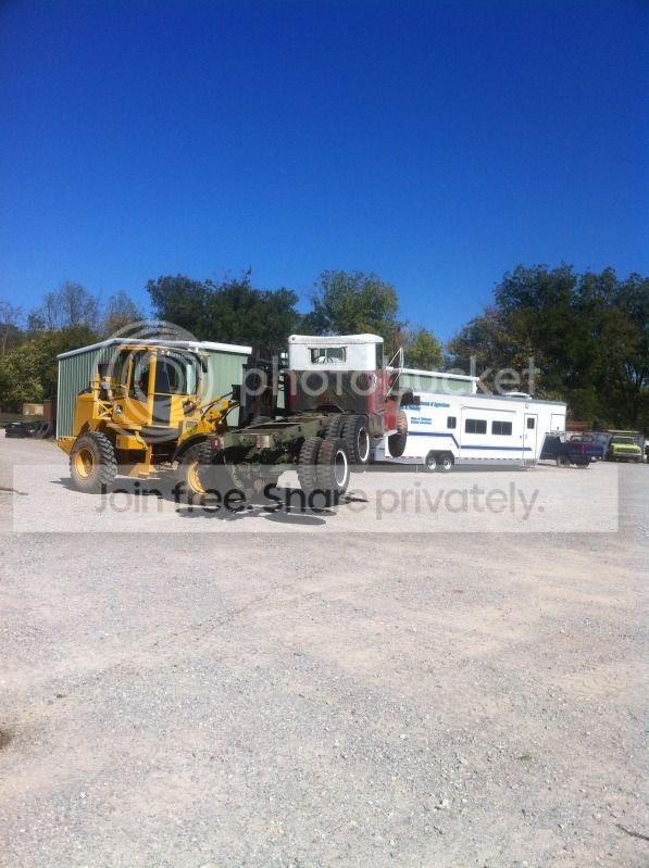

I figure since everyone else uses their build threads to share some other projects I'd jump on the bandwagon. Probably paid a little more than I should, but I've been wanting one for years. Plan to get it running, put a bed on it or bob it and sell it and buy a few more. Seems pretty complete, I previewed it yesterday, they just removed the fire fighting equipment off the back of it, so its a cab and chassis at the moment.
Should have it by the end of the week, I'm pretty excited.

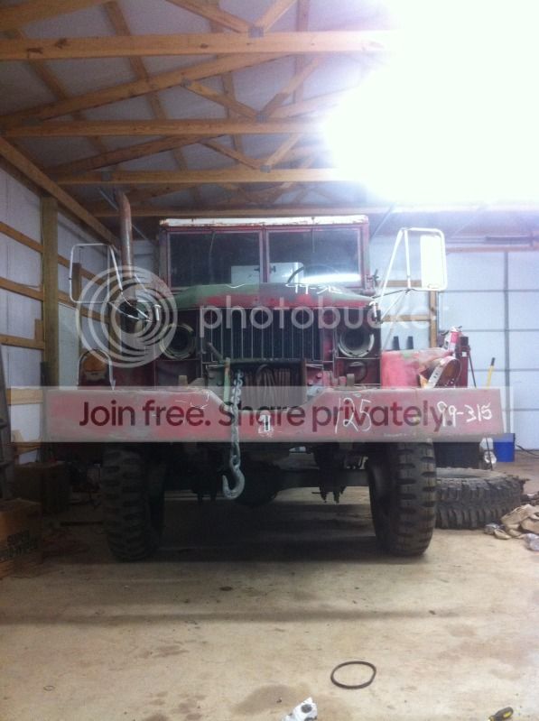

Brought the deuce home today, about 55 miles behind the Dodge. Pretty good ride. The forklift operator dented the oil pan trying to pull the truck out of its hole. A previous forklift destroyed the driver side step, toolbox, and damaged the driveshaft, so I told him to go ahead and pick it up in the same spot.
It fits in the shop.
Its missing some injection pump parts, the part that deals with the multifuel part of the truck. Hopefully I'll be able to find parts, I'd really like to drive the truck instead of parting it out.

Deuce runs. Been working on it for about 20 straight hours. A guy off steel soldiers who lived about 40 miles away gave me the fuel system parts I needed, what luck. After about 12 hours of tinkering with everything in the fuel system I got it to fire. I'll post a video up later if I get a chance. Havent driven it, got to bleed the brakes.

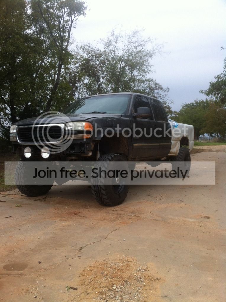

Since there wasnt much interest in this when I started I didnt feel the need to document the build, but I figured I'd show where I am now for anyone else looking to do a similar swap.
This is the end of phase 1. I will drive it like this for a week or so before I start working on the rest of it. I've still got to figure out how to get my 14 bolt in it, get the 205 behind it and figure out what to do about a VSS, figure out a front shock tower, get it tuned, get exhaust, and get drivelines built. Dont mind the random u bolt on the pumpkin side or the hacked tractor 3 point thing in the steering, a good u bolt and ORD drag link are on the way. Its just like this to check clearance around the yard. And I still dont trust it.
I used stock 4 spring 52's with the overload and a zero rate to move the front forward 1.5" to get it out of the rear of the fender. Its got an ORD 4" shackle flip in the rear with a short shackle. I used sky rear hangers and a DIY4X universal mount in front. Rear springs are stock, I plan on flipping the overload since they are barely working with no weight on the rear. Anyway.. As always, cell phone pictures

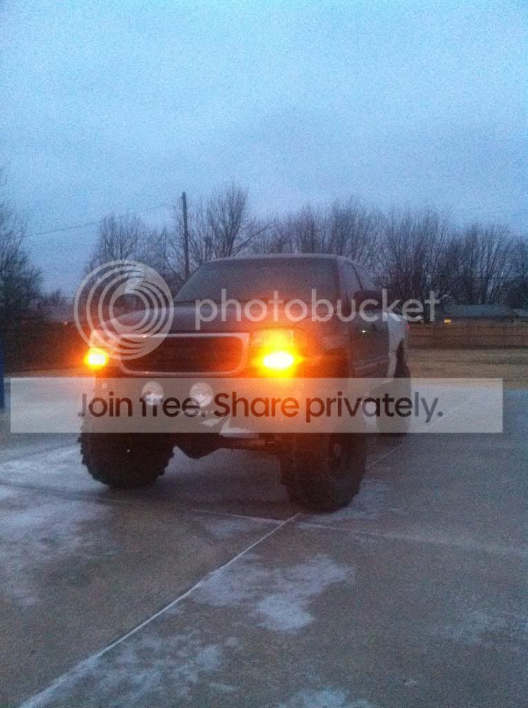

We were supposed to get a blizzard on christmas. Here's pictures from those near white out conditions that they predicted.
We drove an hour south to find this.
I love long wheelbased trucks with lockers on ice.
Looks great. I agree about your 6.0, they are supposed to make a hel of a racket but thats good news with no smoke. Started my thread for my 01, get ready for some PM's coming your way.

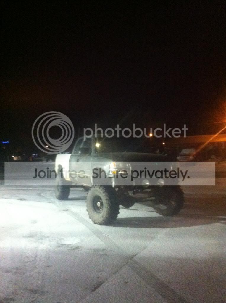

Nothing major. I still drive it damn near daily. Ended up buying a few sets of 37" hummer tires for a good deal and put 4 on the truck with a 2" wheel spacer. Night and day difference. If I had a sway bar you wouldn't be able to tell there was anything different about the truck driving it. All of my shake and wobble issues went away instantly. The bfgs are the best riding quietest big tire I've ever driven. Most of them were even balanced.
The ac has stopped working, and if I can't figure it out I will probably post up in the garage. It's charged. Jumping the pressure switches gets nothing. Swapping the ac controls with a known good control does nothing. But jumping the relay in the fuse box results in cold air. Any ideas?
Anyway,Here's a picture on the new wheels.
Those look awesome! Just need to get yourself a color matched box :haha:
