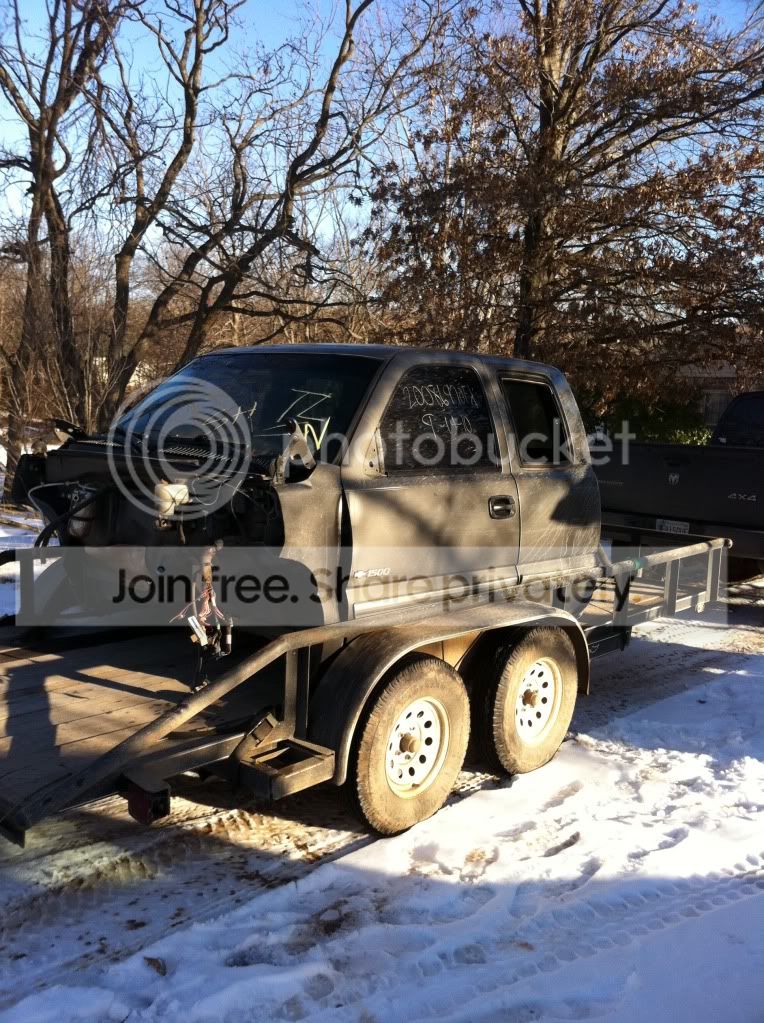

I found a cab at the salvage yard, and I think I got a pretty good deal. The driver door has some damage, as well as the passenger door, but I got the entire cab with all the doors and glass for 600 bucks. And its the same color. They wanted the same price for the matching bed, but thats a little steep for me.

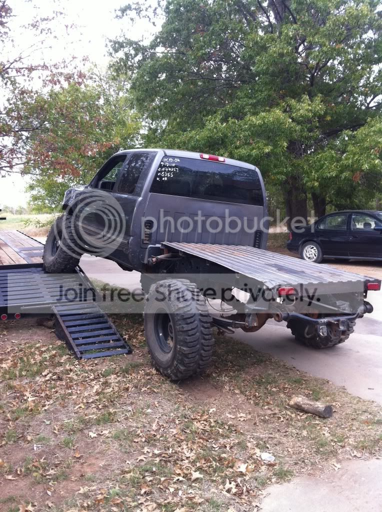

This is the truck. Its a 2000 2500 GMC.
We got the bed and bumper off of it before the snow got too bad.

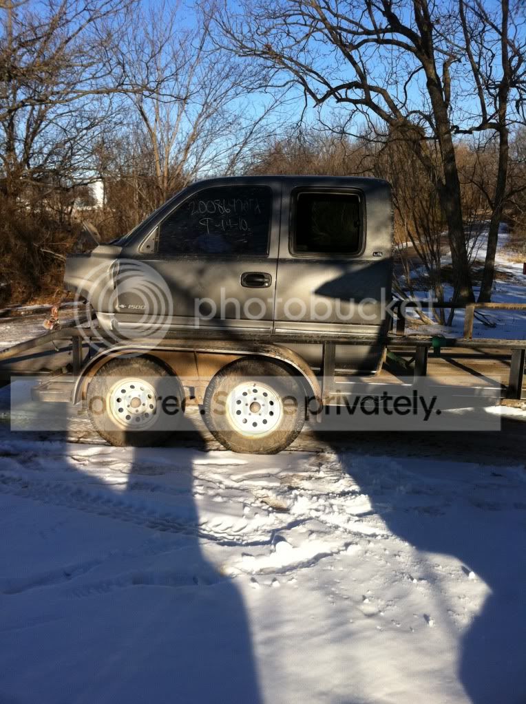

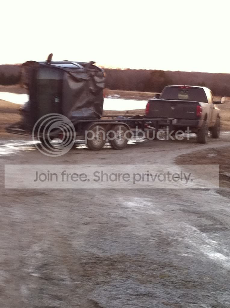

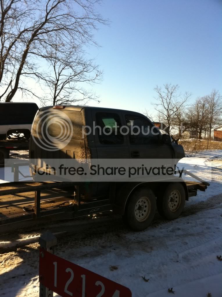

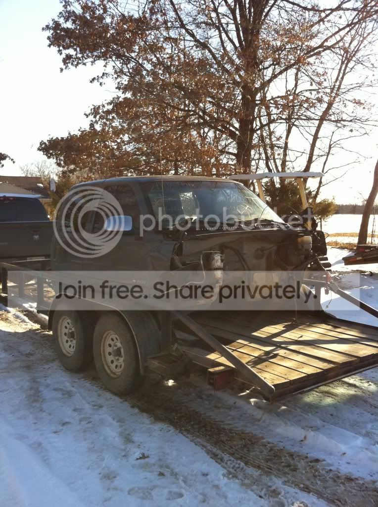

Anyhow, went to get the cab today. My gooseneck was tied up with the K5, so I borrowed a smaller trailer. It was a tight fit. Both of the rear windows wernt latched and broke on the way home. I had one from the other cab, but I'll have to buy another one for the driver side.
Hopefully we'll start pulling the other cab in the next few days.
Please forgive my iPhone pictures, my camera isnt working. When it comes time to do the SAS I'll borrow my girlfriends camera to get some better pictures. The cab swap is pretty straight forward anyway.

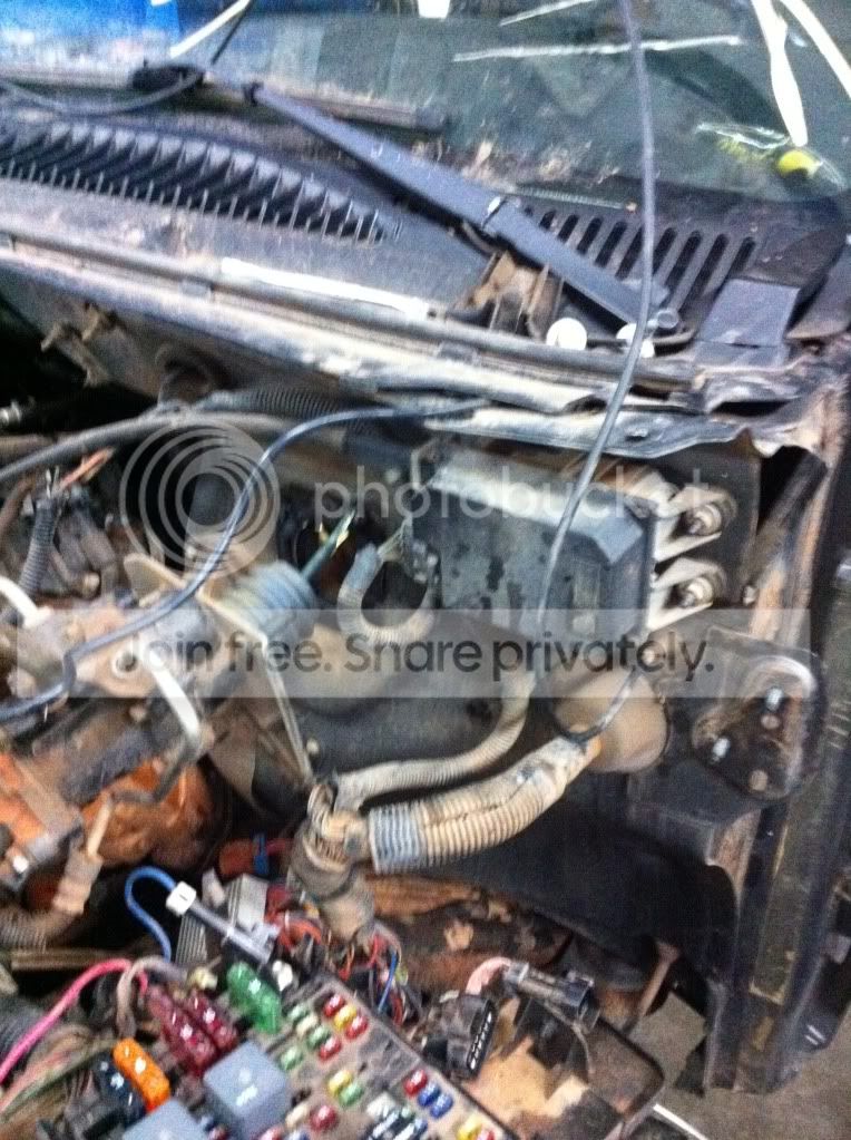

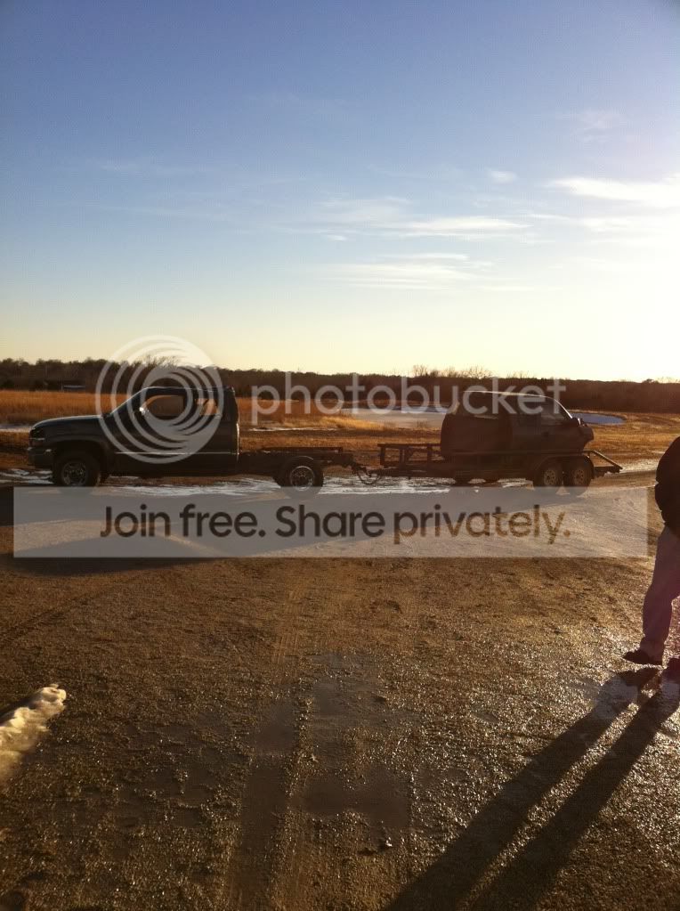

I used the wrecked truck to pull the other cab over to the shop. Unloaded the cab, pulled the fenders and interior the other day. Got the old cab off and the new cab back on and powered up today. Got the interior back in also. We are going to have to pull the column out of the other truck, it is compressed and has some broken mounts. I'll get some pictures of it complete in the next day or two. Its going to take some massaging to get the hood supports back on, as part of the cab under the cowl is damaged.
The only problem we've really had so far was fitting the 3/4 hydroboost to the 1/2 ton cab. One hole had to be drilled and one made a little larger. Other than that there isnt any difference between a 1/2 ton and 3/4 ton cab.
Anyhow, pictures.
Pulling the cab to the shop.
Cab off and on the trailer.
I tried to get a picture of the hydroboost fitment, but it didnt turn out well.. Damn phone.

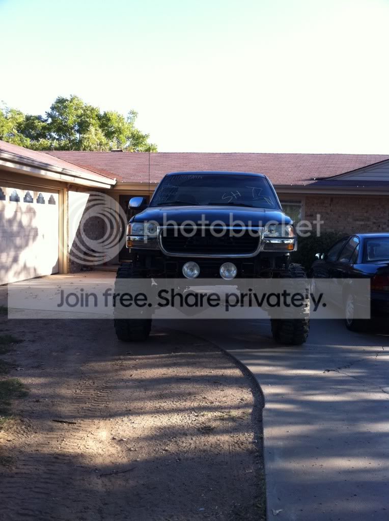

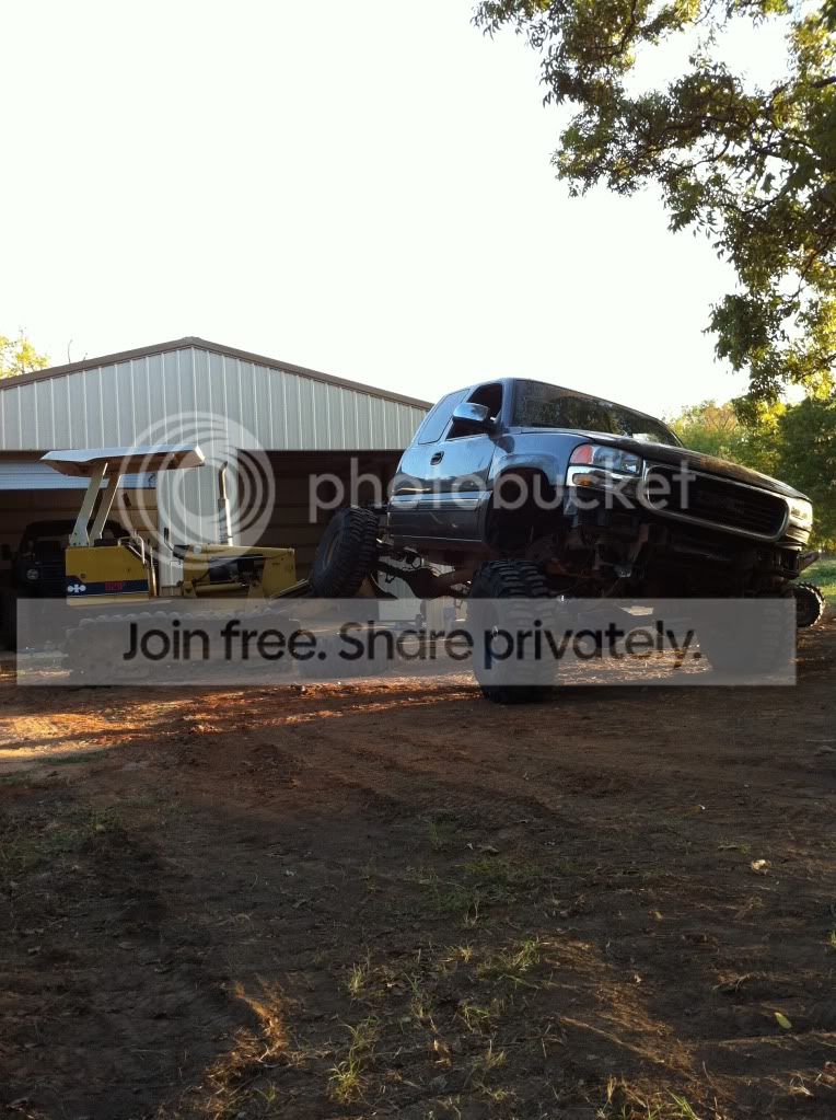

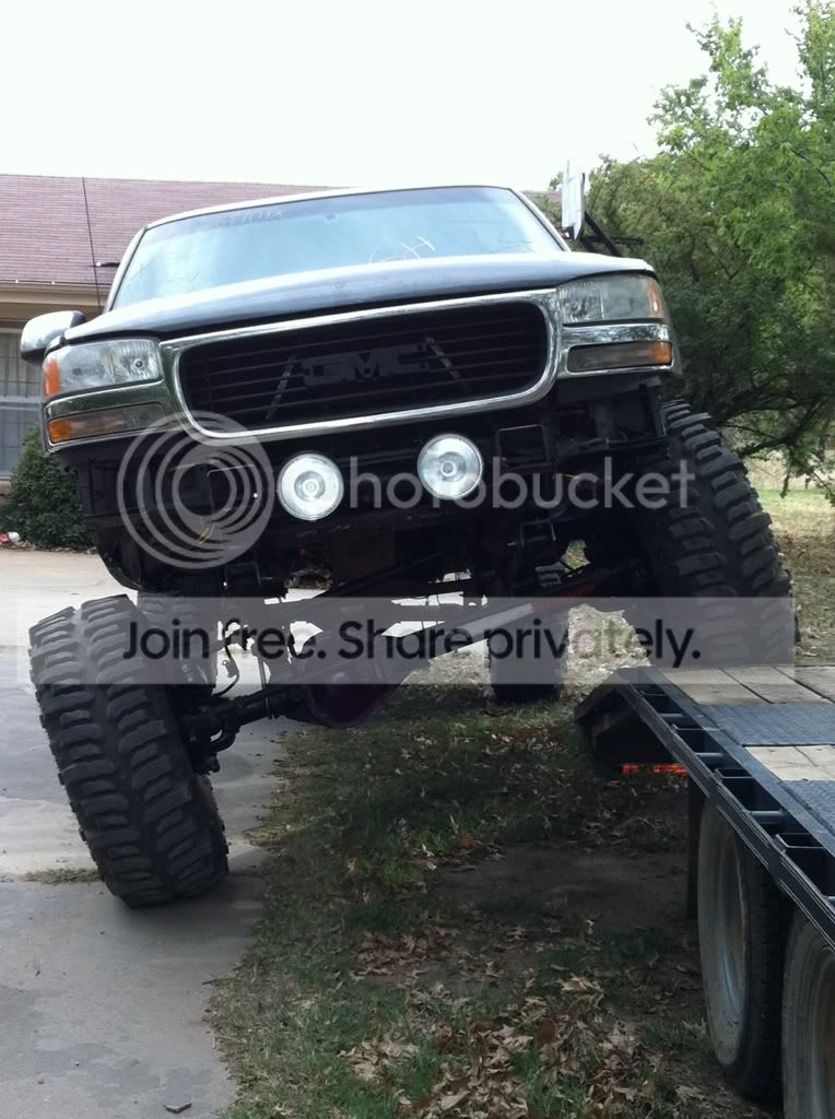

Since there wasnt much interest in this when I started I didnt feel the need to document the build, but I figured I'd show where I am now for anyone else looking to do a similar swap.
This is the end of phase 1. I will drive it like this for a week or so before I start working on the rest of it. I've still got to figure out how to get my 14 bolt in it, get the 205 behind it and figure out what to do about a VSS, figure out a front shock tower, get it tuned, get exhaust, and get drivelines built. Dont mind the random u bolt on the pumpkin side or the hacked tractor 3 point thing in the steering, a good u bolt and ORD drag link are on the way. Its just like this to check clearance around the yard. And I still dont trust it.
I used stock 4 spring 52's with the overload and a zero rate to move the front forward 1.5" to get it out of the rear of the fender. Its got an ORD 4" shackle flip in the rear with a short shackle. I used sky rear hangers and a DIY4X universal mount in front. Rear springs are stock, I plan on flipping the overload since they are barely working with no weight on the rear. Anyway.. As always, cell phone pictures
Looking good....i was wondering what happened to this. A nice set of shock hoops for the front shocks, bilsteins seem to work nice on the sas trucks. Talk to the guys at ord about the 205 vss in you truck, they've done it...also articles here and on pirate where people have done it themselves. Or even bolt up a 241 with vss and have no probs, just have to look for passenger drop. Your 14b prob just move the perches.

I just haven't found a hoop I like. I don't have the tooling on knowledge to bend my own. Bilsteins are in the plans, I've got some 13" travel no names for mock up, but it will be getting a good shock eventually.
My initial plans were to have a tone ring added to my trans and just dealing with the odd shifting in low range, but my local trans shop won't pull and restack my trans without rebuilding it. So I'm considering doing the work to add a vss to my 205. I just need to find someone local who knows enough about this trucks computer to change the ratio to fit the 205. A 241 was considered, and it is still an option, but I want to twin stick this 205. I think front digs may be needed on occasion with 145" of wheelbase.
The 14 bolt may be too narrow. The Nbs perches are 49" center to center. It looks like my springs would be into the calipers at that point. My truck is a light duty 3/4 ton with the 9.5 rear end. Inboarding the springs isn't attractive because my rear frame is tweaked from the rollover. I'm going to move them first, and possibly rotate the calipers down to get them away from the springs. Another option is finding a van rear end for the width, but I'm not sure where they get the extra inches. the final option is a modern 14 bolt. I might be able to do a little trading to get a good deal, but I don't know if my gears and carrier will fit into a new housing.

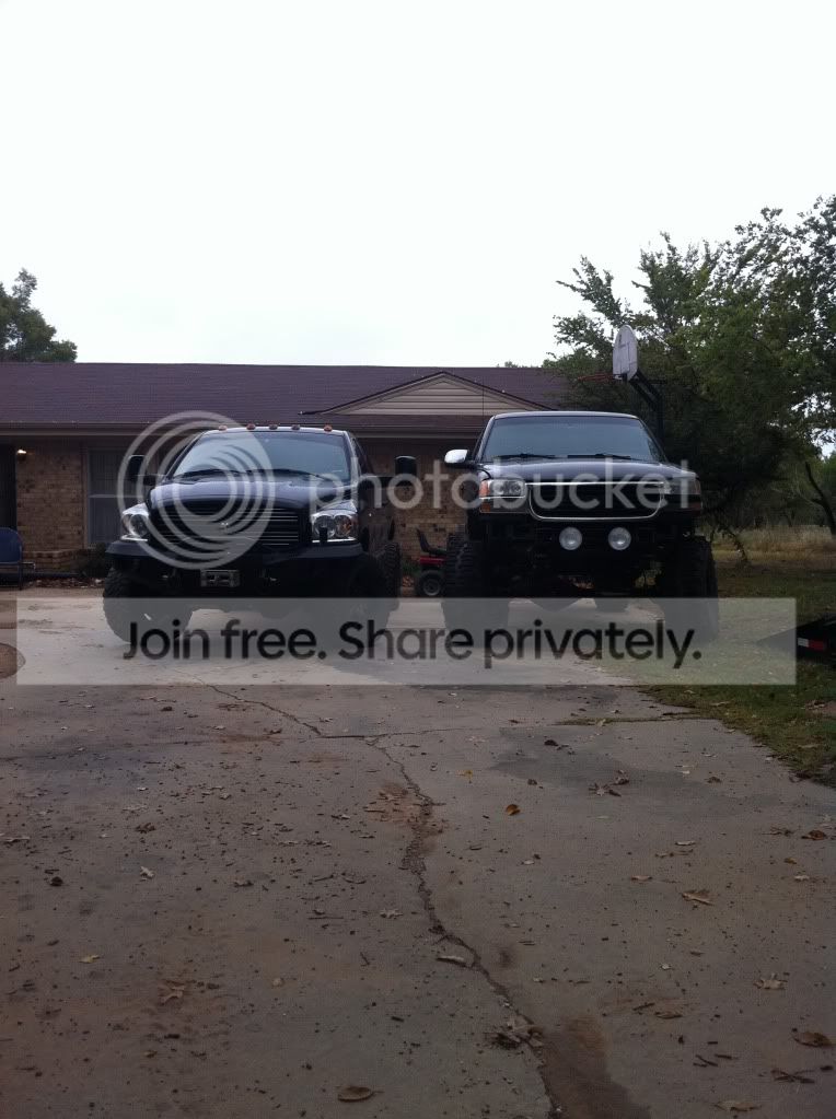

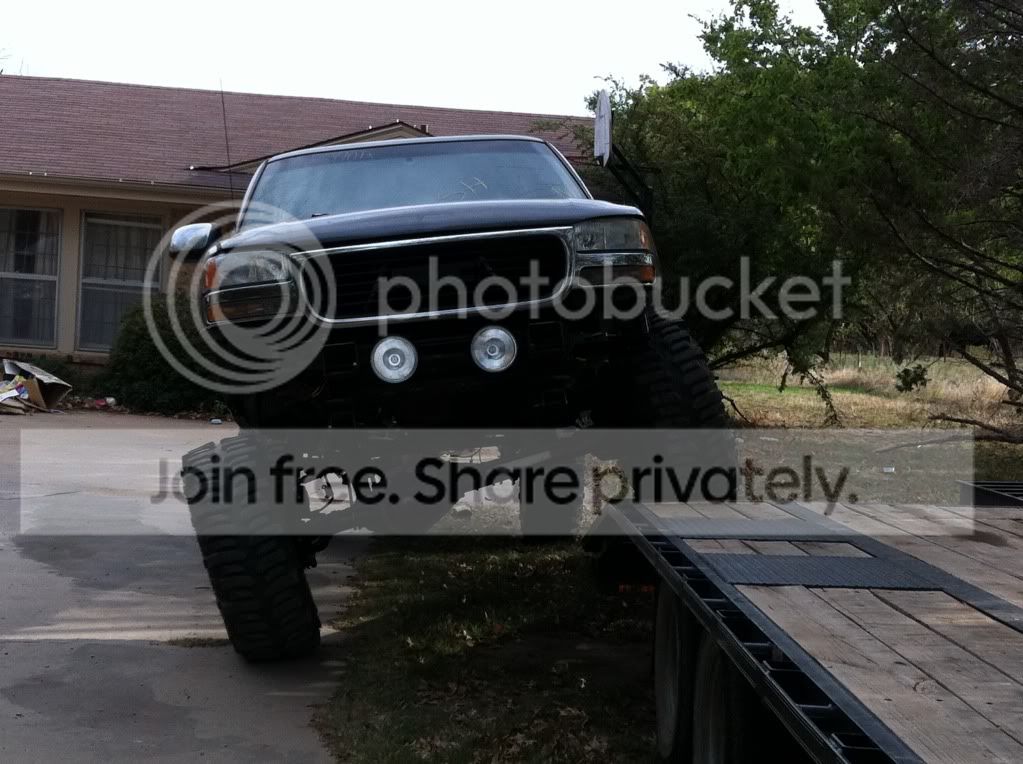

I did take a driveway poser shot to show the size of the new truck against my Dodge. The dodge is stock height on a 33" tire. Tried to keep the GMC as low as possible.
