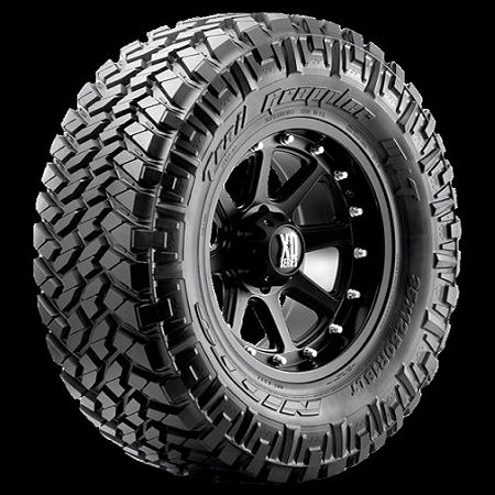

I've got my wheels ordered:
Once they get in I'll order my tires (35/12.5R17):
