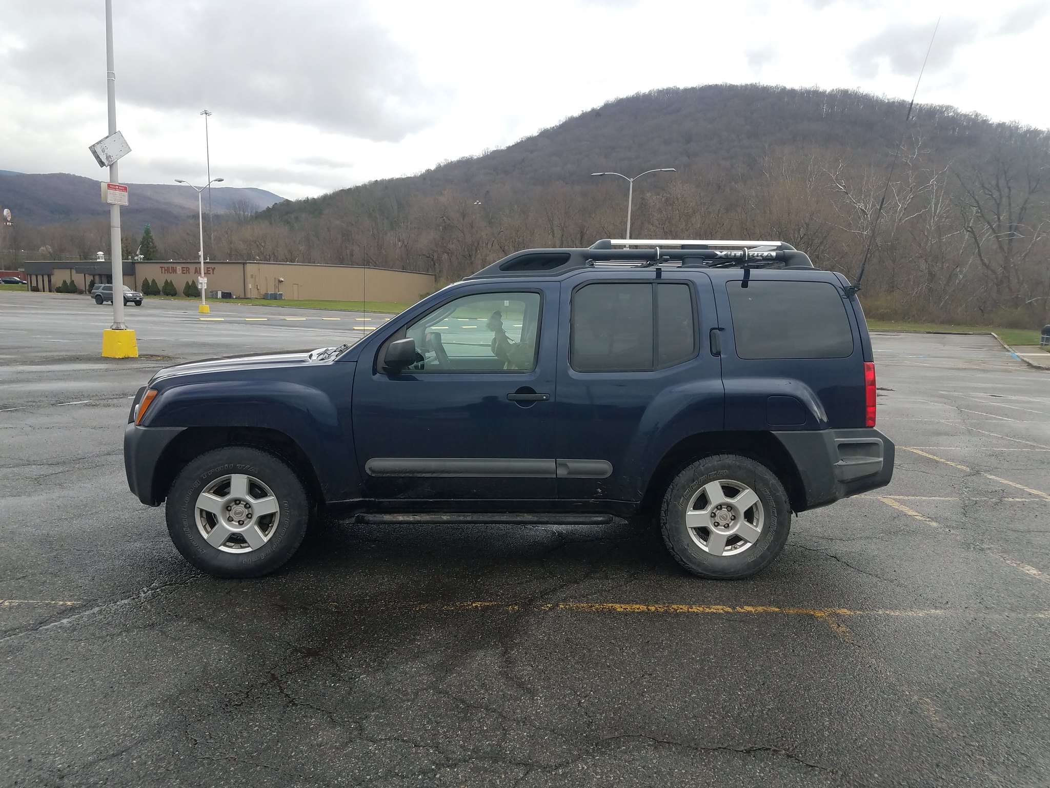

It started as just a stock 07 Xterra S. Nothing fancy.

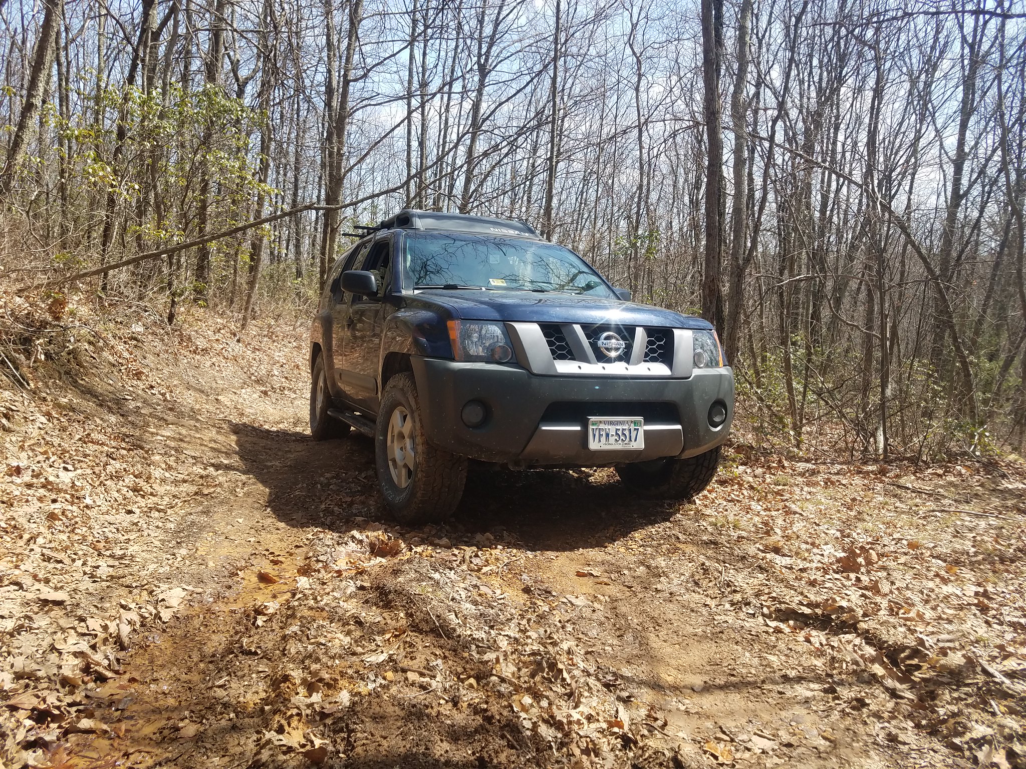

I added a cheap roof basket to it to make carrying things up there easier than strapping it to the two factory cross bars. The clamps are from McMaster-Carr and the basket came from Amazon. I think I have $120 in the whole thing? At least I do a little fab work, right?
I'm considering putting a piece of 5" PVC on one side of the bars that hang out for a water tank for wash-up water around camp. I'm afraid I'm probably going to buy a set of the traction boards like the MaxTrax in the future and I'll probably use the bars on the other side to mount a bracket for them. I've never used them but I've seen them used quite a bit and I think they are honestly pretty good to have if you use them as intended. I want to take this thing out on the beach in the future and I think they'd be really useful in the sand.

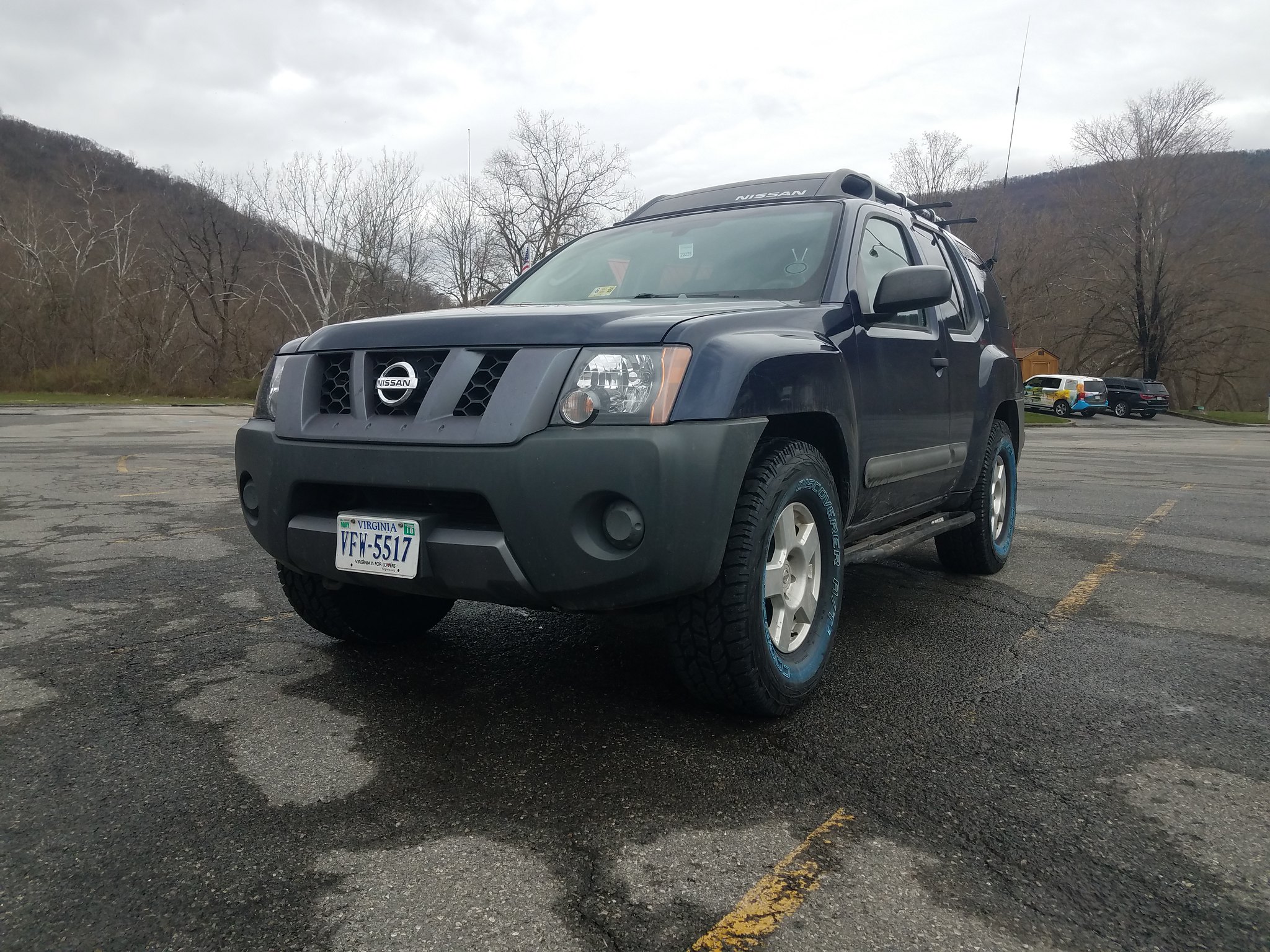

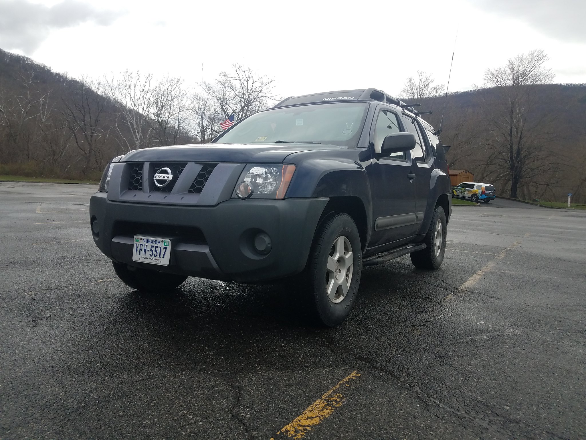

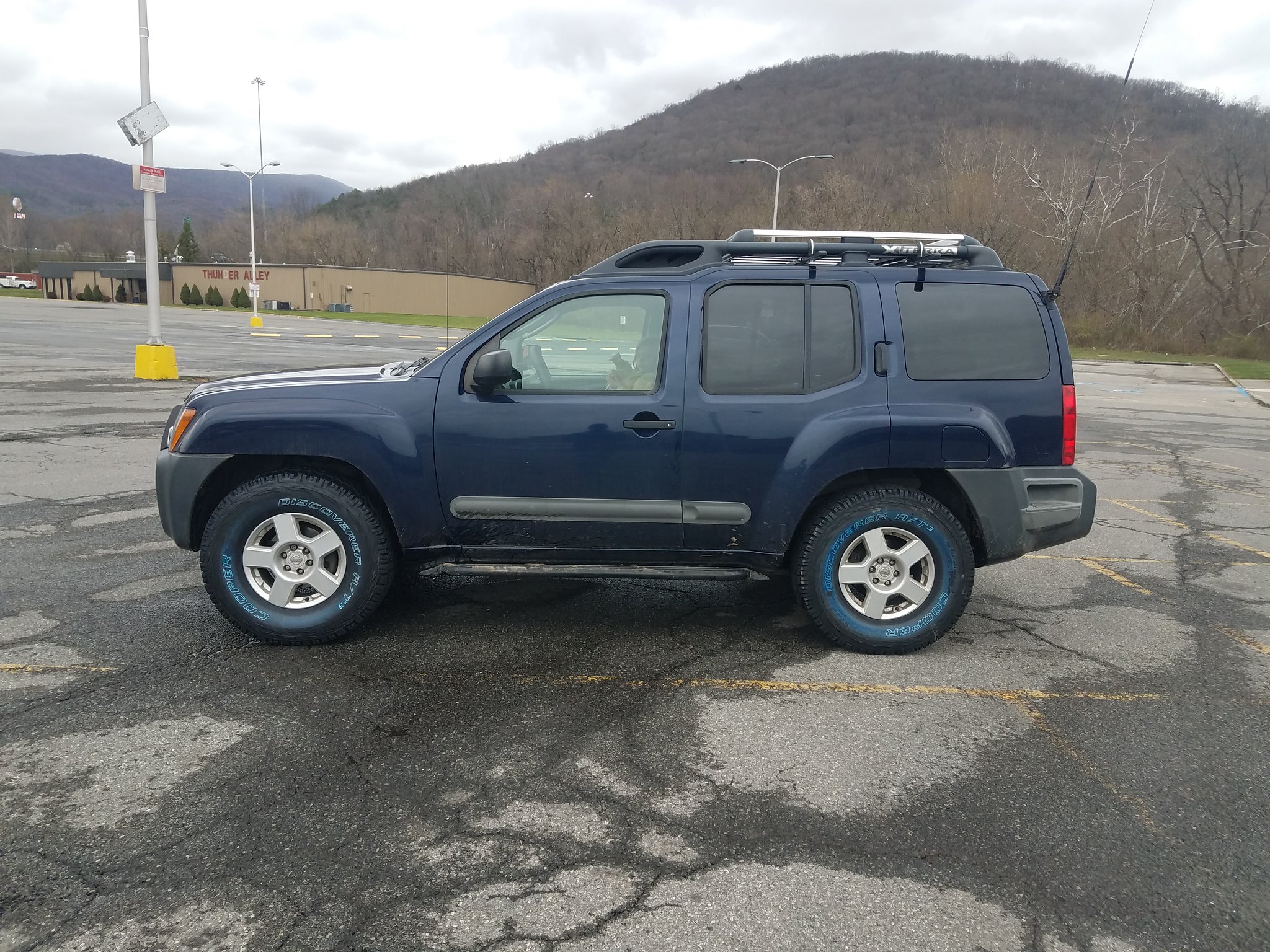

Just got back from the tire shop.
285/75/16 Cooper Discoverer A/T3 I had them remove the TPMS sensors. I don't feel like they are worth the effort right now. I may put them back in down the road but for now I'll just do without.
Before:
New Tires by TerryD, on Flickr
After:
I can tell they are quite a bit heavier than the P rated 265's and I think I might focus on finding a set of 3.69 geared axles for it. It's just a quiet inside as it was so I think for the time being, I made the right choice. While it was up, I gave it a quick once over and I'm gonna need new brake pads on the front pretty soon. Guess I'll be putting in an order with Rock Auto here after while.

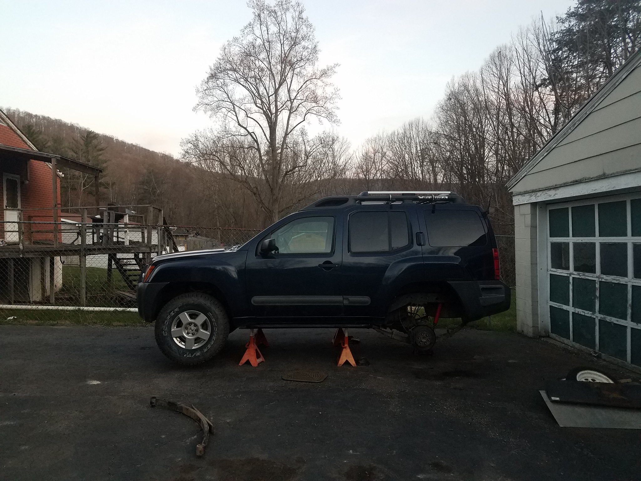

Lift has begun!
Both Helwigs removed
Both shocks swapped
U-bolts off both sides
One Alcan in
Started around 5, worked about an hour and a half between pumping up neighborhood kids bike tires, a nice supper the wife fixed and packing everything back in the garage to close up for the night.
20180411_195407 by TerryD, on Flickr
