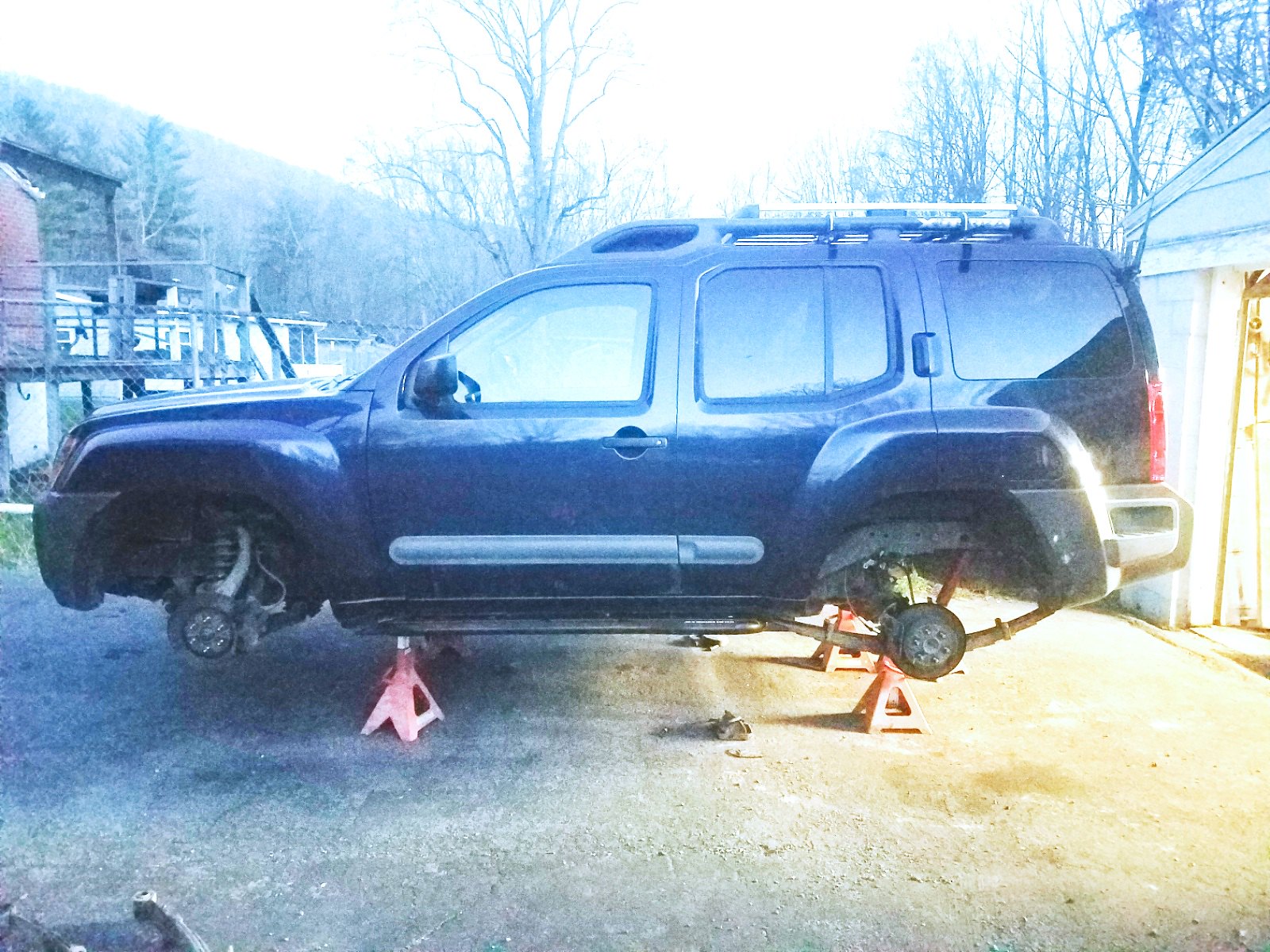

Hard to see in this picture but the rear axle is on the stands with the weight on it and the front is completely unloaded. The rear hub is lower than the front. I'm looking forward to seeing how the front ends up!

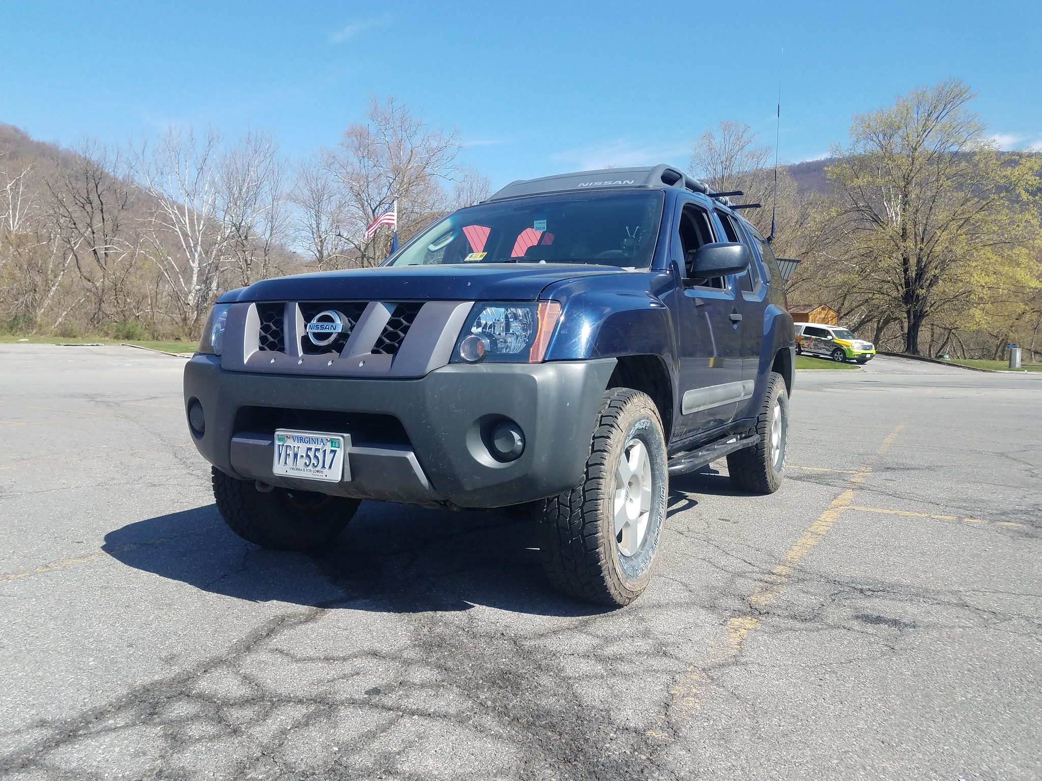

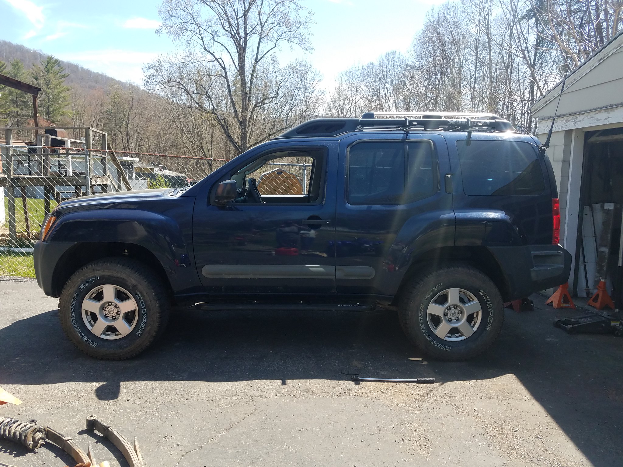

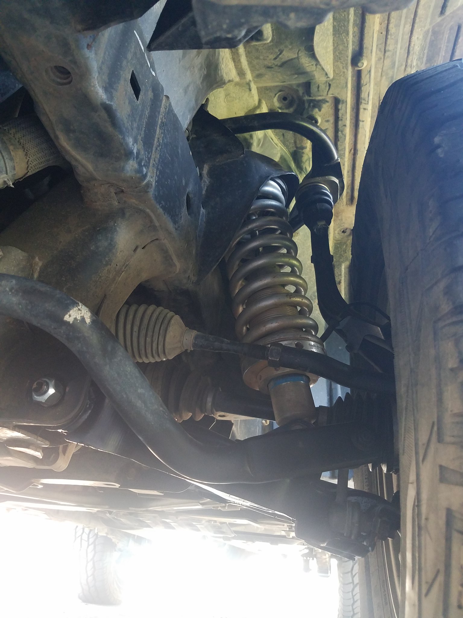

It's taken a good bit to get it done, but with the help of my dear wife and a buddy who came over yesterday after I helped him hang his new HF antenna, it's finally done. I've been looking forward to seeing it on it's wheels again all week. I roughed in an alignment and it seems to drive ok. I think the tow is a bit high.
I wound up cranking the cam bolts all the way out and moving the ball joints out on the SPC's about a 1/4" from the fully inboard position. I've got to find a shop this week to get the alignment taken care of.

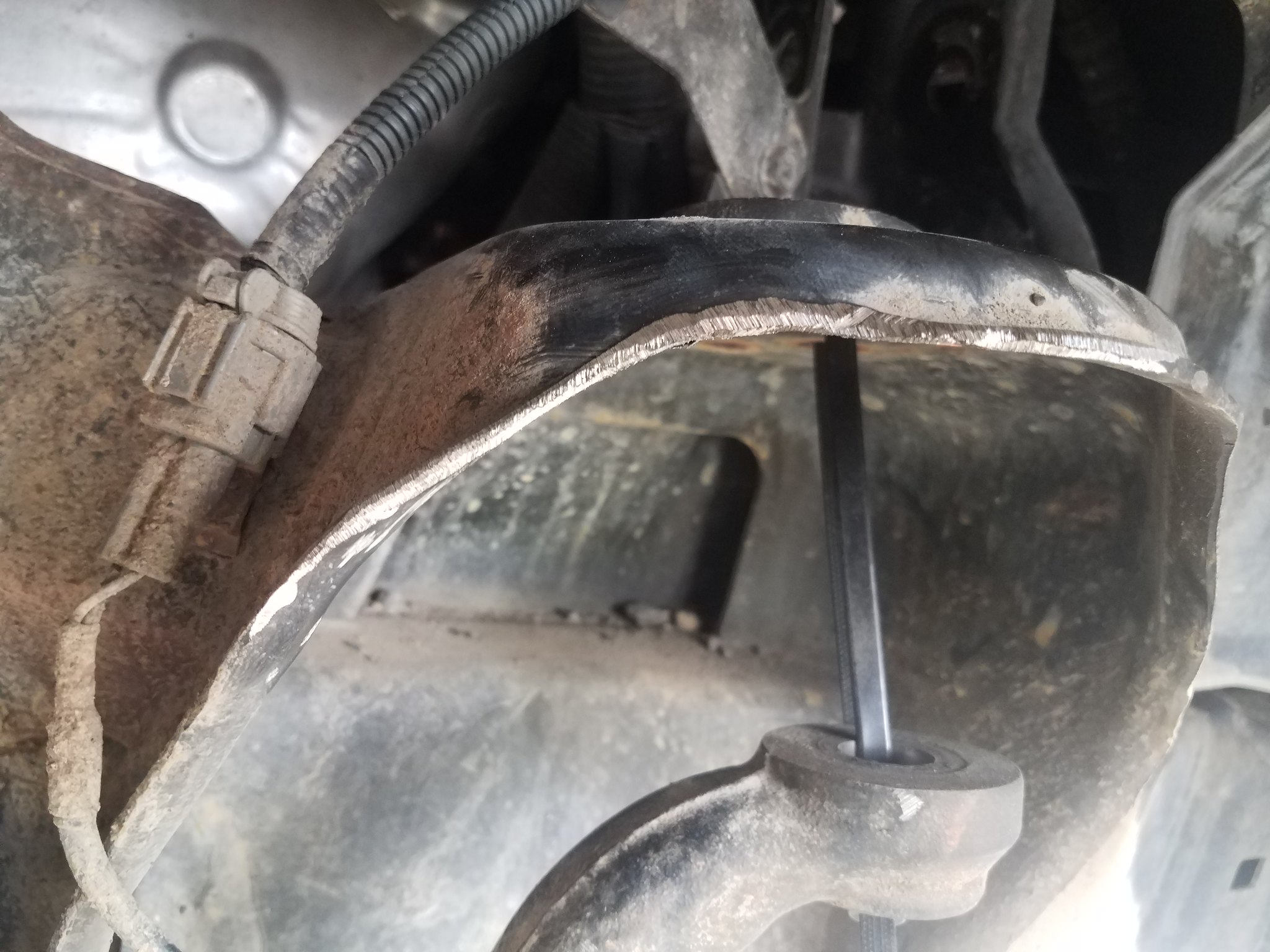

I went ahead and ground the coil buckets till the UCAs would bottom out on the bucket with the ball joint all the way inboard. I shouldn't every have any issues with CBC or ball joint boot damage now...

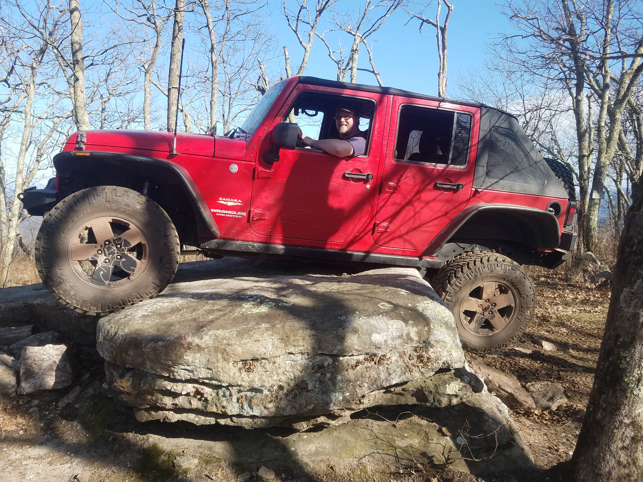

I mentioned going to the local trail after my alignment and a buddy got a hold of me and said he'd like to take his JKU out for a shake down run too. He just put a Metal Cloak 4" system on it and wanted to give it a test.
So after my alignment, I headed up to Craig County to meet up with him and see how our freshly lifted rigs would do.

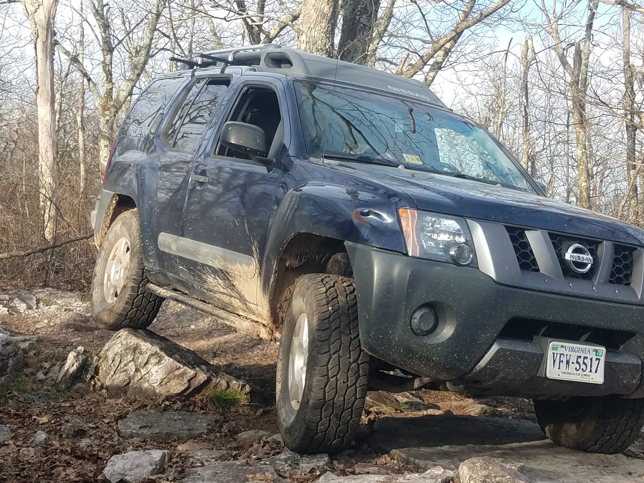

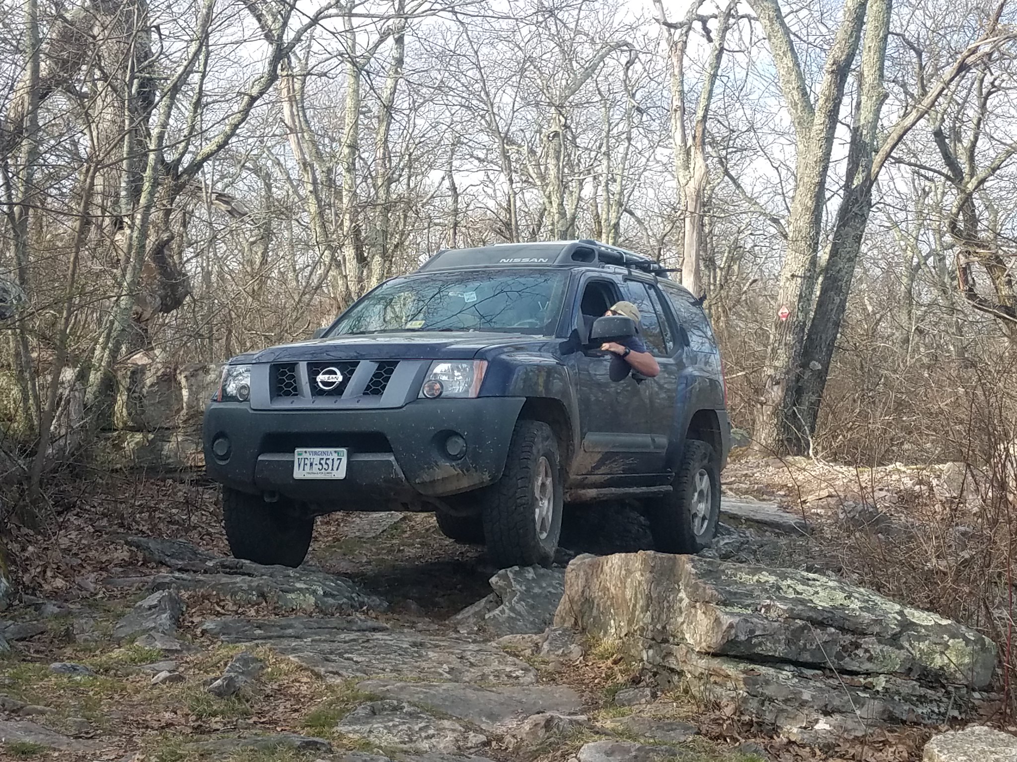

I only aired down to about 25psi for the trip. I'm pretty pleased with how the Xterra worked out there. We only ran down to the Sand Notch at The Overlook and turned around, but Brett got to finally go across Kidney Rock and I good a pretty good idea of how the Xterra is going to work out.
The sliders took a couple light hits. I need to see if there's a way to get a little more down travel. Coming out of a few pot holes, I could feel the front top out and actually carry the front tires. I've only got a 1/2" thick spacer on top of the 5100s, I may need to go to a thicker one when I get the Shrockworks bumper on there and gain a touch more down travel.

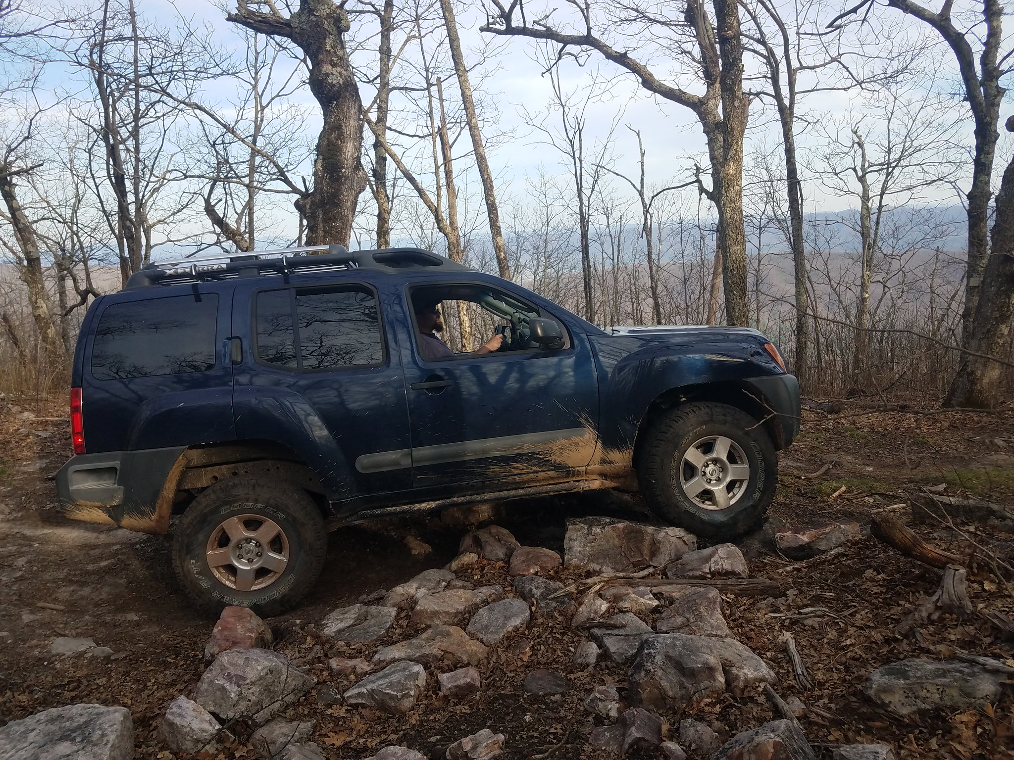

I've got to look into getting some more down travel in both ends. I think even the rear Radflo shocks wound up being too short. I need to try it again with a full compliment of children, dog, and gear to see for sure though.

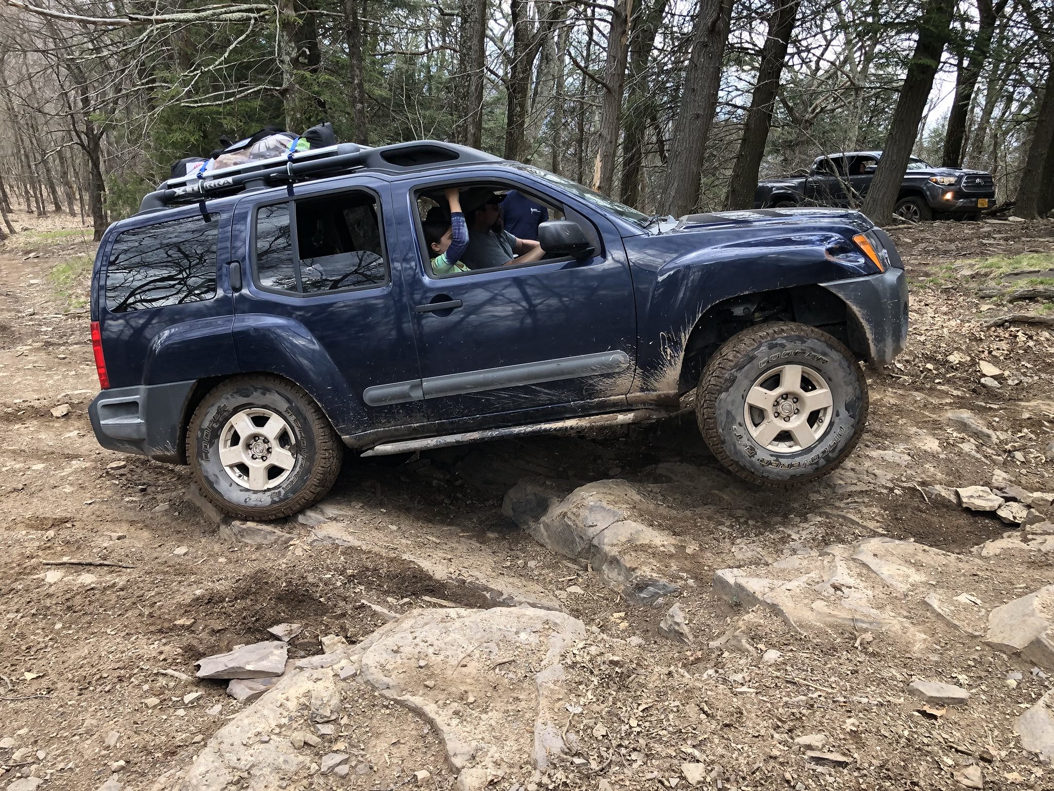

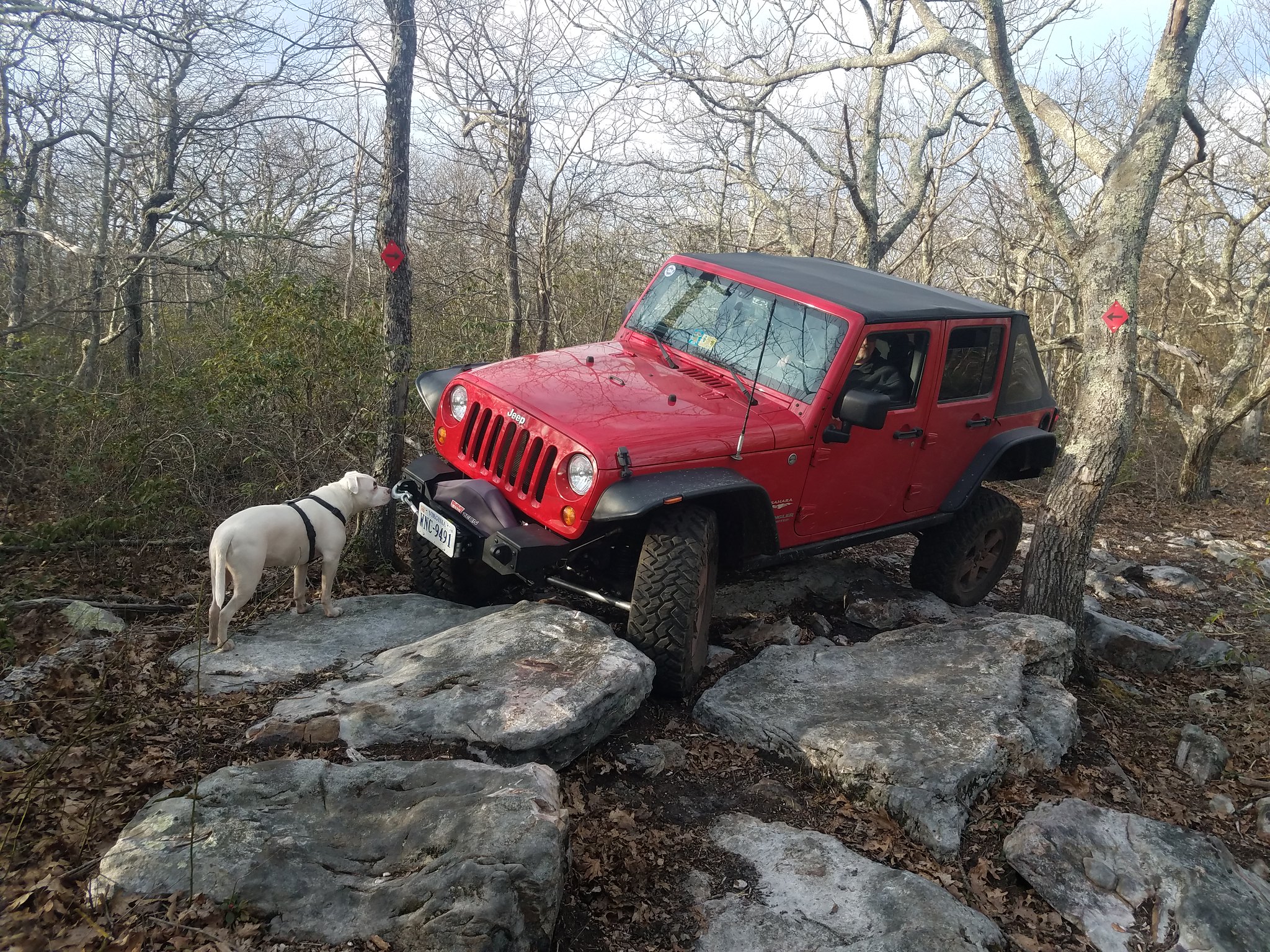

This part of the trail had its moments! It began with a down hill stretch where everyone three wheeled at least twice. I picked a slightly better line than most and just barely picked up one of my rears.
It took a few stacked rocks under the driver's rear and a touch of throttle to get up that because of my wheel base put a little ledge at both front and rear wheels. After a couple rocks in the hole and a good bump, it crawled the rest of the way out.
