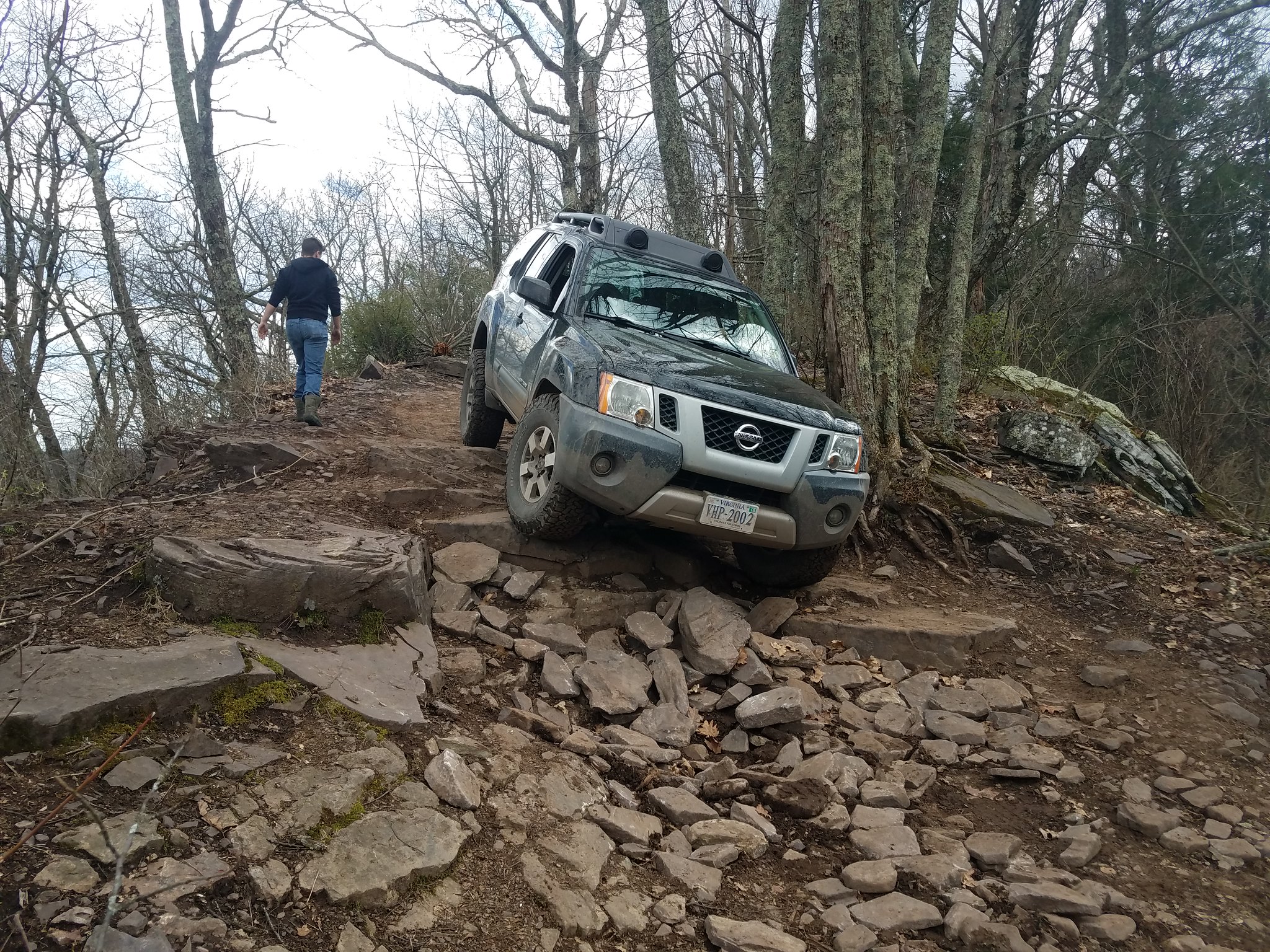

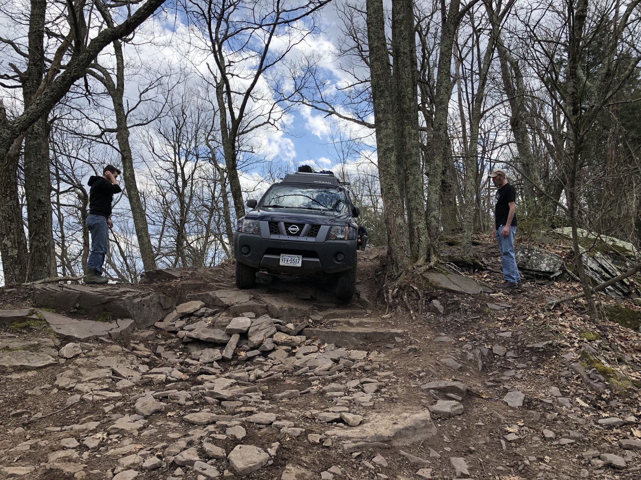

I had Jon do a little spotting for me via radio down this little ledge, trying to find a spot where my driver's rear wheel wouldn't have the same 2' of air under it the Tacoma that went before me did.
IMG_1773 by TerryD, on Flickr
Myself:
IMG_1810 by TerryD, on Flickr

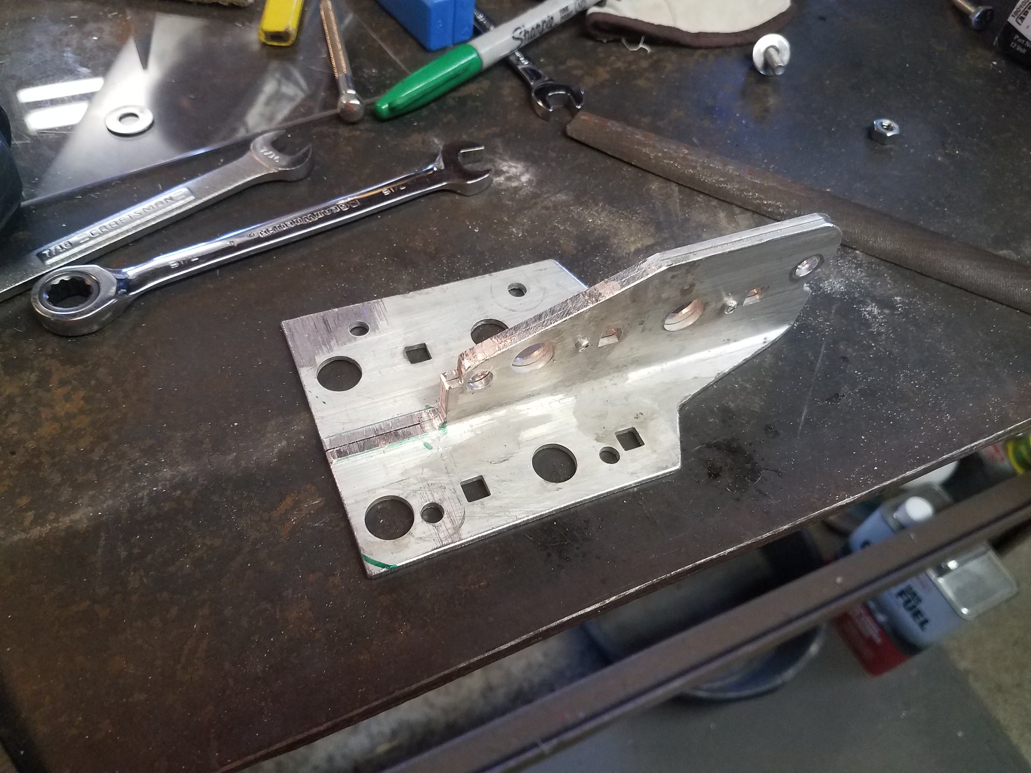

I'm hoping to get my ARB compressor installed in the next couple day to have on our Pisgah trip next week. I've been working up this bracket to mount it with. It'll bolt to the radiator support in front of the air box. I reached the point where I'm probably going to have to pull the air box off to finish it, so I called it a night. I've got to go to town in the morning for some business and then I ordered a 5th 285/75/16 Cooper Discoverer for a spare that should be in after lunch time at the local tire shop. After that, I'll pull the air box and try to get the compressor mounted and hopefully at least begin the wiring. I'll have Friday and Saturday mornings and most of the day Sunday to be working on the finishing touches.
20180606_190514 by TerryD, on Flickr
The only thing I had to work with was a section of aluminum tubing tray I got as scrap from work. I riveted two pieces together, back to back, and I think it'll make a nice mount. I've got some pieces to put the intake filter up next to the brake booster as well to help keep it clean.
