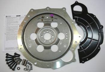

There may be hope yet! I have some friends at GM digging around for a possible bolt together solution. With a specific flexplate. Meanwhile, I mocked up the wireharness and I may only have to extend the evap solenoid and alternator wire. everything else pretty much fits where its supposed to.
Not a lot of feedback from the custom torque converter shops... but pursuing my parallel path of OEM parts, GM may have a solution for me it turns out...
Chevrolet Performance Transmission Adapter Kits 19154766:

So it sounds like if I go with this kit and I re-drill my existing flexplate to match to the torque converter pattern and then this will work but the engine will sit 10mm forward in the truck so I may need to get a little creative in my engine mounts/mount brackets or move the trans brace backwards and take up some yoke slack.
It seems that if you have an LS you need dished flexplate to make up for the offset because of the shorter crank to maintain the bellhousing flange to crank flange gap. If you have an older style engine or BB with the long crank you need the flat flexplate to maintain that gap. Again this supports my theory that the the new LS engine family is just an SBC built with a computer instead of a drafting pad.

Just got the kit in and its perfect... except the crank pattern is for the smaller SBC and the 8.1 is internally balanced so it doesn't need the external weight. I am going to try and re-drill the existing flexplate in conjunction with this kit and go from there. the kit provided has longer bolts for the bellhousing to engine but its meant for the gen I/II SBC which is standard thread, not end of the world I can just mcmastercarr some proper sized metric hardware.
Worst case I am thinking of getting a 1/16th" thick BB crank flange pattern made and just weld it to the small block flexplate to give it some girth in-case the re-drill looks like it has really ate away the meat on the flexplate.

I dig the method of obtaining a 58x signal but that doesn’t work out for some reason PSI has a 58x reluctor wheel on their 8.8L that you could press on in place of 24x in the stock location at the rear of the crank shaft. The bad thing is that would require the crank to be pulled out to perform the pressing. The PSI part number is 80000564. The crank sensor to go along with it would be 8000562. I've researched this a little bit to go the other way by adding a 24x to an 8.8L to retain my harness and ECM in my K10 and Suburban if I ever get my hands on an 8.8L.
I also have an email into my contacts at PSI to see if they have a flexplate solution for you as I swore they had a 8.8L/6L90 combo running around in a test mule. One of the guys there seems to think there is a PRW flexplate that fits the 6L90 torque converter. Below are the 8.1L flex plates PRW claims to have. Might want to call them for measurements to see if any will work. A couple of them are drilled for different torque converter tab spaces.
PRW
1835021
1835030
1849600.. this one looks like the one you already have

Called up PRW the two part numbers you have listed, only difference between the two is that one is lighter than the other (hence the holes) for quick launches. However the torque converter bolt pattern is different. they have 3 patterns the 11.5, 10.75 and some 9.XX" one
PRW suggested I needed 1834620 it is the 164 tooth ring gear not 168 but it does have an 11" pattern which can be made to work for the 11 & 1/16th but I'm not sure the guy understood what I meant. Thats what I hate about this swap I call places and people are confident in what they have but really don't understand what its going in so they provide the wrong part part #s
the description in it conflicts with the other details...
"Ford 429-460, 1966-97, Big Block, 164 Teeth, External Balance"

Well, that is a bummer. Was hoping they had one that would be a direct fit. It might be tempting to try their 1835021 and drill the holes you need. Surely, that would be less expensive than the GM 19154766 Kit.
Yeah, they offer a heavy version of the K2XX Suburban that just came out in 2017. Don’t feel bad, as most GM dealers don’t realize there is a HD Suburban either. Like the Chevrolet Caprice police cruiser, it is a fleet only vehicle available to municipalities and other government agencies. The powertrain is exactly the same as the GMT900 ¾’s with a L96 and 6L90 but with the hideous K2XX SUV body. For 2017 it was called Suburban 3500-HD but I noticed for 2018 they are just calling it Suburban HD. Still an ugly sumbish. To be honest, I am not a fan of the GMT900 trucks and SUV’s either. Those were the cheapest made and poorly assembled rigs in GM truck history IMHO. Although, I do like them better than the current K2XX SUVs by a long shot.
Well, good luck with your flexplate caper. If I come a cross any other info from PSI I'll let you know.
