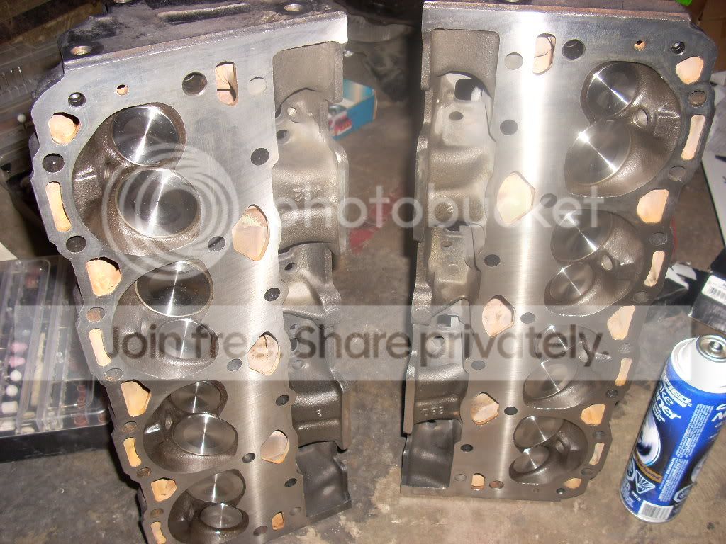

Vortec heads with stainless undercut valves and polished runners

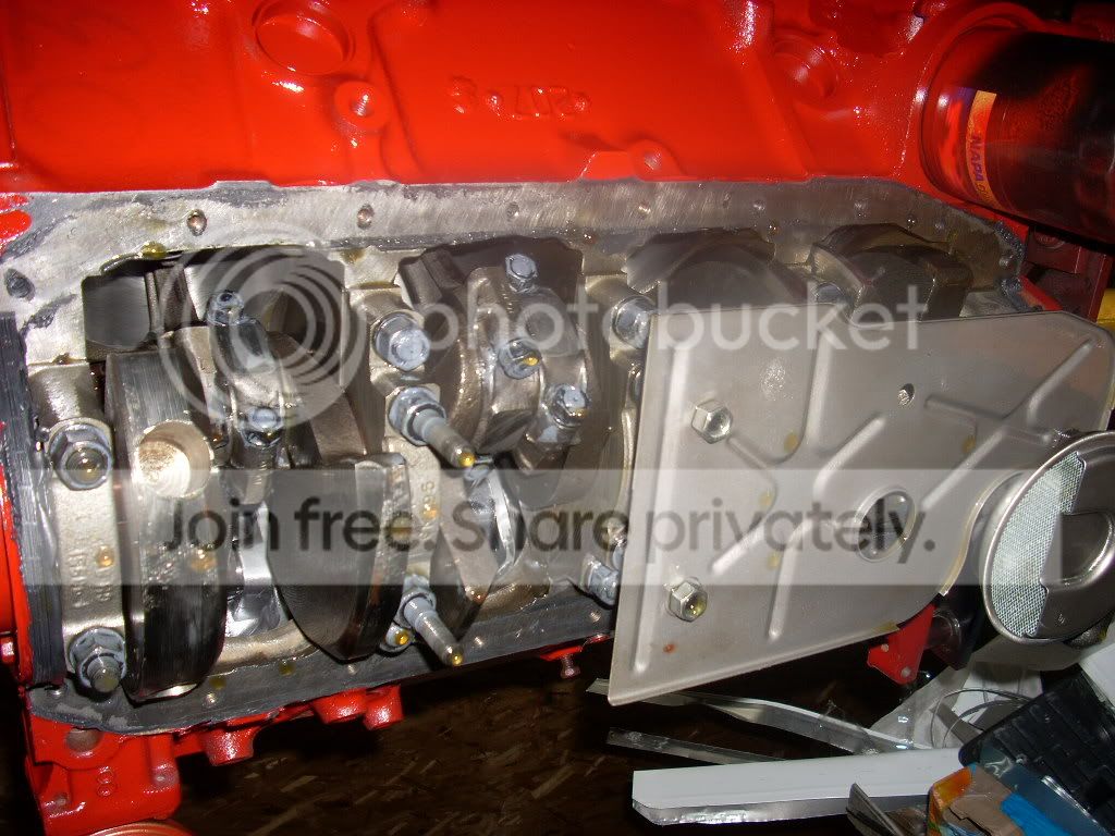

ARP studs and align honed, ARP rod bolts and rods resized, cheap windage tray

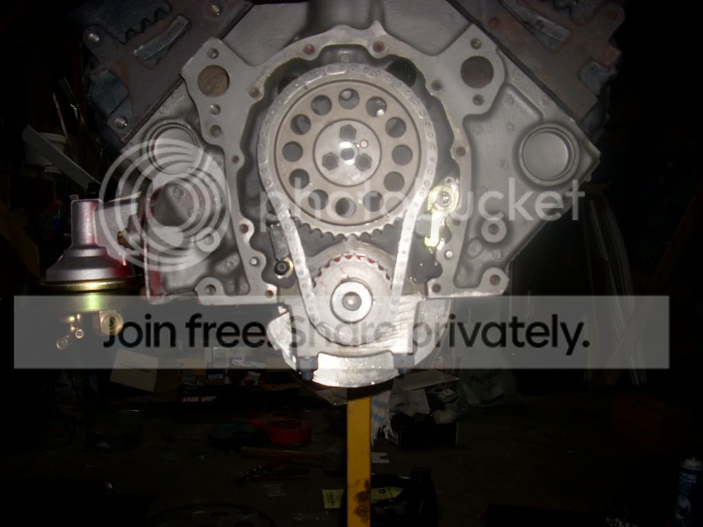

Timing chain tensioner, probably not necessary but a good idea because of the align hone, on a Cloyes .250" double roller timing set.
Oil pan in place with a Professional Products degree'd balancer installed

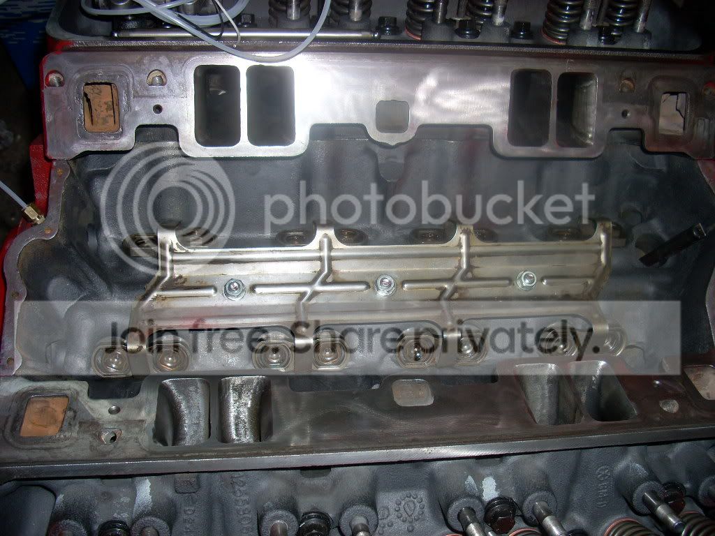

Lifters in place and guide plates bolted down

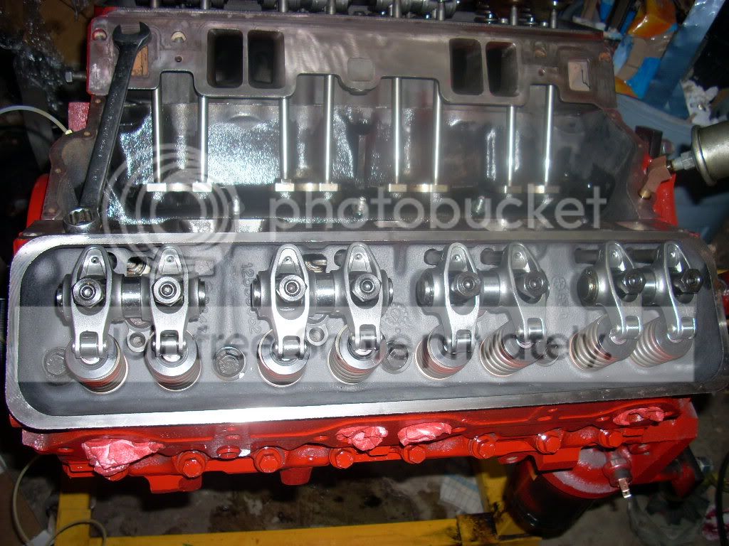

Shaft mount roller rockers--they have to be self guided on the vortec heads, I'm not sure shaft mount was the brightest idea. Might still have to come up with something different as I'll explain below.
Because the seat depth varies from valve to valve, the shaft doesn't sit square when the two arms are tightened to match their respective valves. That will in turn create a lot of extra pressure and wear on the valve train. Do these type of rockers require the valve seats to be cut to equal depths, or is there some other way of fixing this problem?
Only thing I can think of is shimming the pedestal(s) they mount on, but that would seem likely to induce binding if one side is higher since the two rockers are connected.
What say Scott? :)
First i must say i've never used or even physically seen the shaft mounted rockers before. I've seen them in the magazines but never in hand. With that said i don't think there is any "pedestal" it is simply a set of rockers connected with a shaft to keep both rockers aligned over the valve tips. The flaw in this design is exactly the issue he is having now. Unless both valve tips are set to the EXACT height then the shaft cannot sit properly and will stress the rocker studs. The best thing in this case is to machine the heads for guide plates and then change the rockers to a standard rocker arm and make sure you use hardened pushrods for use with guide plates. The first option though would be to use the self aligning roller rockers designed for use with the later heads.
Ugh, no pedestal??
Quick scan of the thread tells me nothing, those look just like my comp cams pro magnum rockers, wonder if you can buy just the trunnions of the non-shaft mount ones and replace them.
Tying two rockers together, with or without a pedestal, seems like a recipe for frustration at best.
I went in and talked to my machinist and he said pretty much what Scott said. The rockers were being sold as Vortec roller rockers, and I didn't know any better at the time. Apparently the application would be where you have an adjustable valve train, dunno how that would work, or you make the valves all the same height when building the heads.
I also have a set of individual roller rockers, and was informed that I could modify them to be self guided simply by removing the roller tip, opening up the end a bit with a grinder, and installing little disks on each side of the roller tip to keep it centered on the valve stem.
For the time being I'll run the stock rocker arms.

as many engines as i have rebuilt over the years, i have never seen 1 of those timing chain tensioners for a sbc, not even in the parts books..who makes it & where did you get it from...i'm about to actually build me a 383 & a 377, i figured since i'm robbing parts from 1 for the other and vice versa, that i would go ahead and have all machine work done and buy all the parts to put them both back together.
The Adjustment on a shaft style rocker is on the top of the rocker where the pushrod sits. You basically have a threaded shaft with a cup on one end and it threads up and down inside the rocker. Then the nut is used to lock it all together. the way it is now it will bind and break studs.
