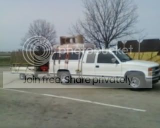

fullsized '94 ext cab silverado, Vortec TBI though, averages about 15-17 or so, if easy on the gas, it will eat the gas if you're on it enough though.
on our trip to Indiana from Arizona, the Silvy was pulling a small Coleman camper trailer, gutted, but was full loaded, the bed was full loaded and we had a complete mattress set up on top of the camper shell. OH, and a cat condo thingy... :tongue1: Only ran no faster than 65mph all the way here and from what i figured up through the mileage and receipts, it averaged about 19, suprised us both, but i contribute this to the steady speed limit, which is what we were trying to accomplish,,, a higher mileage as we were real low on funds.:doah:
also as mentioned, i too had to redo an intake gasket on this older one.

crappy pics there, taken from a previous cell phone...
