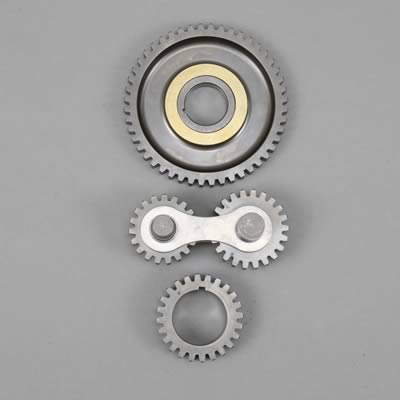

Kennedy Diesel had a few sets of the Pete Jackson gear drives left as of a few weeks ago if you have to have one. However, my experience with floating dual idler gear drives (most from Pete Jackson) in race engines is less than spectacular. They claim more consistant timing and they do a good job to begin with, but they wear so fast that they become way more erratic than a chain in a short period of time. I'll just say that no serious race engine builders use them. Modern High HP engine builders use belt drives, or fixed idler gear drives. In dirt track racing, a good quality chain (like Cloyes Hex-a-just for example) is preffered over dual idler gear drives. I sold an '84 K10 with 339K on clock on the original 6.2 a little over a year ago and still ran good. The IP was replaced by the PO at 220K, but he didn't do the timing chain. I've had (7) 6.2/6.5 trucks and currently have (2) and I've never had a problem stemming from the chain. I'd spend your money elsewhere, because the timing chains do a good job. If the gear drives for 6.2's were so great, and considered a neccessity, there would be several companies selling them. JMO

A agree that other heavy duty Diesels run gears, but they do not the dual idler style set up like the Pete Jackson. They run a gear to gear design which is far superior. I'd argue that is an apples to oranges comparision.
I would personally want to see someone with 100K+ miles on a 6.2 with PJ before I would reconsider trying one. They just wear out so fast on gas motors that I can't imagine them doing any better in a diesel, except that the lower RPM make prolong the wear a little longer. Like I said they do good for a while, I've seen several of them come completely apart. That floating design is just not that reliable for high mileage, at least in my experience.

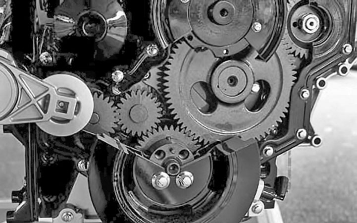

Heavy Diesels do use Idler gears, (with a few exceptions) I chain has way more surfaces for wear to occur and thus way more potential for slop as well as not oiling itself as easily as gears,

They use fixed idler gears which is totally different thing than floating dual idler. I totally agree that a gear drive set-up is better, and if there one was one the market that was a fixed idler set-up or gear to gear, I'd have one a 18:1 CR 6.5 I'm building, but I'm just not a believer in the PJ set-up.

They are not even close to being comparable. Those dual idlers don't mesh fixed gears together like every other diesel gear drive made. They sit there between the large gears floating around and vibrating. That's what you hear with them. You can't hear other gear drive timing sets because the gears don't move. That's the reason the gear drive on a 292 Chevy 6 cylinder doesn't sound like a supercharger.

That true, but fixed straight cut gears are nowhere even close to being as loud as those Pete Jacksons are. The Cummins (and lots of other HD engines) has straight gears, and they do not sound like that.
the floating Idler is still better than a chain.
I guess we'll just have to agree to disagree on that one. I have built all kinds of engines for many years, and I just won't touch those PJ's because numerous bad experiences.

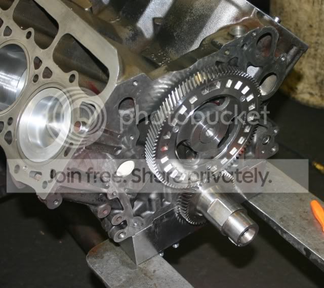

but seriously I have 2 6.5 's with the gear sets one has 630,00 (set installed@200,000)the other has 300,000 (installed at 190,000) and I've had no issues and I have a buddy herein AK that builds 6.5's for marine applications and some trucks and no engine leaves his shop with a chain, ( not sure what he'll do if there not available anymore)

Gear to gear would require a cam that was reverse ground , because gear to gear would make the cam spin backwards
