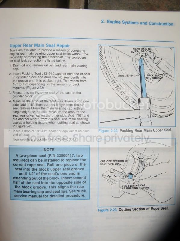

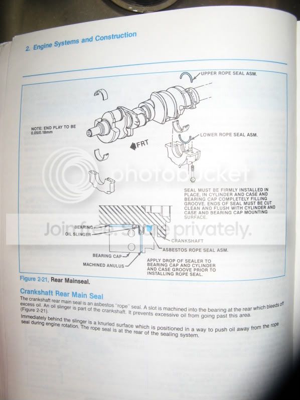

There is a two piece seal that goes in a groove in the rearmost main cap and the block above that main cap. You need a small wooden dowel to push the old upper seal out of the block, and to push the new seal half back into the upper groove. The lower half of the seal just drops into the removed main cap. A very thin line of RTV along the part line from the seal half's out to the pan gasket and you're good to go.
The rear main seal rides on the the end of the crankshaft itself just behind the last main bearing
This talks about an asbestos rope seal, but I don't know if that is even available anymore. When I replaced mine all they had was a two piece rubber seal. The rubber seal has two 'lips' raised up that ride on the polished end of the crank. I put a slight skim of oil on both halfs to keep the rubber from 'friction burning' at intial start-up.

Any truth that you can do this without dropping the pan? I heard someone say that on SteelSoldiers.com a while ago.
Ummm, no. The rear main cap is inside of said pan...so feel free to let that person know they are grossly mis-informed. ;)

As soon as I saw this, I remeber having seen it in the one 6.2 I took apart aobut 4 years ago. My leaks are solely oil pan gasket related. I think my pan is not flat along the surface though. I relpaced the gaskets today and it started lkeaking immediately from the front(engine not running) and down the left side.
