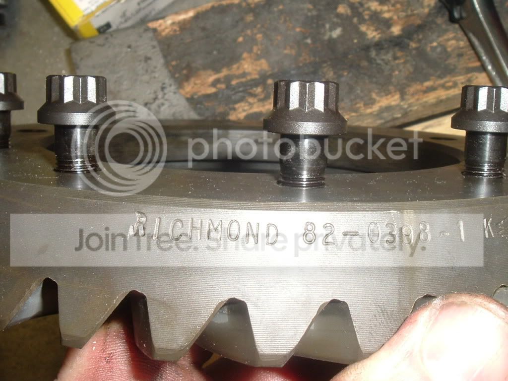

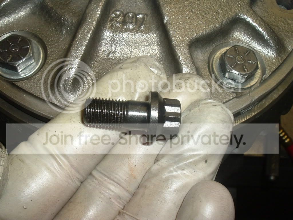

I bought a set of Richmond gears, and the bolt holes are about .120 shallower than the other sets of gears he uses. I had to get Richmond gears to get a 3.90 ratio. Other wise it was 3.70, 3.73, or 4.11. I had 4.11 and ran out of motor before the finish line. Went through on the revlimiter (6500) the last 100 ft or so. So the ARP ring gear bolts had to be turned down by .125 to not bottom out in the ring gear.
He has to counter bore the posi case to fit the ARP heads in, so they won't hit the housing.

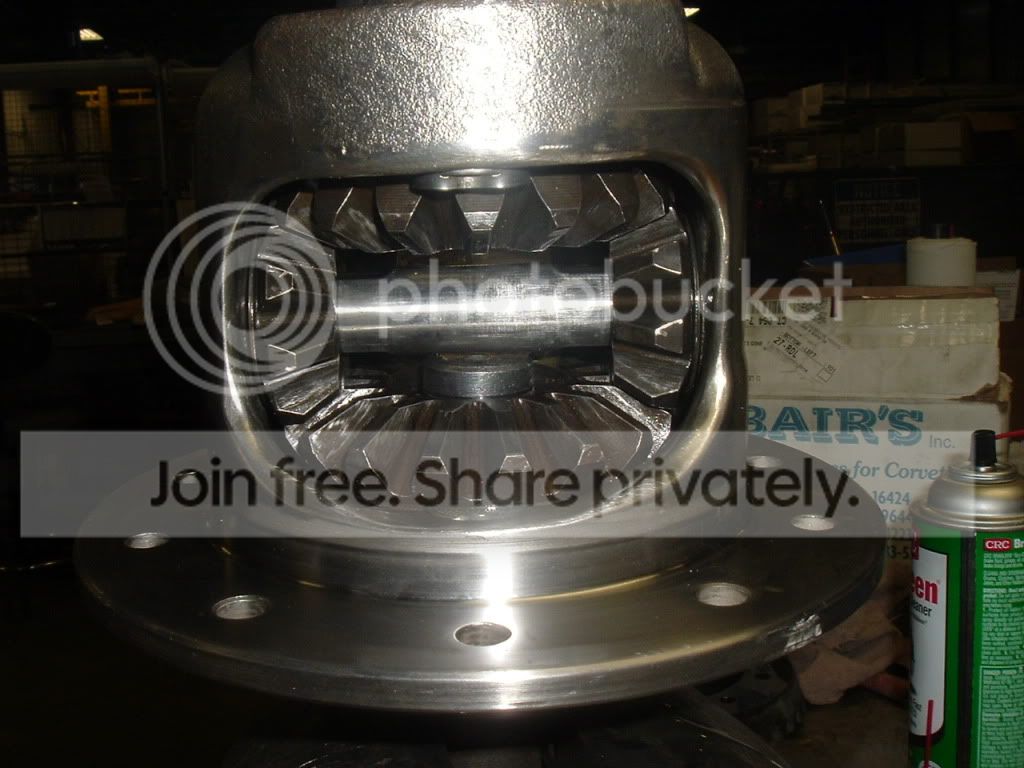

Can you tell what is missing from this posi setup?
The ARP ring gear bolts:
The bolts showing bottoming out in the ring gear by .100

Yep, the spring loaded plates that put pressure on the posi discs.
This setup has custom ground shims behind each clutch pack that leaves just a couple thousandths clearance in the packs.
He has had no chatter while cornering, and they always lock up for true posi traction, the way he builds them.

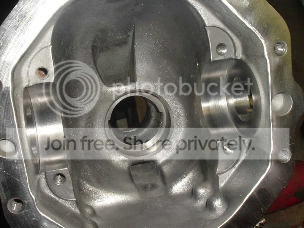

Deburred, and brushed housing

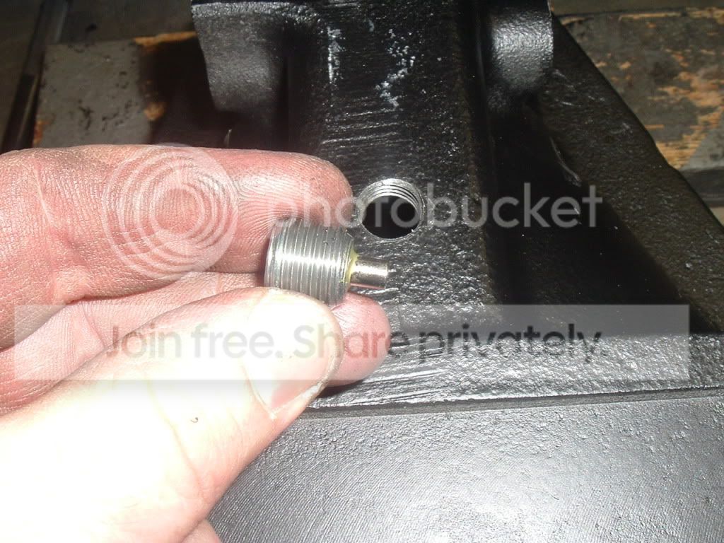

magnetic drain plug install. Older Corvettes have to have the rear suspension partially dis-assembled to drain the diff.

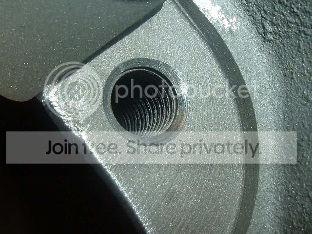

Right side cap threads cleaned up with a bottom tap, and countersunk,
There is a couple places in the country that do it this way.....meticulous attention to detail for sure....

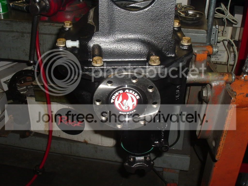

Here is a couple pics of the completed unit.

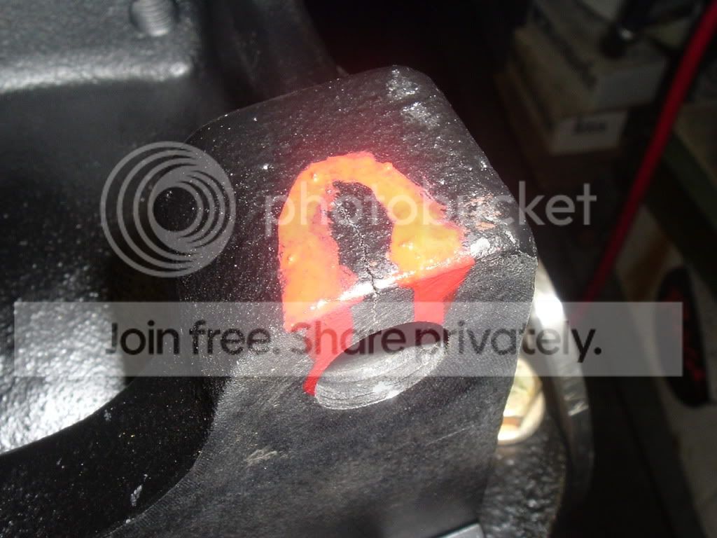

my rear diff cover (aftermarket) was cracked on one of the mounting ears for the strut rods, so I contacted the company (after 24 years) and they requested I send them the old one, and I just got my new one today. Unbelievable!!!
Old cover with crack highlighted:

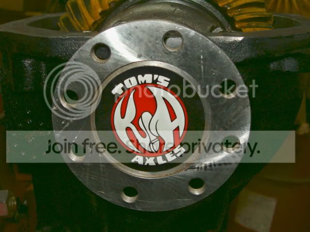

And this is just cool: Toms' Kick Ass axles:
