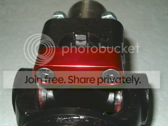

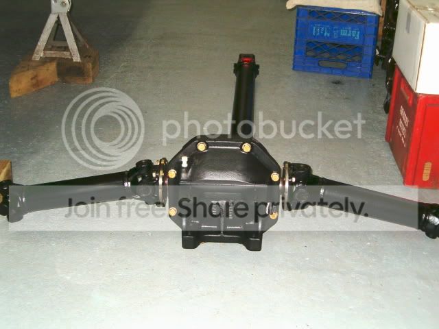

I got the rear driveline parts all together now, and painted, waiting on some adjustable strut rods now, and I can put it all in the car again.

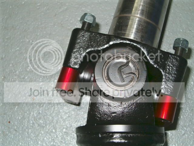

I got some Moroso Ujoint girdles for the driveshaft too
Way better than ubolts or especially straps:
I have those girdles on my Blazer rear end. Lost one of the little ears holding the cap in, did a trail fix, then finally got the girdles to get me by until I can swap in new axles.

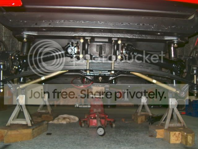

Finally got the rear diff back in the car, with the half-shafts, and suspension. I upgraded to adjustable strut rods also.

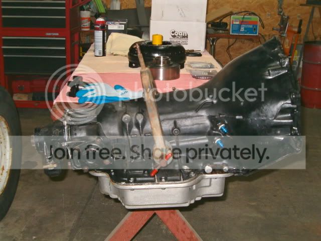

I put some parts in, and took others out:
I rebuilt this last year, and haven't run it yet, didn't even put fluid in it yet.

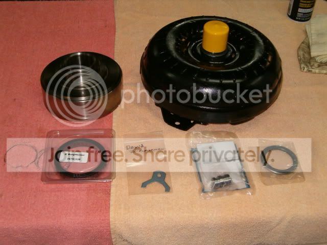

I wanted to change the torque convertor to a pro-street unit with a higher stall to it, and also decided to make a few upgrades to it as well.
The 34 element direct drum, and sprag, and a rear torrington bearing to replace the thrust washer. Also a new bushing for the pump.
