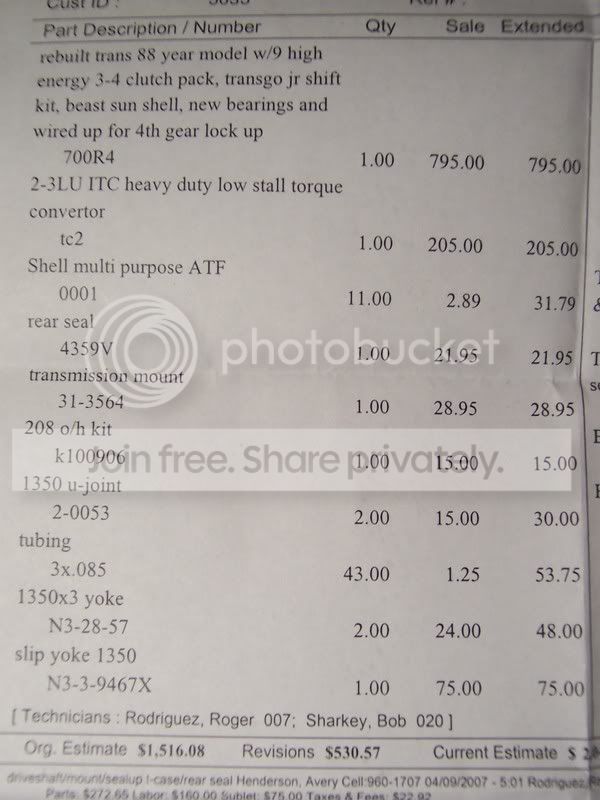

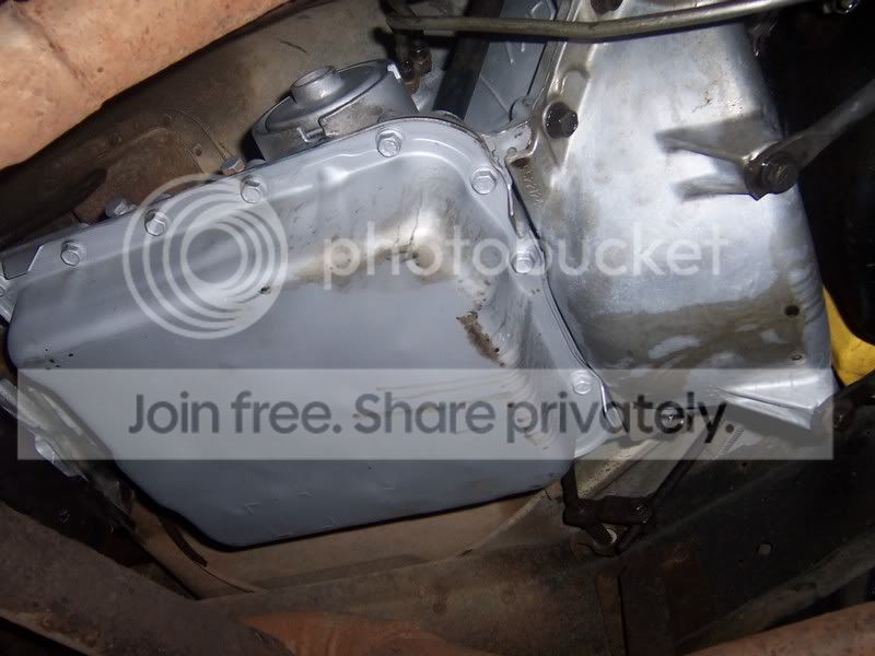

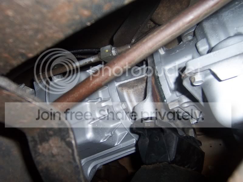

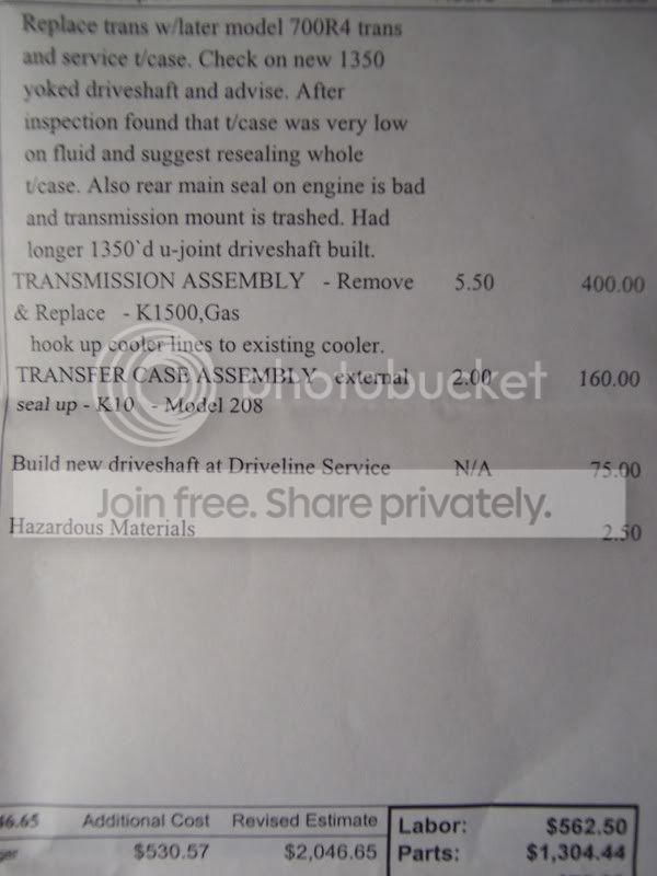

Just for kicks here are some pics...its not exactly thrilling but none the less I'm a picture kind of guy so here we go...
Here is the list of what he did (well not exactly all of it but the big stuff...he didn't charge me for the new TV cable plate, new plug wires, bolts, etc.)

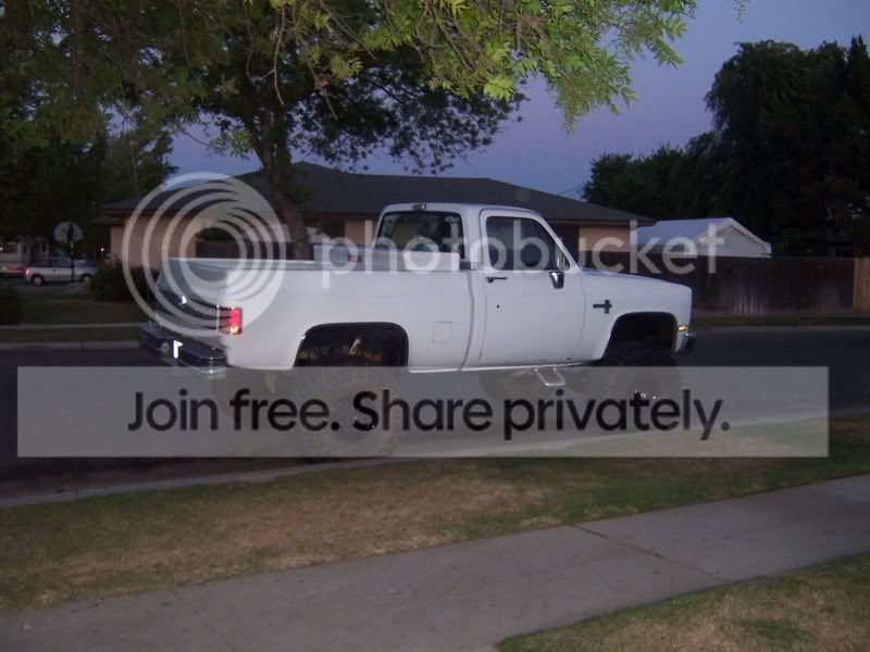

Here she is back in front of the house safe and sound :)

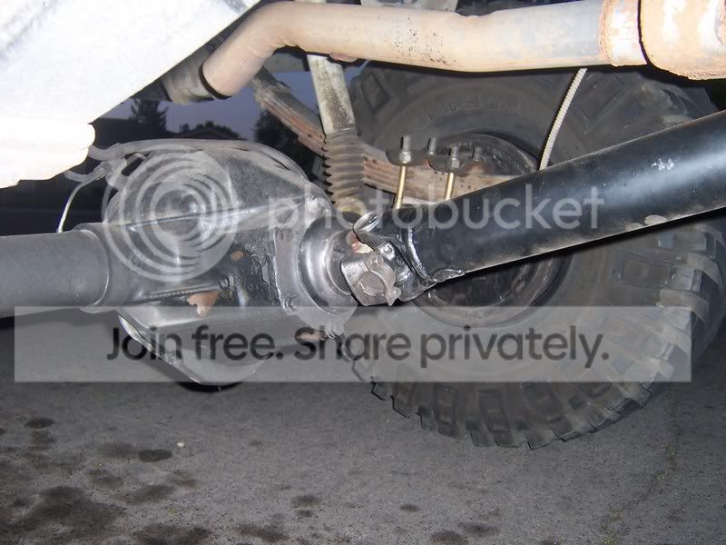

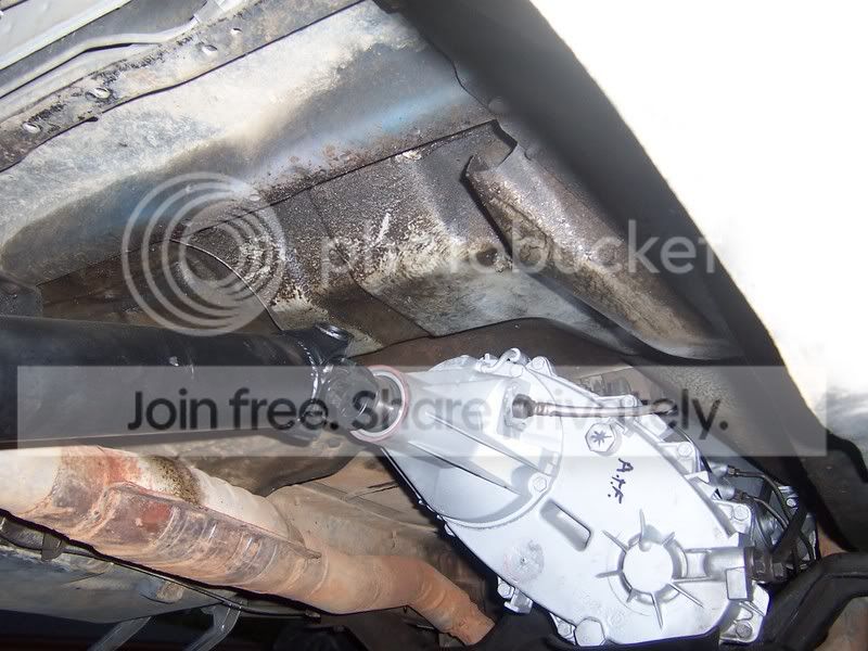

here's a shot of the new driveshaft...they did a great job...its balanced perfectly and is the perfect length...
Here are two pics of the rebuilt transfer case and the new shaft...notice they also replaced the old slip yoke with a new one that has 1350 ears so the new d-shaft is 1350 throughout...
He replaced my old transmission mounts and replaced some hardware that was missing :(
Oh and I finally found where my oil leak was coming from, at least partly. The back of the oil pan...so I'll need to drop the pan and see if the one piece felpro seal I put on was crooked or munched when I tightened down the bolts. BUT the oil leak is basically gone so I know the majority of it was from the rear main but none the less I'll take care of this asap.

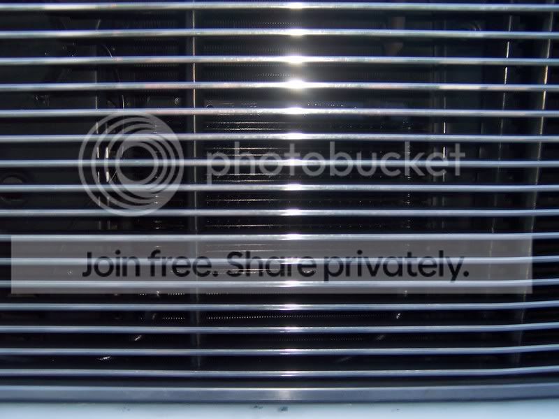

I should have taken a pic of the tranny cooler before I put the front end back together but I forgot so you'll have to use your imagination for what you can't see in these :)

First off, let me congratulate you and say I'm glad your happy. I don't know how you do it, but 6K views on a 700R4 is a record! Glad the drive shaft turned out the way you wanted. Take care of her while she still has those gears. Shop around and get the 5.13's. You'll be so much happier!
Now, for the possible bad. Is it just me, or the pic? Your truck looks like she's leaning starboard. I'd check your body mounts just to be sure.
Manny
lets go with all of the above...the street slopes towards the gutter (obviously :)), I'm standing and holding the camera straight and the springs/bushings are sort of goofy. :)
It looks worse than it is in that pic though...in person you can't even notice it.
At the risk of getting 12K views, :haha:, please describe what you mean as "sort of goofy?" If they are bad or damaged, that isn't good and you should address it as needed.
Manny
sort of goofy as in they aren't cracked/broken or anything like that but they probably need to be replaced for good measure b/c the truck does have a slight slant to one side and I don't know if its b/c of messed up shocks (bent shaft on one), bad bushings in the springs or sagging springs (that'd be my guess).

Avery,
Shocks on a leaf spring truck will not cause a list. Bad bushings in the spring packs will! That is a major safety hazard. If the bushings are destroyed or damaged, that is placing the load unequally on the bolt that keeps the spring in the shackle. That will bend the bolt, weaken it and in time, it could shear. Definitely not good.
Don't take it as if I'm raining on your parade. I'm proud of you for what you have done. Your rig is coming out way ahead and I want you to be happy. It's just more important for me to see you safe. Safe for others, safe for you. All I'm asking is that you make a good visual inspection of your trucks body mount/suspension system and try and find the problem. Once detected, that will help you to determine the fix.
Can't wait to see you get the 5.13's in and really be able to hit the juice and set the ponies free.
Manny
Hey Avery,
Check and make sure it's not your body mounts first... the body actually looks kinda crooked compared to the tires, which the problem would still need to be addressed but maybe that will keep this from turning into a spring pin type situation...
Just for my own education, is that pinion angle correct? It looks pretty well straight, 0-1 degrees, compared to the t case. Optical illusion?
why didnt they replace the rear main when they had the tranny out? thats a 5 dollar part, and there was a $21.95 rear seal on the receipt, was that it? do you get any vibes with the shaft like that? i did. so i got a cv shaft, have yet to put it in though.
