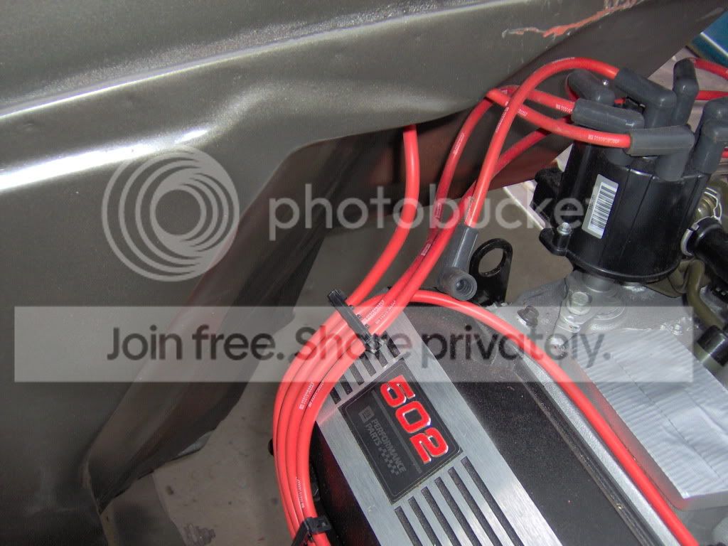

I think it could stand to move forward, the engine is buried in there a bit much. I don't think you could put a transmission on there where it currently sits.
I have marked the holes to move the engine forward one inch and will begin completely re-designing the firewall/trans tunnel. Anyone who can keep their factory heater and manual transmission with a 502 between the rails is a genius, after what I saw yesterday I would have thought it nearly impossible.

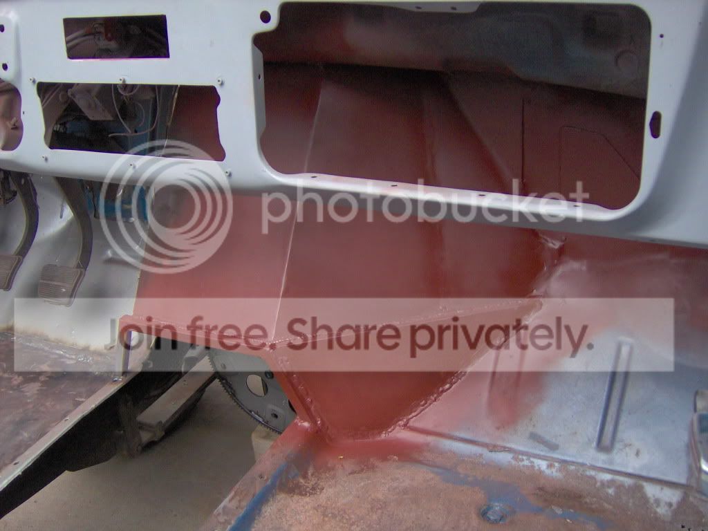

I will have pics by tomorrow, my decision was to remake the entire center of the firewall and leave the engine where it was. My front drive shaft length wasn't as much of a consideration if I had moved it forward due to the Atlas4sp making the front shaft longer as it was. I made enough room redoing the firewall so that I would not have to move the engine.

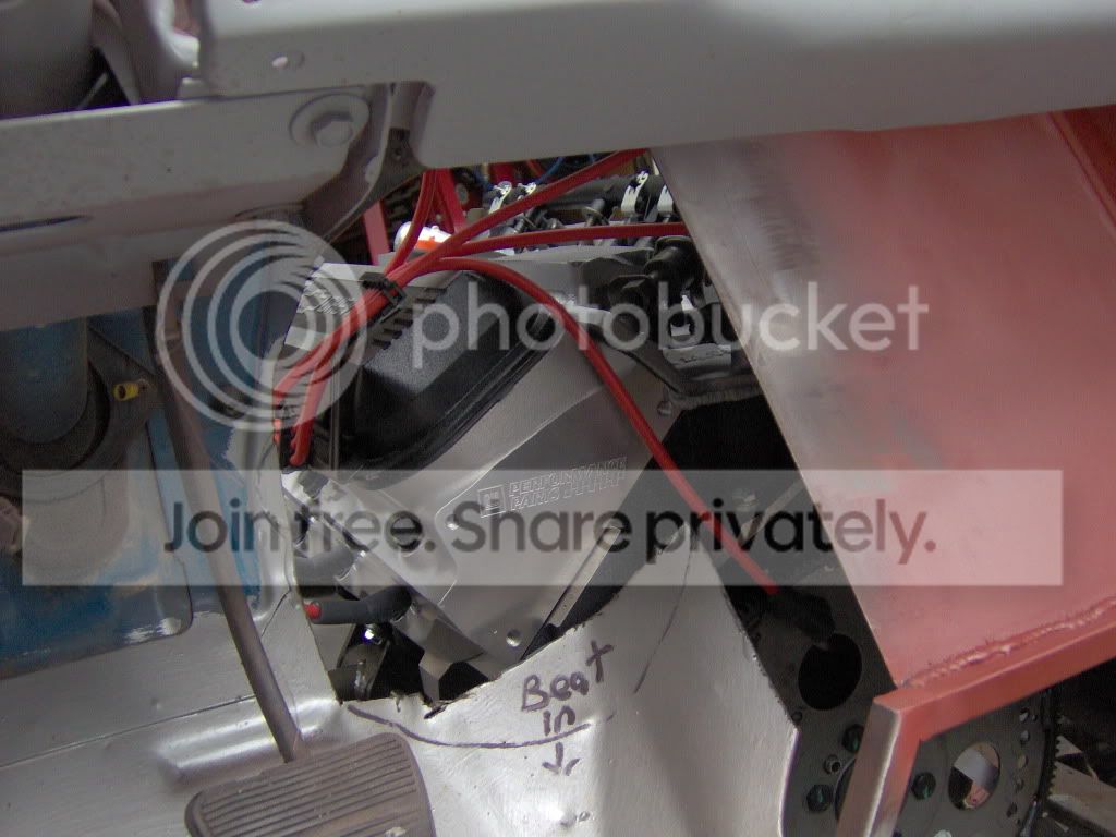

Thanks for the solid tech, the numbers along with my pictures tell the tale. The engine is HUGE in between those rails, Chevy definitely never intended for a big block to be in between those confines. With the right tools and a little time and patience, it will live there one day soon.

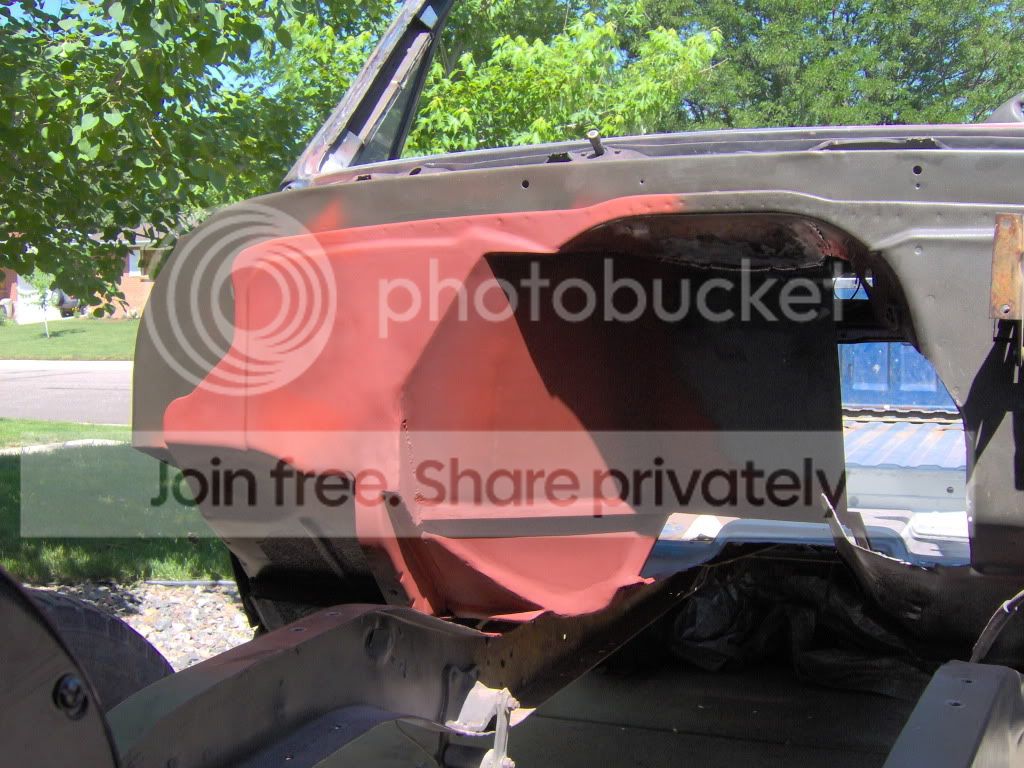

I spent some time re-doing the firewall the last couple of days.
I won't even think about doing the drivers side without the engine back in place. I will build the drivers side around the engine where it sits.

That info. is much appreciated. I will sill be moving the engine forward also just a little bit, I think it will be helpful with my drive line situation caused by the Atlas4SP.

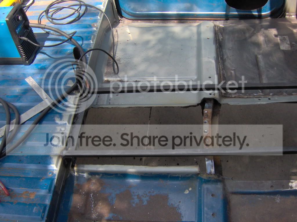

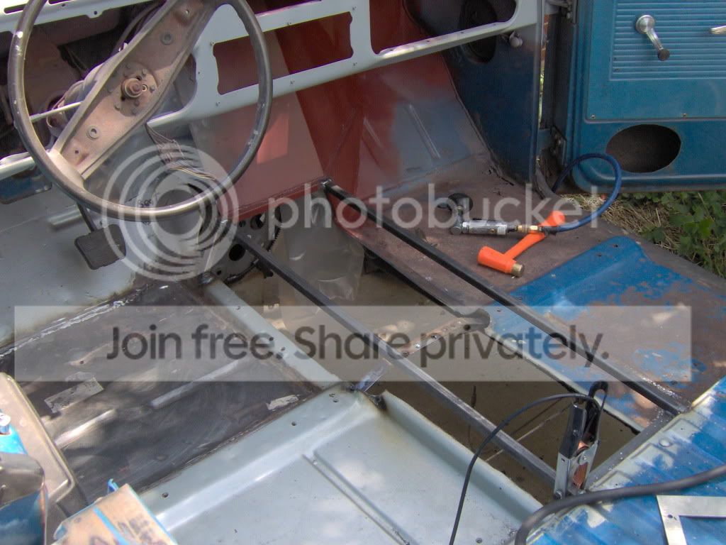

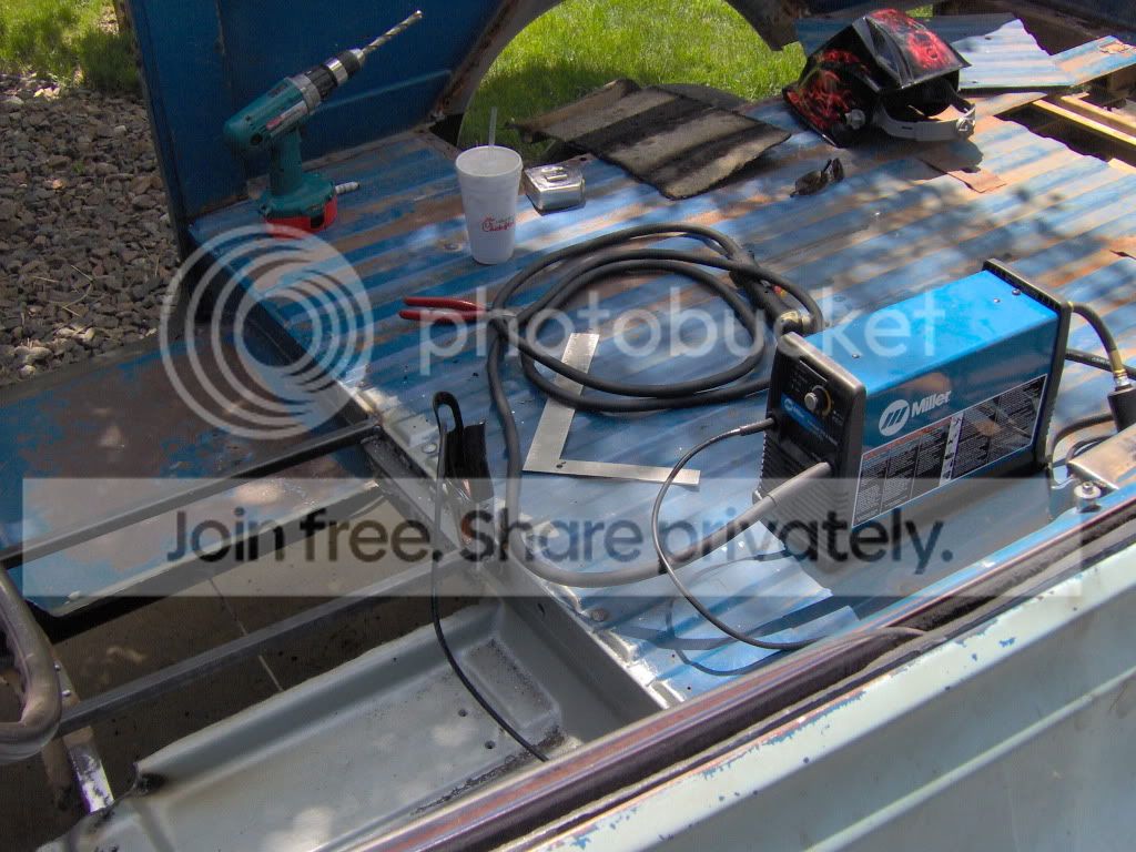

Spent part of today working on the trans tunnel and cutting out the start of where my transfer case will sit. The plasma cutter was the MVP of the day.
