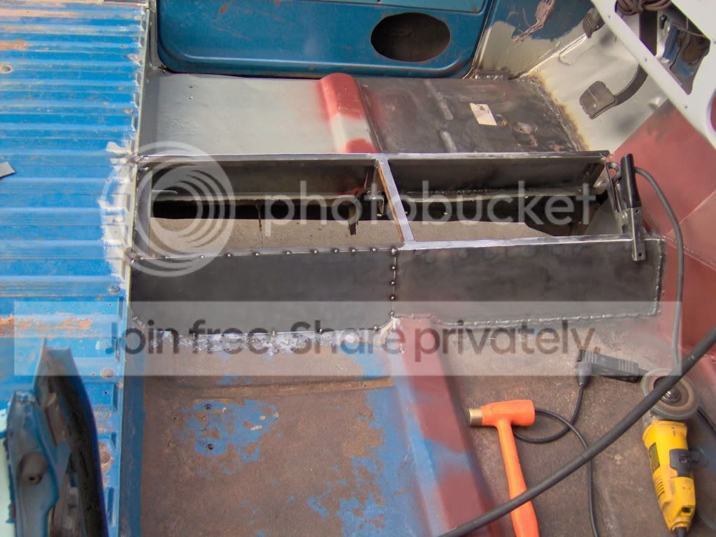

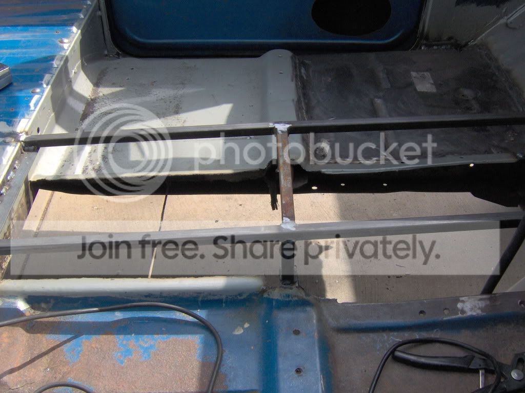

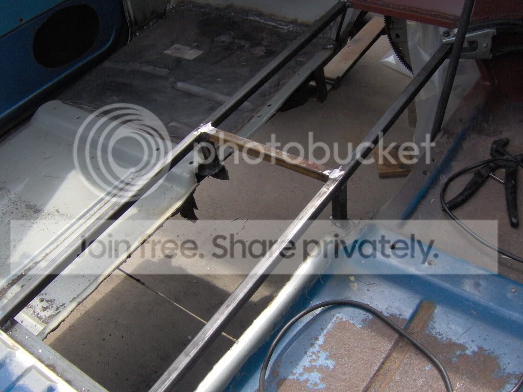

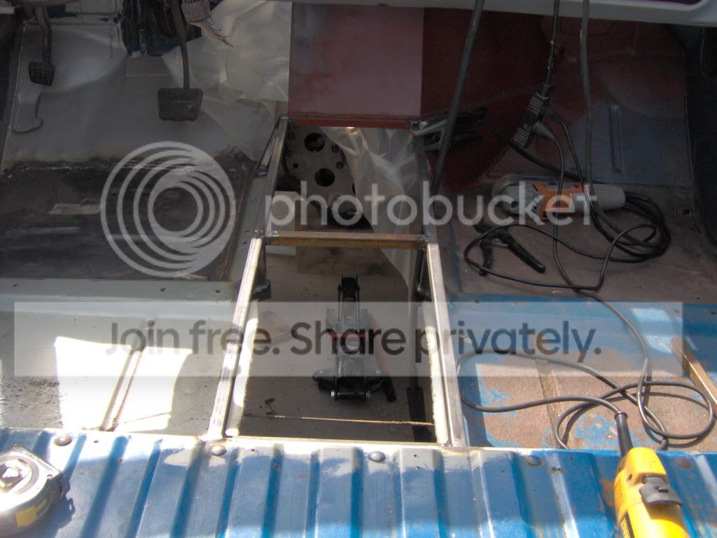

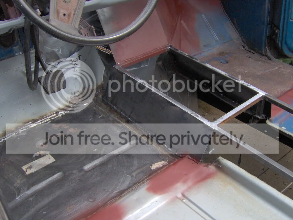

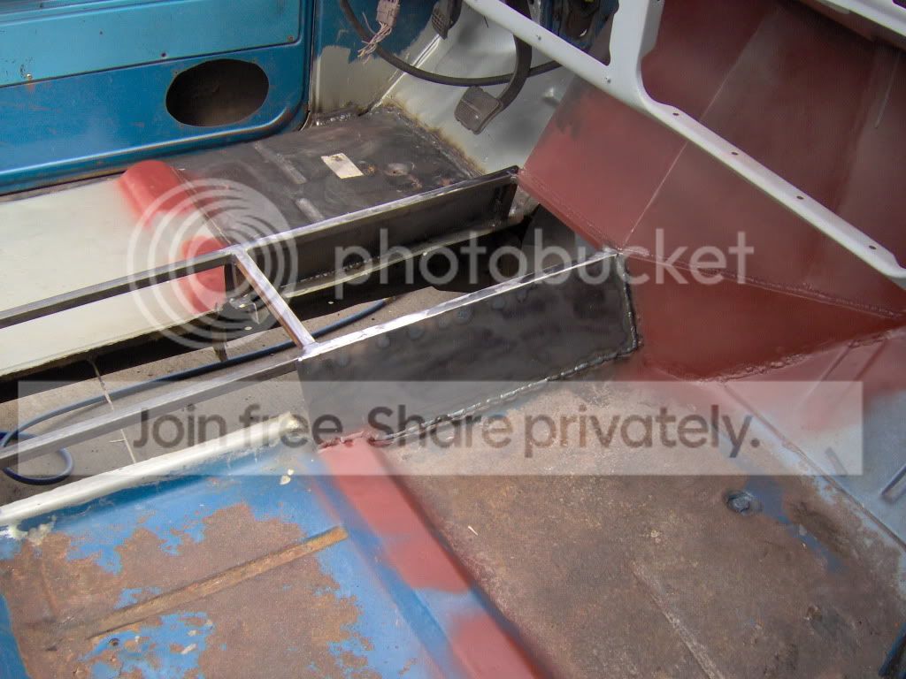

I welded in the three pieces that allowed me to cut the floor support out and make room for the transfer case to ride in the cab with us.

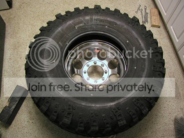

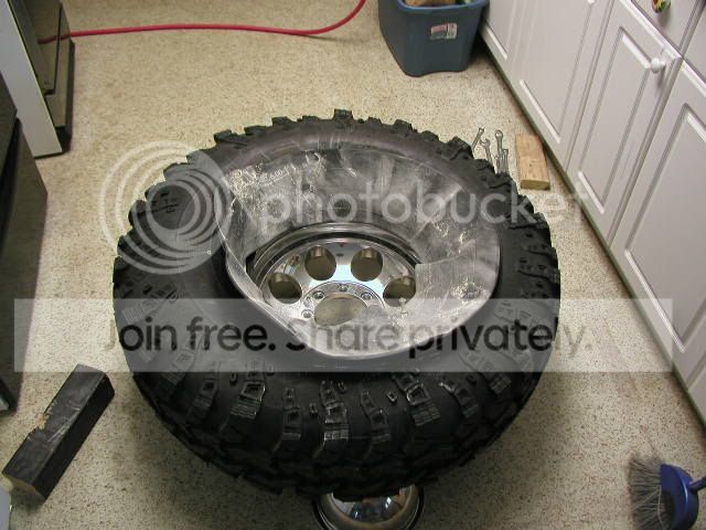

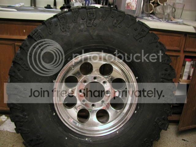

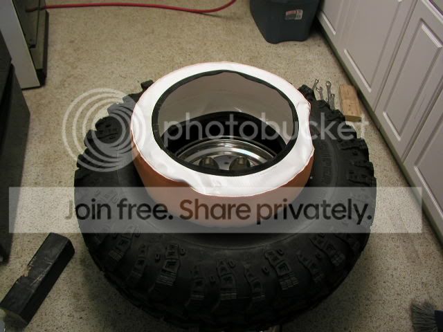

I installed my Staun beadlocks today. After reading about them I was dreading the install. It turned out to be really easy. I did four of them in about three hours.

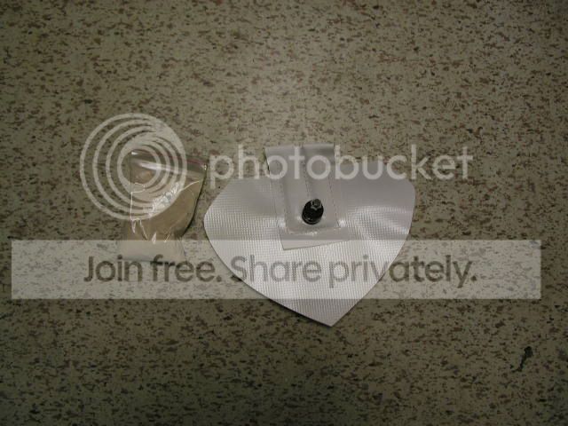

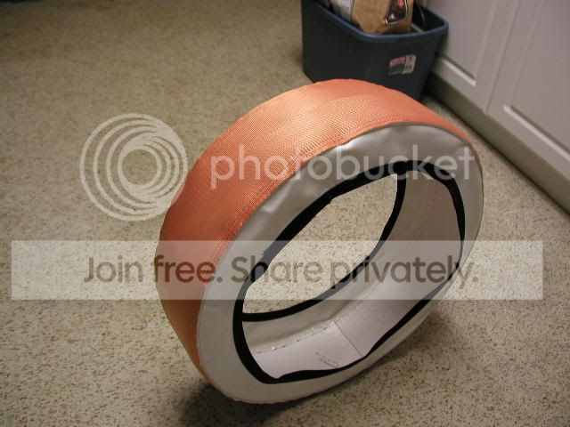

The Stauns are composed of three parts:
casing

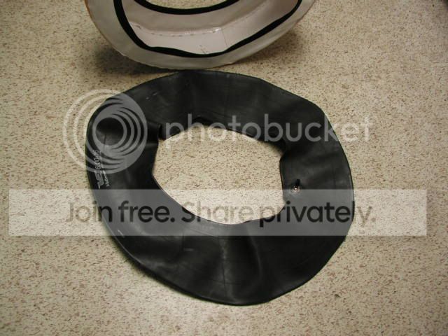

tire tube (from a motorcycle, chopper I think)
air channel/valve stem replacement
You have to drill a hole in your rim for the inner tube valve stem.

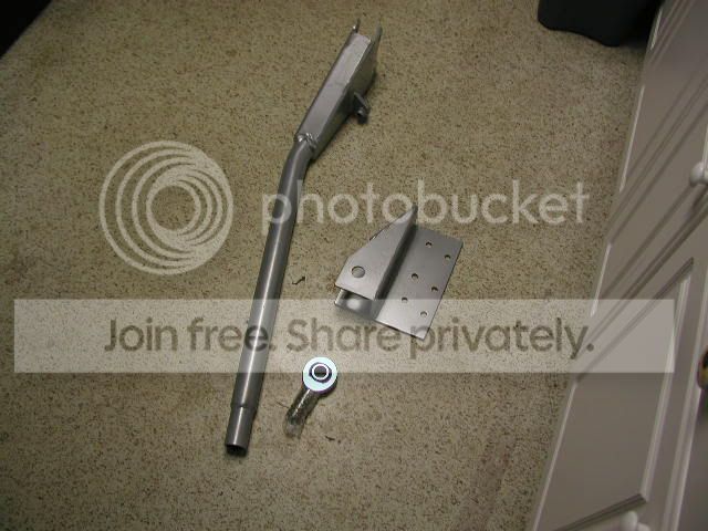

My radius arm showed up from Cage Offroad. Cage builds a pretty beefy product with 2" tube, huge heim and a super size frame side bracket.
