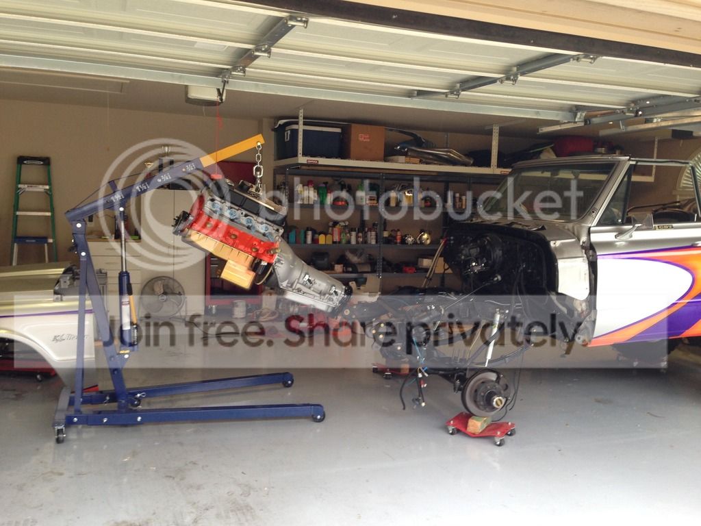

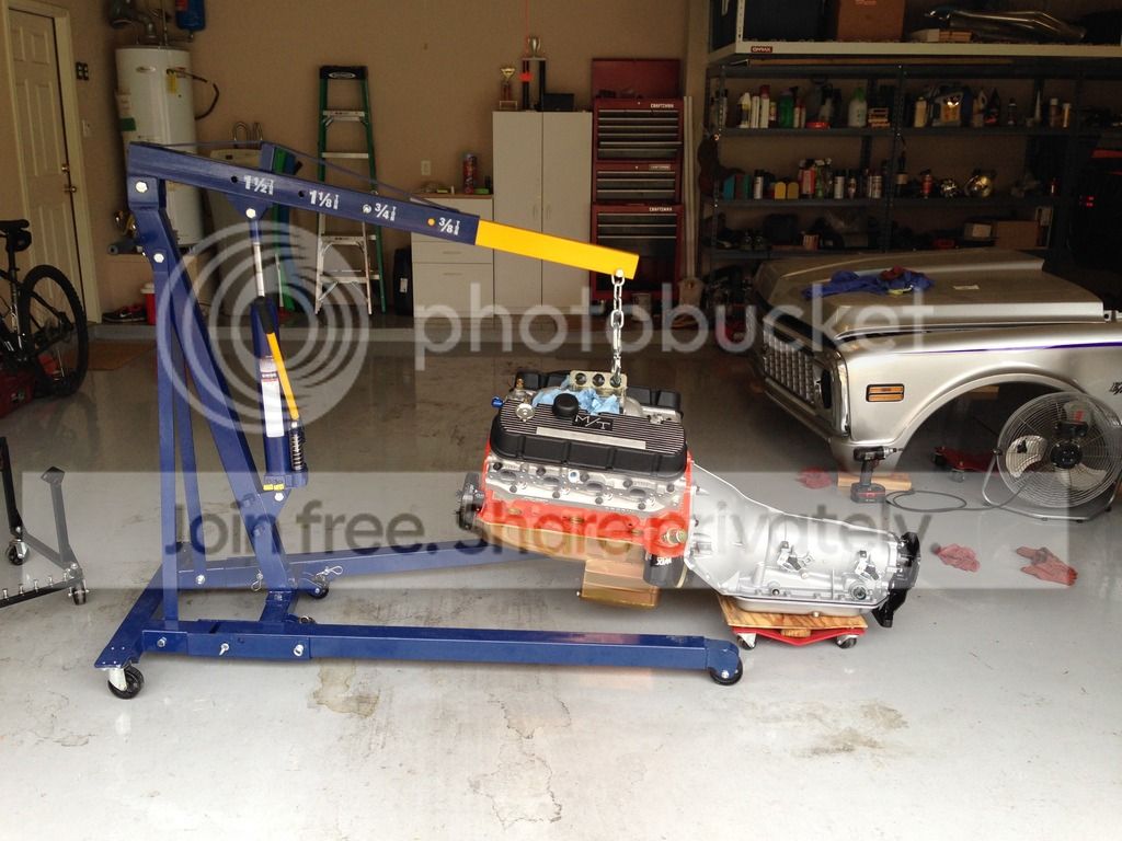

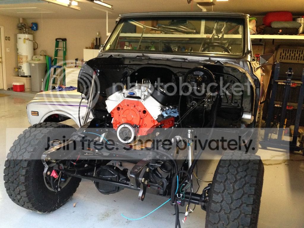

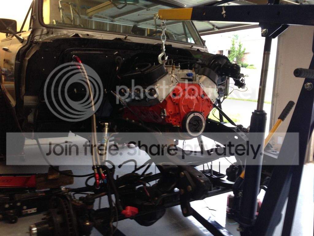

UPDATE 8/14/16 - Transplant surgery
So, this was gonna go down today...
....and then it started raining. So, I had to do some rearranging in the garage.
Almost there....
Done (and garage back to normal).

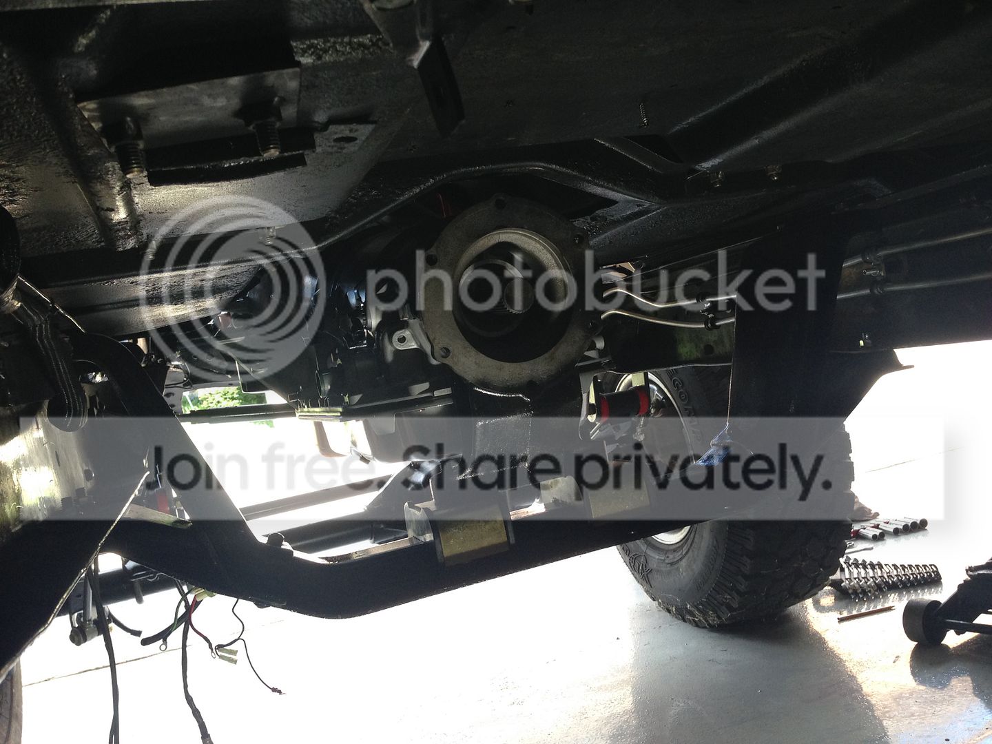

All in all, it went in smoothly. Valve covers still clear the firewall without issue. With the 4L80, the transmission crossmember will need to move back about 1.5" from the 700r4 setup.
Been busy doing a bunch of little things. I guess I coulda posted this sooner, but saved it all up.
Got the transmission crossmember moved

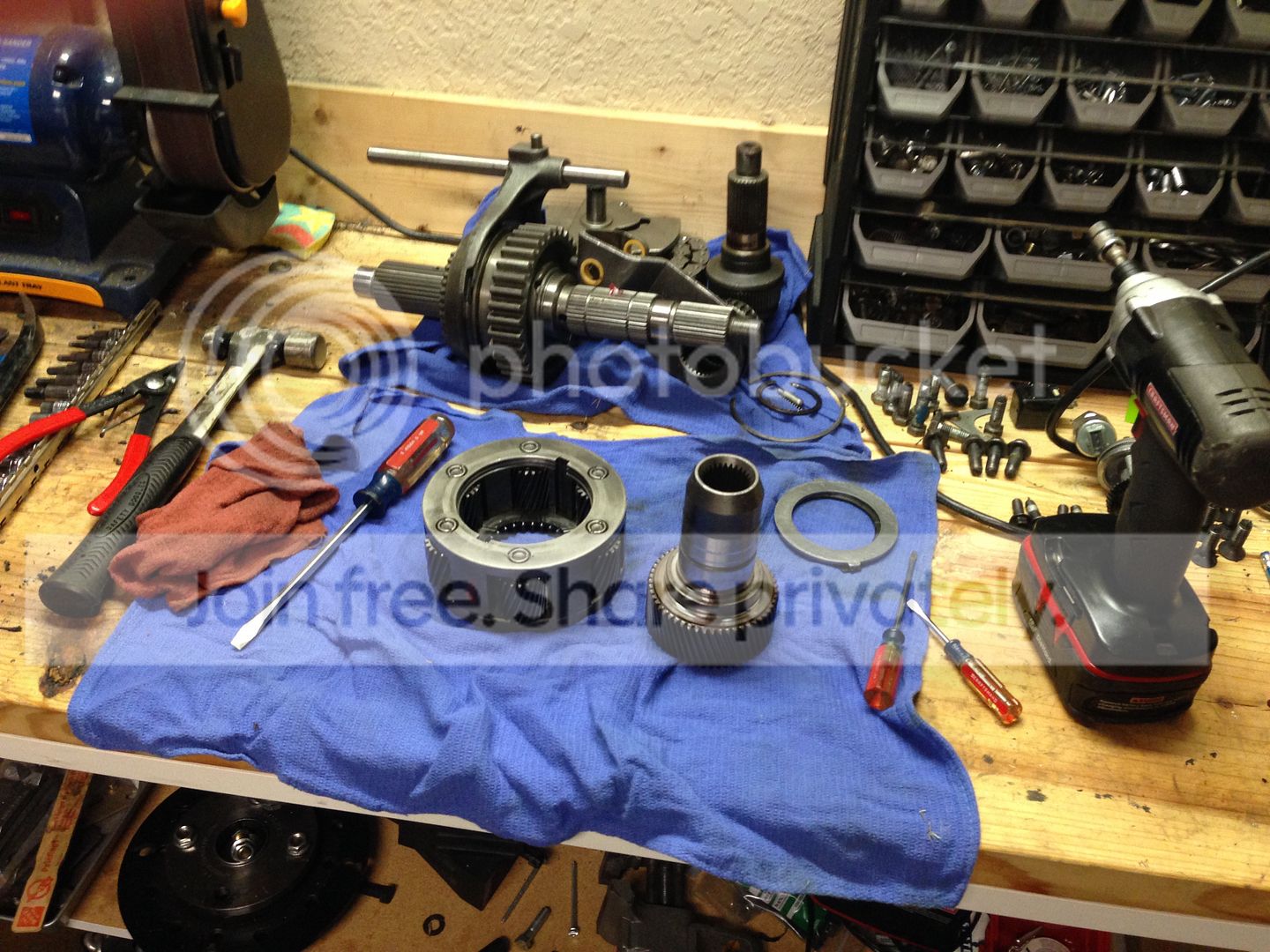

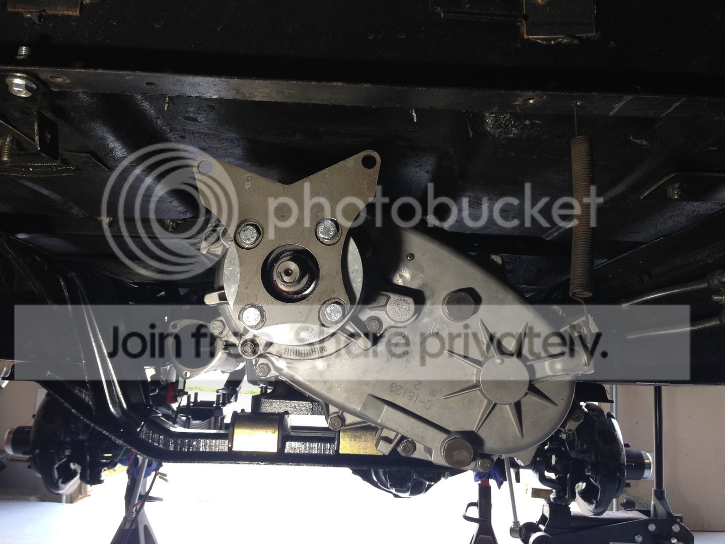

Blew apart the 241 to swap out the input shaft. Mind you, I'd just resealed this thing.
32 spline

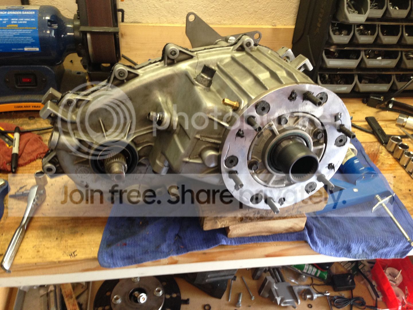

and got it hung

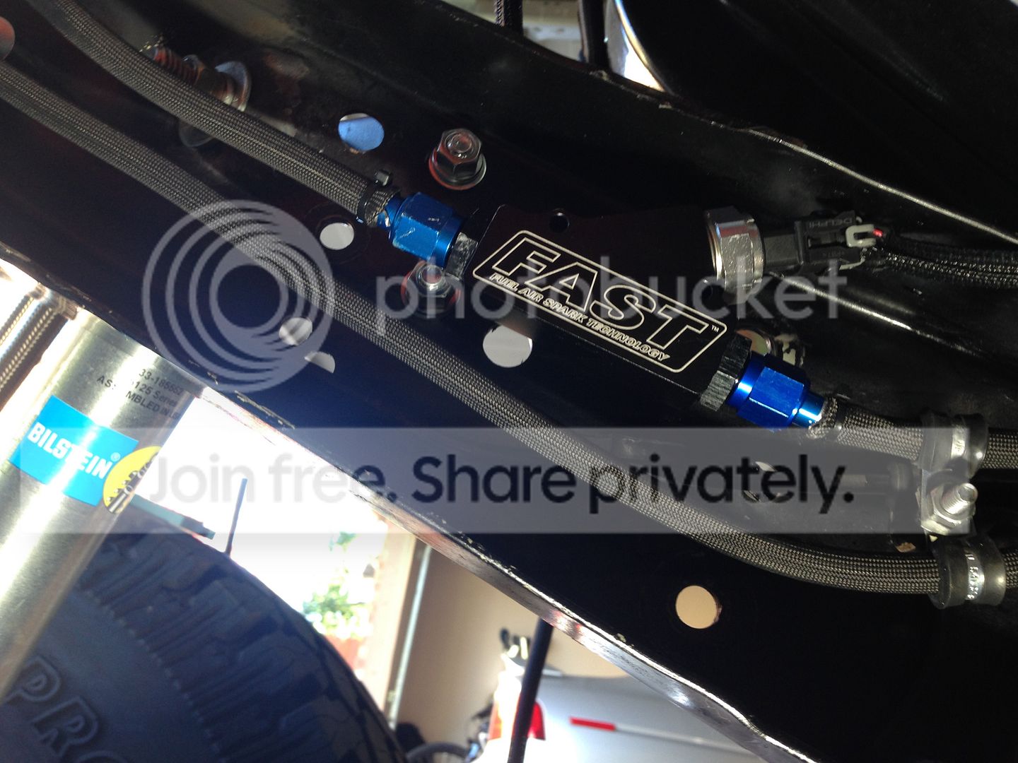

Ran some Hotrod Sleeve to the section of the fuel lines that run close to the headers. Supposed to shield 60% or so of the radiant heat

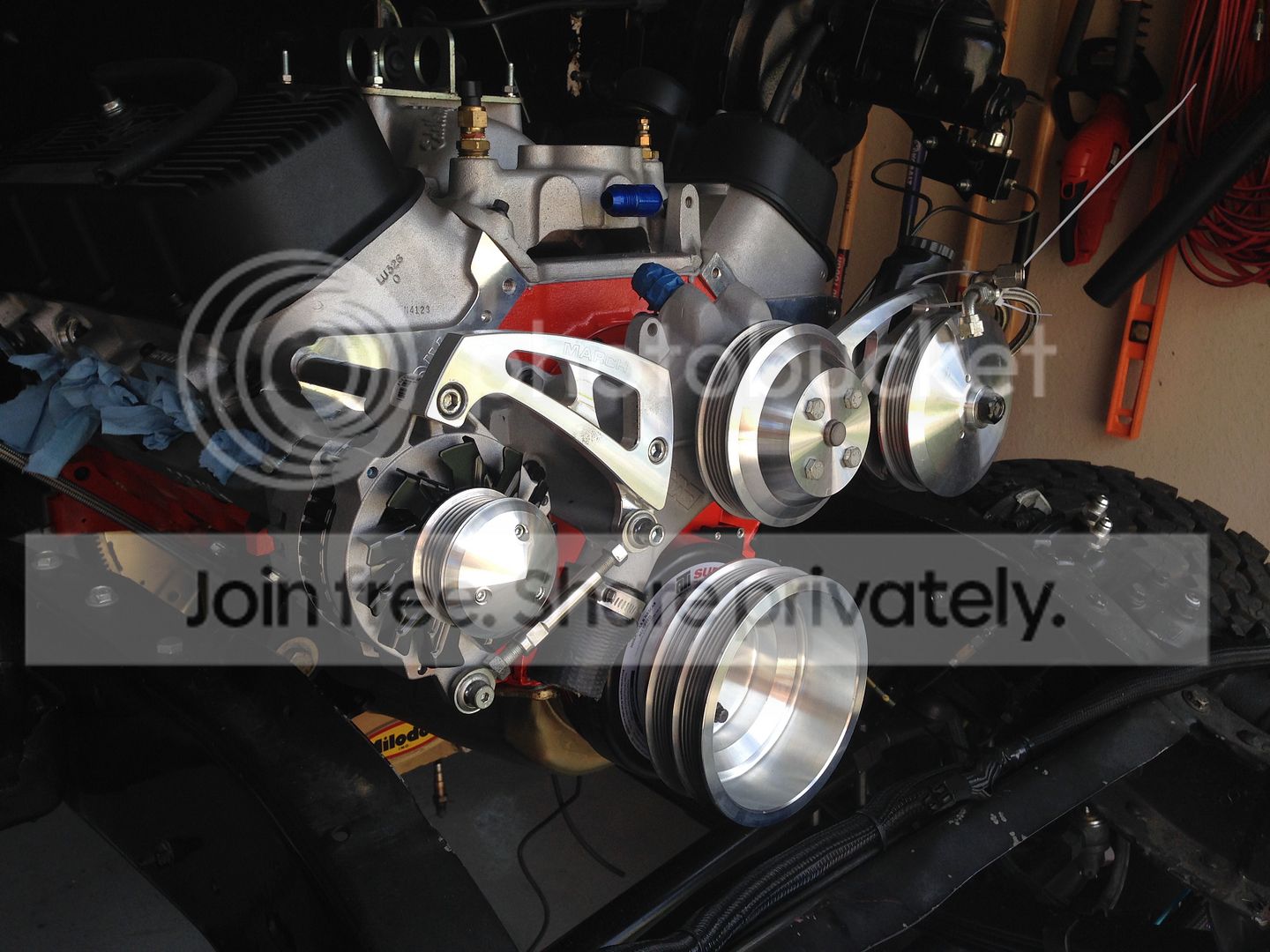

Added a 140 amp CS130 alternator and got all the engine accessories mounted

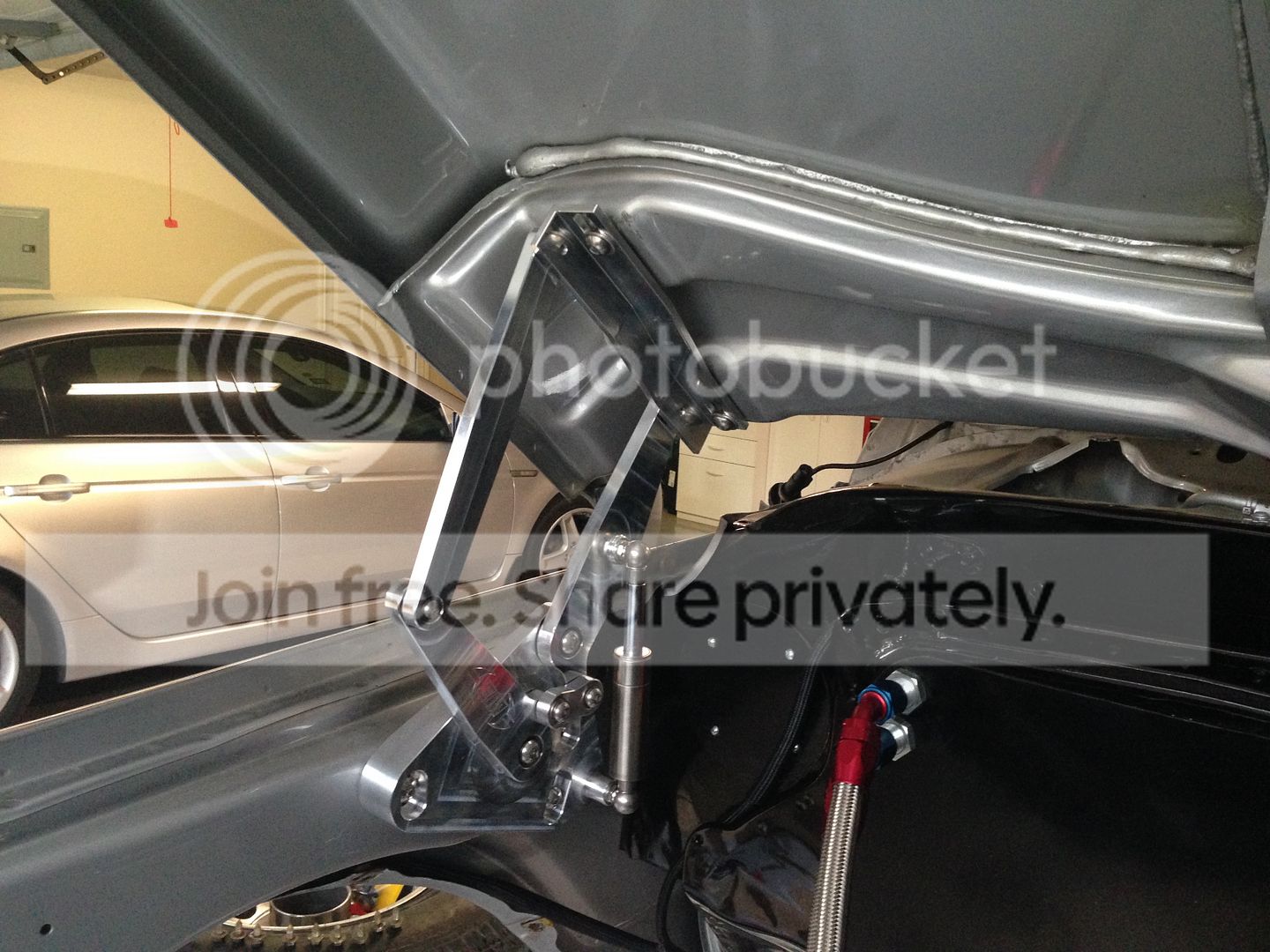

Wrangled up a few friends and put the front clip back on. Then put in some functional bling.
Realigning the hood and front clip are next. Also need to measure for both driveshafts since the drivetrain is longer. Was hoping the front would be ok, but it's too short. And the rear is too long.
32 spline
and got it hung
Added some Hotrod Sleeve to the section of the fuel lines that runs close to the headers. Supposed to shield 60% or so of the radiant heat

Wrangled up a few friends and put the front clip back on. Then added some functional bling.
Vendor for the hood hinges?
Wow dang! Looking good man. What's this hot rod sleeve you used? Is it just a sleeve for fuel line?
Hot Rod Sleeve by Heatshield Products: https://www.heatshieldproducts.com/hot-rod-sleeving
It's supposed to stretch over fittings, but wouldn't stretch enough to get over the tube nuts. That said, I was able to run the tube nuts over them. I found it by googling "heat shield fuel line". Comes in a bunch of diameters. It's kinda like the spark plug sleeves people use.

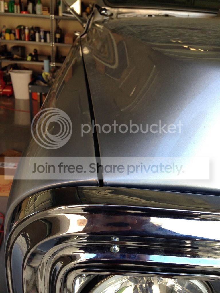

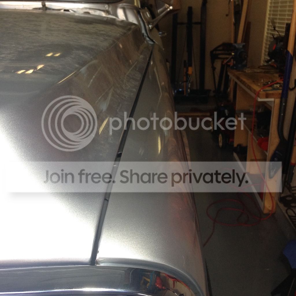

UPDATE 11/6/16 - Getting shifty - Before I get to the shifter fun, spent some time over the past few weeks working on the hood alignment after putting in the new hinges. Overall, came out really straight with nice lines. The passenger side is about 1/16" off at the firewall. It's about as good as it'll get. If I try to pull it out more, the fender to door alignment will be off.

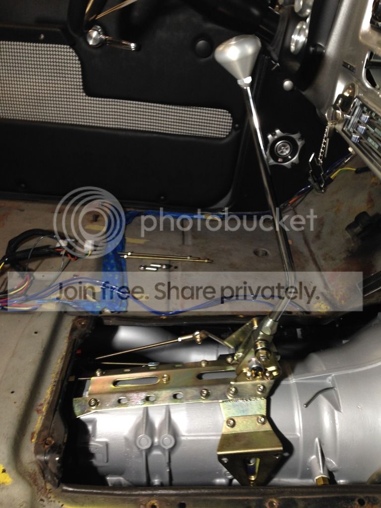

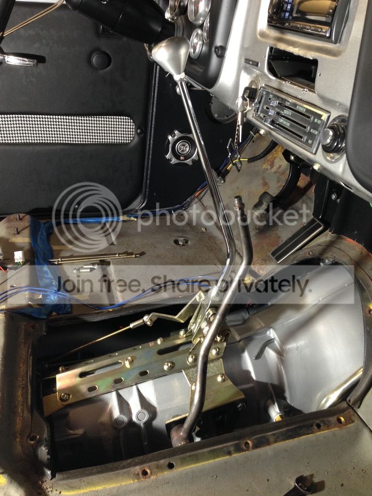

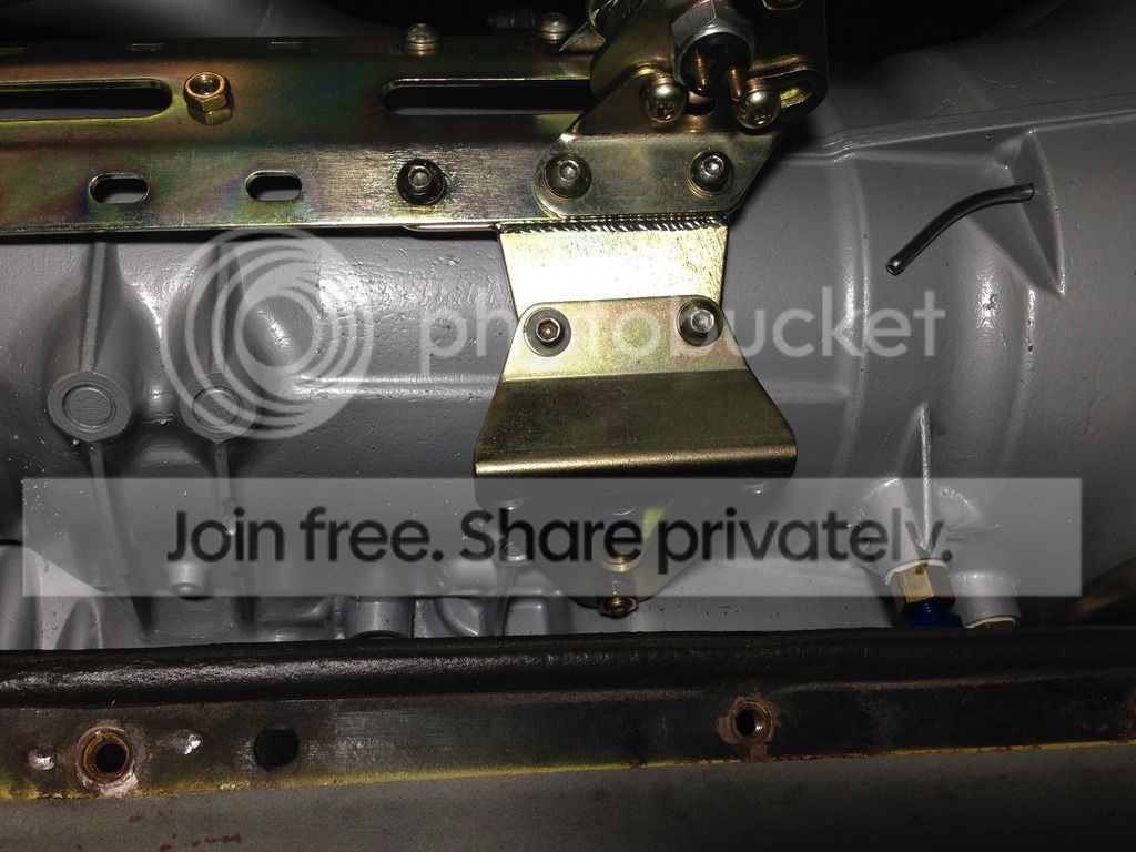

Onto the dual shifters... Got the parts in from Lokar and installed the 4L80 shifter. Pretty straightforward. However, to get the shifter to align with the hole I previously cut in the transmission hump, I had to run it in the frontmost position.
Now, since the shifter is all the way forward, the geometry for the transmission shift arm is all jacked up. Lokar makes a linkage kit to correct it and essentially creates a cantilever at the tailhousing.

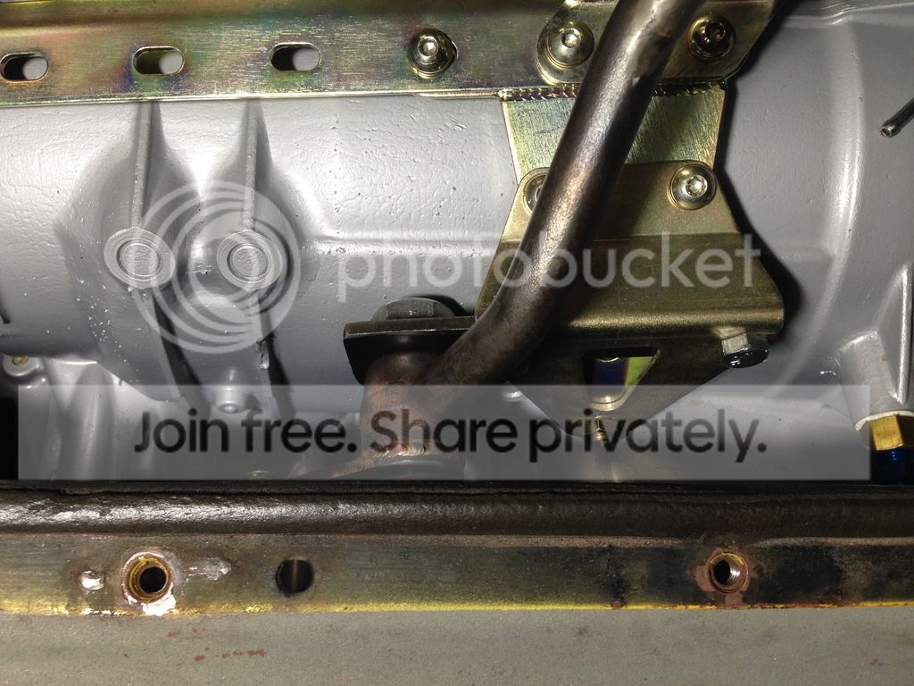

The tranny mount brackets come are set up to accommodate Lokar's handbrake mount

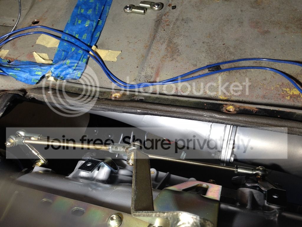

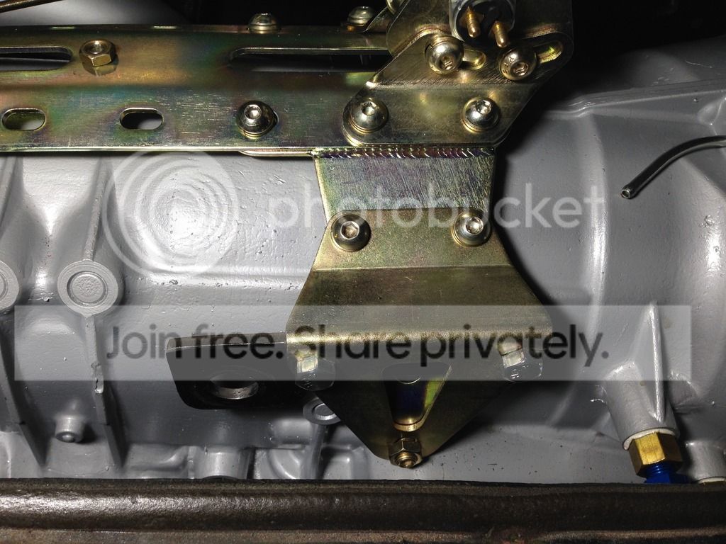

I repurposed it to mount the transfer case shifter. Spent some time with the grinder and came up with this bracket
Shifter mounted

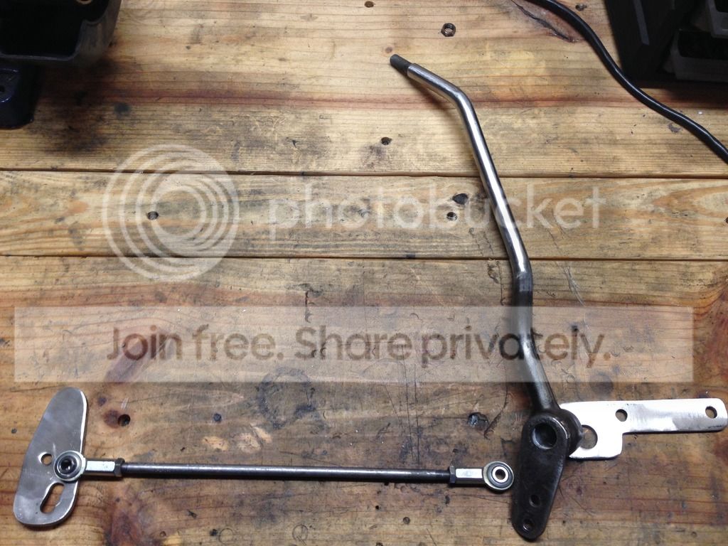

Here's the brackets, linkage rod, and converted 205 shifter that make it happen. Made a new transfer case arm in the process. Getting the slot cut right was a pain in the a$$.

Nice! I really like the transfer case shifter. way cleaner than what I have. I may need to copy that some day.
Nice work! You clocked your 241 up correct? How tight is your front driveshaft to the side of your tranny now?
