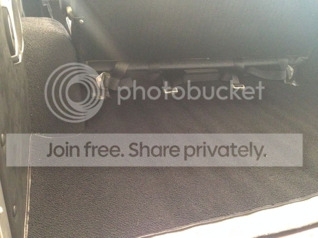

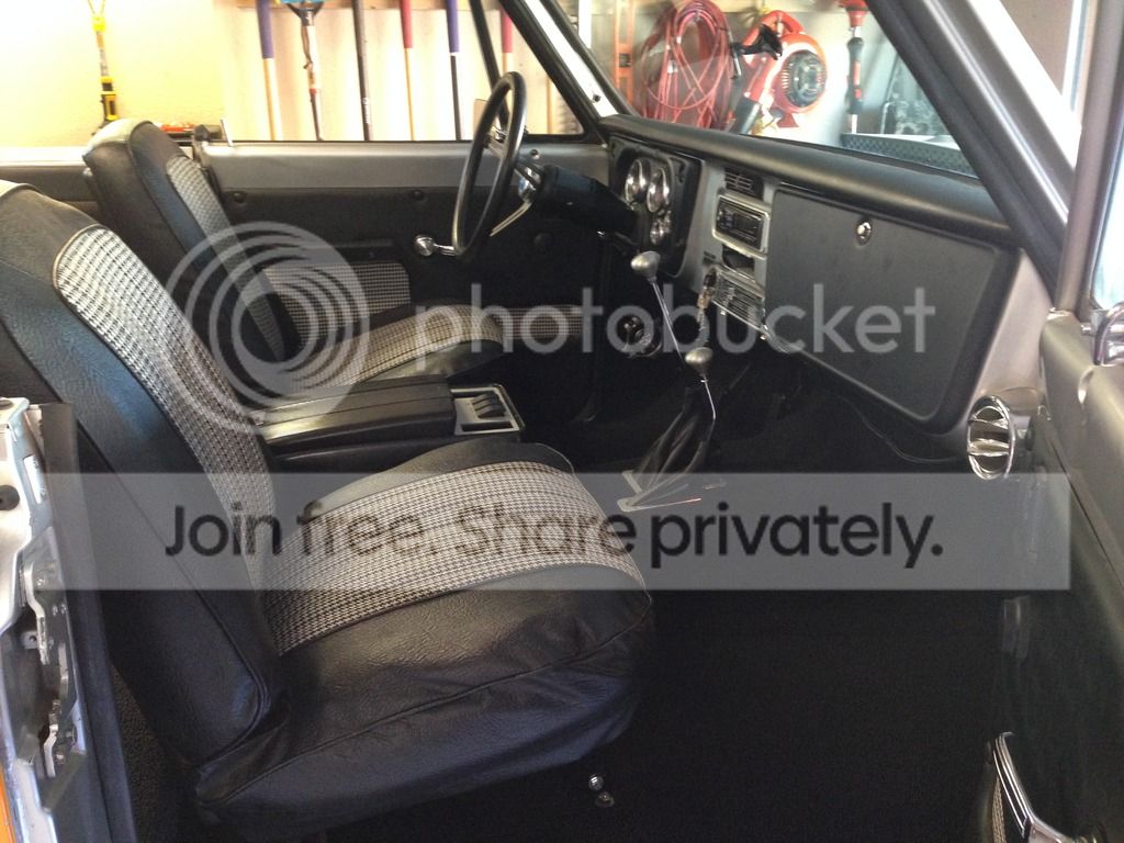

Bought a second new carpet set. First set was from Trim Parts... a "restoration" carpet. But, I discovered it needs carpet strips front and rear of the cargo area. Additionally, the front carpet isn't molded well in my opinion. I think it would fit well with adhesive, but I didn't feel good about spraying the front pan with glue. So...I bought a set from ACC through Stockinteriors.com. Much better fit, in my opinion. Got the rear carpet in and the rear set installed

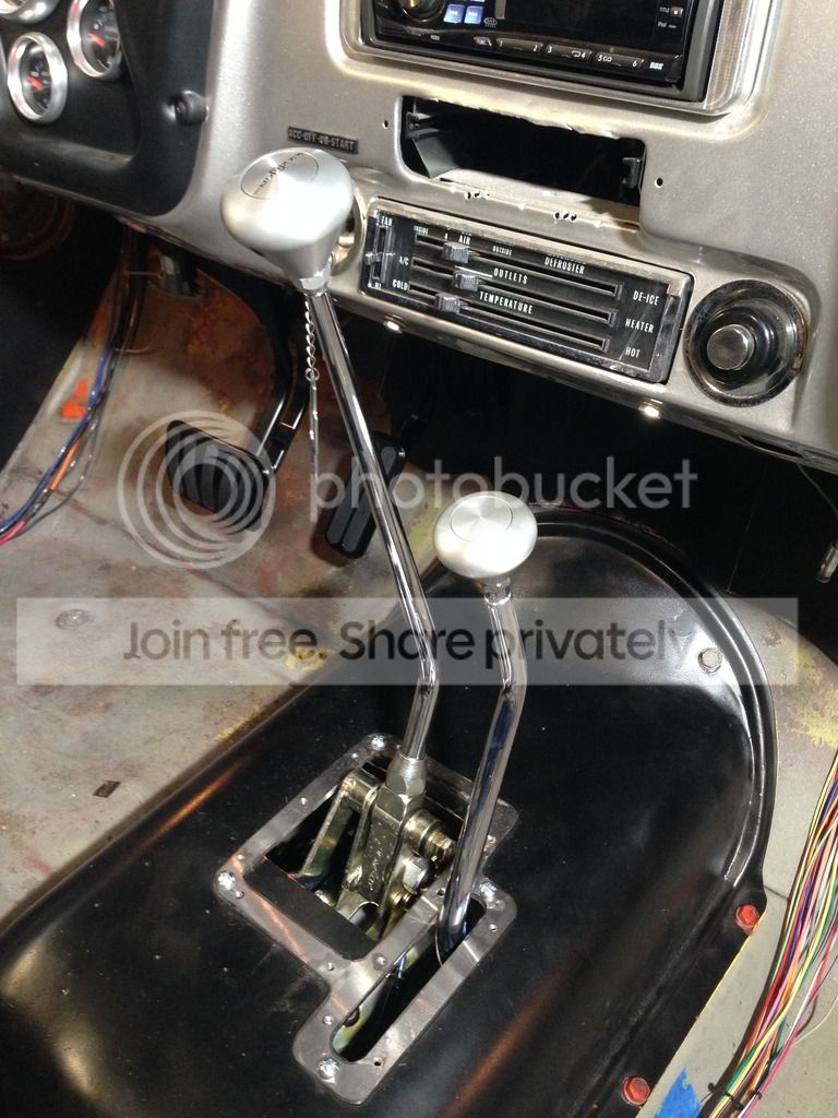

Trans hump installed and test fit the shifters. I used a plain Lokar knob for the xfer case shifter. Drilled and retapped it for the 205 shifter.

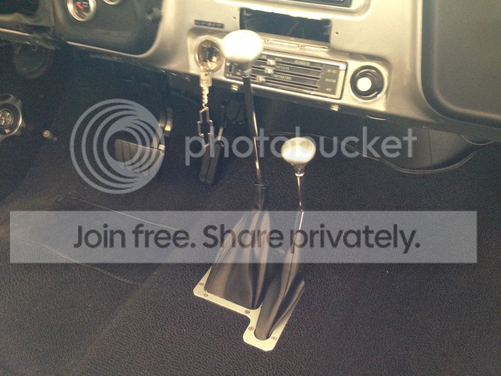

Front carpet installed, shifter bezel, and boots. Damn that came out nice. Super happy with this. Small details like the chrome and matching shifter angles while in park.
Seats and console in.

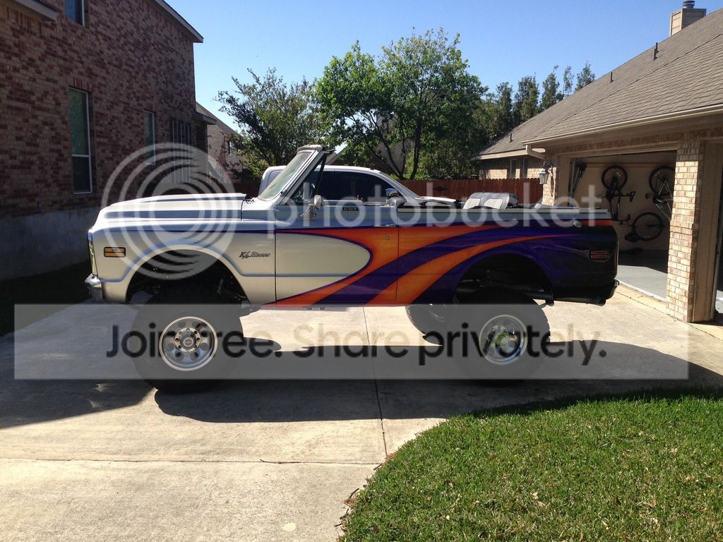

Pulled it into the sunlight for the first time in a year and a half

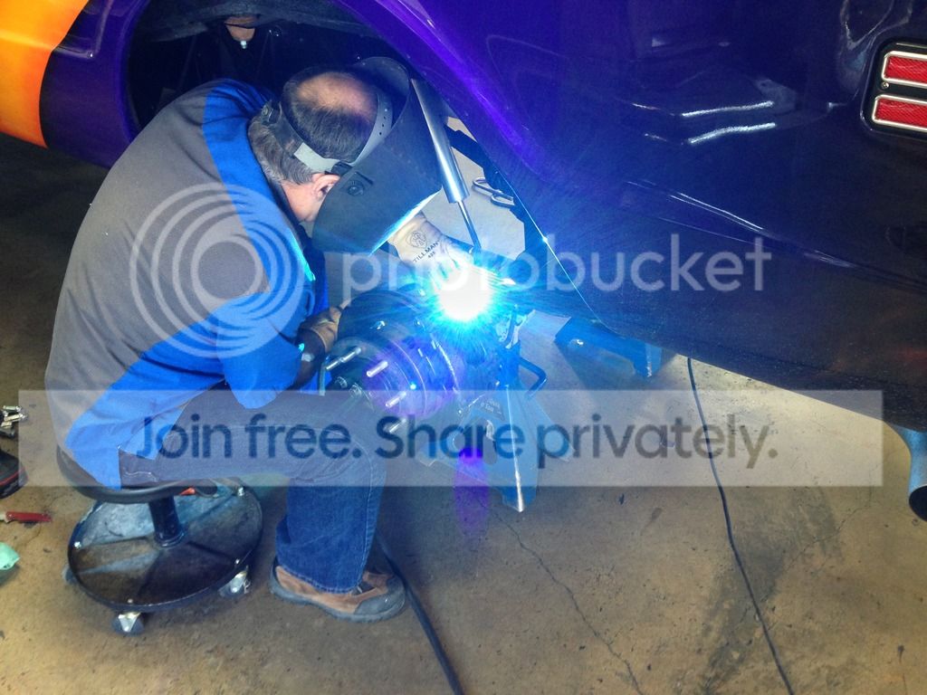

Mind you, at this point, the rear perches aren't welded. Drove it really slow to the shop to get that done. Yes, I still outsource my welding.

Was pleased w/ my ACC carpets also. Seemed to be well molded. Liked the shifter boots you got going on there. Need to figure something out for mine - kinda hacked looking right now.
I designed it and had it made by Front Panel Express. The transmission shifter dimensions match those of a Lokar bezel, but then integrated the transfer case shifter
Is that a local shop to you or did you measure it up and send them the dimensions? I ask because I really want to do the same for my shifter set up.
Not local. They're an online company that does electrical panels out of a variety of non-ferrous materials. They have software you download and design you panel.....sorta CAD-like, there's a CAD import function. When you order, it submits your design to them. I made it work for what I needed on the shifters. But, I also used them for the switch panel on the console...see post #554.

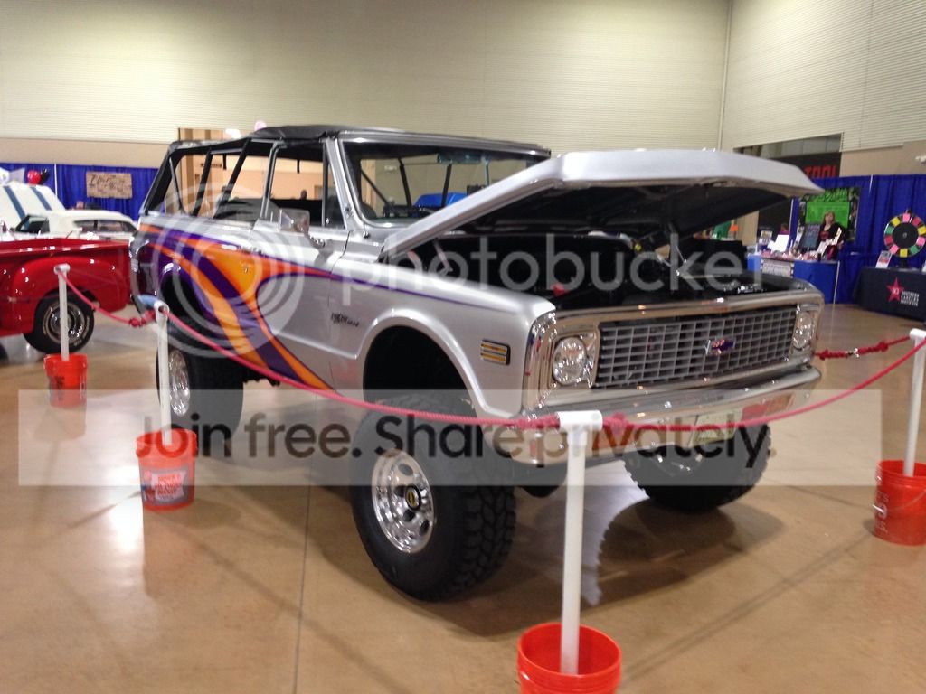

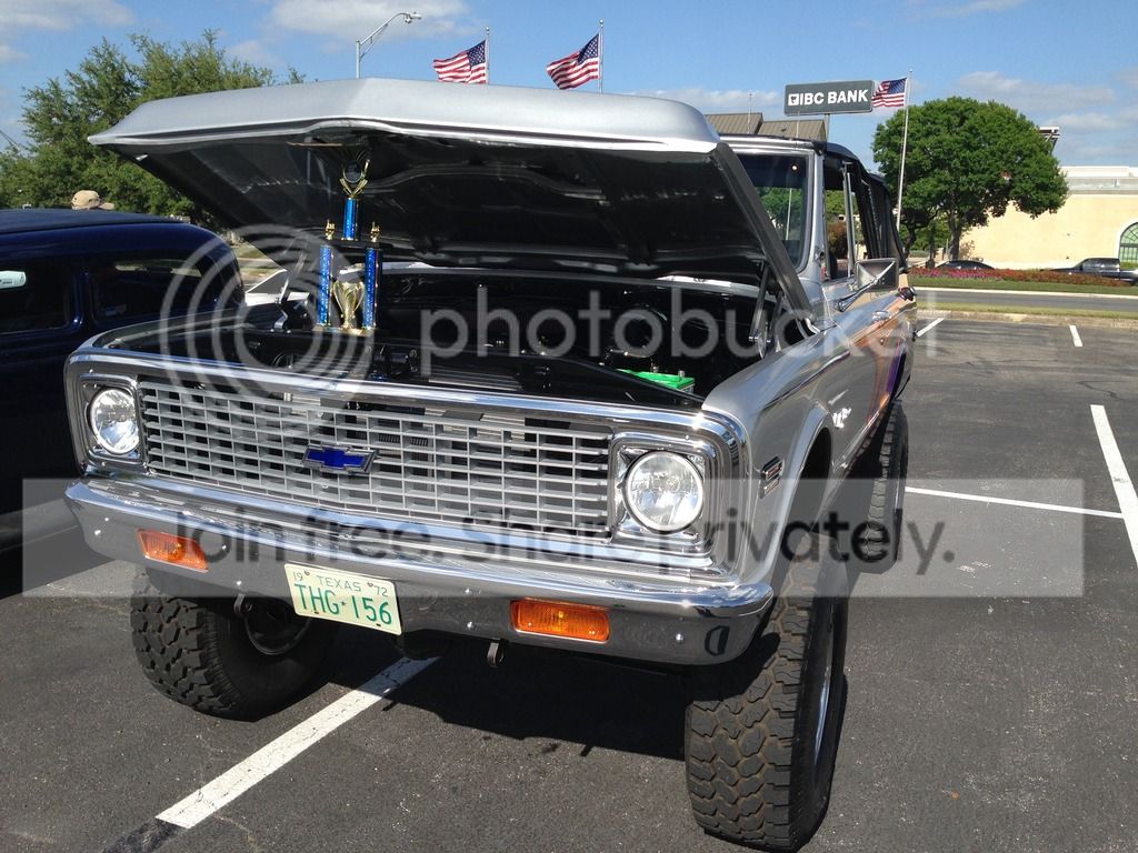

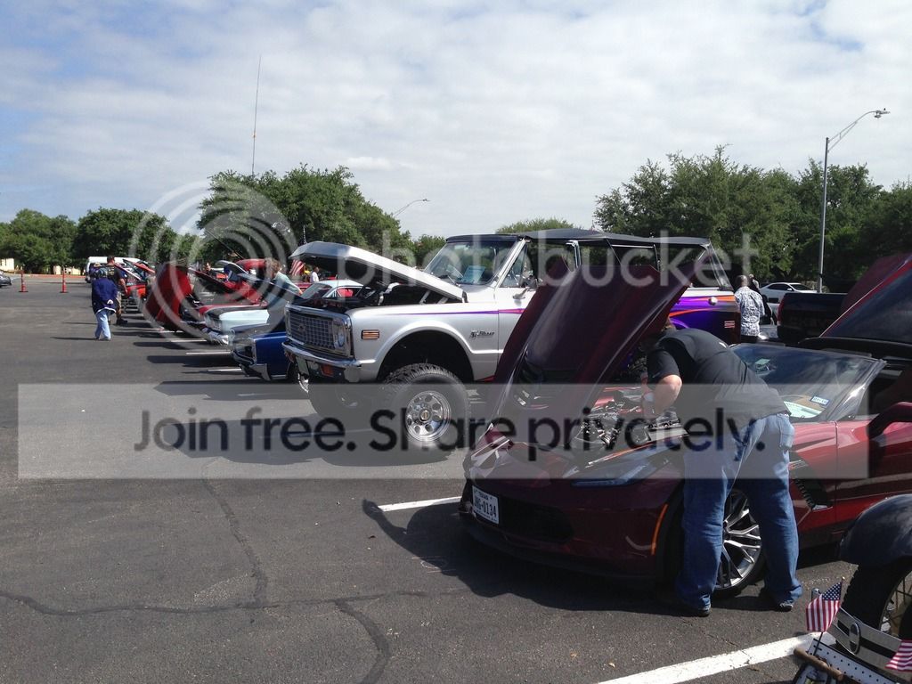

4/8/17 - First real car show. Brought the truck to its first legit car show yesterday. I was originally gonna just hang out with the club putting on the show, lining the Blazer up with their cars. Spur of the moment as I was parking, I decided to enter it into the show. There were about 150 cars there. Lots of really nice stuff.

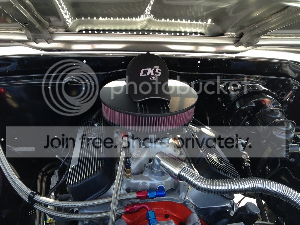

I think the bling on the air cleaner only helped
Long day in the sun, but the truck apparently showed well. Took 1st place in the 60-79 truck class
Need to make some adjustments on the transmission shifter. Gates aren't lined up with the tranny detents. And have an oil leak on the passenger side somewhere that appears to show up on hard acceleration.
