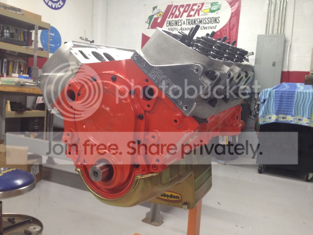

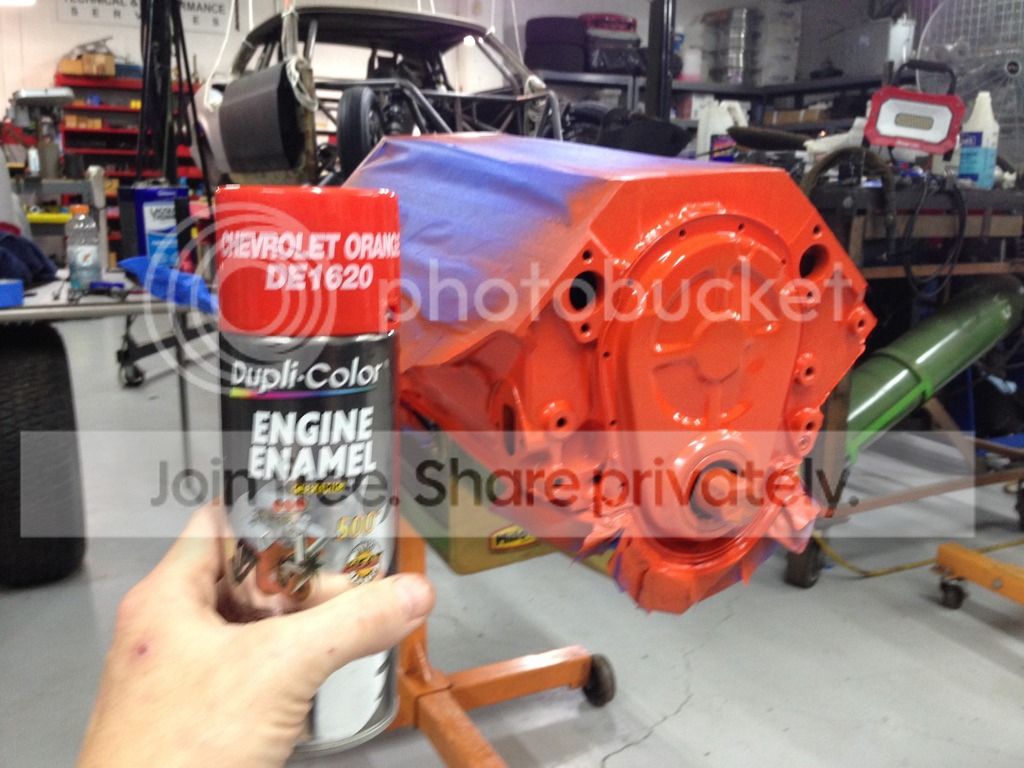

Block got a little cosmetic work done tonight.

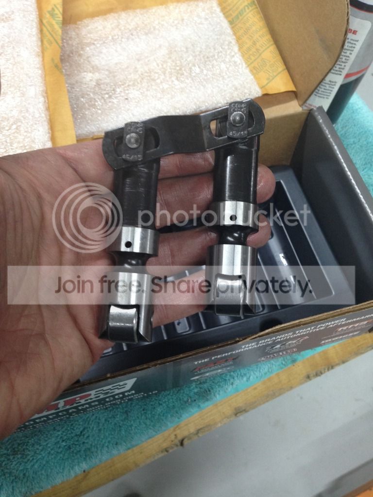

Solid rollers
Poured some ZDDP over the cam and lifter galley. Added some assembly lube and dropped in the lifters
Ordered up some lash caps to protect the valve stems from mushrooming. Those'll be here in a couple of days, then I can put on the rockers and measure for pushrods.

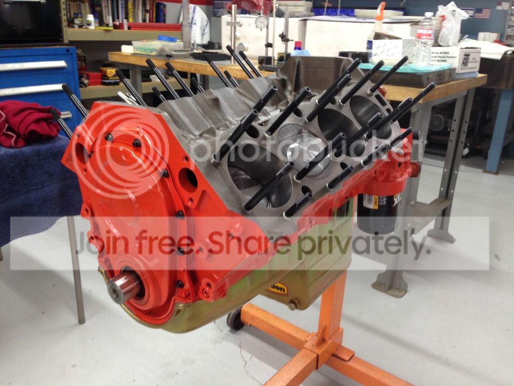

Then the torquing fun commenced. 110 ft/lbs in 10 pound increments. I was beat by the last one. But the crank turns smoooooth.
10 lb increments is a little overkill, that is a lot ot torqueing! 3 steps I what I usually do, from the middle out. I would of gone 40, 75, 110 after snugging them up with a 3/8" ratchet, which is kind of like 4 steps I guess.

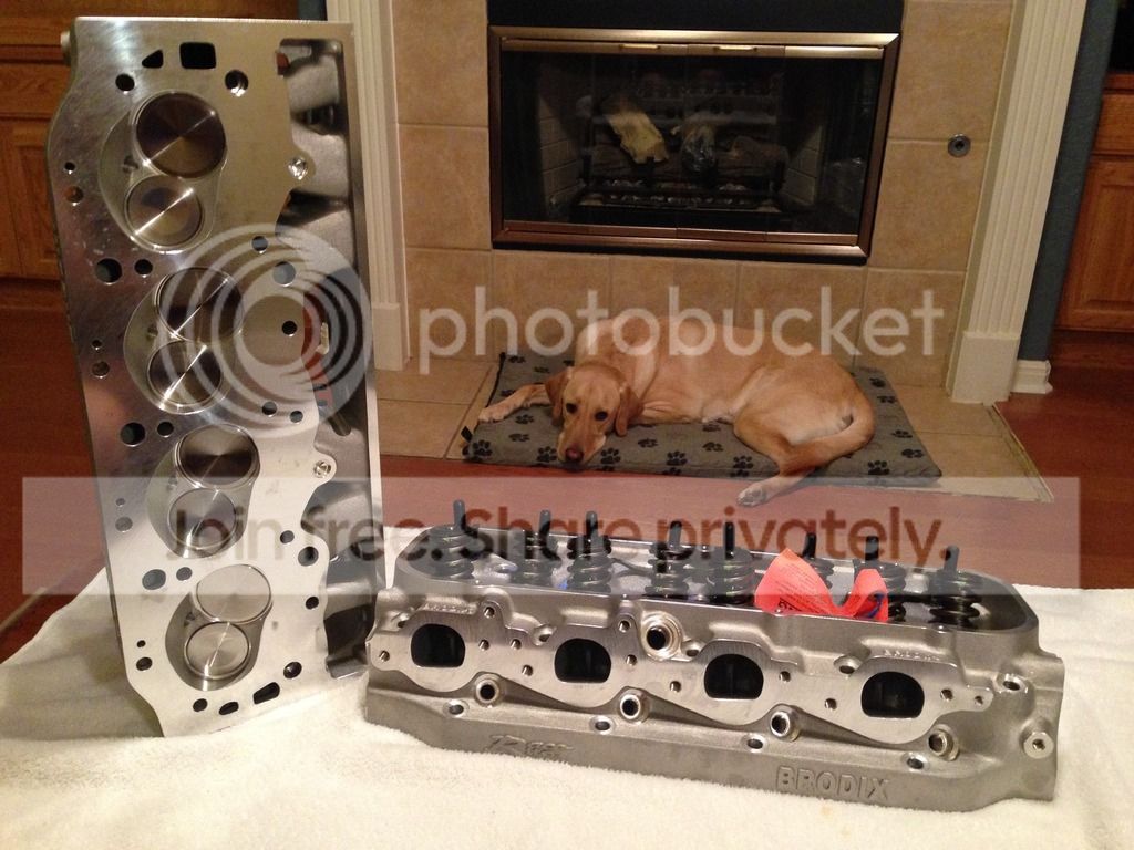

Interested to see how the heads do.
I think they might be a limiting factor here.

Although with that cam and intended RPM range I don't think the heads are a limiting factor, they flow enough for almost 700 hp and should have very high port velocity. If you were revving it higher that might be different.

Forget old school snug down ring compressors. These guys are the way to go. Ridiculously easy and way smoother. Wish I woulda stopped to get a pic of one going in... :doah:
Buttoned it up with the timing cover, oil pan, and freeze plugs.
Now we wait on Brodix.
Those ring compressors are awesome aren't they? I switched over to using them too, I like the total seal units, a long gradual taper, I ruined a set of rings using one of those wrinkle band compressors, scratched the rings all up because of wear at the ends where the clamp connects. I shot that thing, literaly, blew it to pieces with a Henry lever action. The thing is, if the piston to valve clearance on that motor wasn't too low, so I had to take it back apart again, I would of never known the rings were damaged. Then you try one of those one piece tapered units and start laughing at how easy it is.
Speaking of that, did you check your P-V clearance?

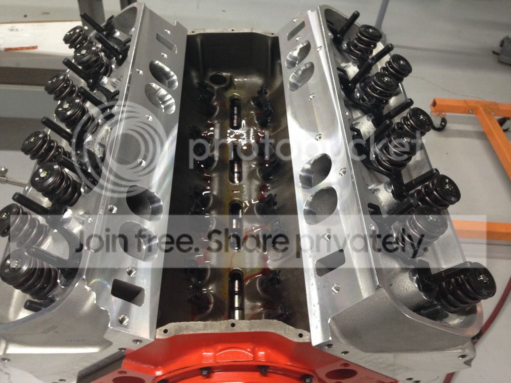

Copper coated the head gaskets, set the heads in, and torqued them down. Long block done. Looks damn good.

The ZDDP isn't required with the roller cam, but can only help.
I don't think you need lash caps these days, I would only run them if you need them for clearance.
Did you check your camshaft endplay?
BTW, if you have any trouble getting the rockers on the center of the valve, the Dart adjustable guideplates work awesome. Obivously the corrrect pushrod length will get your rocker geometry correct. But sometimes you can't get the roller centered on the tip with both rockers in the pair because the quidplate is one piece. Well, the Dart guideplates are two piece and they work excellent. Highly recommend them.
Also, don't forget to check the pushrods for clearance to the head, sometimes you get some that rub and you need to clearance the head with a die grinder.
