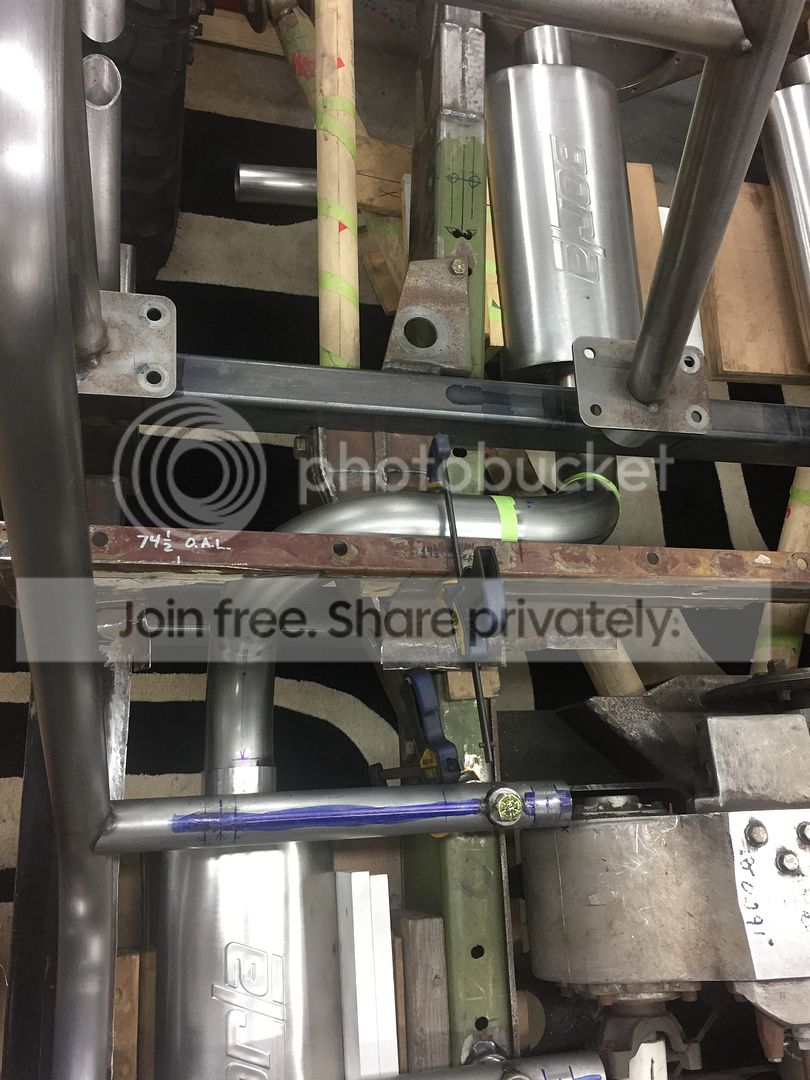

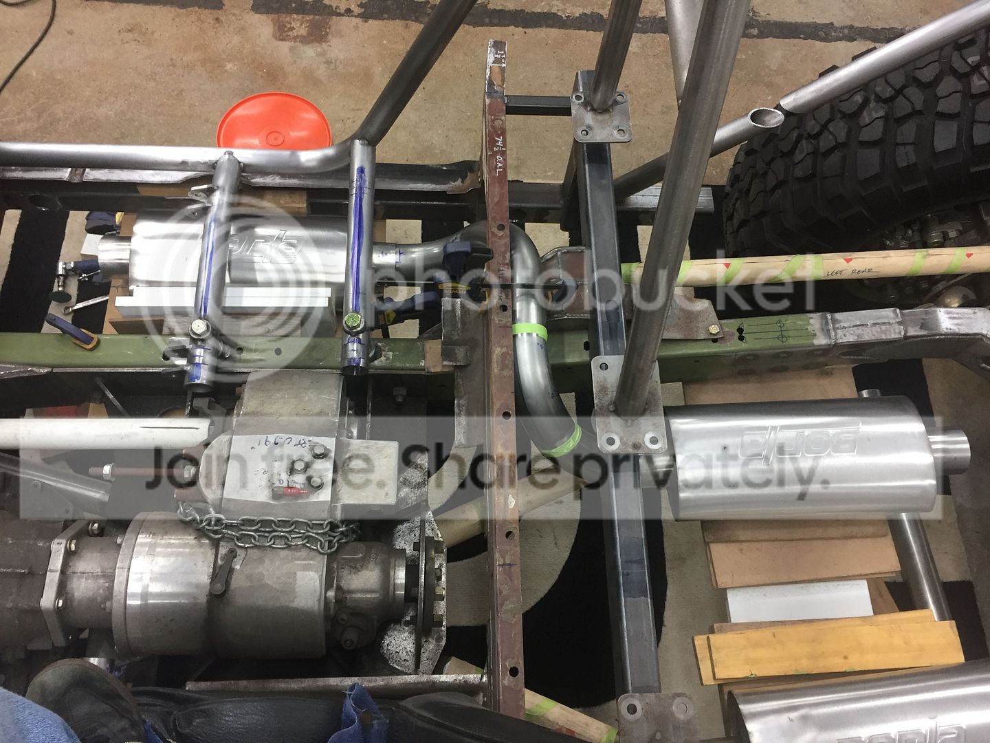

The one final piece of the exhaust puzzle was the finicky section of tubing that runs between the first muffler (in the torsion box) and the resonator that is on the inside of the framerail. This requires a very precise set of turns and threading-the-needle over the top of the framerail, and there isn't much margin for error..... and not a lot of extra room even if everything is done perfectly.

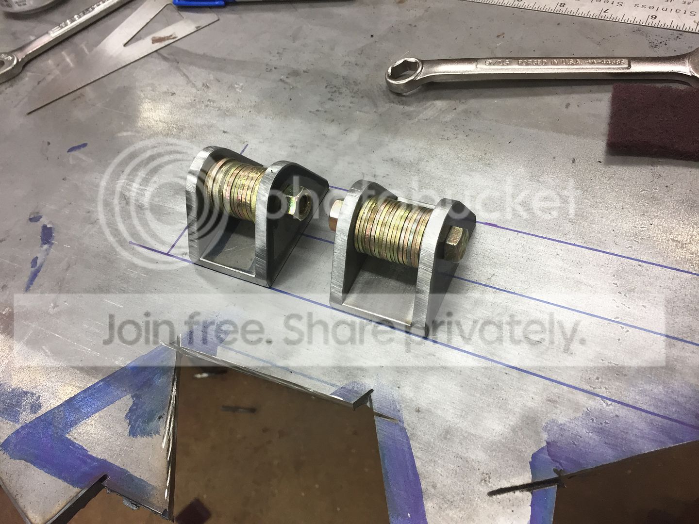

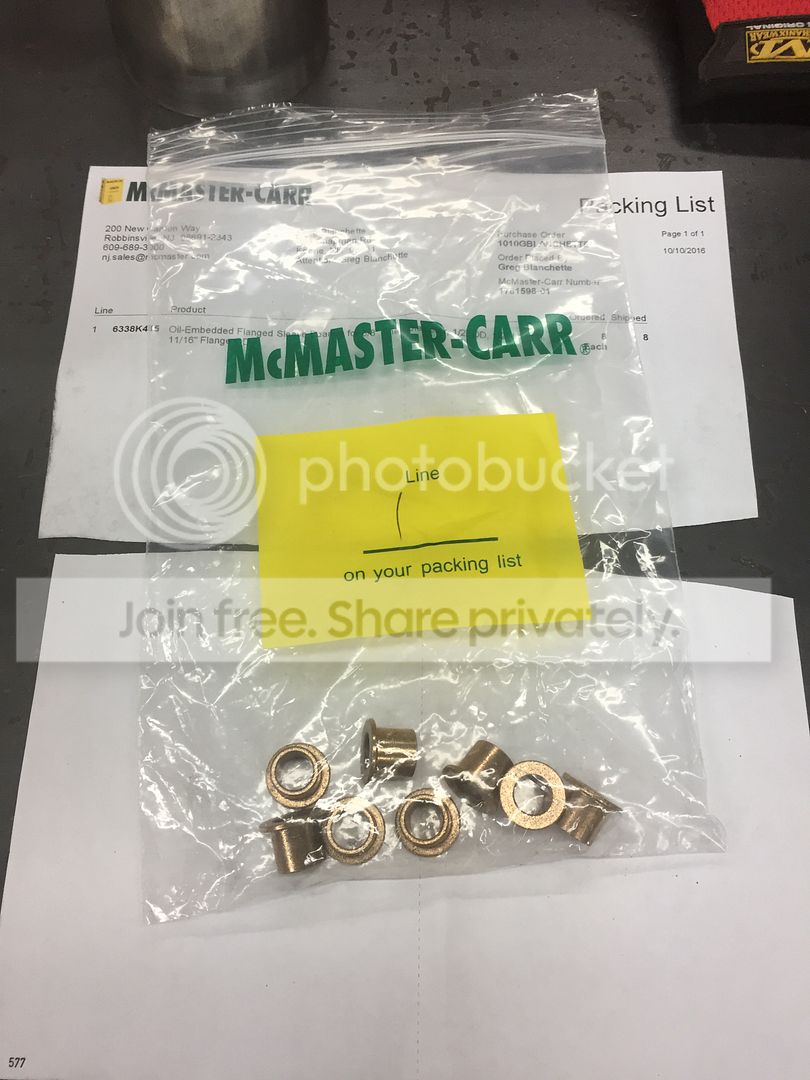

For starters though.... McMaster-Carr came through with a quick (as always) shipment of bronze bushings for the seat pivots. I love spending $5 for parts and $6 for shipping!!! LOL

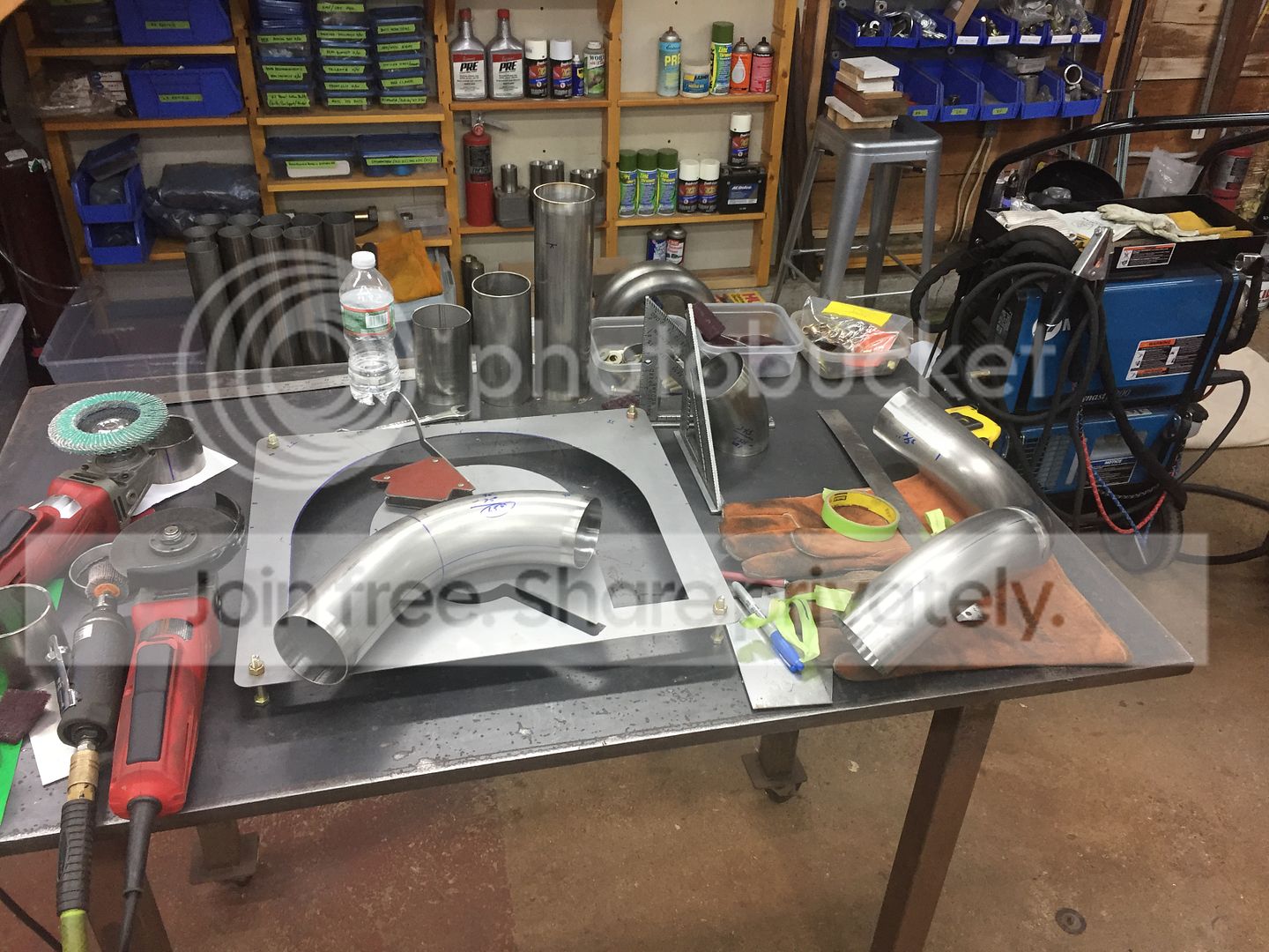

The first bends coming out of the torsion box were already figured out, so the trick was getting a 90-degree bend connected to the existing tubes, then angling it downward to clear the transverse B-Pillar crossmember and then angling it slightly upwards to meet up with the resonator. The benchtop looked the part, with lots of cut tubes, grinders, sanders and the like:

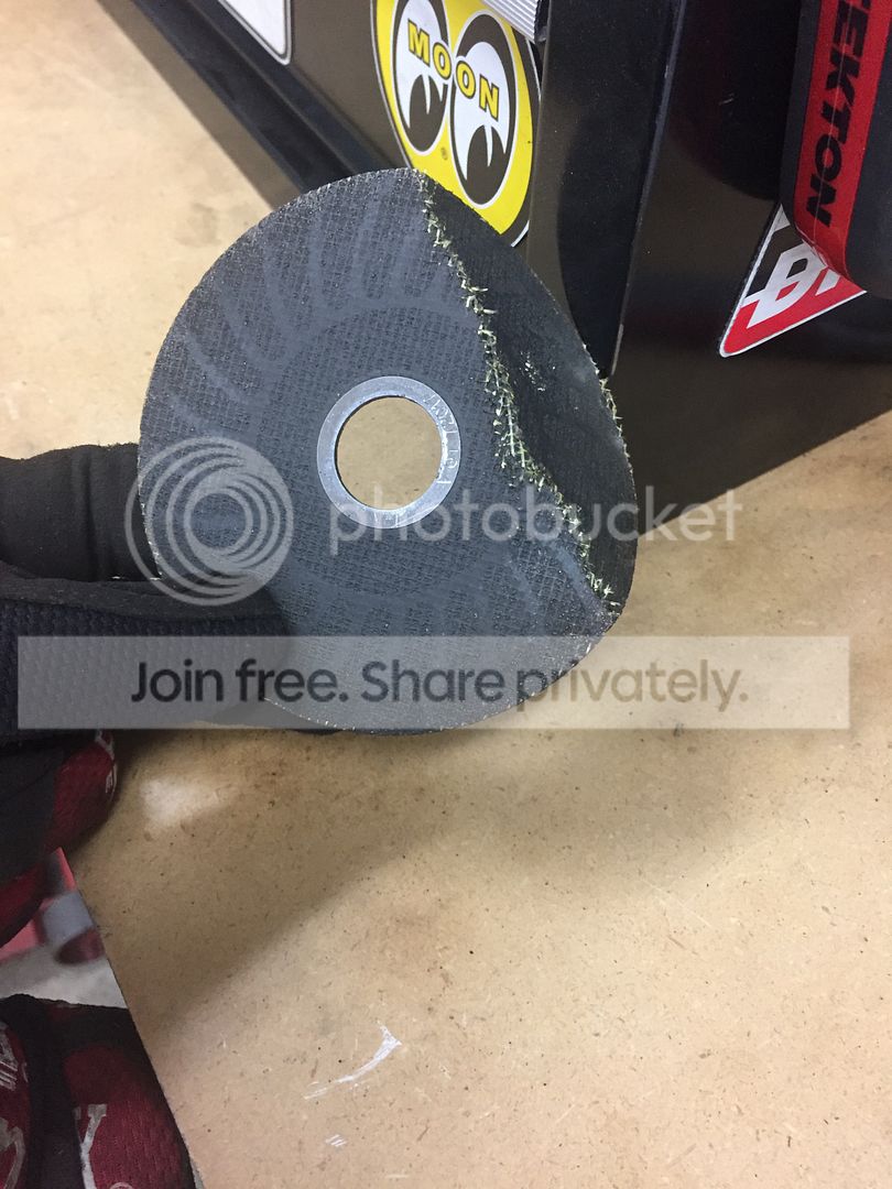

Of course, anyone who does fabrication work knows that the perfect time to knock the angle-grinder off the bench is JUST after installing a fresh cutoff wheel..... my shop is no exception!
It was a strange combination of metal cutting, yoga moves and green tape... but eventually the whole assembly came together and started looking right.
....from a slightly different perspective:
So the good news is that now there is a perfect set of template cuts that can be used to replicate a "mirror image" version of this exhaust routing for the driver's side.... so that will go MUCH faster. Basically the entire thing is figured out now with the exception of the final few inches at the rear tailpipe (which will be positioned and fine-tuned once the bedsides are re-hung), and a small 18" section that comes off the headers into the front muffler....(which will require the headers to be finish-welded to the collector to lock those dimensions in 100%).

Looking good Greg. Is the idea to put clamps at each muffler so you can unwind the sections of tubing from under the frame to do the final welding? Looks pretty tight.
Brian,
Yeah it's hella tight! :haha:
I've got several sets of Vibrant V-band clamps already. The plan initially was to put them on either side of each muffler so that I could swap them out for straight pipes or a different style. But that transition-piece that goes over the framerail is going to be REALLY hard to remove. So it seems like at least one set of clamps will need to go in that tube section or it will be trapped forever (once the floor is reinstalled). :thinking:

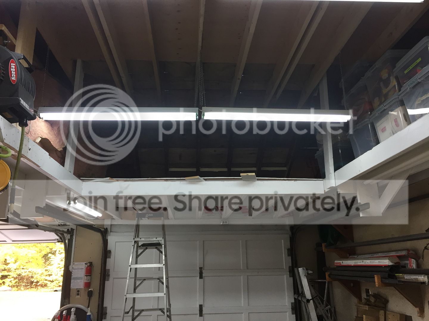

2016.10.17 - UPDATE!! - DROPPING THE MEZZANINE..!!!!
Winter is on it's way.
Although the weather has been sunny and crisp and basically perfect lately.... it won't be long before it's just a bit TOO cold in the shop and heater needs to get fired up. And with the winter comes the snow and the idea of rolling the truck outside gets more problematic too.

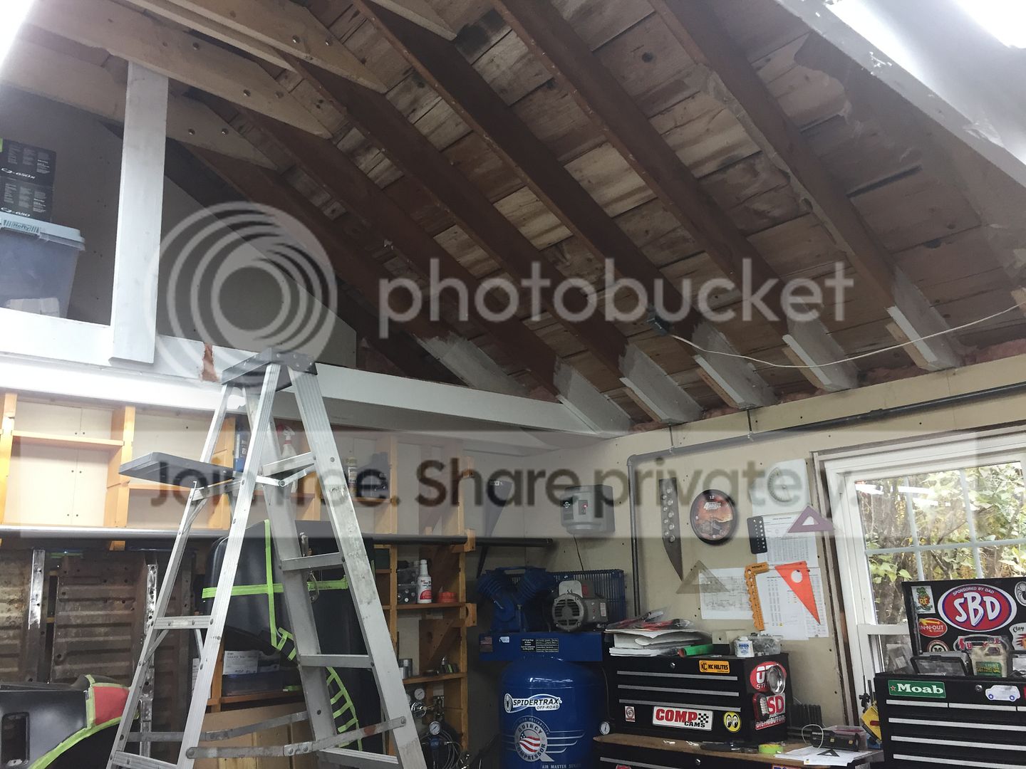

There have been a couple of recent build days where the overhead mezzanine made it difficult to get things done. A recent "flex test" day came up short because the rollcage actually hit the ceiling and prevented the truck from getting high enough to fully droop the suspension. On a separate occasion, attempts to lift-out the upper rollcage structure were thwarted for similar reasons. For the small amount of storage space those platforms provide, they just aren't worth the aggravation they create.... and when it comes time (soon!) to install the rest of the foil-backed foam insulation it will be simpler to just work directly off a ladder rather than climbing onto those platforms 100 times.

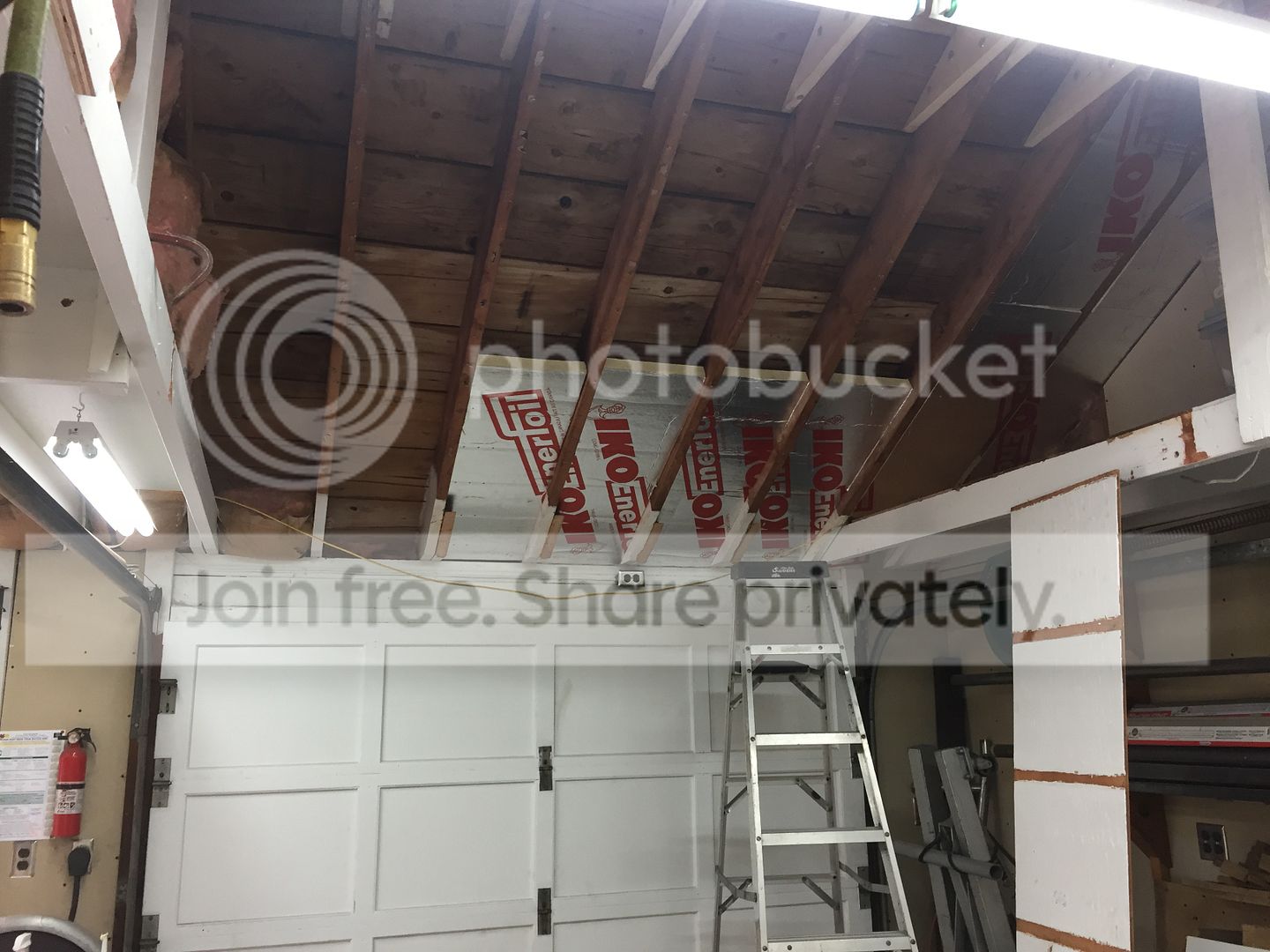

Step 1: Pry up the plywood and to expose the beams.
Then....cut the nails with a trusty Saw-Z-All....

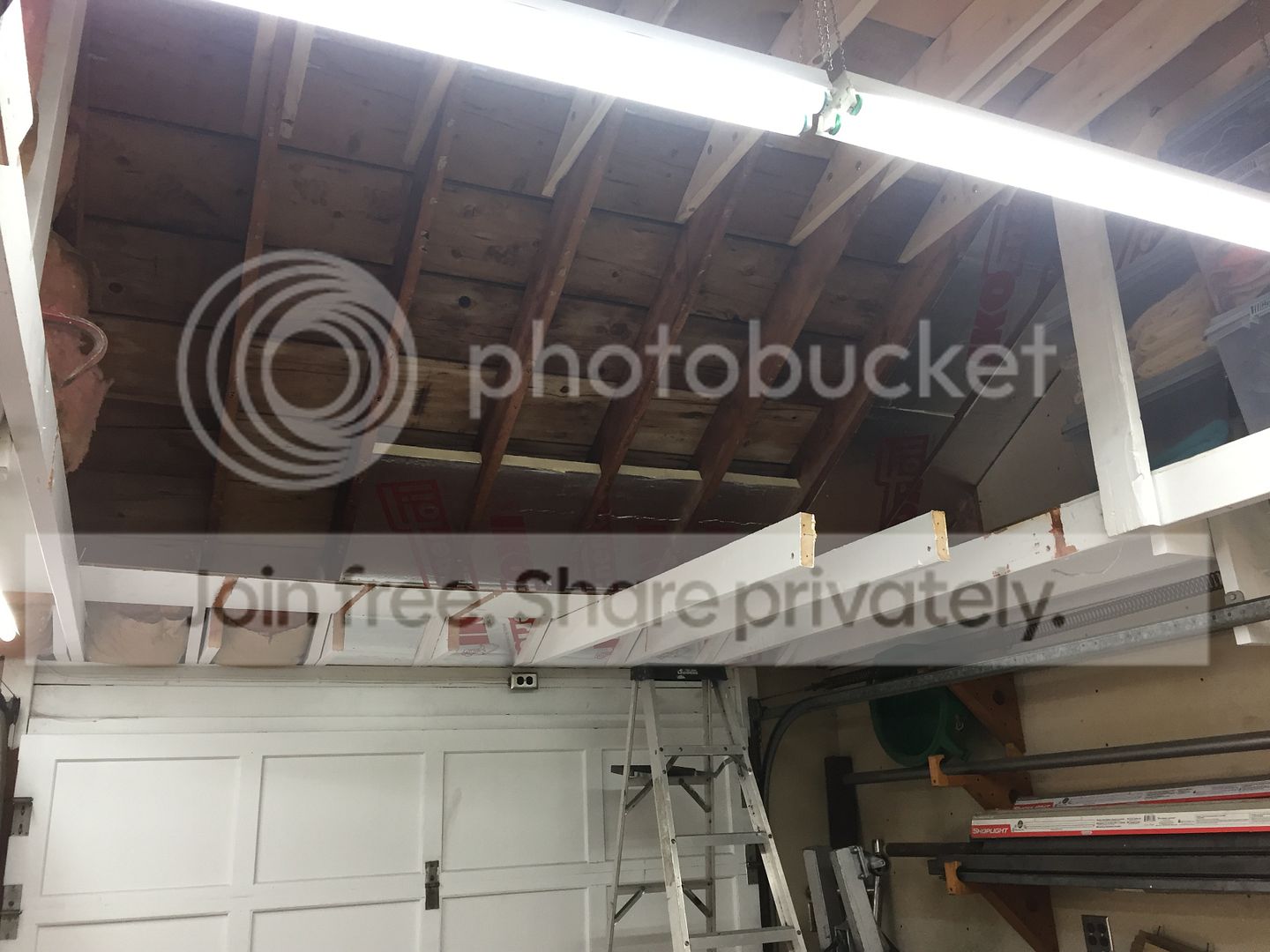

.....and enjoy the "open sky" effect!!!
It didn't seem like it would be as critical to do the inside mezzanine (over my toolboxes) but I knew I'd regret it later on if I didn't say "MAW"...
The end result is really good!! :waytogo:

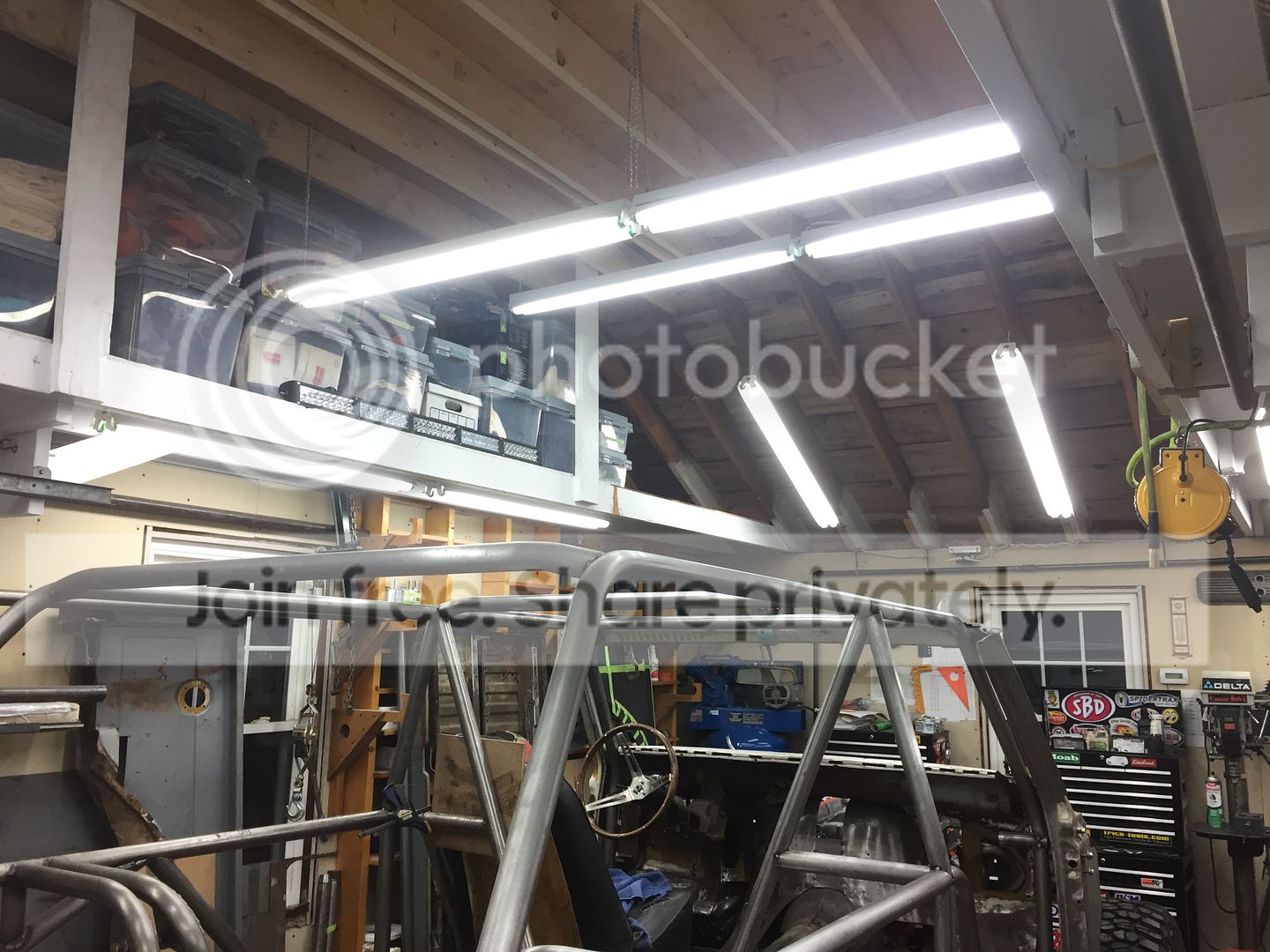

The upper ceiling lights were originally dropped down about 24" to give better light, since the mezzanine floors blocks much of that light. But now that everything is wide open, they can be raised to the very top again. This will actually create enough clearance that the entire rollcage could be lifted up into the rafters and the truck can actually be rolled out from underneath if I wanted to. That's HUGE. It means that in the future the sheetmetal tub can be removed and sent off to the bodyshop for final paint, and the rolling chassis can be prepped and assembled while it's away. Also, the topside cage can be finish-painted and will be ready for final assembly as well.
Over the next few nights the priority will be getting the foam sheets installed so that the garage will hold heat well... then it's right back to exhaust work!!! :D
