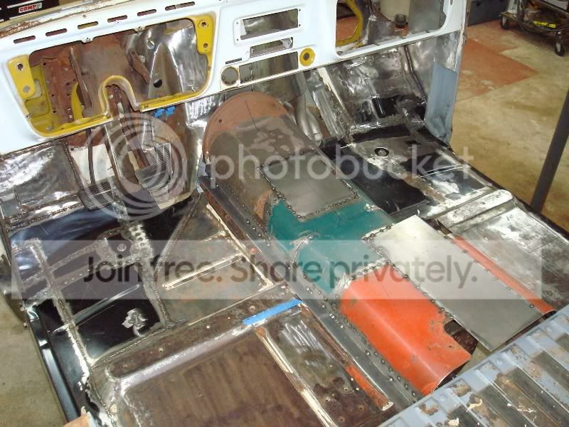

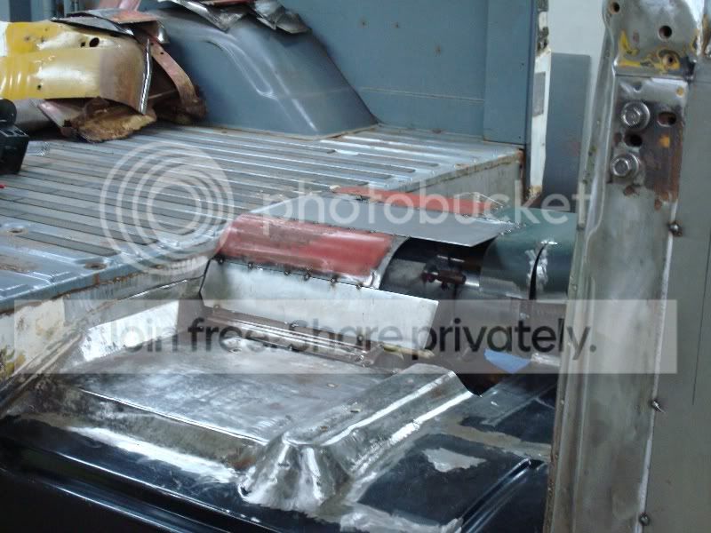

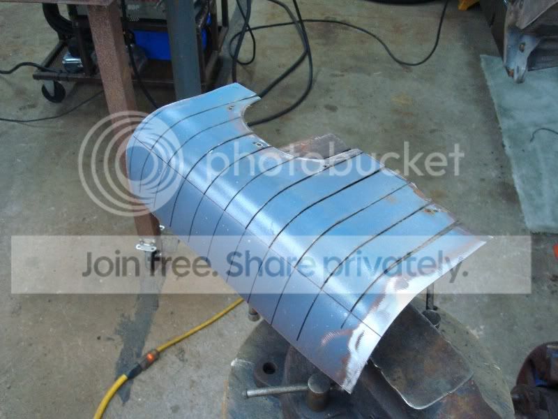

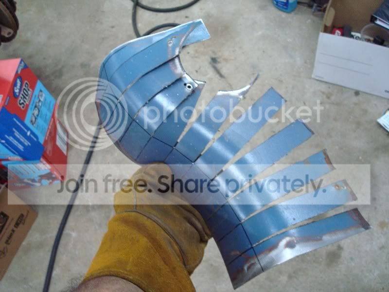

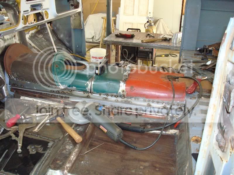

Running a flat bellypan certainly creates it's share of interesting challenges...

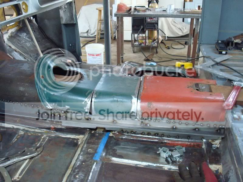

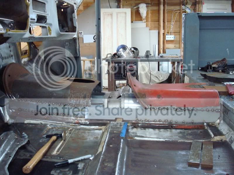

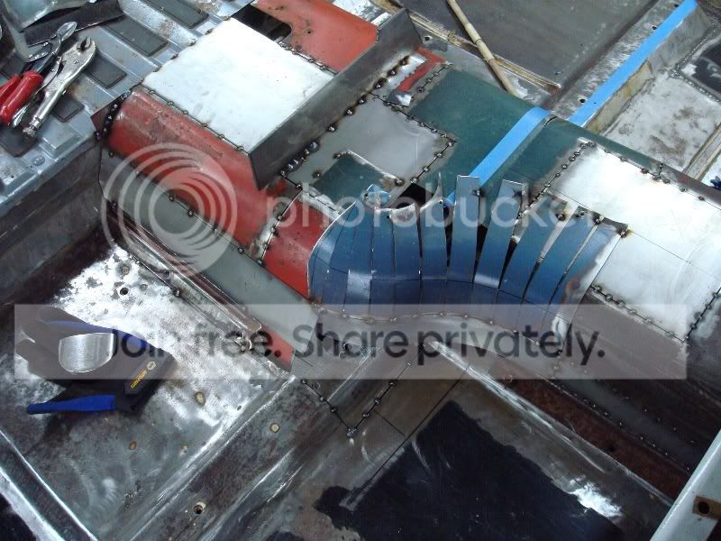

Looks good Greg. Might i suggest that maybe you make this tranny tunnel two pieces? Looks like the mid point is somewhere about where you sliced the green tunnel piece, maybe make it seperate at that point. Just a thought but it would make it a little stiffer and eaiser to remove.

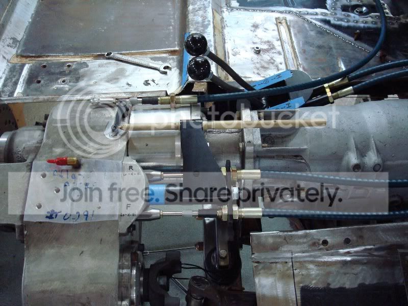

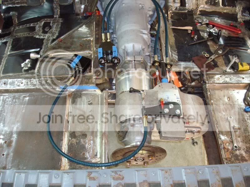

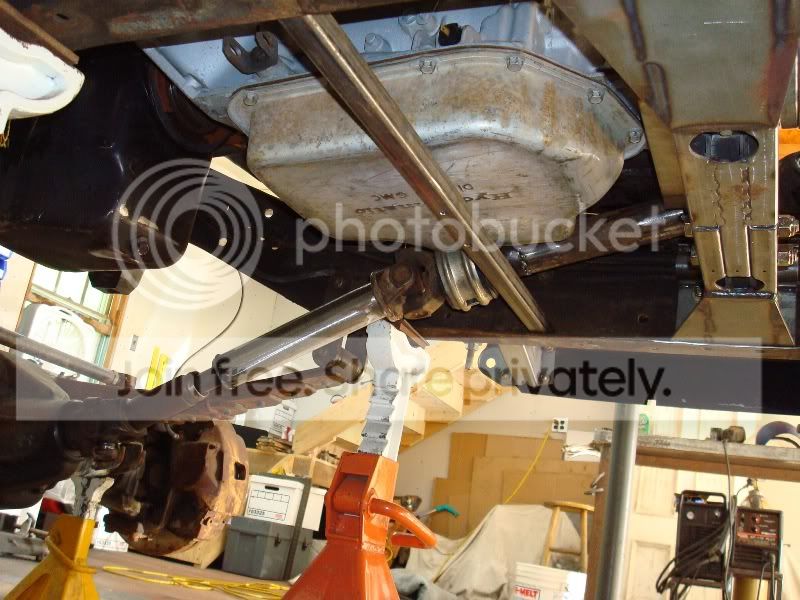

It is FAR superior to what Advance Adapters provides, and it made the job a lot easier. There were a few hiccups...like some missing parts, and a DOM spacer sleeve that was about 1" longer than the parts list description said it should be. AA could certainly use some improvement in the "details" department.
It also creates a problem with the pinion brake, since the cable wants to rub against it pretty hard.... the cables aren't very flexible at the extreme ends where the fittings are.
