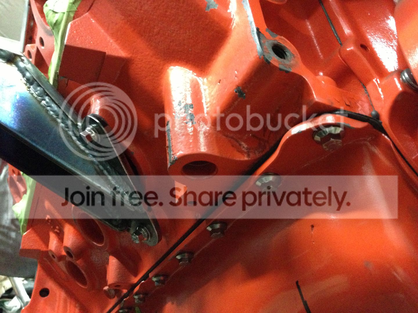

Changing gears for a second.
This is a boss on the engine block that is already giving me trouble (as evidenced by the scratched paint). It's on the forward part of the passenger side and although it has a drilled hole into the bottom of it, it does not appear to have a plug installed for anything.
Can I feel confident grinding this down to match the angle of the surrounding block area or am I going to end up cutting into a cooling passage, oiling passage or whatever? :dunno:
EDIT: Is this the mechanical fuel pump boss? That would make sense... This engine requires an electric fuel pump so maybe the was just left behind from the older block casting they based this engine on?

That boss on the block isn't the fuel pump. The fuel pump is similar to shape and placement as a SBC is. I'm thinking it may be a mounting point for another non automotive application?

The engine boss could very well be for some other application, I think there is a similar one at the same spot on the DS too. It's got a hole machined about 1" deep in it, almost like it was some sort of locating "index" to drop the motor down onto a set of pins or something. I'm hoping I can grind it down flush (or close to it) or my upper link is going to smash it......failing that, I'll have to move the mount a few inches forward so that it's closer to where it was before I pulled the axle back almost 3"! :eek1:

About the casting sections on the block, I could be wrong, but they do look like dowel holes for a positioning fixture to keep it secure while travelling through the various stages of the machining/production line.
I saw similar when I built and installed the guarding for a new Chrysler engine line in Windsor, back in the early 80's.
