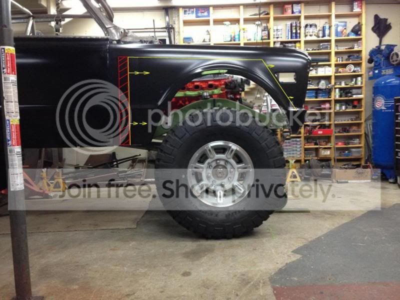

1. Cut and slide the entire fender opening forward 2" on the fender (maintain current 106" wheelbase)
FTW:waytogo:
If it doesn't create a "weird" looking fender in the process, I agree with you 100%
When it comes to the front suspension and fenders these last few days, it's definitely becoming a battle of inches. Small changes can really make the difference.
-G
I think it would look factory by the time your done:D Not like you dont have the skills to do it:bow:
I think if you make the suspension clear the fender, you will have to modify the opening more anyway. So I say make the suspension how you want it, whether it be factory wheelbase, or +1 or 2". Then when you get the suspension complete, then modify your fender to fit with the tires on and make them clear. I would set the fenders aside for now, once you pick your wheelbase.
This, fender/ body is last.
I agree with Heath though since it turns its going to need to be bigger everywhere. I have been down this road before and its absolutely astounding how much space a turning tire takes up
So you guys are suggesting that THIS is a problem...? :whistle:
This was at full bump on both sides.
Remember.... The axle is technically 2" too far forward based on this fender opening centerline, so it should not be surprising that things got bizarre at the leading edge of the fender.
The surprise was that the rear of the fender was really tight as the wheel turned in and out. Maybe 1/4" of clearance between the tire and fender at its worst-case scenario. So if I had moved the current stock-sized opening forward, I would just be shifting the interferences around, but not solving them. Looks like I'm going to be moving towards "pizza slice fender v.2"
My original pizza fender was a total of 4" wider at the base of the arch, but my guess is that I can probably get this one done with an extra 2" at the base of this one. (adds 1" around the entire current fender arch). :thinking:
-G
Hope you don't mind greg, but I was bored.
Here is the opening moved forward like you showed in your illustration.
I went a step further and did that same frontal movement, but kept the rear of the fender in the same spot, effectively opening the wheelwell 2 inches.
This gains the front room , keeps the rear in, and gives the tire some more space. I think this keeps the fenders overall shape as well.
Cool.... :waytogo:
I have to admit that the thought of doing a major fender "rework" has me a little bummed....
I never really liked the look of my original pizza-sliced fender, mostly because of how much taller the arch became. Ultimately if you want to preserve the proportions of the original fender well you HAVE to make it taller too.... But 2" added everywhere just didn't look right to me...
I know Eric and Heath are coaching me that "form follows function" on this one.... And to let the fender be what it is once the suspension is fully built. But I just can't ignore the aesthetics completely. I need to strike a balance between the two factors here (suspension travel vs. aesthetics) and that's what is going to eat up a lot of my brain cells in the coming days.
-G
