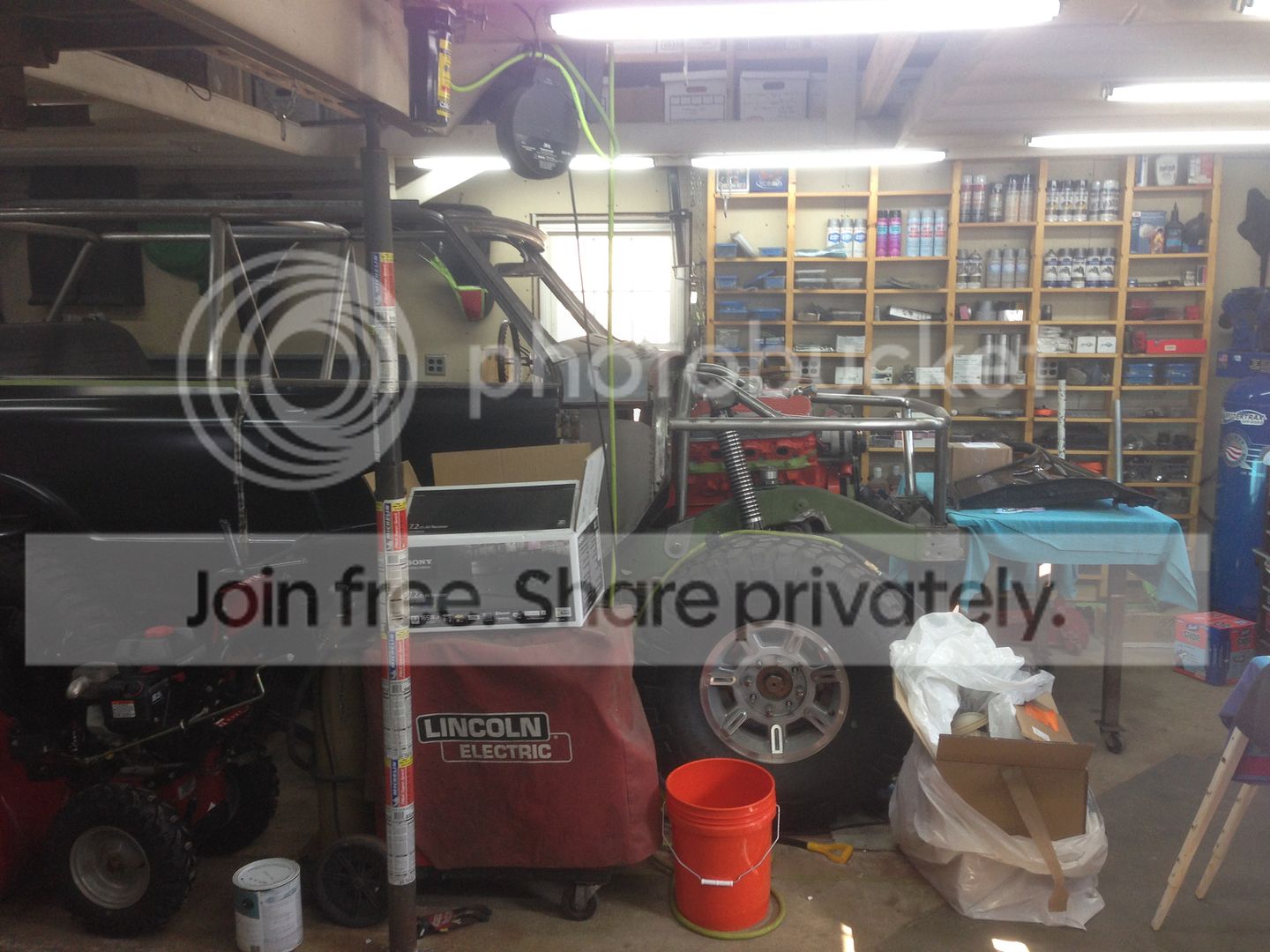

Sunday turned out to be an amazing weather day. Mid-60s and sunny. I rolled up both garage doors to let some fresh air into the workshop and surveyed the damage that a winter of neglect causes....
Oooops... December 2013. Guess it HAS been a while since I've been here!
The "patient mistress" was buried and hidden behind a bunch of debris, but still happy to see me...
I spent about 3 hours cleaning out the sand, salt and slushy debris.... cleaned up the tool area, and just generally got my head back together as I put the garage back into a functional, clean state. It's always a good time when I've got the music playing and have a hot cup of coffee to get me moving along.... eventually the shop was clean and I found myself staring at the truck wondering:

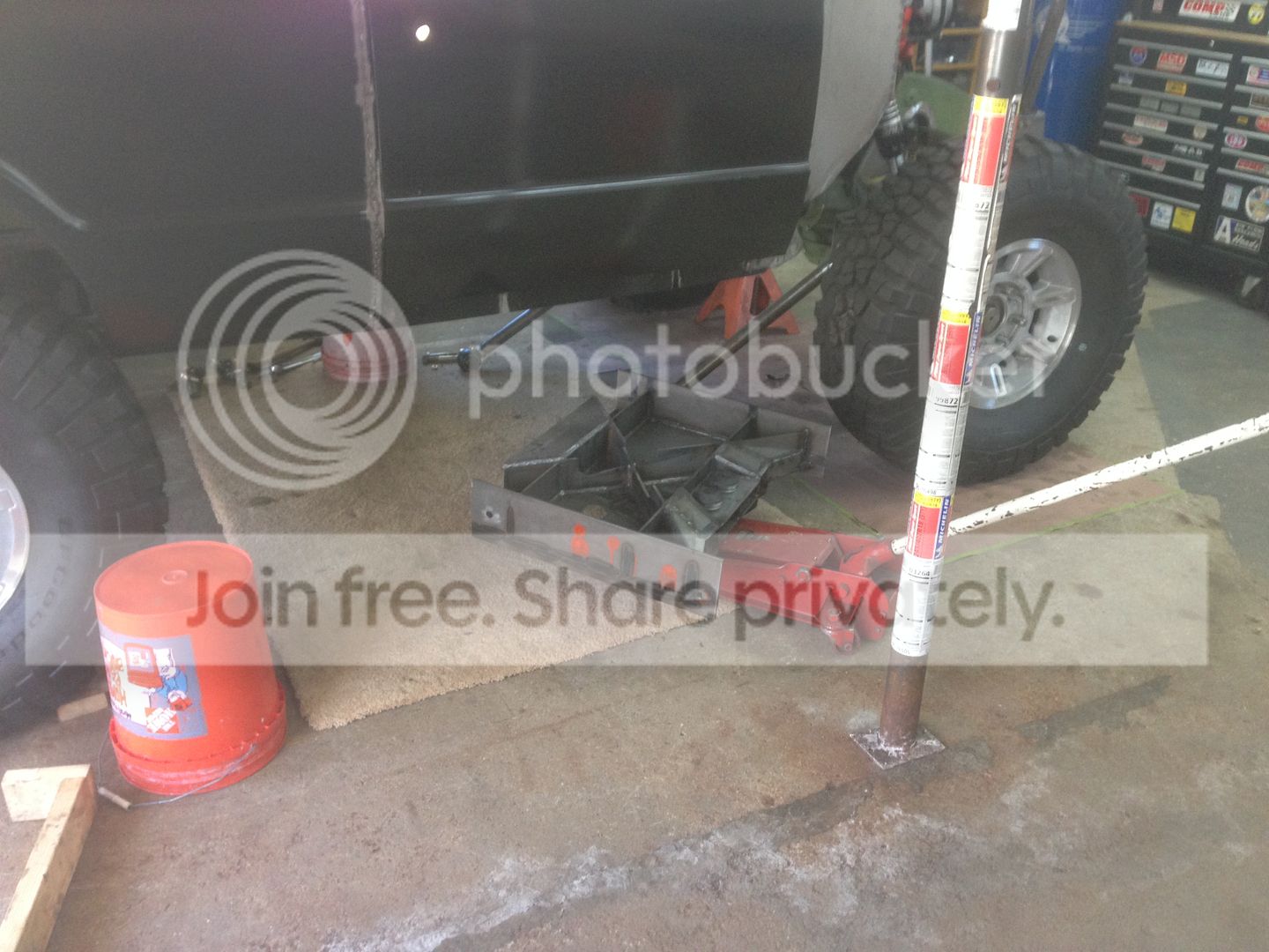

According to my Oracle notebook and re-reading this build thread, I was able to determine that I still had some final welding and hole-drilling to finish on the monolith. So that's where I decided to start.
Before removing it from the truck, I took a careful look around to see what else might need attention. It's not so simple to install/remove this crossmember anymore, so it's good to spend a few extra minutes identifying issues in advance. I found TWO...

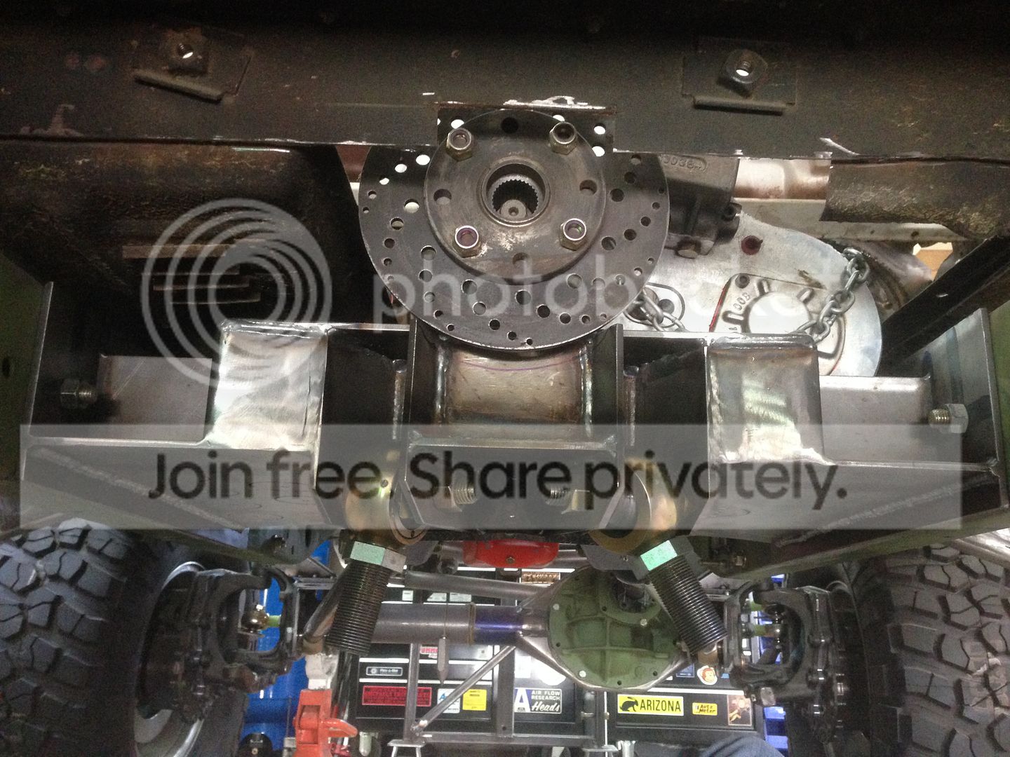

One is that the front driveshaft output will need a bit more clearance for droop, so the braces I've built will need to be trimmed back a little on the passenger side. Not a big deal, I marked the area with a blue Sharpie as a reminder.
The second is a bit more work, but ultimately still pretty straightforward. I had forgotten that the rear output of my Atlas has a HAD e-Brake setup that didn't fit anymore. Some of the rear bracing was in the way of the disc and will need some trimming and re-plating to create the needed clearance.
After marking that area and taking a few careful measurements, I dropped the monolith like it was hot. (and heavy) :D

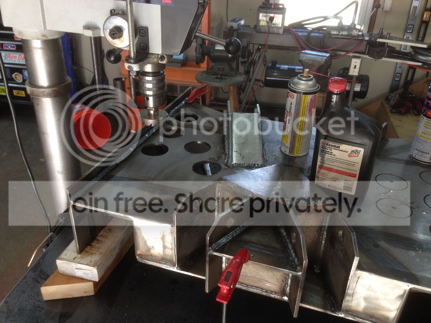

I never got a chance to try out my new gear-reduction pulleyset for my drillpress and was excited to see if it would help my cut the 2-1/2" holes through 1/4 plate steel without loading up and stalling the motor...
It was certainly better than before, but it still needs some work. The amount of torque that is generated causes a LOT of belt slip and when I really crank down on the tensioners they deflect pretty bad (it's a single shear idler). The extension plate on the RogueFab kit bends pretty badly too. A simple triangular support welded to it will probably be all that's needed to improve things substantially.
Anyway.... after a couple of hours and a lot of cutting fluid, I got all the holes drilled. It was a great feeling of success. I'd been worrying that these holes would fight me forever, but the end result came out quite nice!
You'll notice that on one side the holes seem to be in an almost "random" pattern compared to the opposite side. That's because I was careful to align the drain holes with the drain plug on the Atlas... not being able to reach that drain plug would have been a huge "ooops" in the design.

Quick bonus photo.....
Started the clearancing of the rear area on the monolith tonight to make room for the e-brake rotor and caliper.
A little bit of plating and it's done. The front driveshaft clearance mod is even simpler.
