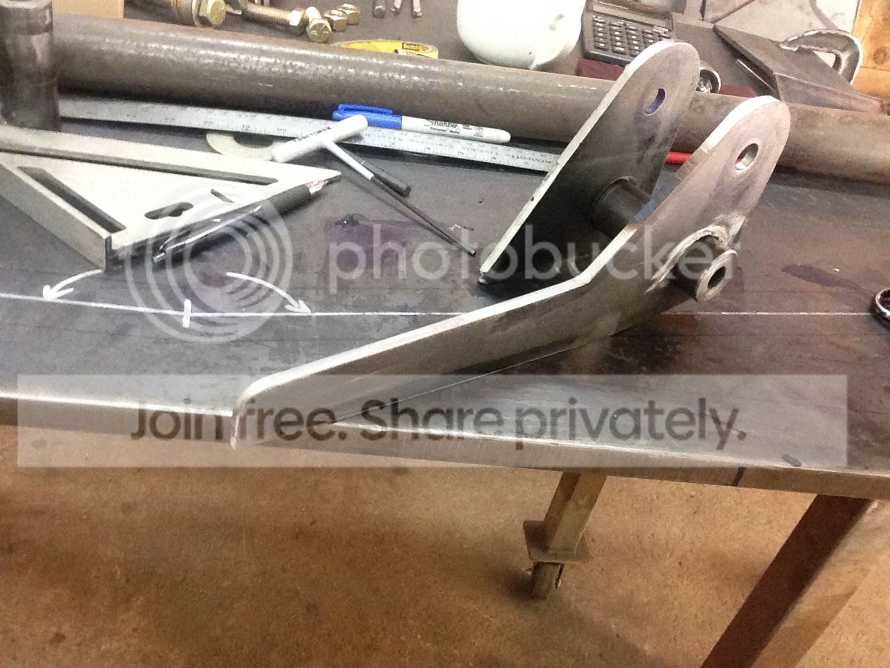

First was to make a few small changes to the PS steering arm. The uppermost plate needed to be clearanced for the draglink heim so that the threads would not hit the plate under droop. I reduced the radius of the curve at the end of that plate by about 1/4", so the result still looks nice but now clears in all conditions. The other thing I did was to bore a through-hole in the middle plate so that the thick-walled spud could be lengthened to pass through both plates (as a single tube, instead of 2 separate ones). You can see the basic idea here before I reinstalled it on the PS arm.

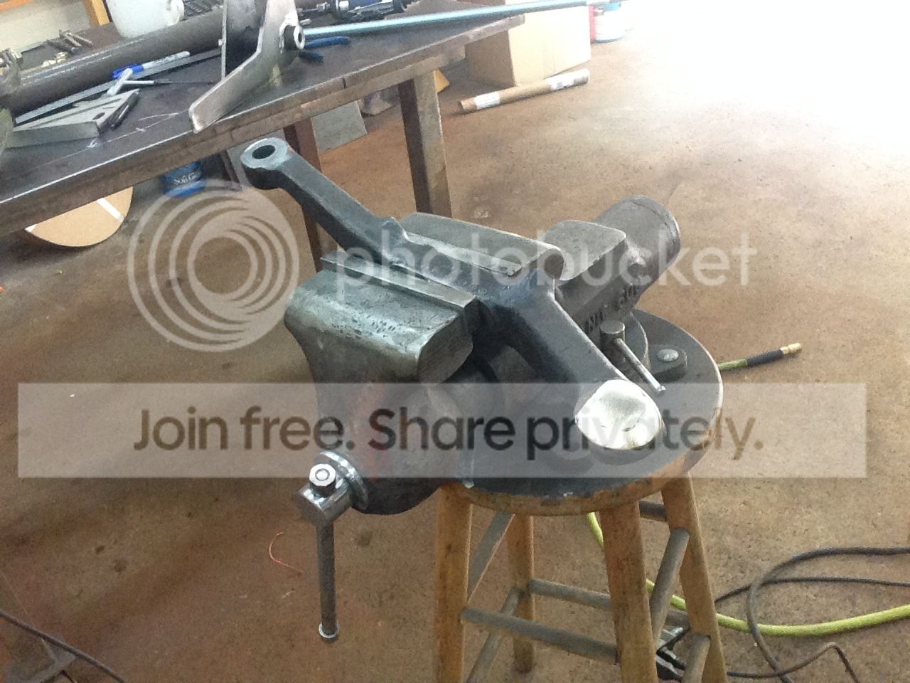

You may also remember that I had on objective to use the factory Unimog 404 steering arm on the PS as a way to reinforce the lower part of my new steering arm design. As it turned out the original hole for the draglink ended up INSANELY close to where my lower plate ended up..... sheer coincidence, but it was a great bit of luck! :waytogo:
The original tapered hole was just slightly off the mark, so my 5/8-11 - 8" through-bolt would not actually drop through it and allow me to secure the nut onto it. So I welded up the hole and marked it in the correct location and drilled a clean, new 5/8" hole there.
Here's the shot of the welded up arm, just before drilling.

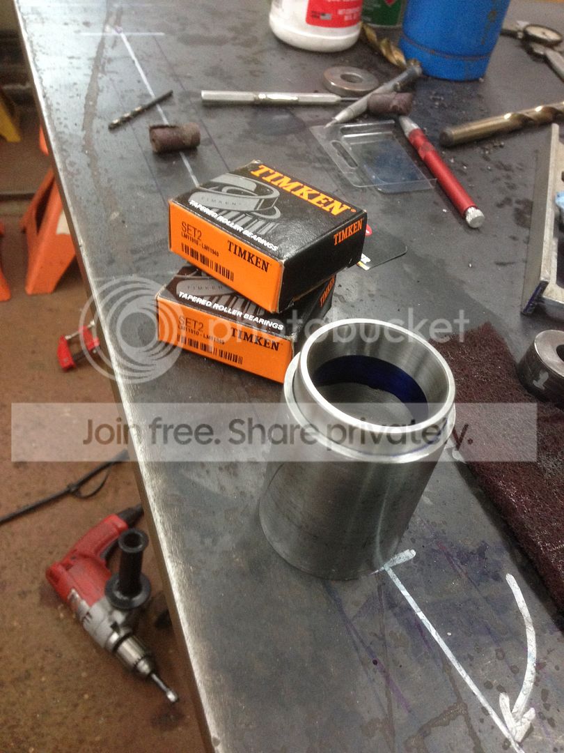

Finally, since I had a bit of time remaining.... (and I'd already done the research and ordered up a couple of bearings) I started on the upper idler pivot....
The bearings have a 3/4" I.D. and the O.D. is reaalllly close to the same dimension as a scrap of 2" x .120" wall DOM that I had laying around. So I spent some time with a few sanding rolls and gently opened up the ID of that tube until the outer race started to drop down in there snugly.
I'll drop a second scrap of 1.75" x .120 wall DOM inside to act as a backstop for the bearing races (on both sides). My target is to have the overall width (including the installed bearings) at 2.25" wide. This will match the width of the heims that are also being installed on that steering idler, so it should keep things nice and uniform.

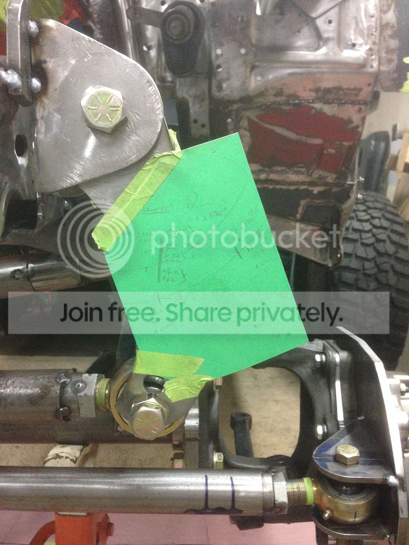

In the meantime, I have been struggling with the last details of the steering system as you can see here:
Here's the back story:
During the time when I was working to resolve my Ackerman steering (or lack thereof)....I disconnected the small draglink (idler) from the rest of the system. This allowed me to hit the steering stops on the knuckles without worrying about bottoming-out on the steering box stops or other interferences.
Since my new WFO steering arm arrived, I decided to drop it into position and start taking some measurements to see where the through-hole should be drilled so that I can get full-steering in both directions (against the knuckle stops). Things began to get weird....
First, I swung the steering against the steering stops (knuckles) on each side and then measured to the existing pitman arm hole (also swinging the pitman to it's internal stops in the same steering direction each time) and the dimensions for hard left turns vs hard right turns were off by more than 2 inches!!!!!! On a hard left turn, the required length for my small idler draglink would be something like 14.875" for a full-right turn, but only 12.125" for a full-left turn!!! :eek1:
As I'm sure most people would do..... I decided that the problem was that the pitman arm must not be "indexed" properly on the steering shaft... and since the WFO arm doesn't have any of those solid keyways to force me to install it a particular way, I could rotate it by one spline at a time until those two lengths were identical..... right? :whistle:
WRONG.
Turns out, all you accomplish by moving the index is changing both numbers to some other value, but you really don't get them any closer to each other.
What DOES work, is changing the relationship between the idler pivot length and the hole spacing of the pitman arm itself......
Originally, I set the idler spacing at 5.5" (top hole where it pivots at the frame) down to the hole where the small upper draglink attaches to it. This value was selected because that is also the hole spacing of my original pitman arm (5.5"). My logic was that since the numbers were identical, the motion of the pitman arm would translate EXACTLY as motion of the idler arm..... In reality, this does not happen. I'm still at a bit of a loss to understand why, but I suspect it has to do with the fact that the pitman arm is travelling in an arc that is different from the arc that the idler arm travels... so the relationship is NOT linear at all.
I started screwing around with the relationship between those hole spacings, increasing the idler.... decreasing the pitman and taking measurements at full-left and full-right turns. Sure enough..... the distance between those holes became more similar to each other. At first, they were almost 2.75" different, but with a bit of trial-and-error I had a combination that got them to around 1/8" different!!! Not bad. :waytogo:
What I learned is that for my particular setup, the ratio of idler to pitman are is around 0.795:1 so if I want a pitman arm to be spaced at 5.17", I need to make sure my idler has hole spacing of 6.50" to make it all work.
Strange stuff.....
-G

I wonder if part of the problem is also that the pivot point on the small "pivot arm" (is that called the idler arm in the picture?) isn't directly above the bolt for the heim on the draglink. Assuming the picture shows everything in the "centered" position, if you draw an imaginary line from the center of the two bolts in your picture, you can see that as the assembly rotates clockwise, the heim end starts moving almost completely horizontally, and just a tiny bit downward. But as the end of the heim moves counterclockwise, the end of the link starts moving upward as well as horizontal as it follows the arc. This is why the horizontal motion being transferred to the tie-rod isn't the same for both directions. If a similar motion difference is at the pitman arm, it could exaggerate the problem even more. Not sure if that makes any sense without a diagram.
