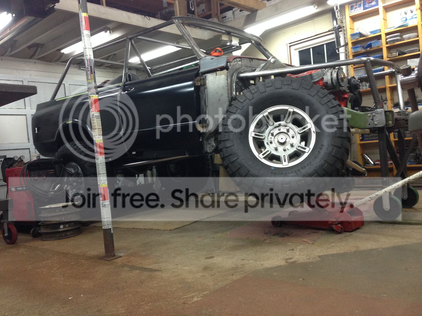

One thing I noticed on mine and you migt want to check that too is the bottom of the radiator support. At full lock and bump, on mine at least it looks like the tire would actually contact the radiatorsupport. So I´ll have to clearance that too. Have you checked on yours?
These 38's only measure out to about 36" diameter. Normally I'd feel cheated, but with as many issues as I'm having getting them to clear I won't complain. If your tires measure more true to their rated size you may have more to deal with than you realize.
I deep-sixed the original core support a long time ago, so I don't have to worry about that, but the radiator is still pretty wide. This is the best photo I have that shows the full-bump hard turn scenario...

How much minimum clearance exactly do you have in any particular position?
Seems like things will move a bit more in the real world of wheeling with your setup, and in the case of leaves, maybe a lot more in the real world!
Just wondered if you should allow a bit of "extra" clearance for such a situation.
The experts seem to think that 1/4" is probably the minimum... I'll have to do a thorough check to see that I am not cutting things too close. But in some areas, there just isn't a whole lot of room left to increase the gaps I've got.

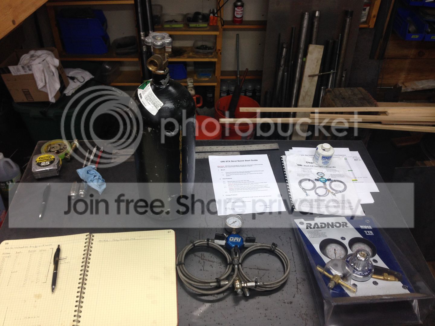

Got a call back from Kirk over at ORI and got the hard facts about the 14" STX travel numbers. As many have claimed, he confirmed the 5/8" chrome stickout at full-compression is the absolute maximum possible compression.....if there's suspension clearance above the axle with that stickout, it's good to go. (I'm still building some kind of crash stops to protect the oilpan just in case). The MAXIMUM droop is 14" of chrome showing.... that's it.
I'm no math whiz, but the difference between those two values is 13-3/8"..... not 14" :whistle:
Mostly, my concern was that the "missing" 5/8" was actually hiding in the upper bumpstop which would have eventually been catastrophic. Kirk explained that in reality, when the STXs were beefed-up a while back, the extra materials ended up stealing some of that total travel out of the strut.... so when you buy a 14" strut, it's actually 13-3/8" total travel. Not a big deal to me (especially considering how many tire interferences I've already seen..... but for those of you shopping for ORI's in the future, it's good information to know.... The STX's run 5/8" shorter than the advertised lengths... so move up a size if that bothers you. :waytogo:

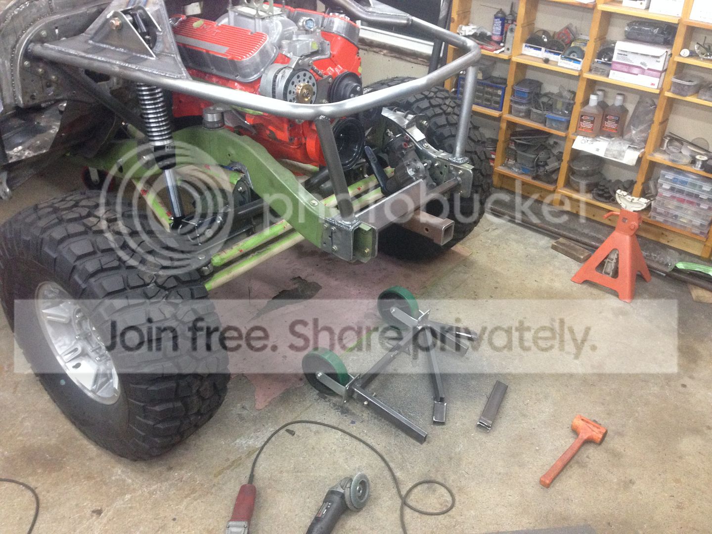

So...... armed with that information, it was clear that I didn't need to scramble to raise my lower strut mounts, and since everything in the front suspension was looking good and the cycling tests were successful, there were no more excuses!

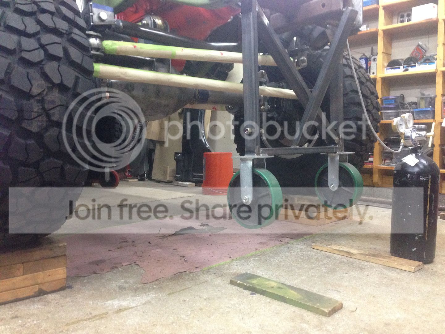

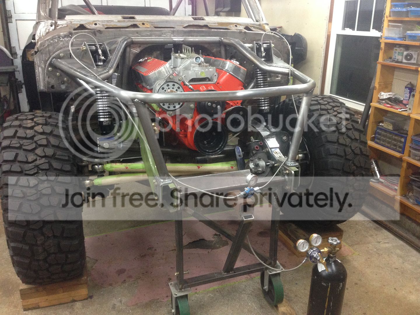

I read the charging directions a few times, and decided to give it a shot.... Here's the setup..... (the instructions said to start with the strut fully compressed, and since I couldn't lower the truck because of the front casters, I put 6" of blocking under each tire to accomplish the same thing.)
READY FOR LIFTOFF!!!.......
10......9......8......7.....6......5......4...3....2.....1..... Liftoff!!! :D
Here's the super-shortcut ORI Strut Charging process that I ended up learning after making a few mistakes along the way.
Step 1: Put a 90 psi charge in the lower fittings. This is produces a small amount of damping but since it is pushing UP, it does not change the ride height of the truck
Step 2: Put a much larger PSI into the upper fittings to extend the strut and to lift the weight of the truck into the air! For me, this ended up being around 300psi to get the truck to ride height. Based on some quick math, knowing that the piston diameter of these struts is 2" (each) that means that the total weight (sprung mass) of the front end is around 1885 Lbs as it sits in these photos.... obviously, the truck weighs more since axles/wheels/tires are not factored into that number.
That's pretty much it. There are a lot of shutoff valves and diverters on the nitrogen dual-fill kit, so it takes a while to get comfortable with the sequences for adding or removing pressure without accidentally overfilling or dumping pressure....

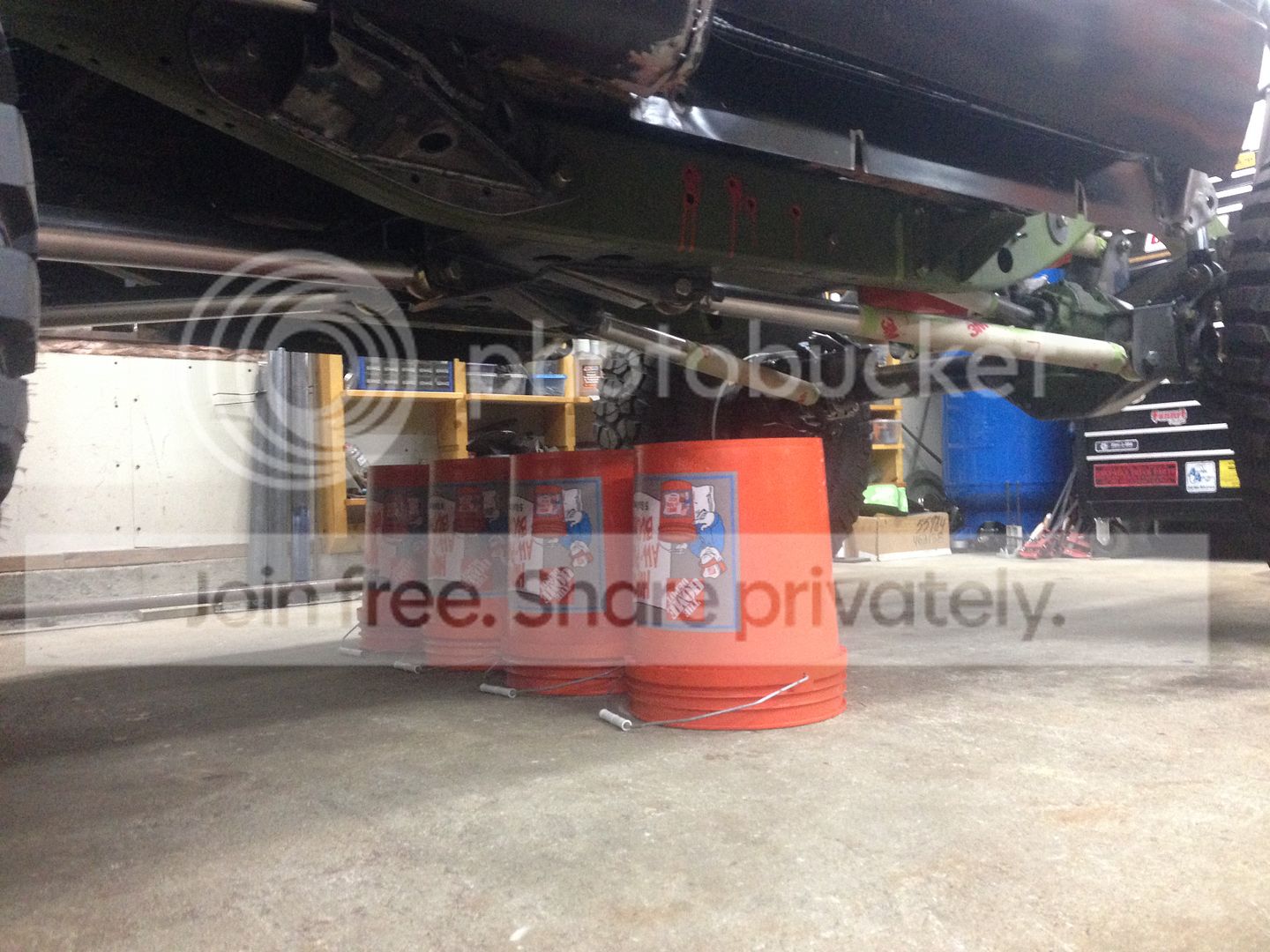

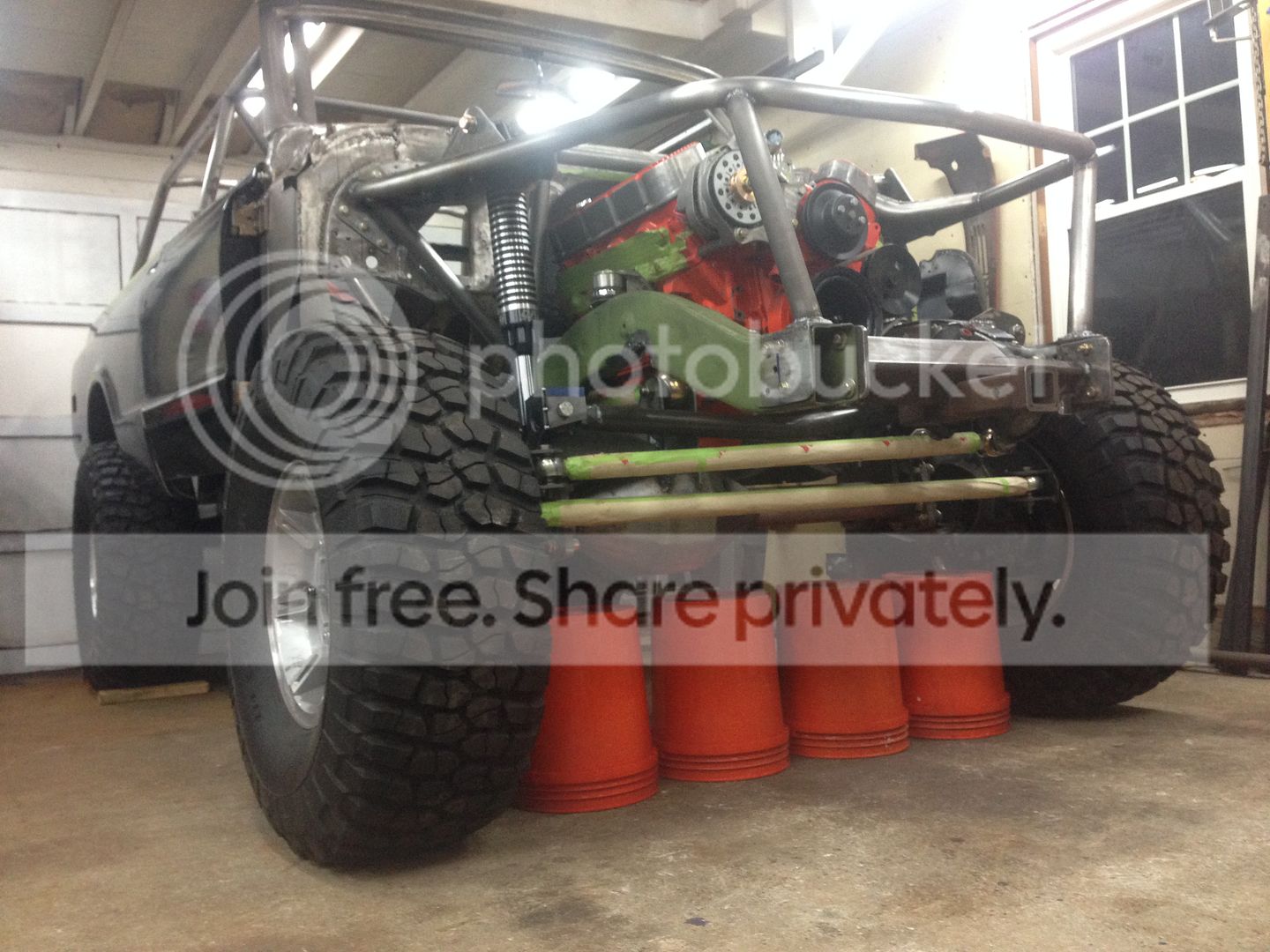

Something I've been waiting for a LONG TIME to actually do..... (It's been 6 years since this truck has sat on it's own wheels without jackstands or casters....but who's counting??) :D
And since they are all the rage on social media these days..... I decided to do my own "Bucket Challenge" to celebrate this important milestone.
FOUR BUCKETS.....NO PROBLEM!!!!
.....and from a different view with the truck pushed a bit deeper into the garage.
I have said before that the photographs don't always express how much clearance the truck has with the portal axles and this suspension design... but I think that these photos may actually do a pretty good job of providing some perspective and scale.... :thinking:

That last shot is beautiful man! Great milestone to hit and a long time coming. Gratz man!
Oh I've been watching you young man! lol
That is an awesome feeling to have it back on its wheels again after links alone, not to mention everything else you have done to it in the meantime. Congratulations are in order there, you deserve it! :waytogo: :woot:
Also, I think I missed this part of the build, but it appears the back is already charged up previously or are the shocks not mounted yet, just the links with something else holding the body up? I mean, all you have to do now is roll it outside for a pic?

Outstanding Clearance man! :bow::bow: Great work! :thumb:

Love how flat everything is under it! And the insane clearance! :bow:

There is just a small "slight of hand" going on to get the truck on all-fours... but I've confessed to it in previous threads. YES, I built small standoffs for the rear axle to set the ride height. At the time when I finished the rear axle trussing and got the axle slung underneath the truck I was pretty burnt-out on that part of the project and wanted a change of scenery. To be fair, those standoffs have been there since the LAST time this truck was outdoors.... so it's not like I pulled a fast-one on you guys, just to get myself some "prouds" today. :haha:

Wow!! That looks fantastic! I like the clearance reference with the 5 gallon pails. Some years ago I was behind a construction trailer that lost a 5 gallon bucket, as it tumbled in front of me I thought I had enough axle clearance to miss it. It must have stopped tumbling on an end just as I made contact, but worse, it must have been what was being used for a toilet on the job site. I spent the next hour power washing the underneath of that truck for my miscalculation......
