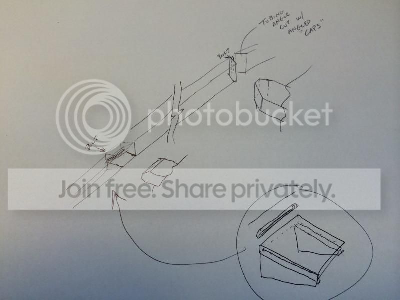

Are you envisioning the taper to be conical or two planes?
If it were to be intersecting planes instead of conical, here is one way that I envision you could get there...
I'm not sure how many mounts you are envisioning - but if it were to be just two, you could incorporate the diamond pin style set up...
Here is quick sketch of what I'm thinking...

Another question - now that you have me thinking about this!
Ben,
I'm trying to keep this simple (HAHAHAHAHA, right?)....
I selected the 2" x .500" wall DOM for my tapered solution (conical) because I already own the material. It was used to build my rear lower links originally, so I've got about 8' of it just sitting around now.
What I like about it is that it adds a LOT of wall thickness to the areas in that square tubing where Heath reminded me that I'd lost a lot of strength. It also has a 1/2" hole already running through the center of it, so I can get that tapped for whatever the next largest thread size/pitch bolt is. It seems like I can use that same material for the "male" portion of this setup as well.... so from a materials cost perspective, this experiment is basically free.
I just need to find someone locally to do the machine work and make those tapers for me. I have no idea how complex (or simple) that type of machine process is, or what it will cost to have done... but obviously, I'll need 10 of each part to swap into both rockers. The other nice thing, is that the rework is minimal to incorporate this new design. I just need to grind out a few spot welds on the current 2" DOM sleeves and pop them out... then slide these new machined pieces in place. :waytogo:
-G
Ben,
-G

I like the taper idea but the receiver tube still has some merit as well.
You can split the male portion of the receiver tube and make a hole at the end of the split. Then weld nuts inside the male half.
Once you've done that, you can bolt the receiver the male end into the female end for a real tight fit with no alignment issues.
