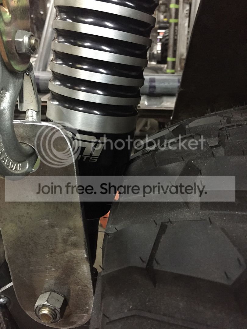

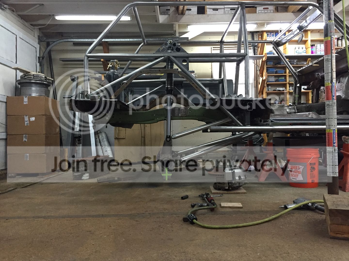

I wouldn't be comfortable with that clearance on the tire. Like you said you could do another .5 on the wheels. I would do that and move the mount in. Then back to cycling
Not to mention it doesn't look like the strut is fully compressed, it will get worse.

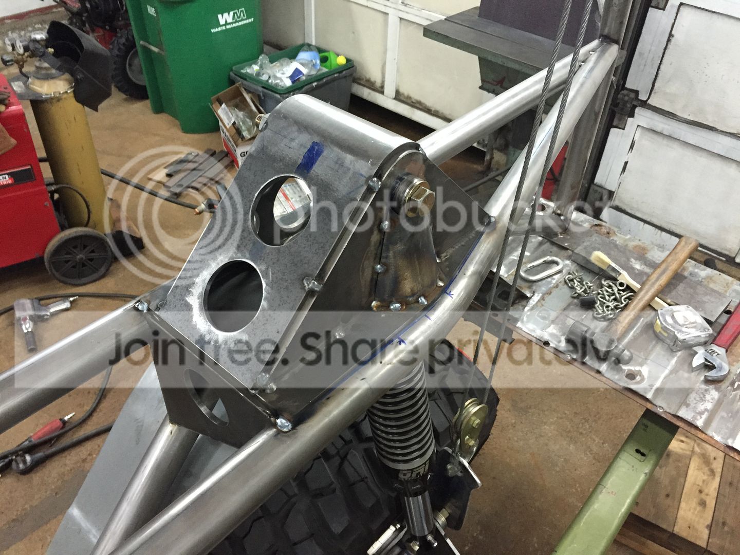

Why is the strut mounted so high on the axle? If you mounted it directly to axle and not the upper link mount, you wouldn't have to mount them so high. That would eliminate all the problems of sealing the hole and possibly make more room in the back.![]()
I´m working on a cantileaver setup for my rear suspension, that way nothing will go through the bed. (so that even more plywood can fit!!!)![]()

Good luck with that. I spent quite a bit of time considering a cantilever setup too, motivated by the compact packaging and ability to preserve my interior floor space. The more I studied the design the more I realized that it creates a complex association between the strut and the axle due to the asymmetrical lengths of the bellcranks. Figuring out the motion ratios, and their effects on the shock shaft speeds started to get complicated....and the physical size of those bellcranks ends up being pretty large when you want to use long travel struts. IMHO it sort of defeats the purpose of a cantilevered system. It would be better to use a shorter travel strut and let the motion ratio of the bellcranks magnify the total wheel travel.
Well, good thing I´ve raced downhill MTBs before and they all have cantilever suspension on them. So I´m used to tuning the suspension on these for different tracks. But ultimately I would see King for a tuning session to get it dialed in perfectly!
Being an automotive engineer, it helps with figuring out the suspension curves and whet the bell crank needs to look like, what the ratio needs to be, etc.
Of course at that point you are tuning with a stiffer spring and dampening rates to compensate (assuming a coilover setup) -> yes coilovers on all 4 corners. and unless you know what you're doing or have access to a local KING or FOX technical rep, the odds of getting it tuned properly are pretty slim. That was a big turnoff with coil overs initially for me..... They cost a fortune, but only deliver their peak performance if you spend the time to valve them properly and do all the tuning work.
and I'm all about saving money on this build!I can totally see that!
Cantilever has some cool benefits but it also creates it's own problems and eats up a lot of valueable space underneath the truck. It also ends up right where my 30 gallon custom fuel tank needs to go.
good thing my saddle tanks are gone and have been replaced with a 45 gal fuel cell behind the rear axle. So I have way more room behind the cab outside of the frame now than I could ever use up! Heck, I can fit a 2.5" coilover, a 3" bypass and 2.5" hydraulic bumps all in there! The cantilever air helper springs will have to go on the inside of the frame though. but I have quite a bit more length in the chassis than you do!
I just like the idea of a long travel setup (16-20" of travel) but kkeep the bed 100% usable and stock looking!

Like I said.... good luck.
It's one thing to be an automotive engineer, it's quite another to actually get it off the paper (or computer) and onto an actual vehicle.

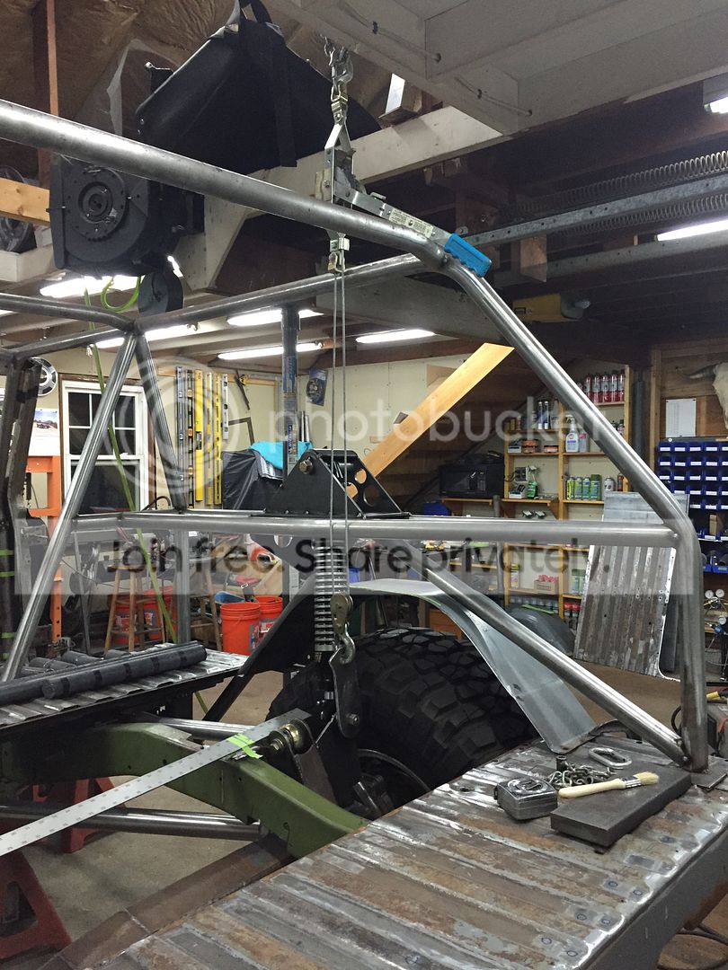

So I cobbled a quick mounting plate so that I could run the bolt in the correct orientation and then tried to get the axle fully articulated. It's never easy to cycle a suspension with a floor jack, so I made another quick plate from some "tuition metal" that allowed me to lift the axle from above directly from the lower strut mounting point....
) I figured that it could be deployed to get me some REAL clearance.....
