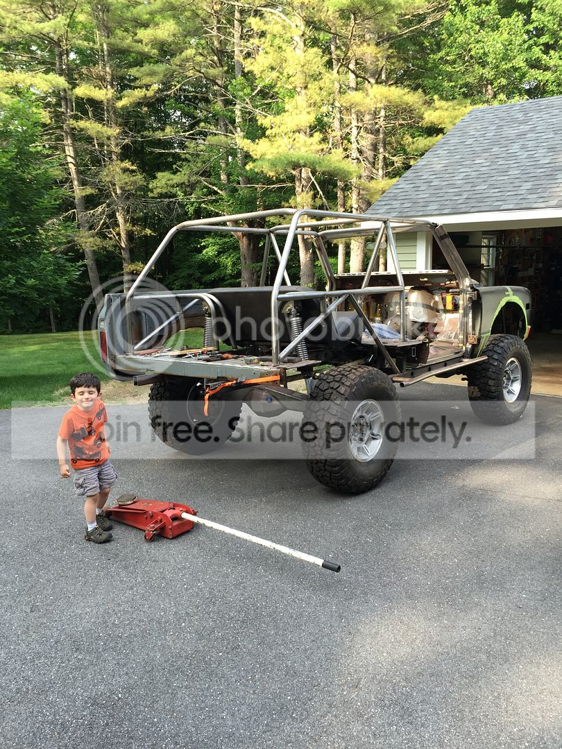

However; those shock tube plates simply don't fit this build (or did I miss something??)...I mean for all the other "just throw it together and drive it" (like mine) builds going on it would be fine; but that corner hanging out over the frame just don't fit in my eyes...RESPECTFULLY....this build demands more!
I think he could tie those two corners together with a nice crossmember and the slight visual issue would be fixed. But in this case I can see the "function before form" in the way it is now. Might even be a good spot to put some threaded holes that can be used to hold down the giant gas tank cover?
I agree a cross member would fit nice there, but I also agree with Zimm almost seems to not fit visually just hanging out there
I didn't want to leave you guys hanging without at least showing you a couple "outdoor" shots now that the truck is fully on all 4 wheels.
Charlie dragged the floor jack back outside so we could lift each other up and down again. He loves that game... :D

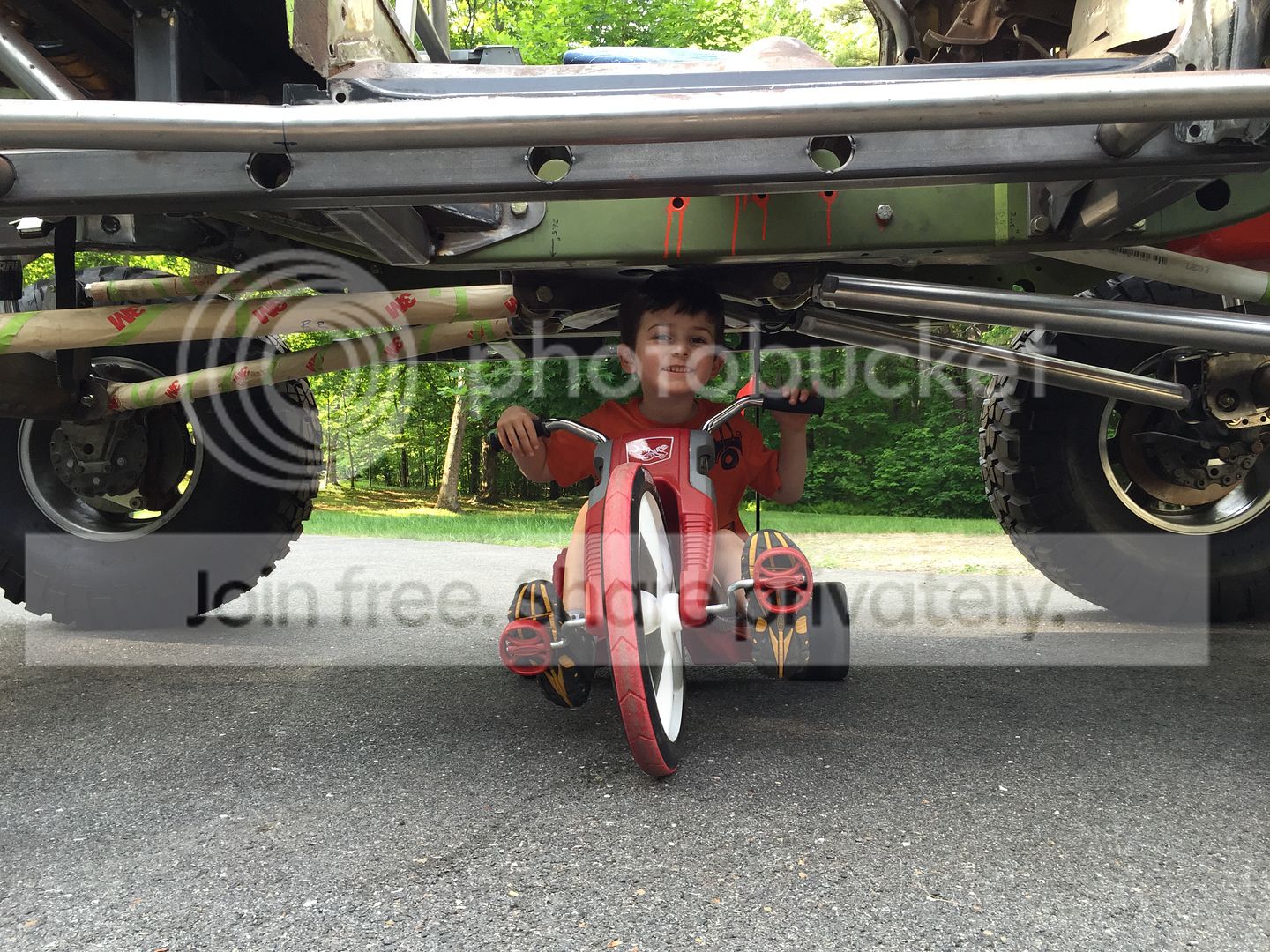

And here he is checking the underbelly clearance at normal ride height. This is what we now refer to as "1 Charlie Big Wheel Height"...

Greg, I resonate the previous comments by all the others.
Zim,
Those plates will be supported from underneath with gussets... just haven't gotten around to installing them yet. No worries!
Probably not a crossmember, but I will at least brace them from the underside as I've mentioned in previous posts (and to Dave a couple responses above this).....
Personally I would have done the same thing.
I would rather have a symmetrical assembly and box or do something where that rear tube landed.
You end up bending four like pieces rather than two pairs,and it will flow better visually once the floor is in.
