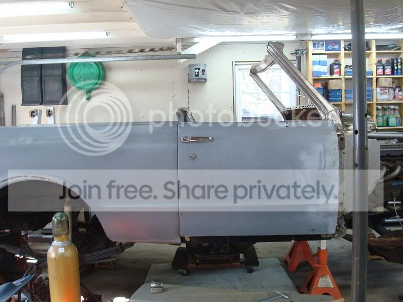

Stock door for reference (Glass, wing window and a-pillar support have already been removed)

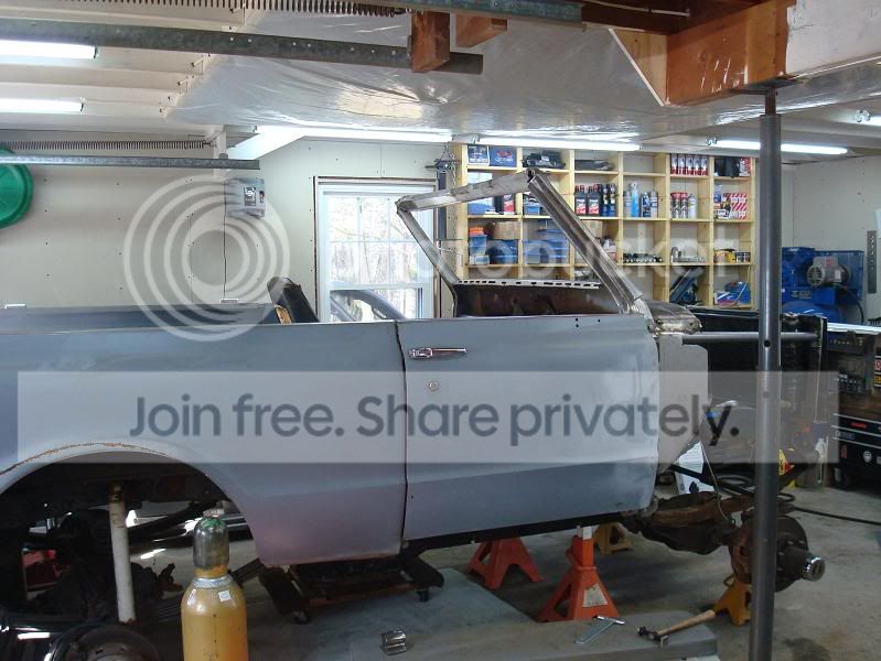

A few minutes with a Sharpie marker and a cutoff wheel, and a few more minutes with a hammer & dolly to create the same radius as the rear quarterpanel bedrail has:

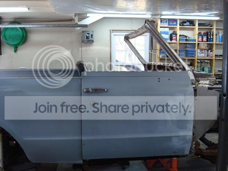

And another slightly different angle to show the new "lines"...
The result is freaking beautiful! :saweet: I absolutely LOVE how much smoother and nicer the truck looks in a profile shot now.... enough that it doesn't even bother me that now there's no way stock glass will work anymore, and I'll have to come up with a different way to keep rain out. Being a few inches lower will also make it a lot more comfortable to use as an armrest.
