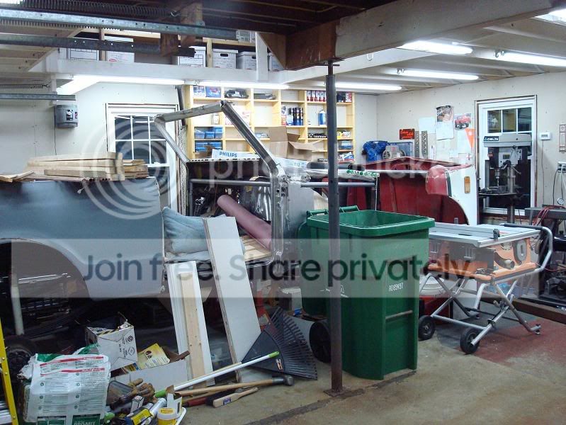

As my real life took over these last few weeks, the man space has fallen into disrepair, and chaos...
Some of that stuff has no place in the manspace...(ie. Peat Moss, garden tools, wood scraps) but even so, as I acquire more parts for this build, I'm finding less and less useful space to store things that belong.

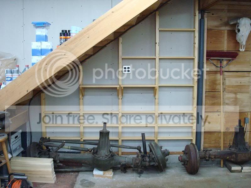

I spent the last couple days on a mudane task, but one that should help me stay organized as I start the next big "push" on this build..... more shelves! :saweet:

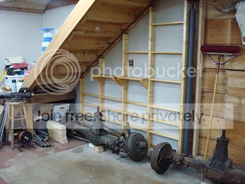

Since I was out of room on the left side of the shop, I had no choice but to find some space on the right. Here's what I ended up with as of tonight:
This will allow me to store my tall items away from the build-area on the opposite side of the shop... I've got tons of rattlecans of paint, solvents and other things that were just cluttering up my benches. Now I think there is space for everything.
Astute viewers will notice that two of the shelves are substantially deeper than the others with some extra bracing.... one is for my "manspace microwave" and the other is for my Apple HiFi Ipod boombox (one of the most enjoyable gifts I've ever received). Having hot coffee, hot pizza slices and some good, loud rock-n-roll are every bit as important as a 4-1/2" grinder and a 220V welder IMHO... :D

The manspace is turning out great, Greg! Really digging the shelving, wish I had a garage of my own! I will have to agree about the music, DEFINITELY helps me!
did i miss something, but what axels are those?
I don't know much about them, but think I've seen them before elsewhere. Are those unimogs?

As you might have noticed in the photos, I have a tablesaw now....it was finally time to buy a dado set too, and that made the cuts SO much easier (and faster) than last time with the router and 3/4" bit.

Those are the Mog 404 axles. I've had them forever and I'll be using them as donors to build a set of Mog-9 portals (Ford 9" centersection / Mog outers)......someday.
