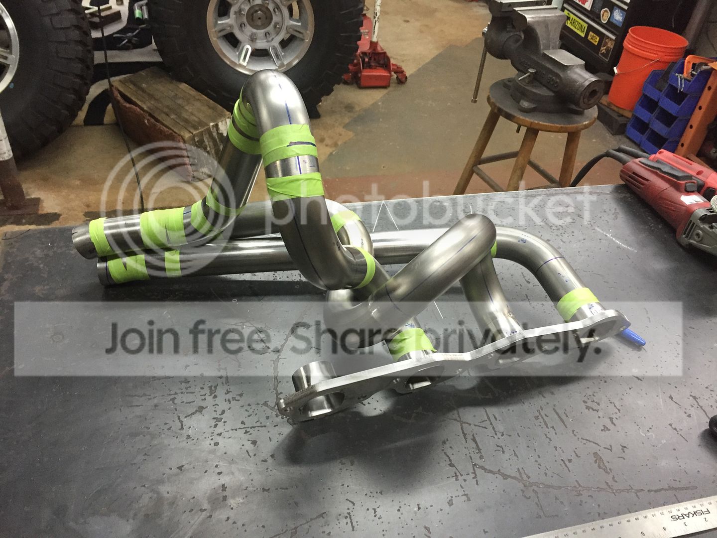

On the bench with the first 3 primaries roughed-in. Cylinder #7 is still notably absent!! :D

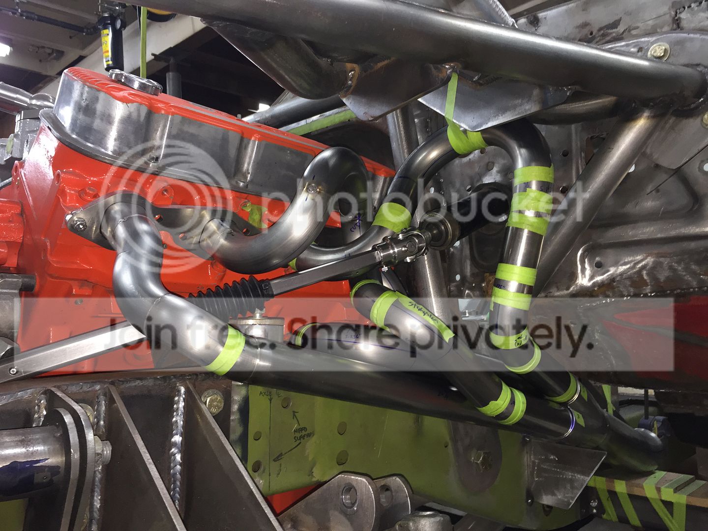

From the back side... here you can see how I was trying to keep sparkplug access to the #5 cylinder as clear as possible, but there just isn't much room anymore.

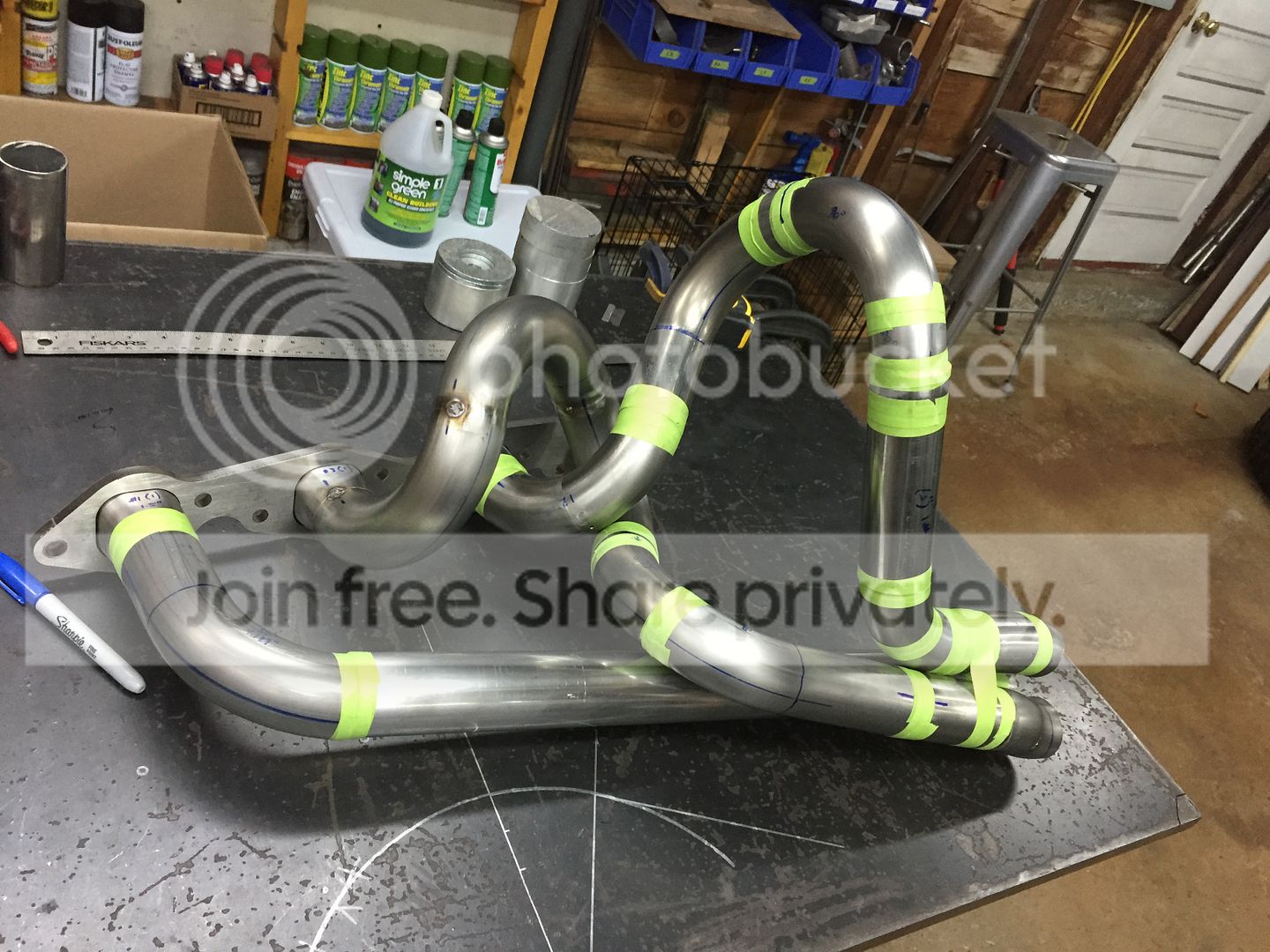

Generally when I'm building headers, I try to get a feel for the routing of the tubes, and then tack-weld at least the first few segments in place on the exhaust flange to create a starting point. Otherwise, there are SO many taped joints that the whole thing just flops around and you don't get a realistic feel for the clearances or dimensions anyway. :)
Here is where I put those partially welded tubes back on the truck and did a lot of work to get the #7 figured out since I hadn't even done a mock-up of that one previously. As it turns out, not only did I find room for it but it ended up being over 34" long!!!! Pretty close to "perfect" and impressive considering how close it is (in absolute distance) to the collector.
So....with LOTS of 3M Green Tape and sample bends I finally got all 4 primaries in place in a believable way...
From that template, there are some small tweaks that I will do in the final design. I want to clean up some of the angles as the 4 primaries come into the collector so that the whole thing looks a little "cleaner" and more tight, but generally I can see that the routing works.... the individual lengths are all within very close tolerances of the 36" target values and the whole thing sits high enough that the tire sidewall won't rub against it under extreme articulation! :bow:

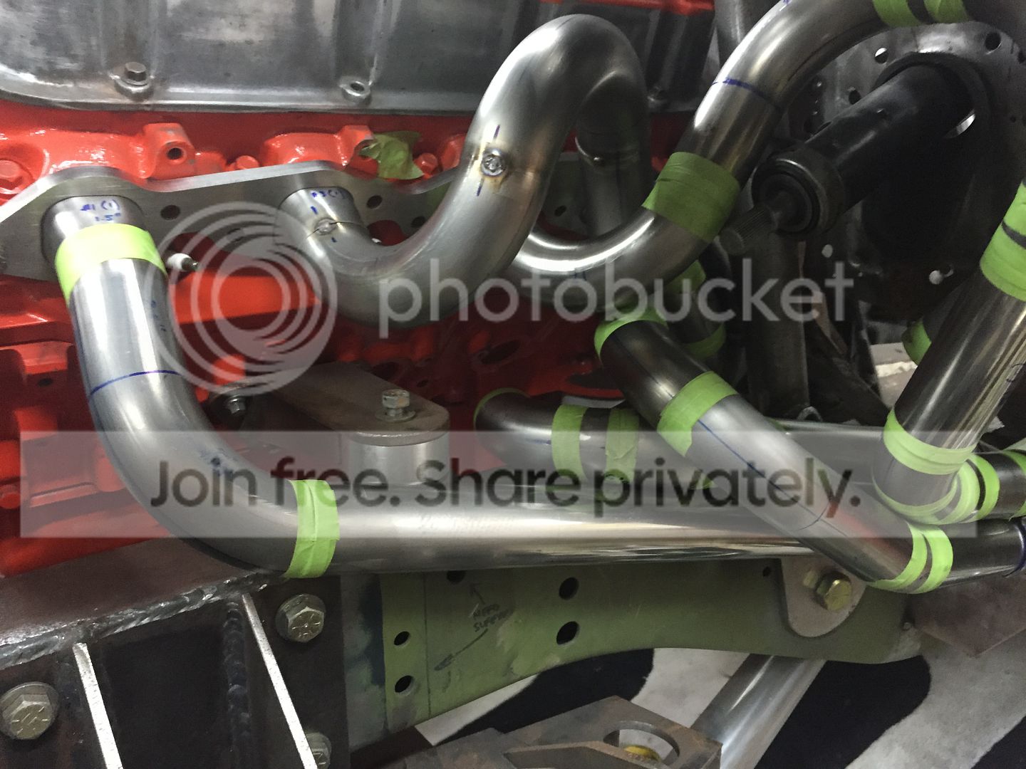

It was time to disassemble the primaries and start building it FOR REAL... I like to start on the two rear tubes first (the ones closest to the framerail) since they are the hardest ones to reach later on, and ultimately they establish the clearances from the frame that I need to work with anyway. Here's how #1 and #7 went in (I put the steering shaft in there quite a few times to confirm clearances)

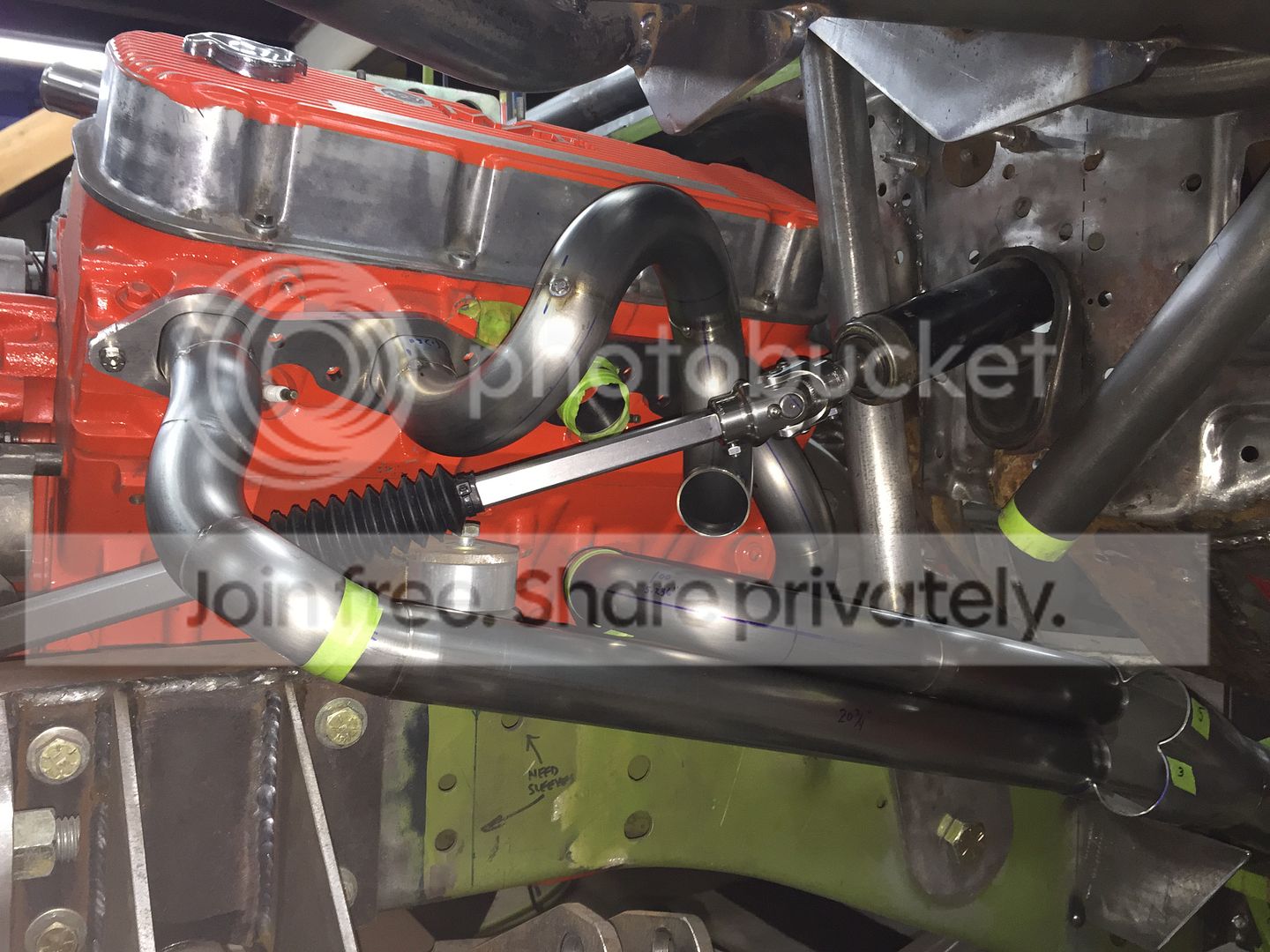

Once those were fully tack welded, I dropped #3 & #5 back into the mix for a sanity check:
