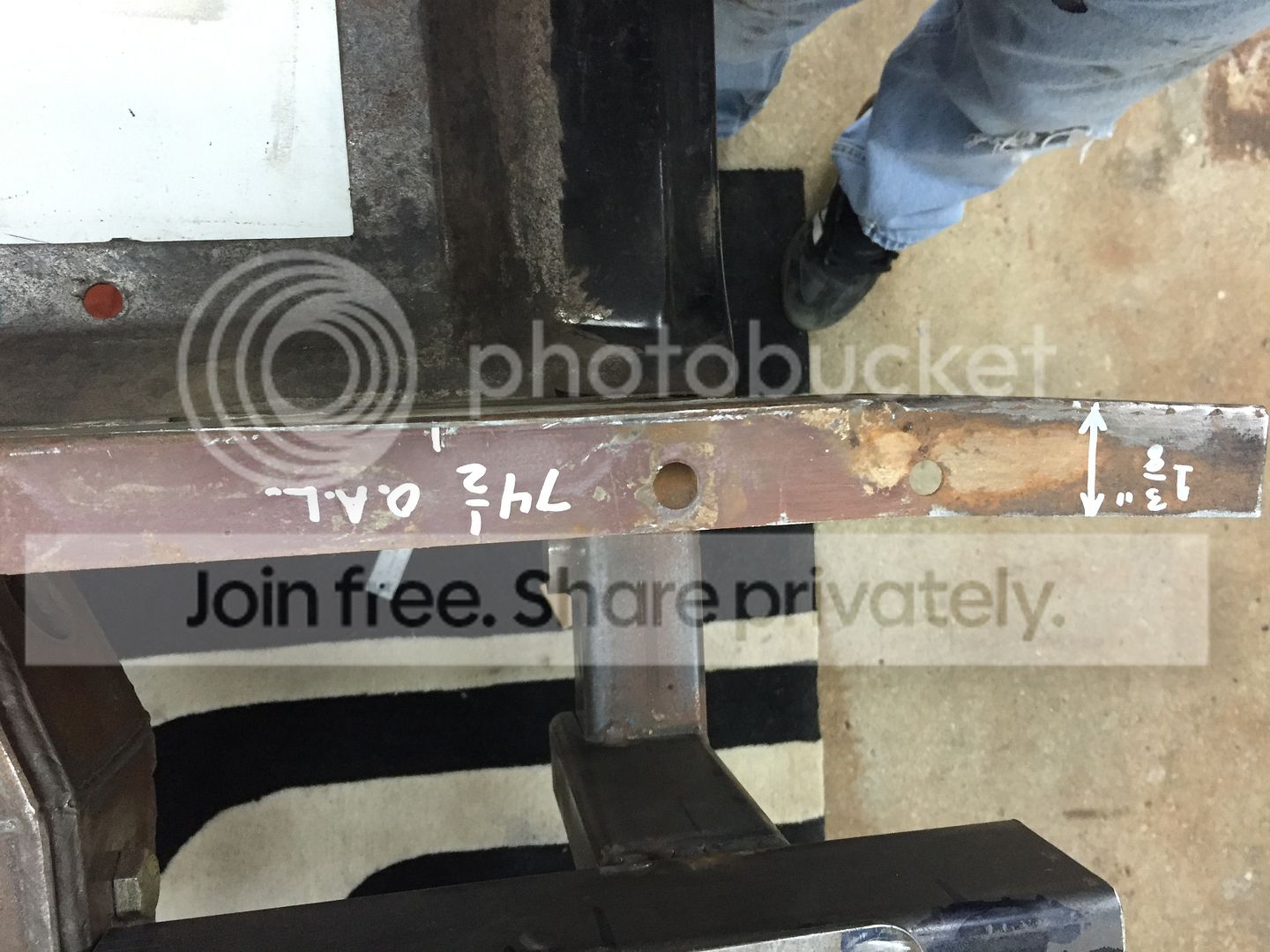

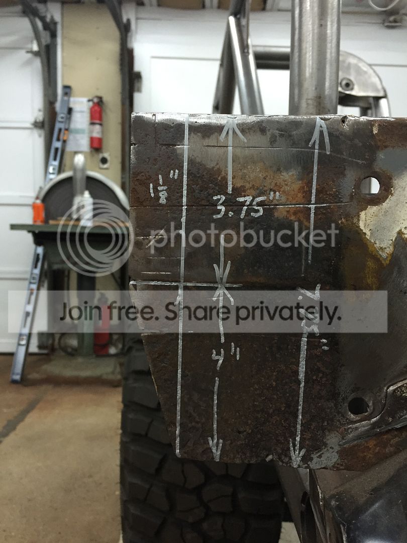

The vertical step panel is in pretty rough shape and since the part is backordered, and isn't really the final shape I want anyway, measurements were taken so that it could be replicated / modified in a fresh piece of steel.

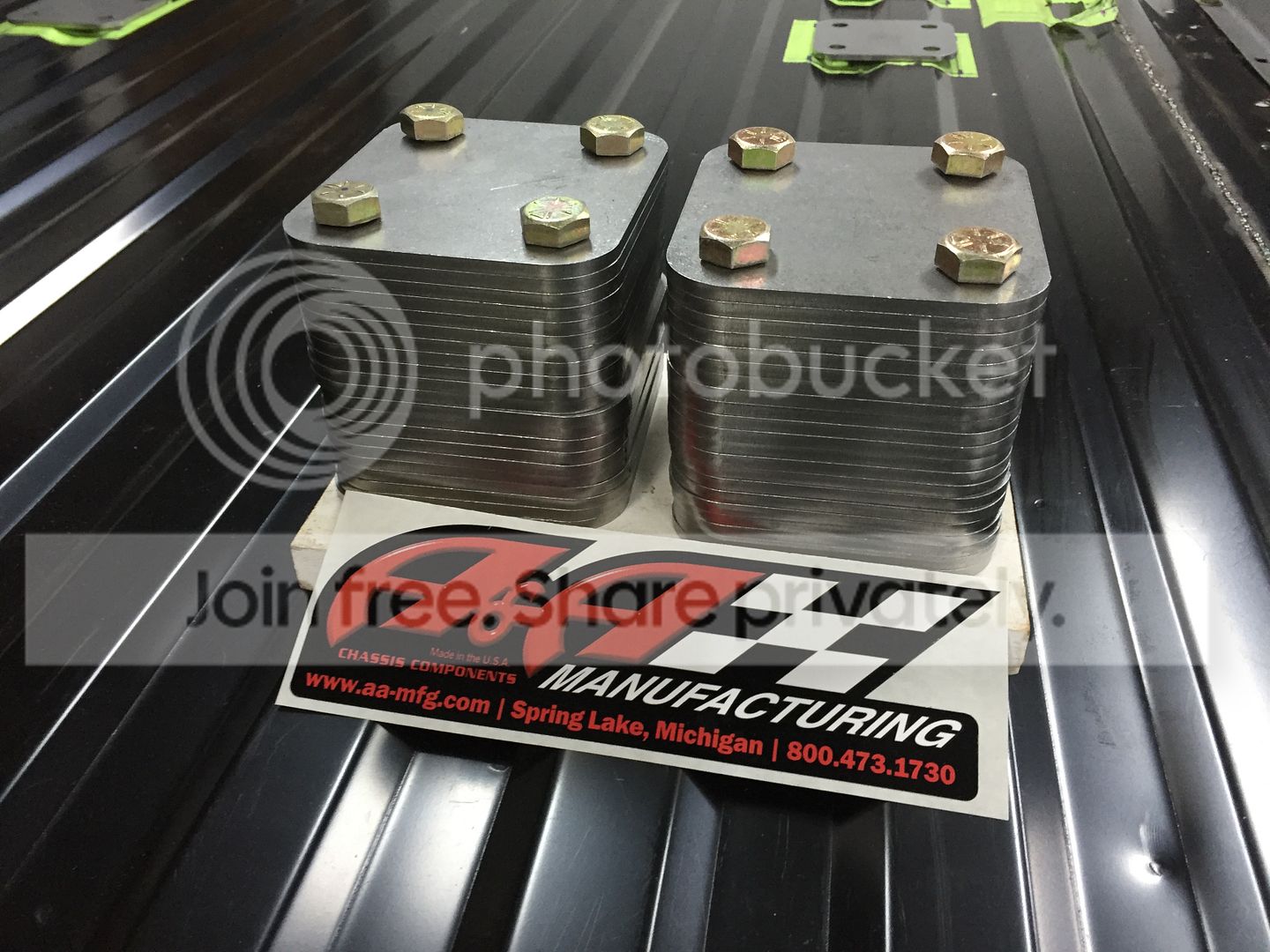

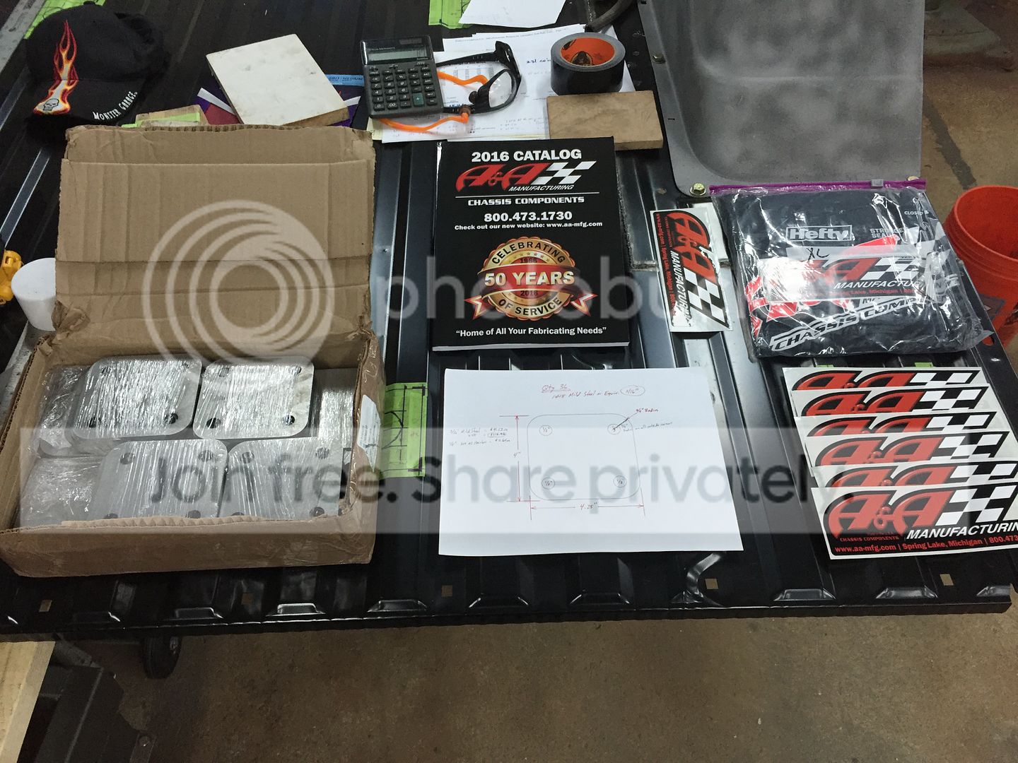

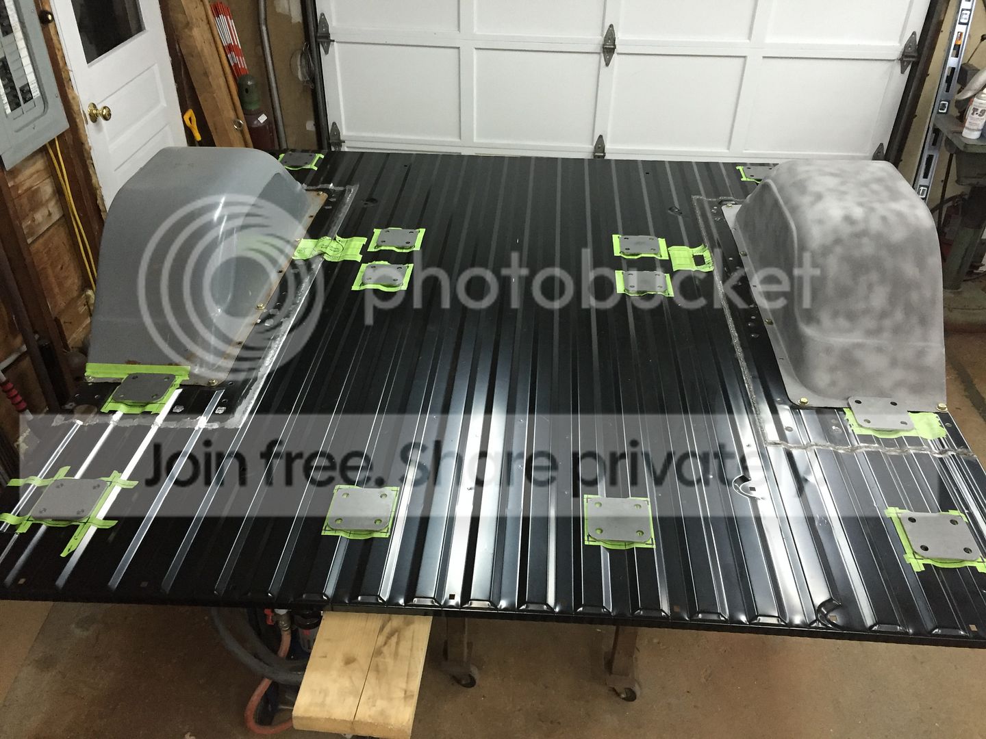

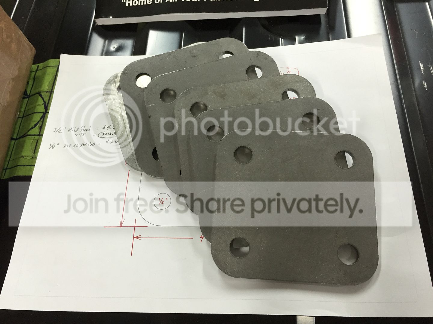

Just flat plates? I thought you were doing something to puzzle piece them to the floor contours?
Don't get me wrong, they look nice just not what I was expecting.
Out of curiosity, what was different about these plates from the stock stuff they had on the shelf?
