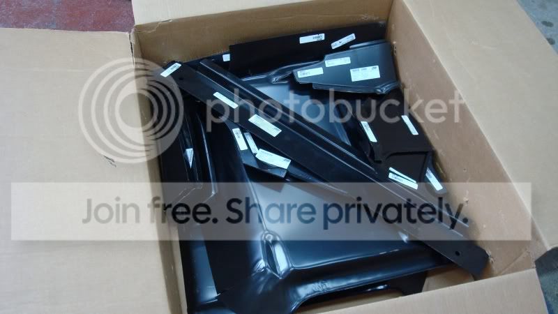

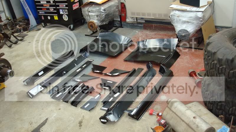

First, here's what a box of reproduction Blazer sheetmetal looks like
And here's how it looks when you spread it all out to admire it...
That pile contains all the "basics" for 1st Gen rust repair: Front floor sheetmetal, Front cab supports, Door jams w/integral inner rocker (nice!) and the outer rocker panels. Some smaller triangles are for patchwork of the vertical footwell areas, and there are some parts to go up into the B-pillar area as a tranistion from the rocker panel itself. Almost everyone needs these parts once they commit to doing rust repair. The lucky folks can stop here....the less fortunate need a LOT more than this to complete the job.

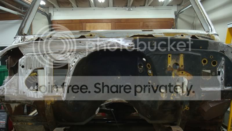

Seeing as how I am not feeling 100% yet, and don't quite feel like diving all the way into those new panel replacements quite yet. I decided to practice a little more sheetmetal welding (aka: burning holes in 18GA). I started removing the extra lip from the firewall where it is spotwelded to the cowl.

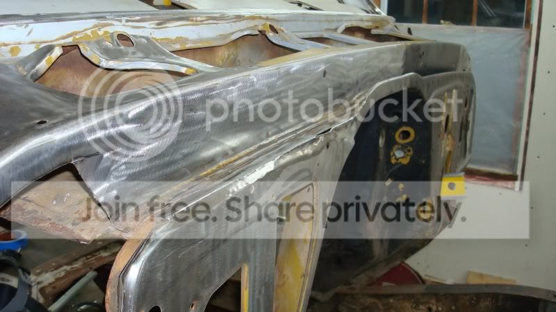

Here's a shot of that vertical lip ground all the way off (passenger side) and welded up:

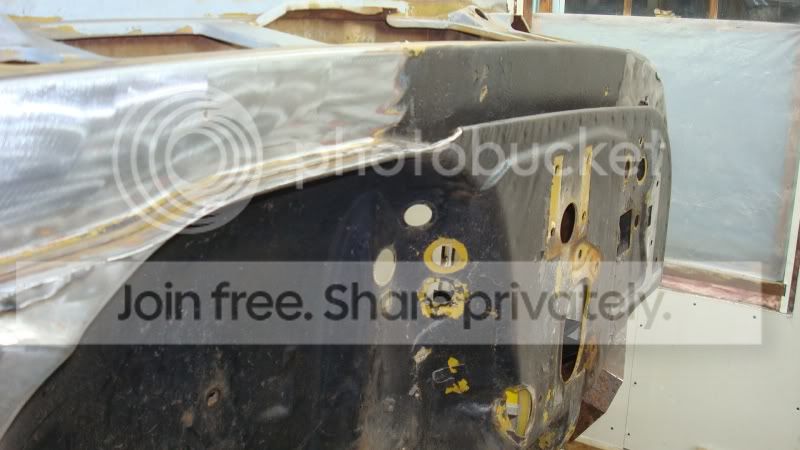

Another shot to help show the original vs. new configuration... you can see how it transitions from the modified section just as it gets to the drivers side of the cowl, just above the mounting holes for the gas pedal:
One last attempt to show the change. It gets a bit strange in the center, since it's basically just two horizontal pieces of 18GA sandwiched together....very delicate looking...

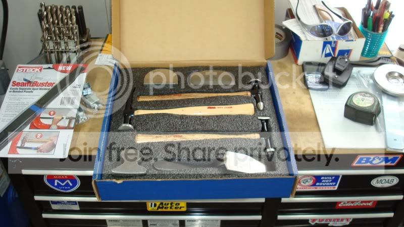

I picked up a set of nice Martin hammers & dollies from Sears. I've reached the part of the project where these are a must. As you can also see, I bought a seam busting tool which has proven to be VERY valuable already....

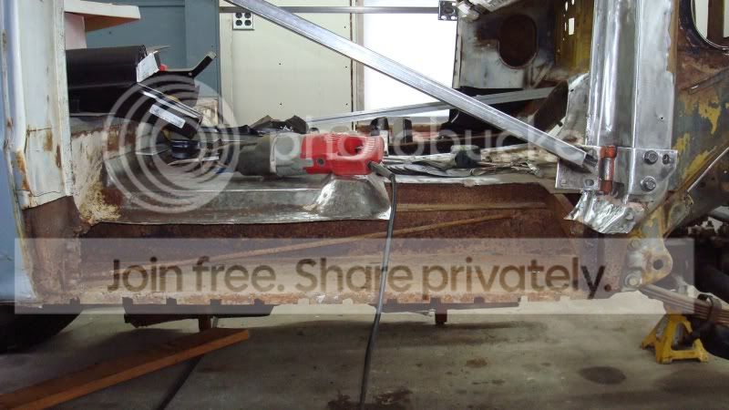

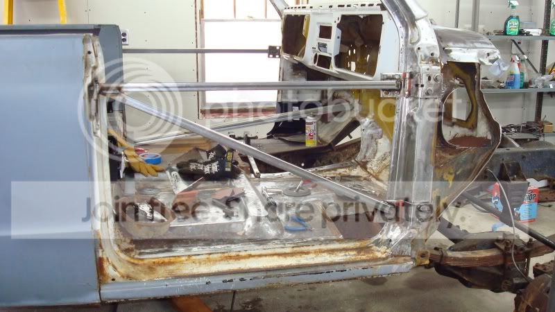

Start of the day photo: This is what you've seen before. Just a truck needing attention, but not getting it...since I was sick with the flu for the past week. The first thing I had to do was add a diagonal brace to my door bar, since I knew I'd need all the extra structural support I could get later on today.

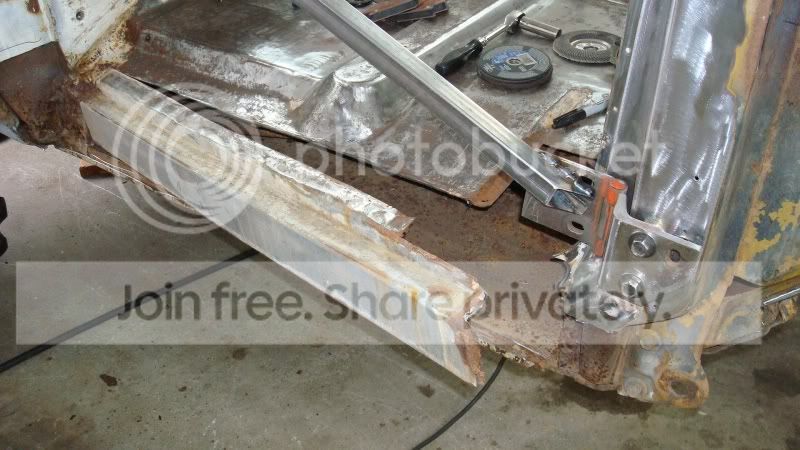

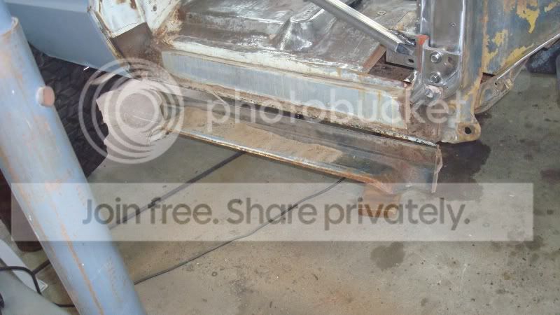

Nothing left to do now but cut off that outer rocker and embrace the horror... Nice Beach! :wink1: Plus a better shot of a "non-factory" galvanized inner rocker repair. Creative, but poorly executed.

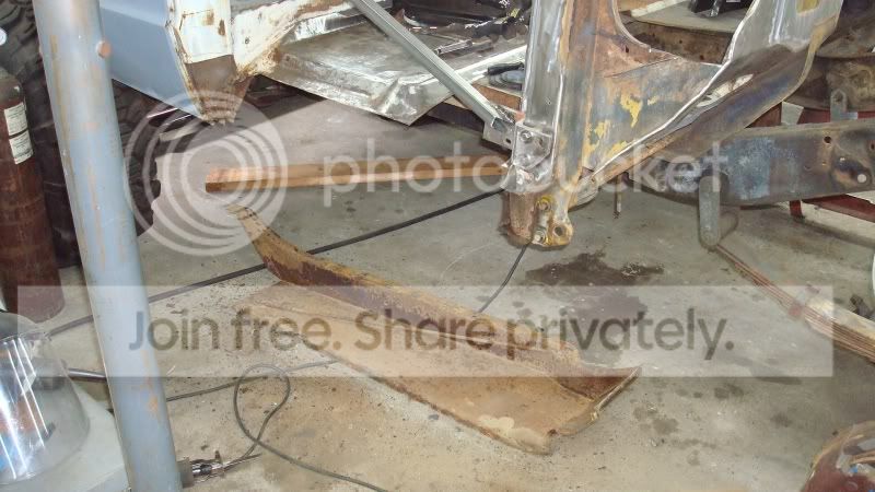

....Might as well drop that torsion box like a bad habit:

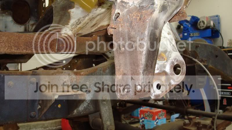

After a LOT of careful cutting and gently prying in the "Four Bolts" area of the front cab support, I was able to free up the backing washer that was originally sandwiched between the inner rocker, outer rocker and cab support sheetmetal. Here's a shot to reference where it will go on the replacement part:
And here's the final shot of the "Four Bolts" area after a LOT of gentle work and PB Blaster on the bolts....
You can actually see through the brace on the lower left corner, just above the welded nut. The metal is VERY tender in that area.....it's paper thin and it was hard to get the rusty bolts out without tearing that whole lower corner off.
