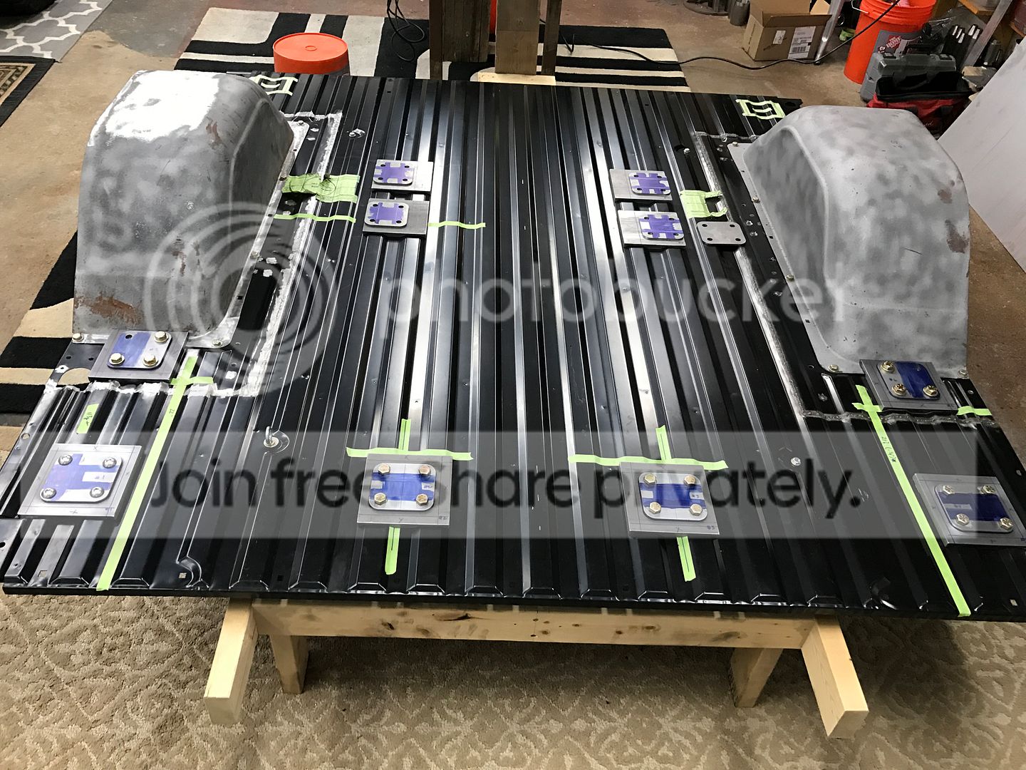

These days, it's all about getting the convoluted cage plates into position and all the through-holes drilled properly. As of last night 6 of the 12-positions are completely bolted down, with 4 more marked and ready for drilling and bolts.
It's getting closer and closer.
The amount of weight being added to this floor is not trivial and it's been bugging me for a while. After a few quick calcs, the answer was more obvious... the total weight of 12 pairs of 1/2" thick steel (6" x 6") plates is 92 Lbs!!! :yikes:
It's also becoming obvious that there really isn't any value is making the convoluted plate WAY larger than the (4" x 4.25") cage foot itself. It's just adding a lot of extra weight and making everything look more "clunky" than I was hoping for... so it was decided that the plates will be trimmed down to more reasonable dimensions at each of the 12 mounting positions which will cut the weight from about 7.5Lbs (per plate pair) to 4.5Lbs.... for a total weight reduction of 37Lbs....!!! The end-result will look nicer, and the reduction of unnecessary weight will be a welcome fix also.
For now, the plates are all going in at full-size for simplicity.... and once they are all figured out and precisely installed, they will get marked, removed, cut and edge-finished.... then dropped back into place for final welding.
It's going to be nice to have this floor fully-prepped, and ready to go.... I can already imagine how tempting it's going to feel to get the bedfloor dropped into place on the truck once the sun is shining.... and once the bedfloor goes on.... the rear quarterpanels can be rehung, and the whole truck starts to look a whole lot like a "truck" again. And THAT will really start to fire up the motivation heading into the spring and summer months!!!

And now I know the answer to the question "how does adding 55 lbs reduce weight by 37 lbs?" then something didn't look right....
I went back and did maths... an aside, I hate maths.... 12x7.5 = 90 lbs, or less since it was "about" 7.5 lbs. I figured maybe you rounded up like I do with my weight loss... and I was right. 4.5x12=60 lbs for a net weight 'loss' of 30 lbs.... or, in my weight-loss parlance.... I've lost 50 lbs (rounding up). So really, since it's steel and we all know steel is heavier then fat - you lost 100 lbs, you best anchor your rig to the ground or it'll float away soon :)

All original convoluted cageplates were cut from 1/2" thick steel, into 6" x 6" squares, and were machined with 1/4" slots to follow the floor profile. When you interlock a "pair" of plates, you get a total thickness of .750" per set
Stack up all 12 sets into a nice neat pile and it sits 9" high, 6" wide and 6" deep... or 324 cu in. Throwing that into an online materials calculator for steel gave me 92 Lbs.
Cutting the plates down to a smaller footprint (4.5" x 4.75") with the same thicknes as before yields 192 cu in.... for a total weight of 55 Lbs.
The difference being the 37Lbs that was originally referenced......
What probably threw you off was that I took some liberties in decribing the "per plate pair".... the actual weight for the original plates is 7.66667 Lbs, and the new plates weigh in at 4.583333 Lbs. :waytogo: (I should probably also remove the weight of the four 1/2" diameter holes per plate, but it felt "close enough" for purposes of this thread)
