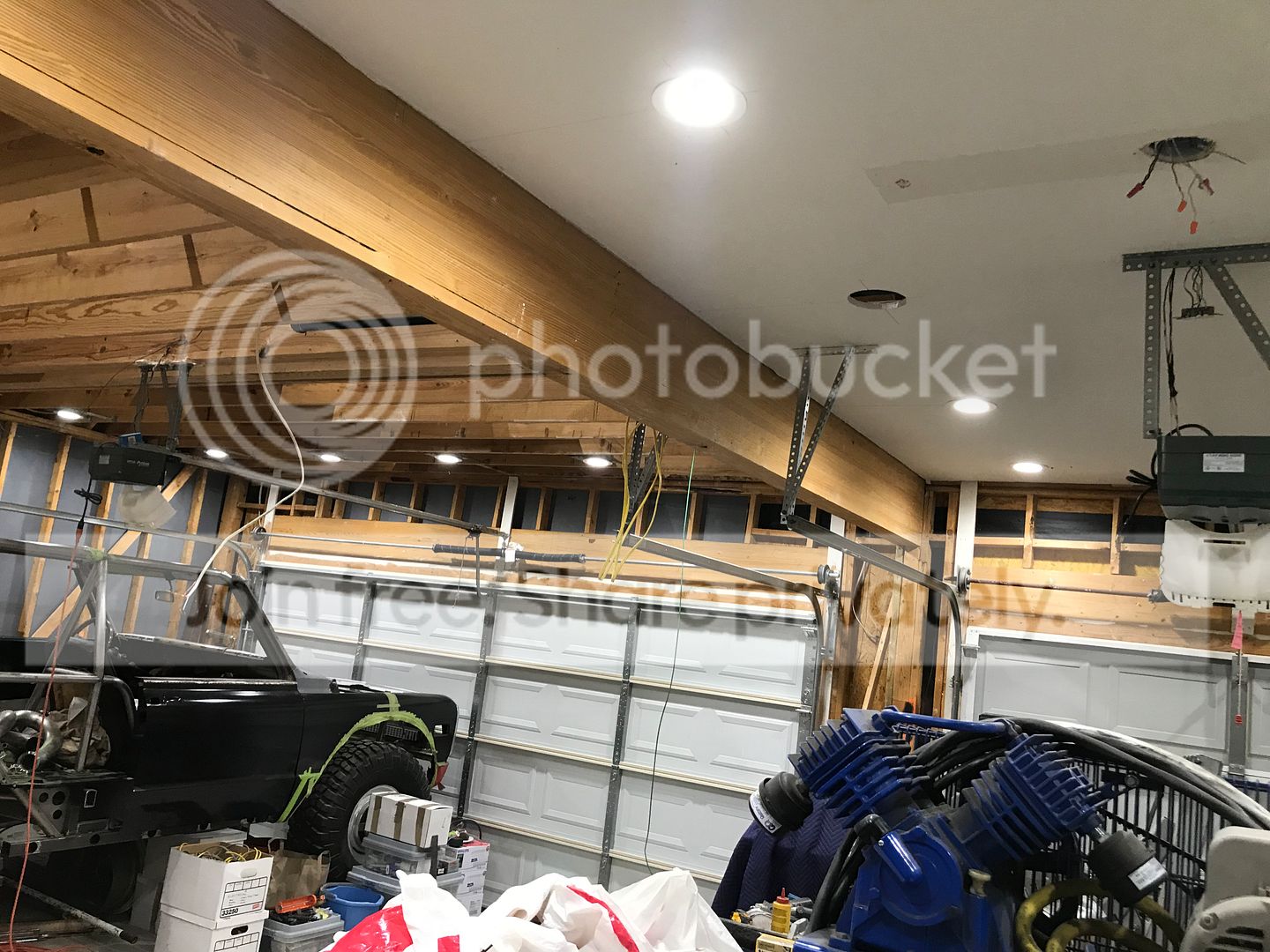

Installed 10 more LEDs on the single-bay side of the garage, and decided to remove the drywall from the large glue-lam beam since it was pretty beat up anyway. The natural wood looks pretty cool anyway IMHO...

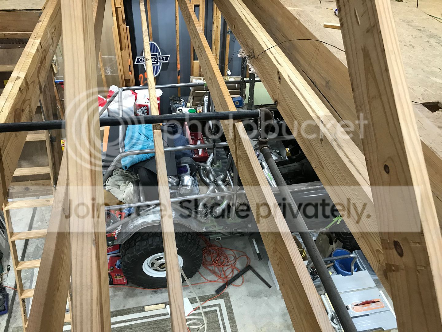

A view from the opposite side. The gas line is preventing me from installing the last few LED canisters.

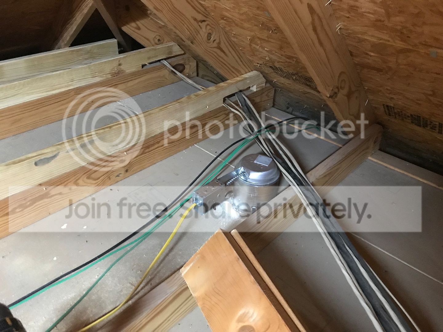

Up above the single-bay side the joists are only 2x6"... the original construction just laid all the wires from the outside panel on top of the joists which makes it impossible to put down a plywood floor.
It worked out OK, because the 2-bay side is all 2x10 construction, so by adding strategically notched boards I was able to match up all the floor heights... and get those wires out of view under a new floor.
Another shot of the path of the house wiring... crossing from the outer wall sub-panel to the interior sub-panel on the common wall from garage to laundryroom entry.

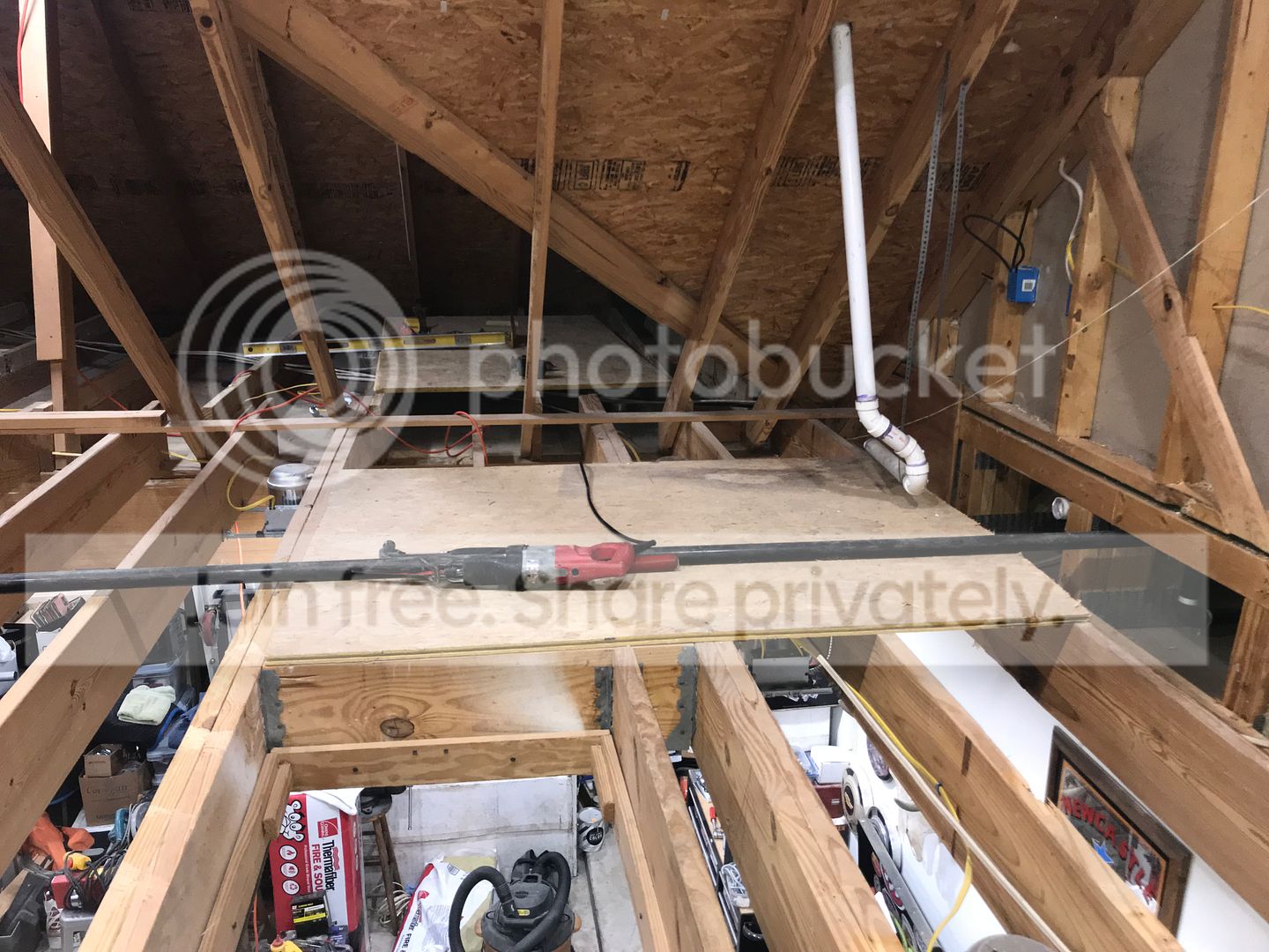

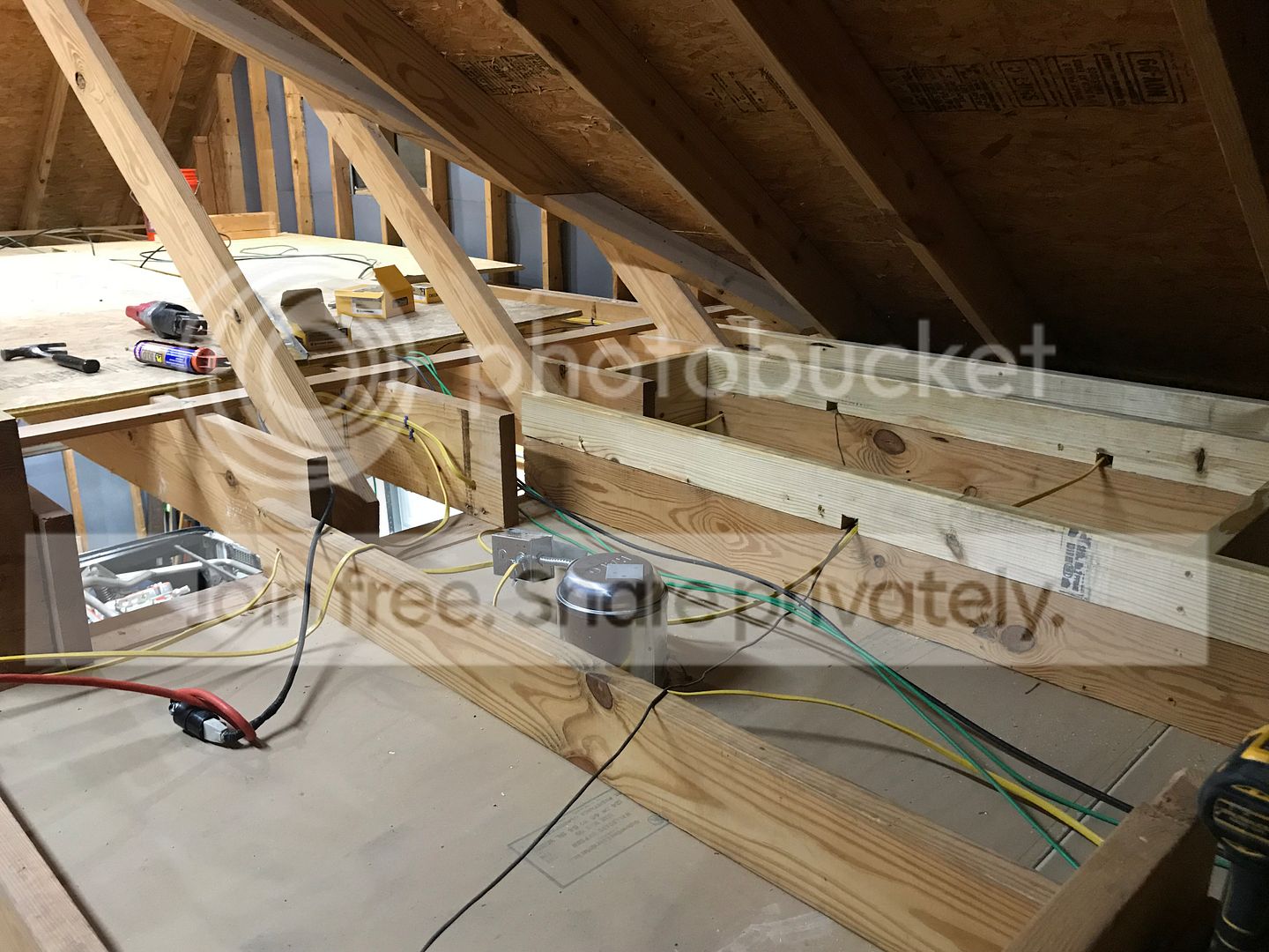

2018.04.03 - UPDATE! - ATTIC WORK....
It's been a slow nightly slog in the workshop, getting the upper storage areas prepped so that the sprayfoam crew can come in about 2 weeks from now.
The main focus is on getting the 2x6 joists raised up to match the 2x10 joists on the 2-car side so that plywood can be run across all those areas, and also getting the rockwool insulation into the ceiling areas to help dampen-out the echo from powertools, and the upright air compressor. Still need to demo a small amount of drywall on the perimeter walls and run additional wiring for outlets and the mini-split AC unit (Probably a few hoses for that one that can be hidden in the walls too)

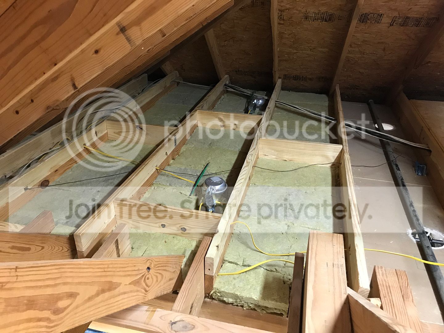

Here's the basic setup. Adding lumber with LiquidNails and screws to raise the deck height.... Roxul-type insulation and ready now for some plywood flooring.

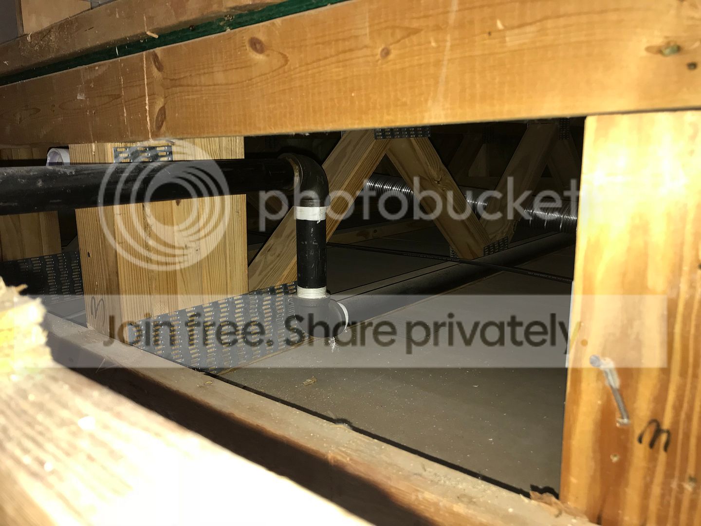

A nice surprise! The gas line that disappeared inside the common wall (into the house) actually HAS a fitting reasonably close to the garage wall... I had to remove a piece of plywood to reveal it, but the good news is that I don't have to cut and re-thread the existing pipe in situ.... a small 18" threaded pipe can replace the current 10' length and then the piping can be redirected around the perimeter walls instead of out in the center of the room.

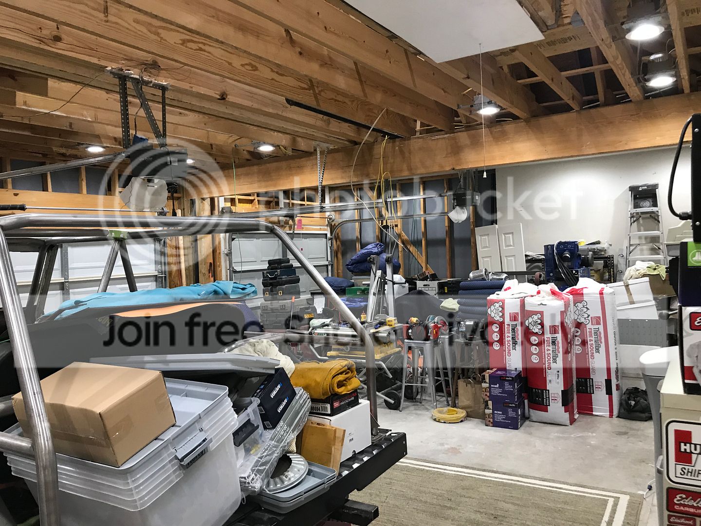

The long-view of the area. The area behind the yellow level is where I want to run the new sections of pipe. If I keep them tight to the corners (where the roof joists meet the floor) I won't lose any useful storage space.
That's the plan. I'm looking forward to having some plywood up there soon. Spending 4 hours a night balancing on 1.5" wide ceiling joists is really beating me up.... :)

I see twists and not perfectly straight runs of romex. I thought those things ate at your soul greg.
