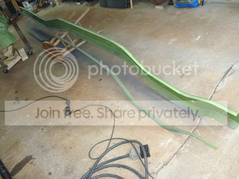

Here's a shot of the strip of metal I removed using lots and lots of cutoff wheels... I ended up cutting both frames 1.25" from the outside edge so that the resulting "merged" frame would mimic the 2.5" wide factory dimension.

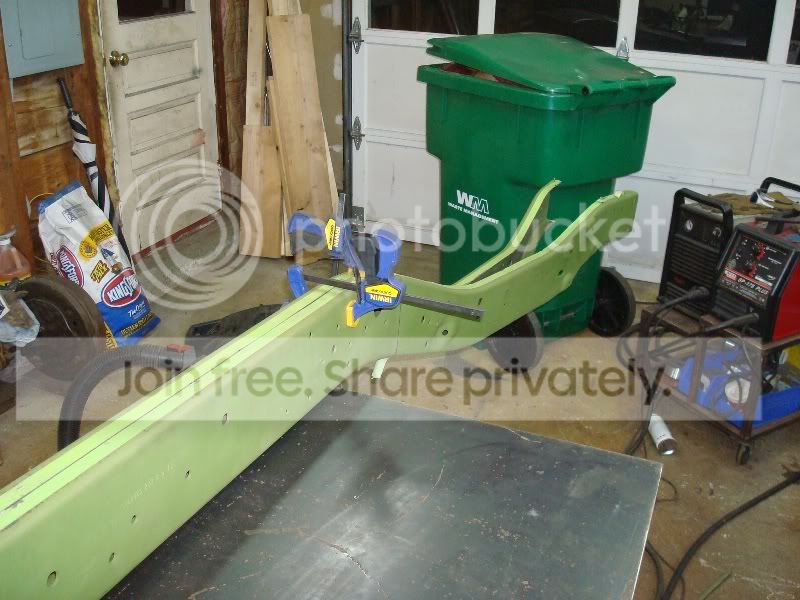

Here's an early mockup showing how cleanly the two cut frame halves line up...

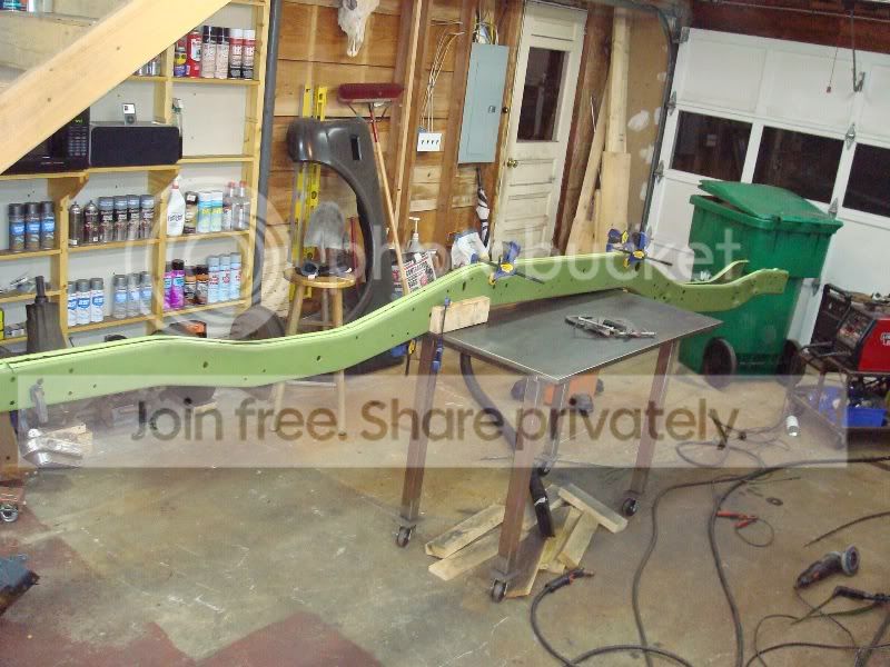

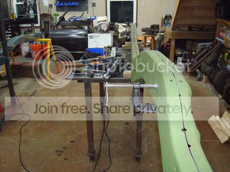

I slowly starting clamping and running bolts through the various spots to check my work.
Everything looked good for the rear 3/4's of the frame (which is perfectly straight from the factory) As it approaches the front spring shackle area, things get a bit more tricky... you can see that the two frames don't naturally flow together on this end.

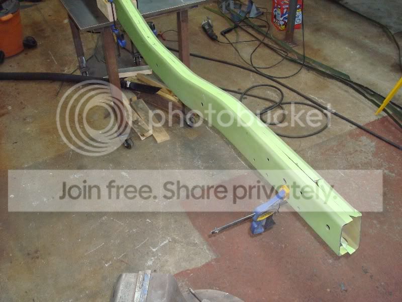

A few very carefully measured relief-cuts were made across the frame radius to allow me to gently bend the long vertical frame sections to the correct profile.
With more gentle clamping, fitting, cutting and finessing... the inside "box" section was drawn down to the outer frame pattern for a perfect fit!
Like everything else....this proved to be a TON of work, but the result really does look amazing. I'm quite pleased with how this came out.... and inspired enough to stay motivated to do it all a second time for the driver's side framerail. :eek1: UGH!

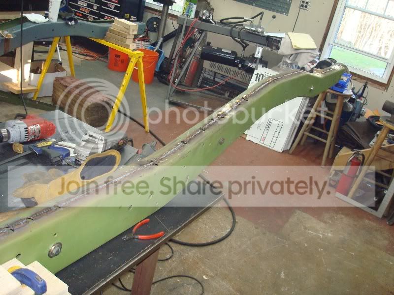

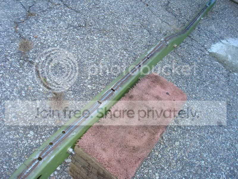

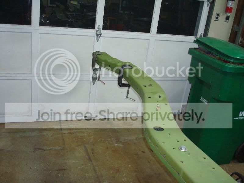

The update isn't sexy because as the title suggests, this weekend was spent welding, welding and welding some more. The passenger side framerail that I'd already mocked-up was prepped, I cut a nice deep "V" into the gap for good weld penetration and put a bunch of tacks down the length to hold everything in place. It takes a LONG time to weld 20 continuous feet of metal... :yikes: The reward is that when I finished, I got to flip the part over and do it all again..... the other side turned out to be 20 feet also. :doah:
The results were good, and worth the effort.
It's hard to get a good "long shot" of the frame and still get close enough to show the details. I dragged it out to the driveway and propped it up against my classic shag-carpeted wood block to get a shot in better light.
These loose frame sections are really unstable, and it seems like they want to lean or fall over no matter how you support them. Plus, now that it's fully boxed it's about twice as heavy as it used to be....weird, eh? :wink1:
I took care of some other random stuff over the weekend, like sandblasting all the related body mount bracketry. Those are all painted in the Ryoken green zinc now and ready to be bolted back on. The remaining step will be to sleeve all the bolt hole locations with some short stubs of DOM. That material should be arriving tomorrow. Since I had a few cutoff wheels left (I burned through about 30 of them since this frame project started) I cut the driver's side rails to the proper width also...actually I got 3 of the 4 full-length cuts completed and then ran out of discs.
For the driver's side, I still need to sandblast one of the rails and zinc it as well as all the body mount hangers. The weather isn't supposed to be that nice for the next few days, and big surprise....I'm out of blast media (again!) so I'll need to make another trip out for that too.

I'm curious how 'straight' the welded frame stayed Greg. Generally I would have string lined the frame and made some notes while mapping it for crown/sag etc. I would have welded about 1/3 of it, then turned it over and welded 1/3 of the other side, then checked for crown/sag again. repeat twice more until it's solid. I may have just stuck with no more than a 50% stitch...
My concern having done similar is if you do weld all on one side, then turn it over and weld the entire other side you will have changed the crown of the rails.
