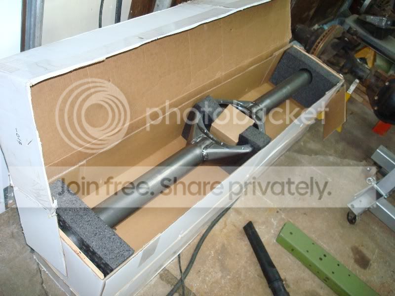

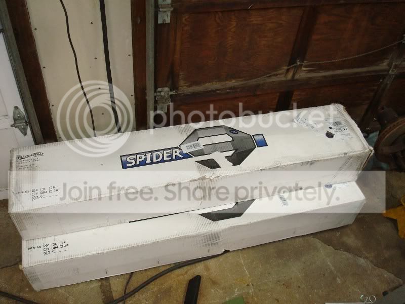

What a nice surprise.... I was just minding my own business tonight in the shop, welding and welding and welding on that 2nd framerail, when the UPS truck backed all the way up my driveway and right up to the rollup doors...
I guess he wasn't feeling strong enough to carry these from the street.....two Spidertrax 9" fabricated housings (@ 80Lbs each) for the Mog-9 axles:

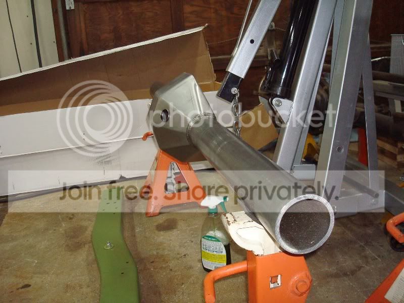

There was no way I was waiting until Christmas morning to open these...
And certainly no way I wasn't going to take at least ONE of them out of the box to really check it out!
Those 3.5" axle tubes look BEEFY in person....
One step closer....

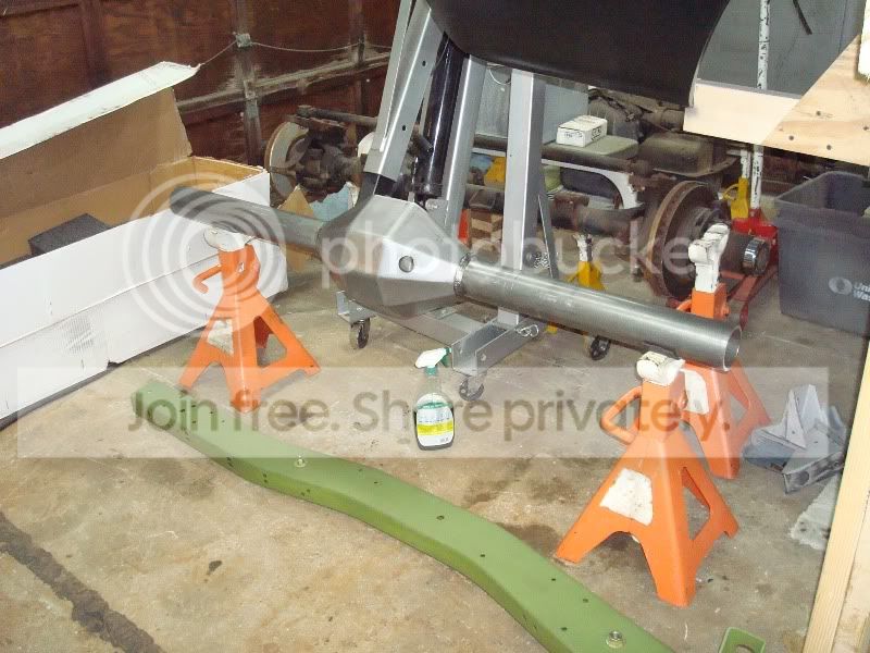

This makes me really want to get the frame finished soon, so that I can get it back underneath the chassis and get the axle housings in position. It won't be long now until I'm doing some suspension mock-ups! :saweet:

Daaaaaaaaaaaaaaaaamn. I'm speechless otherwise.
Dead sexy Greg, and I gotta say a bit intimidating too! I am assuming the Volvo portal boxes get attached to the ends, then custom shafts made from the center section to the portal inputs?

Volvo??!?!???? Bite your tongue! :D (Ford owns Volvo, how embarrassing)
No Volvo parts on this rig....good ol' fashioned German engineering. Mercedes-Benz Unimog 404 portals my friend! :deal:
It's a bit daunting to have such "nice" parts sitting in the shop, but it just forces me to bring my "A-Game" and really move this build to the next level.

And yet you are going to put aftermarket Ford 9" housings in your rig?
There's one in every crowd... :haha: Sorry guys, the Ford 9" is a defacto standard in performance circles. Occasionally even Ford gets one right! Just look at their stamped steel shock towers... :D

mind if I ask the price?
They were $100 off apiece in the "Outlet" section of the Spidertrax site which I believe dropped the price to $499 ea. I haven't got the final invoice yet, but even with all the extra oil seals I ordered I was out the door for around $1100. Not super cheap, but not "unobtanium" pricing either... sort of like buying 4'x8' sheets of composite fiberglass, eh? :wink1:

thats not bad at all... Do you have all the mog stuff?
I've got a complete set of 404 axles (one fixed axle, one steer axle) and an aftermarket set of MSI CNC-machined portal boxes.
The parts I still need are the Ford 3rd members, lockers and axle shafts made to fit whatever width I end up with... some of the 404 shafts might end up re-splined to work, but at least some of them will probably be custom-built.

Good info... That nodular centersection was recommended by a few other guys who build Mog-9 conversions, so I was already pretty sure that was the direction I was headed.
The problem in the portal application is that the 3rd has to be flipped to make the wheels turn the right way and that creates a high pinion setup that unfortunately doesn't oil very well. PortalTek makes a pinion support with an integrated oil slinger so I think I may have to go that route.
By the way, what is the method to check the bolt hole pattern on a 9" centersection? Is there something obvious about the hole pattern on the center chunk that tells you which side is UP and which side is DOWN? I want to double-check that I got the right housings.... obviously I can always flip the housing to make it work but then the existing fill plug will end up being a "drain plug" instead....
