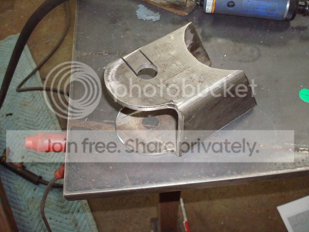

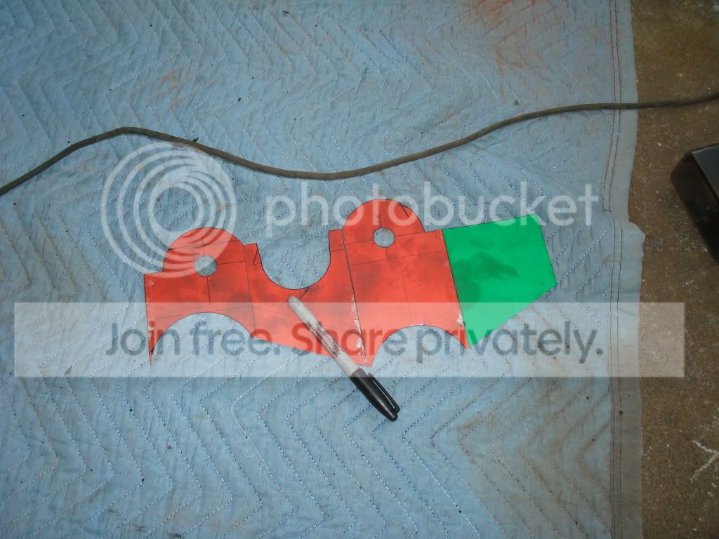

Step 1 was to take a close look at my 4-link summary data and start designing a bracket that would hold the lower links at the perfect angle. I didn't want to waste angularity of the heims by building a bracket that would eat up a few degrees at ride height. The solution was to build the bracket with 26 degrees of angle where it attaches to the axletube. After a bunch of measuring and cutting, I had a template:
I started off with a 3.5" x 3.5" x 250" square tube and traced my patterns around it. Some plasma cutting and a lot of grinding and shaping later I had the first one looking good.
By flipping the template inside out (using the green side instead of the red side) I also had a good pattern for the opposite side. What took 6 hours on the first try, took about 1 hour to duplicate for the other side...

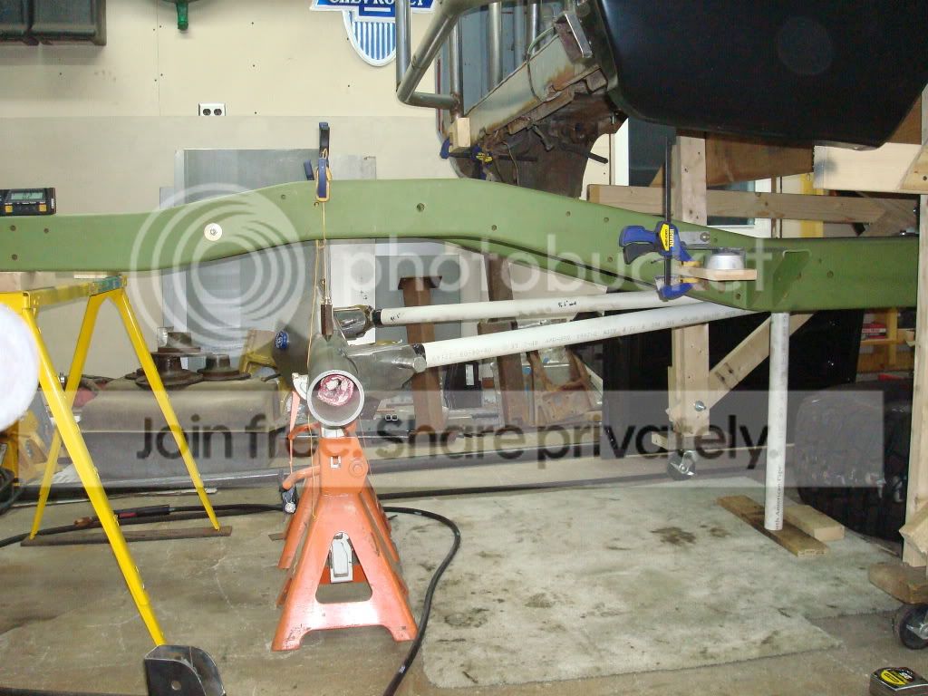

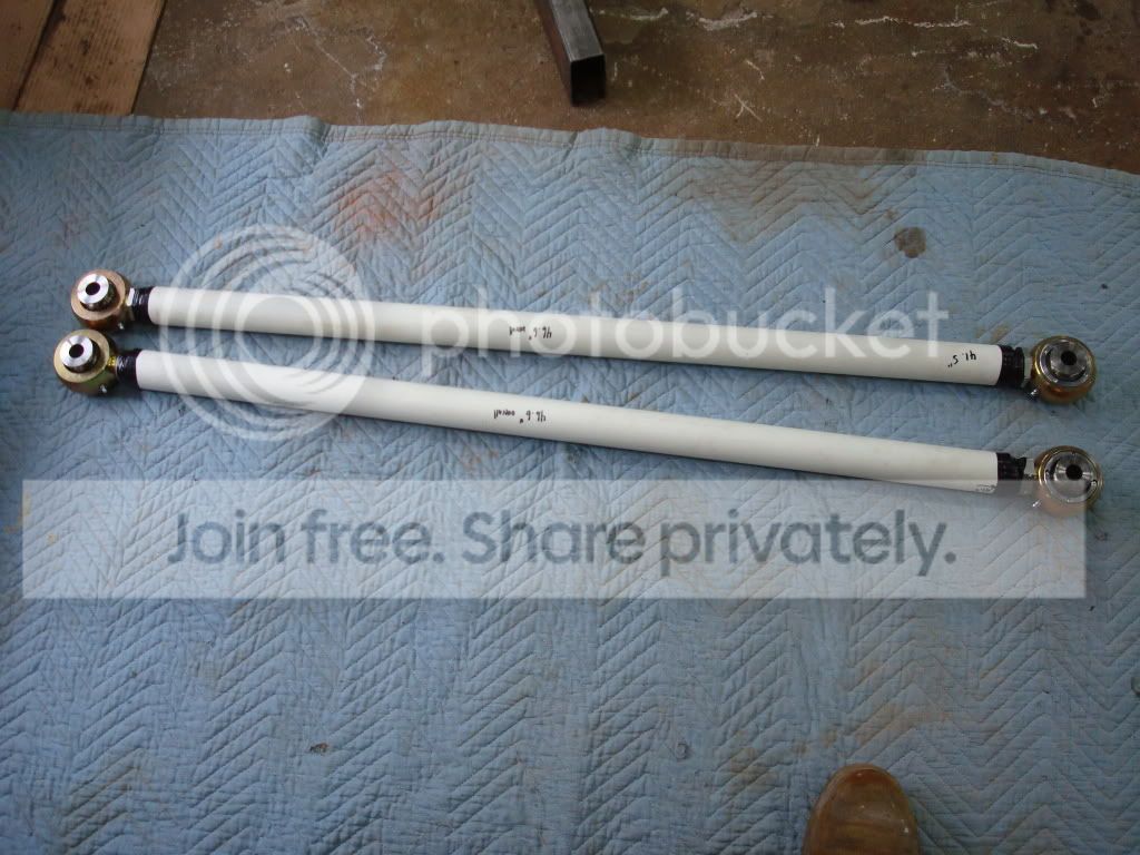

Then I set up a couple of PVC links and heims to simulate my actual lower links...
And with a few tack welds, I was able to get the brackets into position and test fit the links before the day ended....
So far, so good. Next up will be the frame crossmember so that I can hang the other end of these links permanently.

I'm assuming you have the axle housing positioned properly for pinion angle at ride height?
As close as possible for now.... nothing gets finish welded until all of it is 100% dialed-in.
