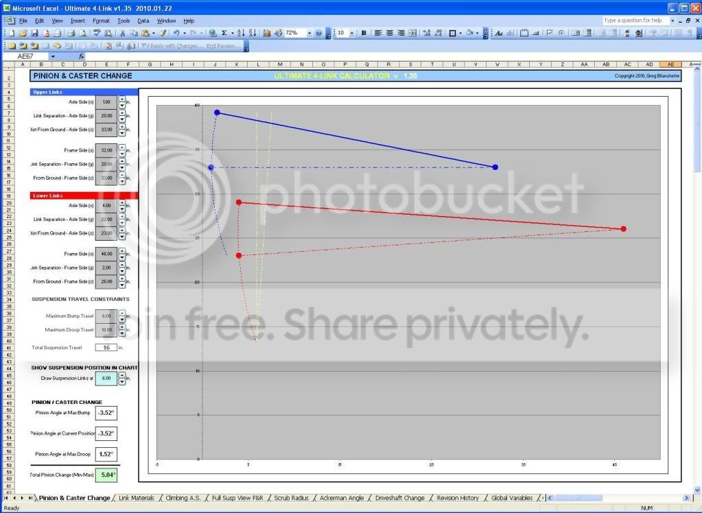

Here's another shot of a different tab:
This is a more detailed view of the Pinon Change information. In this case, the dashed lines represent the static link positions and I can click the buttons in the left menu area to cycle the suspension up or down. The yellow line represents the amount of pinion change from the static position...so as I cycle the suspension that angle grows larger at either extreme. It's also nice to be able to see if there is more pinion change in one direction than the other (bump vs. droop). In this design, there's about 3-1/2 degrees of change in bump, and very little change at all in droop. Some designs are wildly different on one side of the equation....it really just depends on the link positions and lengths.

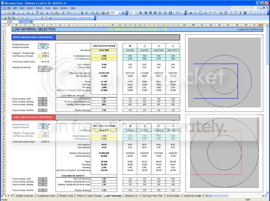

One more tab....
This one let's me experiment with different link materials, diameters and wall thicknesses to get an optimized design for strength and safety margin. The biggest changes in this area were that I created 4 "scratch pad" areas where I could build completely different designs side-by-side and immediately see and compare the attributes of each one. Once I have one I like, I just click the little radio button above the desired column and the data in that column is then incorporated into my "offical" design on all the other worksheet tabs. The other major change is that I now have a graphical representation of the tubing, wall thickness and an overlay of the heim joint (the sideways rectangular shapes) to show how well it will fit in the selected material, and how much wall thickness will be left around the heim once the tube is threaded for the heim joint. Cool. :cool:

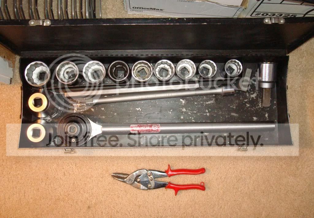

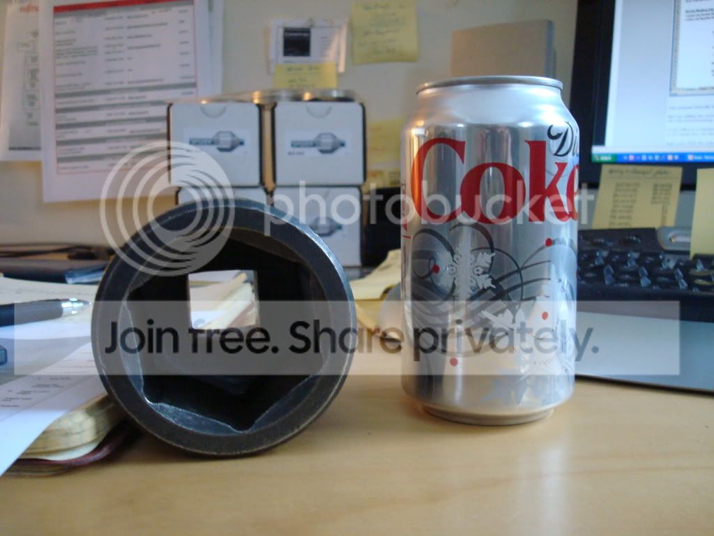

One thing that was becoming abundantly clear as I worked on the Mog axle stuff was that I was going to need a SERIOUS amount of torque to break the hub nuts free on those massive drum brakes. The factory spec is 750Lb/ft on the nut and I didn't have anything that rugged in my shop....I also didn't own a 55mm socket that was also needed.
Problem solved!
Then, I got on eBay and found this Snap-On 4X torque multiplier for a decent price to help me get to that lofty torque value I needed. (Can these be safely used with an impact gun or no? :dunno:)

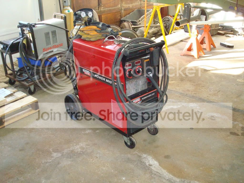

Then, a totally unexpected score on the local Craigslist.... A guy was looking to trade-down to a smaller MIG welder. In short-order, I was able to hand over my trusty Lincoln SP-175+ and a little bit of cash for this much nicer Lincoln 255! :saweet:

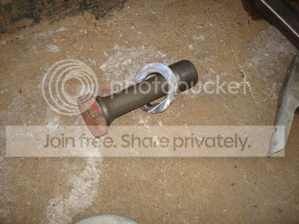

You know what they say about the best laid plans? Well, I was supremely confident about breaking those Mog nuts loose with my new pimpy socket and torque multiplier... but the 404s had other plans, like staying put.
After countless breaker bar setups and attempts, I went for the trick I knew would work, a cutoff wheel on the underside of the bolt to weaken it's hold.
I knew that I wasn't going to be reusing these bolts, so it didn't matter that much....though I was disappointed that I had to resort to such an unsophisticated techinique after buying the "correct" tool for the job.

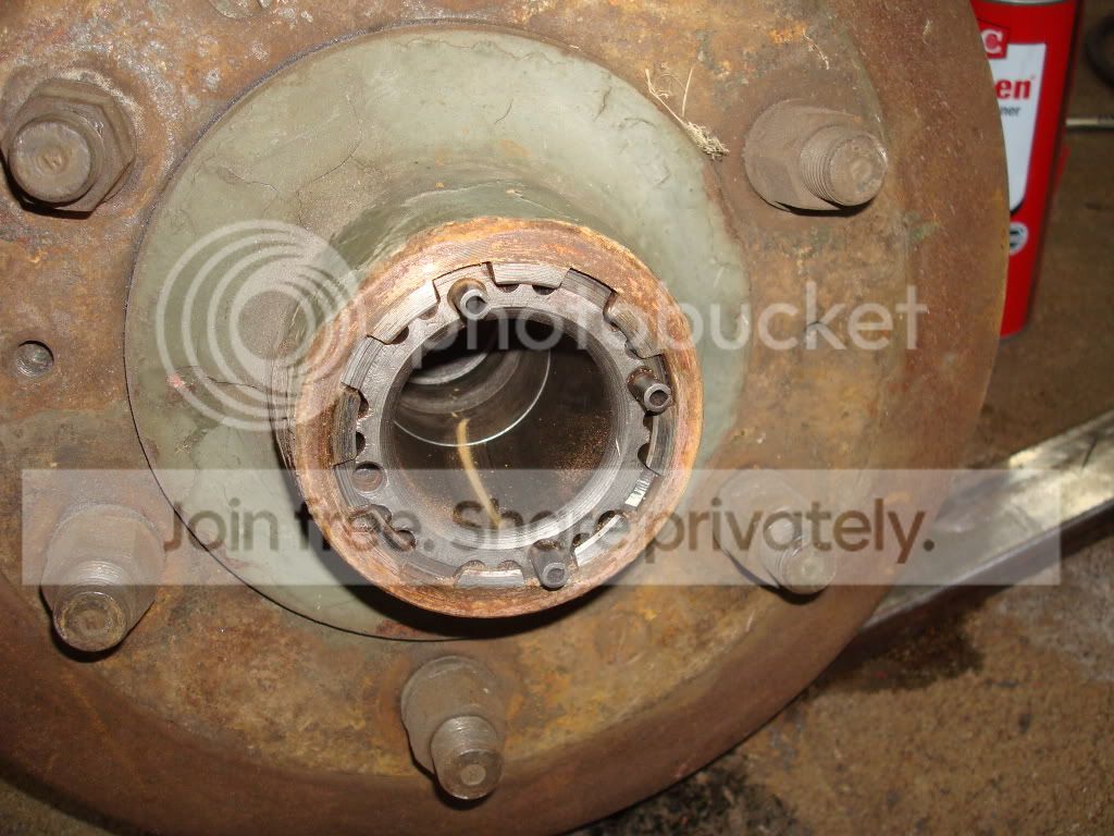

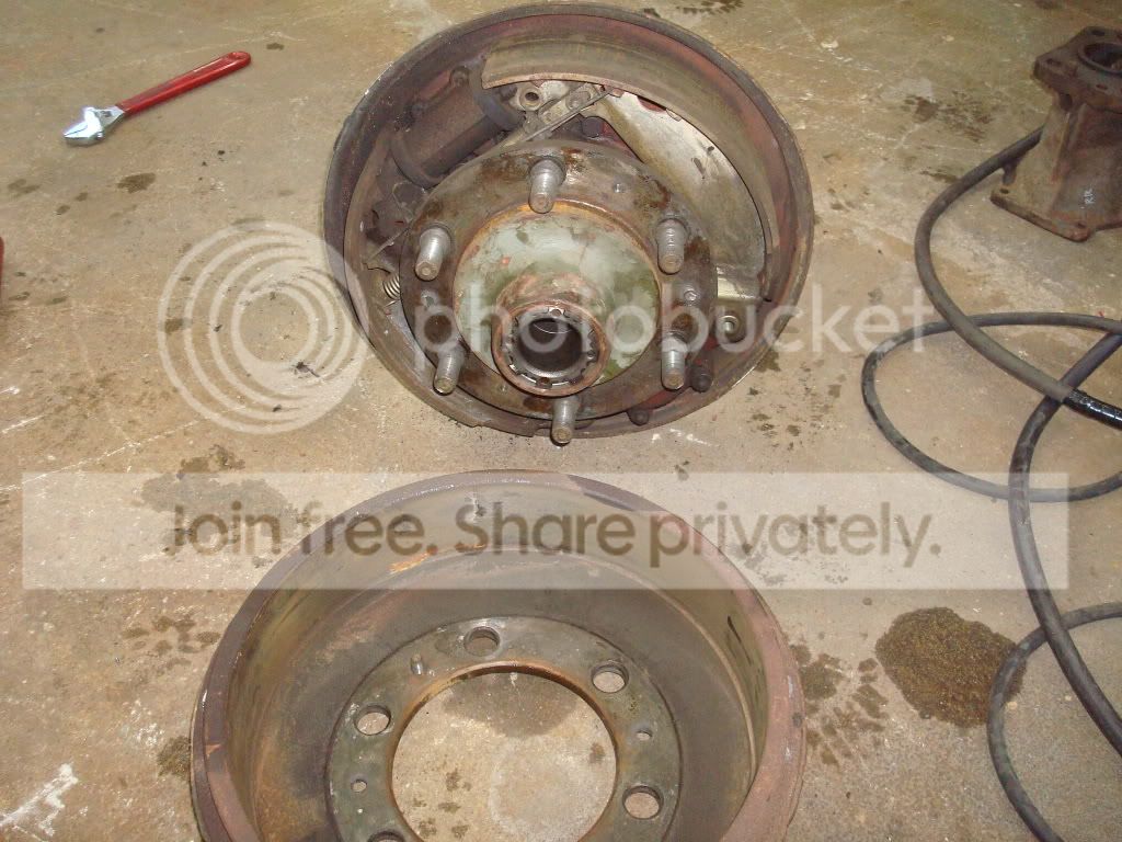

There are 4 dowel pins holding on a larged knurled cover plate....this is what it looks like once that's removed.
With that cover off, it's possible to remove the massive drum brakes. Unfortunately this is where I'm now stuck again....the hub pictured here is apparently pressed on to the portal gear with about 6-Gazillion Lbs of pressure and requires a special puller to remove it without damage. So until I can locate the correct tool, this part of the project goes back on hold.

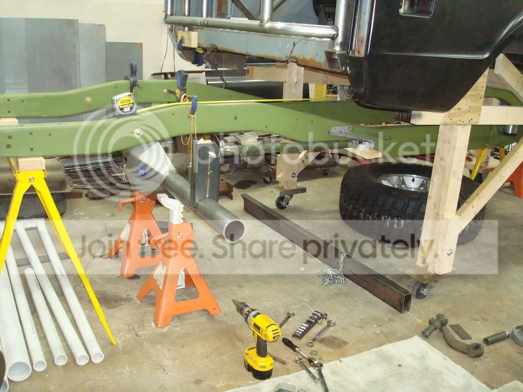

While I figure that one out, I thought I could share one quick "prototype" shot with you. This is me trying to get a basic sense of the clearances that I'll have with the suspension design shown in those screenshots at the beginning of this update. The basics look good, but I'll need some serious bracketry on the frame to handle the loads.
The PVC piping I bought for mock-up ended up being more trouble than it was worth, as was trying to create "phony" heim joints to create pivots with....so I called up Evolution Machine in Canada and told them to send me 16 of their bada$$ joints. That was a serious chunk of change, so I'm glad that I'd managed to sell of a few items around the shop to soften the blow.....
