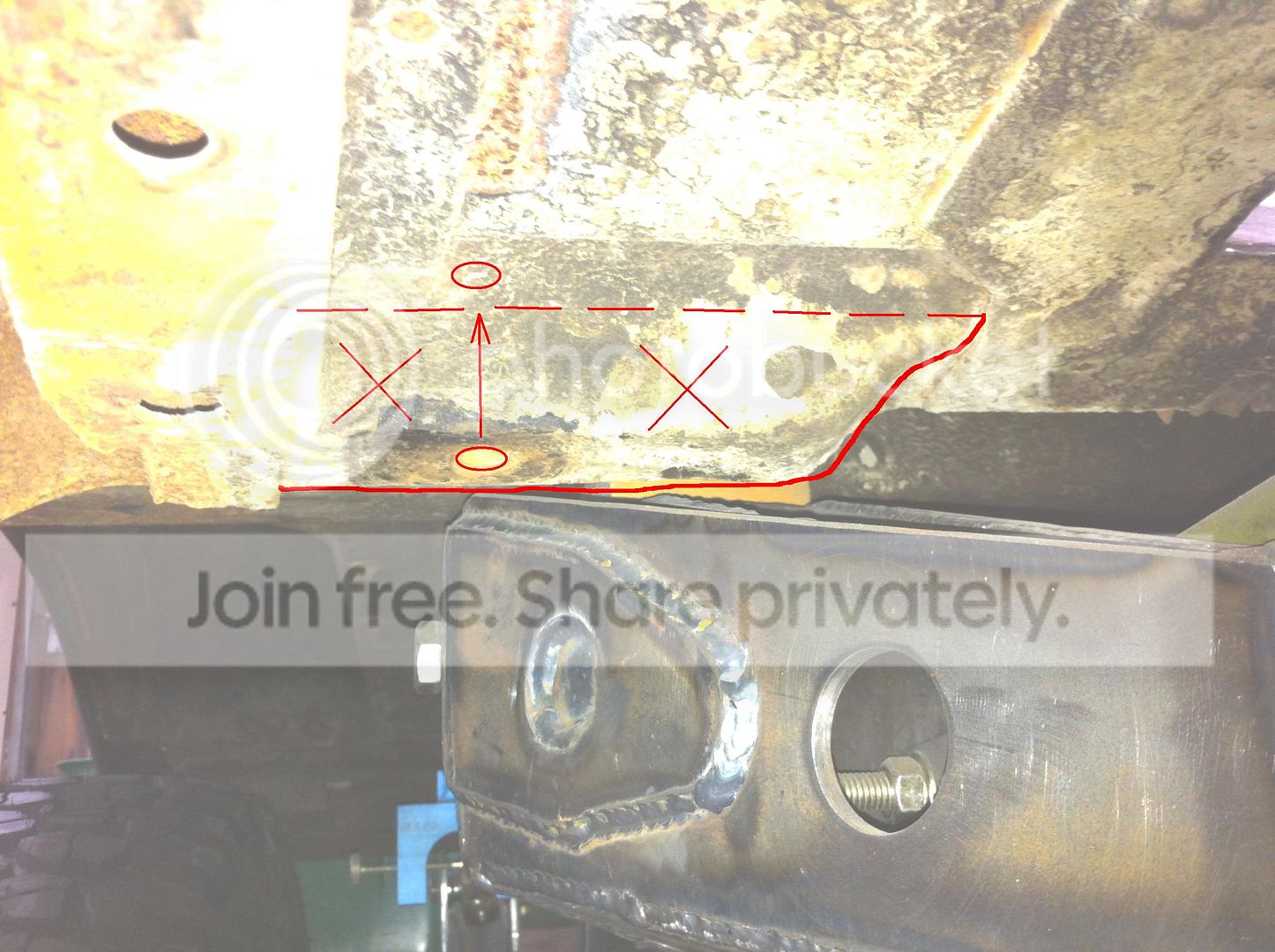

Removal of 2" Body Mount Pucks - I overlooked one small item during the build of the rear suspension frame-side link mounts. While I'd remembered to address the interferences of the upper link to the #3 body mount position, I didn't see the interference that was created on the #2 spot when I built my "Godzilla Mounts" for those upper links.
The solution will be relatively simple. I'll re-use the original through-hole for the mount, but I will need to clip about 2" off the factory vertical "c channel" structure to allow me to move the body down without interference. Once it's in place I will need to fab up a simple body mount hanger off the side of the Godzilla bracket on each side so that Mount #2 is supported correctly again.
Initally, I thought I would move this entire mount "inboard" of the framerail but upon mature reflection that doesn't seem like the smartest solution anymore. I'd really like to keep those inner framerails open for exhaust routing, so plopping a body mount bracket there is a waste of valuable space.

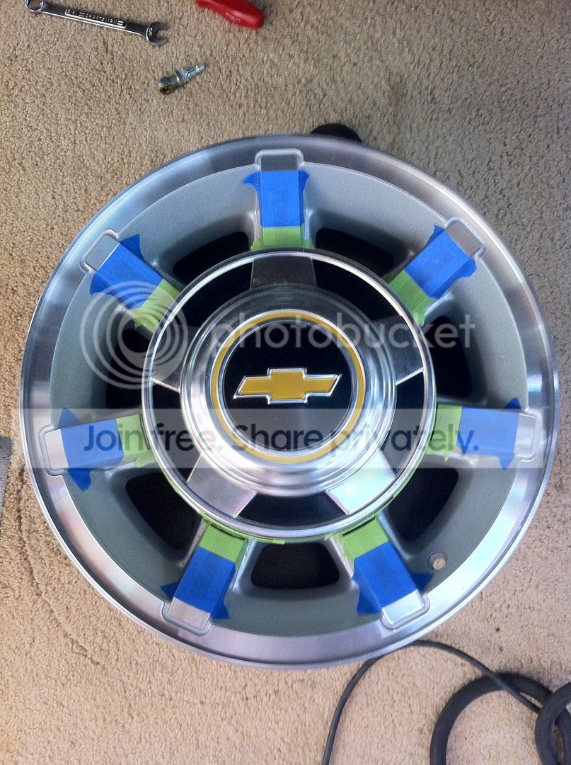

Steath Hubcaps - I'll be honest, I don't really like the looks of the H2 wheels on my truck at all. The only benefit was that the were the correct 17" diameter I needed (to clear the massive brakes) and they have a boatload of backspacing (5.56")....and they were cheap to buy off eBay. I have a nice set of factory hubcaps, so I had an idea to mount them onto the H2 wheel since this will help to hide almost all of the CTIS airlines and fittings. I thought that if I painted the wheels in an original factory white color it might actually take some of the modern "edge" away from the wheels and make them look a bit more correct for the age of the vehicle...??? :thinking: What do you think?
Ideally, I'd like to find a company that can build me a custom steel wheel that holds that hubcap, has 8-Lugs and lots of backspacing. But if this paint / hubcap experiment turns out well, I may not be in much of a rush to replace the H2's after all.

They might look cool in white with the caps. Give some of that old school look back to the rig.
I know I'm a 1% on not liking these wheels, specially on a 1st Gen.

I'm with you Paul... don't like 'em one bit. My theory is that even though they seem "generic" enough, they are still very recognizable as the "Hummer H2" wheel design, even with the centercap removed. Maybe it's the fact that it's a 7-spoke wheel instead of something more popular like a 5 or 6 spoke? :dunno:
In any case, I'll be happier if I can disguise them as much as possible. I even thought there might be a way to buy a set of 17" Mooneyes discs, flip them backwards and paint them white... Attach the Chevy hubcap to the center and mount them up!!! :waytogo:
The wheels are such an important part of the "look" of the entire vehicle that it's going to be hard to just say "meh....good enough" and leave the H2s on there as my final solution. Obviously, I have plenty of time to figure out a solution but I guess it's important to let everyone who's reading this thread know that these wheels are not my "choice" of wheels....they are simply a placeholder for something else later on.
-G
yup.. a stopgap..... after some of the stuff/costs in this build, a set of custom steelies will be no big deal down the road...

I think the hubcap won't be that hard to adapt to the stock H2 hubcap. A few experiments I did seemed to work well, and will have the same holding power as the factory hubcap.
The idea of being able to almost completely hide the high-tech CTIS airlines will be a plus for me as well. As it stands now, the wheels are too modern for the rest of the truck..... stainless airlines, etc would really throw the look "off"... IMHO.
-G
