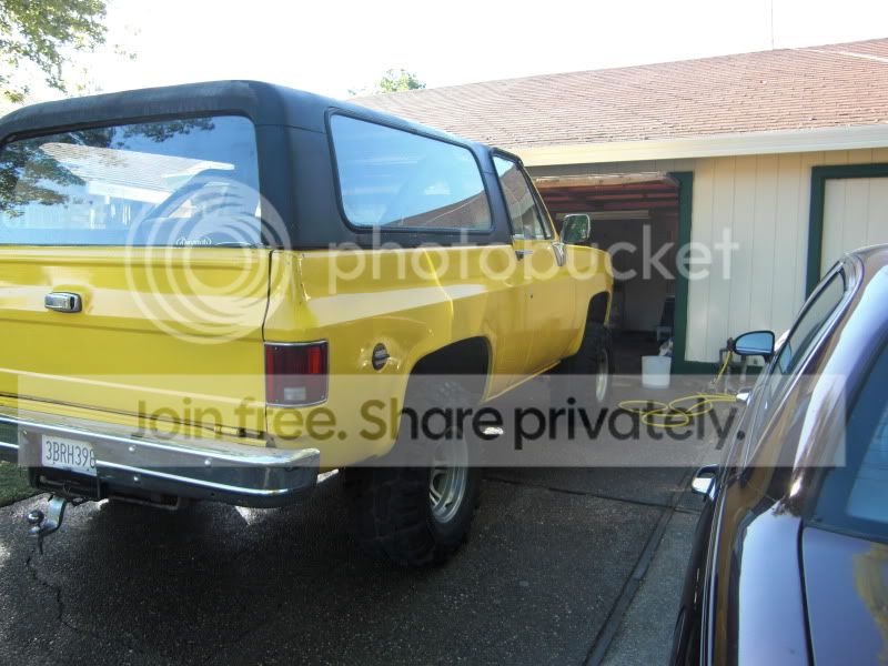

73 K5 BLAZER 4X4
4 Inch lift with blocks :rolleyes:
33 Inch Interco Thornbird Tires :(:(
350 Goodwrench CRATE MOTOR 15K MILES
Longtube Headers
Flowmasters w/ turndowns
Edelbrock 650 carb
Newer paint- some sort of yellow
Kinda coolish front bumper

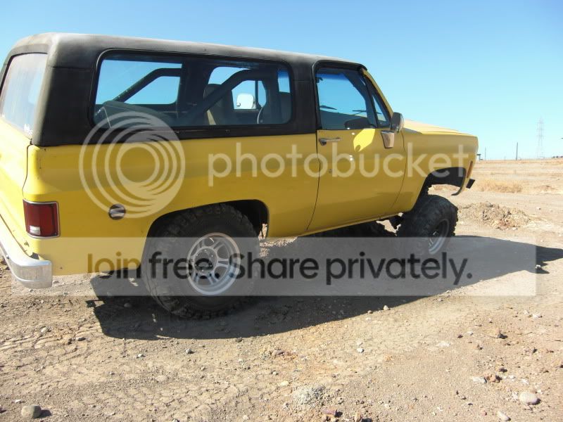

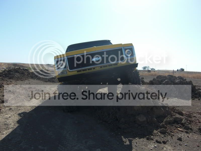

Pics of when i first got it.

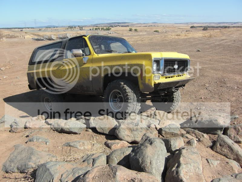

Couple days later took it out wheelin for the first time. Good basline for how it performed. This is with the swaybar on as well

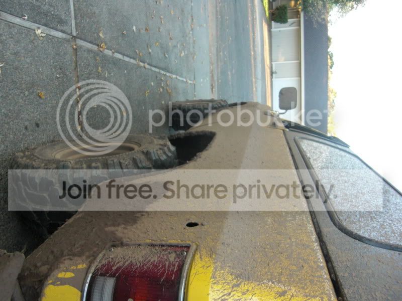

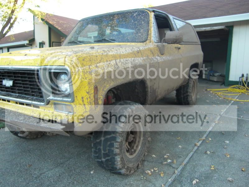

Got it muddy a few times.
Then i had a cracked flexplate... oh the joy!
Made me realize how much i hate mud when i had it falling down on my face and in my eyes.

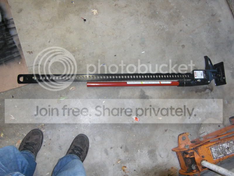

Wife got me a hi lift jack, got that mounted up.

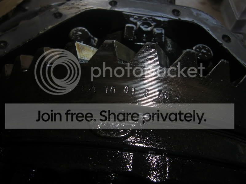

14bff 4.11 gears
d44 flat top 8 lug 4.11 gears

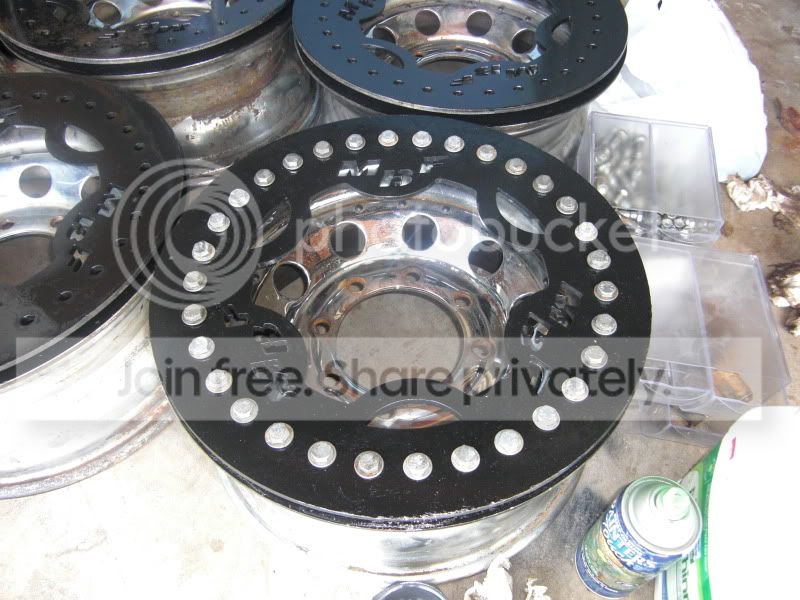

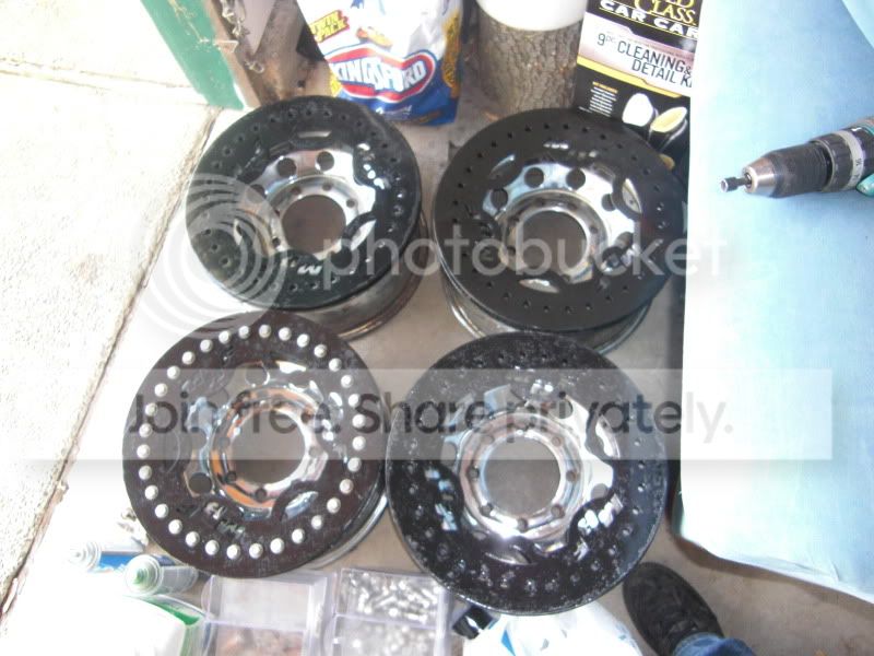

16inch 12 hole wheels with weld on beadlocks w/hardware

Not sure about the beadlocks. Think they are overkill for my setup but we will see. I also DD my truck so i dunno about that, allthough i have a buddy that runs beadlocks DD and the guy i am getting the stuff from ran his on a DD.
So may sell them to fund new wheels/tires
Budget is big concern for me. Limited income and baby on way in September!
Beadlocks on a DD is no big deal at all, even the homemade ones aren't hard to balance IME if they are centered/welded well.
And, IMO, lockers make the most impact on the performance of a truck but beadlocks have to be right there with tire size and suspension flex. Beadlocks and LOW LOW tire pressure are very underrated by most people here IMO.
Appreciate the imput! Saw that post about the knuckles, seems like a pretty good route. Allthough i already have well 2 flat tops now, i think the cost to machine and the arm would be about the same as that whole knuckle lol.
Glad for some pro's on the beadlocks instead of most of the your gonna kill someone remarks i find by people ( 99% im sure dont even have beadlocks). I will just check them regularly and make sure they are still torqued right and i dont see them having an issue. Im hoping a good eyeball center and some airsoft bb's will get me a nice balanced tire.

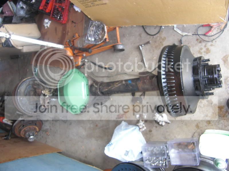

Well got my camera to work and snapped some pics of the goodies i picked up!
the beadlocks

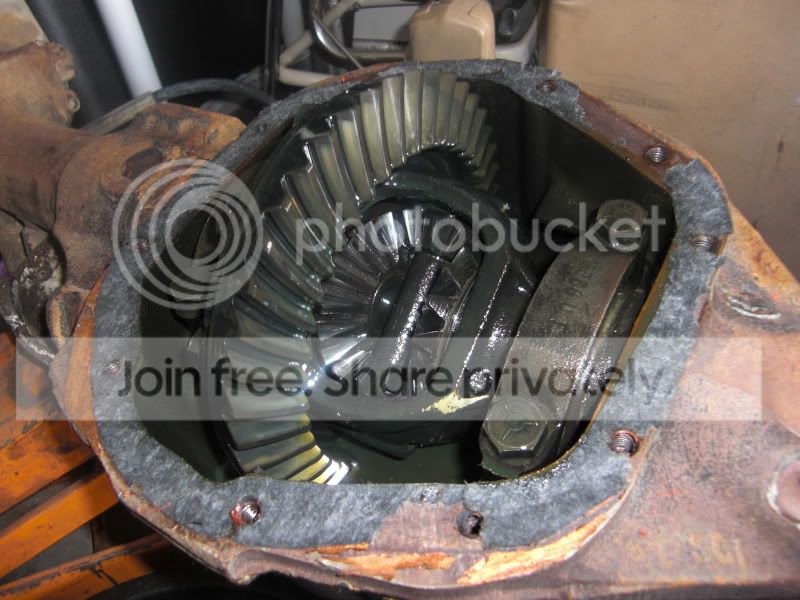

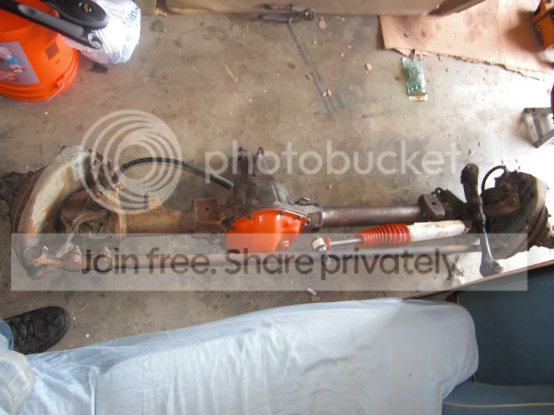

8lug d44 front with all the trimmings

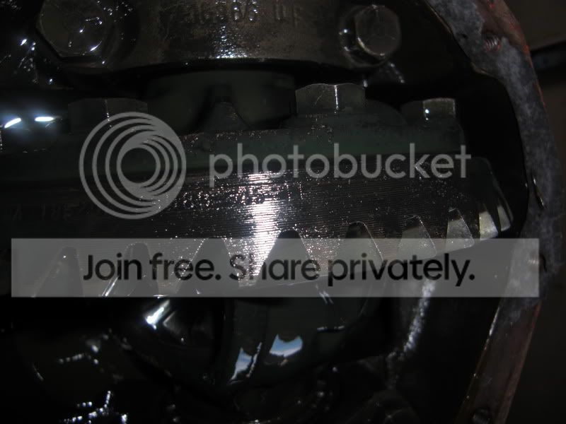

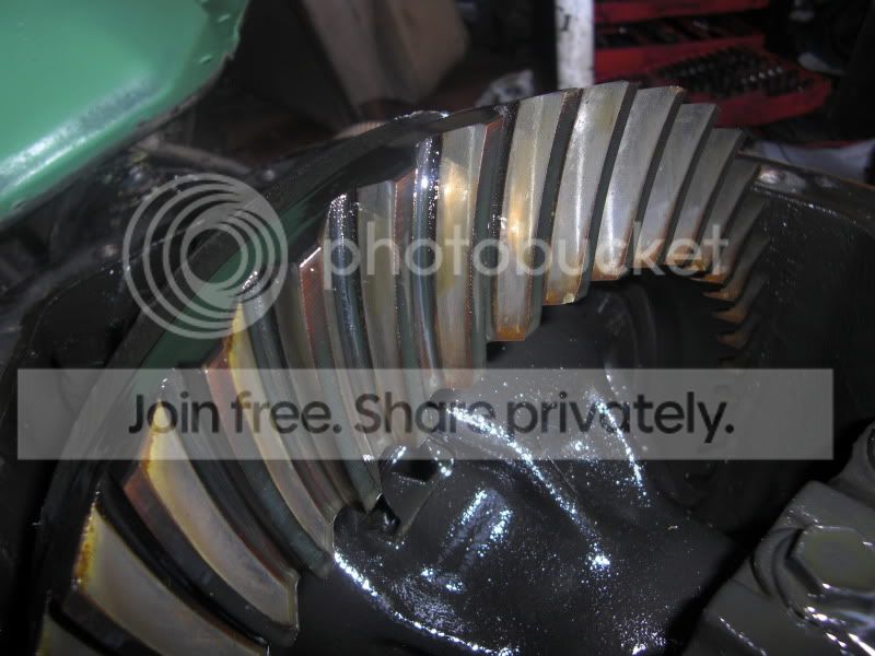

the 14bolt, inside looked really really good. Gears look new.
Guy is bringing me the 2wd steering box and 56's over the weekend.
Been just cleaning up and painting so far. Noticed one of the welds broke on the 14bolt for the spring hangar, so i will have to fix that. But they look damn good otherwise.

I like that Hi Lift mount, did you make it or buy it?

I would definitely run those beadlocks. Being able to run 2-3 psi makes my rig so much more capable, and it keeps all the wet crap out of my beads like all the rest of the guys in my club get almost every trip :wink1: Plus they look cool! :D
I made that mount. Figured it was better to have it inside away from the weather. Got a pair of bolts, a pair of nuts, and a single piece of flat bar and bent it up with a vise/hammer. Very happy with how it came out.
Thanks! Yeah the more i think about beadlocks the more i want them! they are just so cool.
They will make me look badass :haha:
Not JUST LOOK bad ass but your 1/4 mile ET will drop too. Make your rig faster for damn sure. No really, they will. :D
35x12.5-16. Called mud dawgs. Cheapest mt at the time he bought em.
For sure id hang onto those beadlocks, 10x cooler looking than a recentered H1 , even with all the different rock rings available. The mil tires are super cheap, but am told maybe not great on traction. Im just as curious about sidewall stiffness. Pickin mine up this weekend, and when all is said and done ill likely do a build thread and let all know my .02 on the matter.
