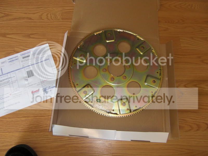

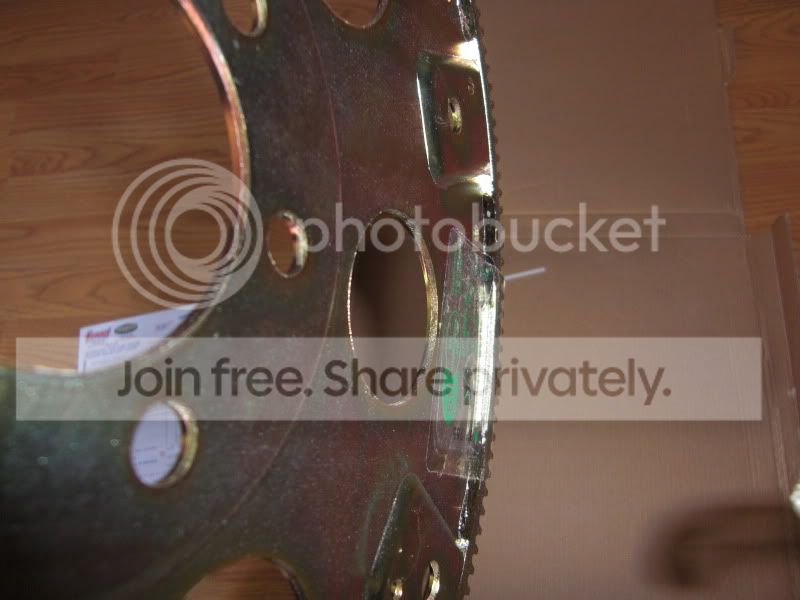

My new Flexplate came in today. I swear if this thing breaks i will shiz bricks, and know something else is wrong lol. It is pretty too... I love that Zinc finish.

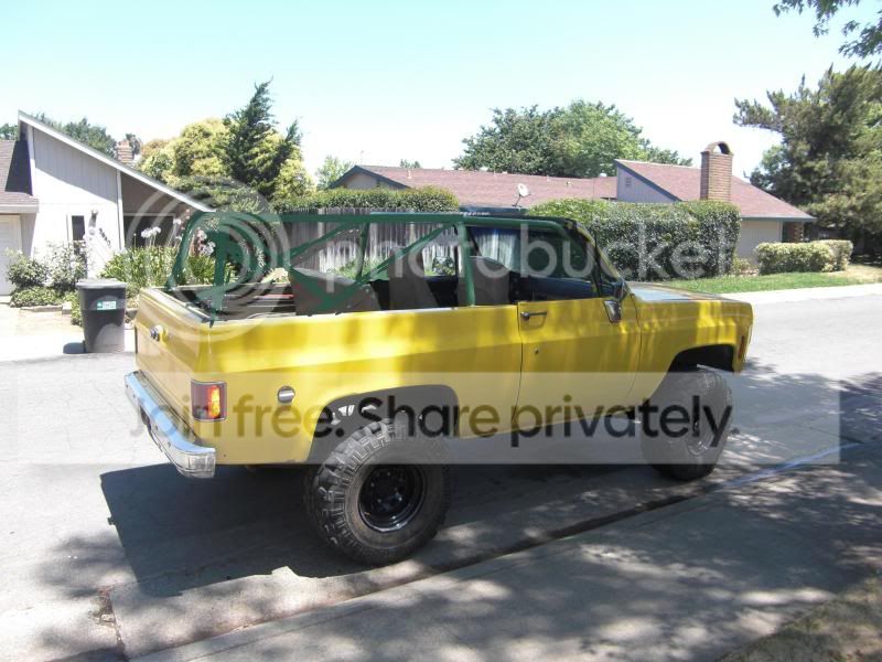

TOPLESS!!!!
I took it off by myself too :P
bent down inside and pushed off with my back flat and walked it to the edge of the bed. tied a rope around in and looped it around my cage. Then tilted it up and lowered it down with the rope till it slid nice and easy off the back onto my spare tires. Easy peasy!

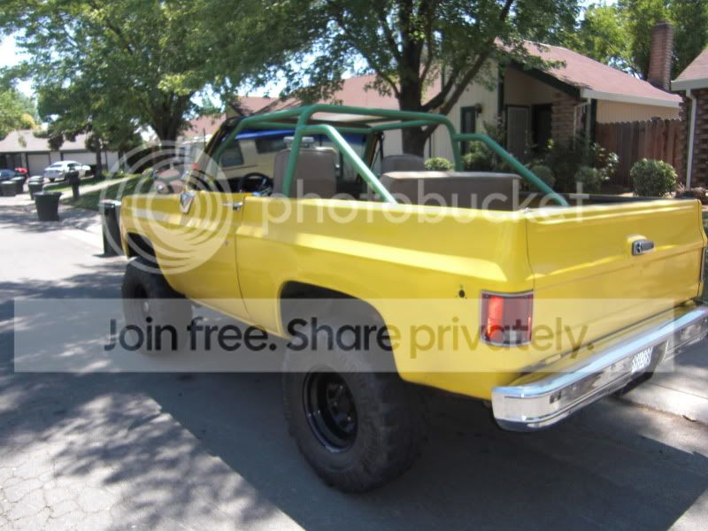

And this is what i want to change up about cage. Will also get X's in front and rear sections on roof.
The more i look at the bar on my b pillar the funnier it looks. It seems like it is back to far? Anyone else feel the same? Maybe i should hack and move that forward before i do more work
