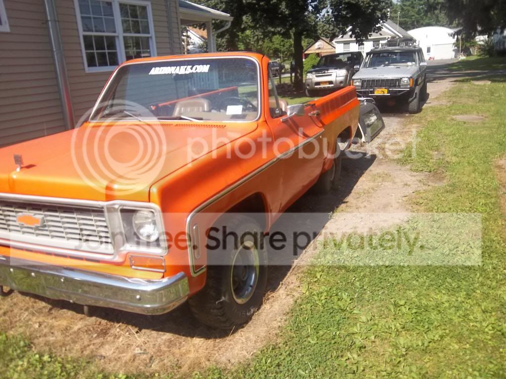

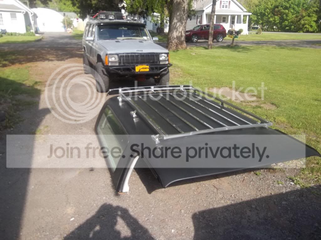

put a fresh coat of flat black on the top this weekend, and polished up the chrome on the roof rack. the wifey did not think that was a very good mothersday present no matter how hard i tried to spin the "I did it for you, baby" angle
Lol ouch :doah::haha:

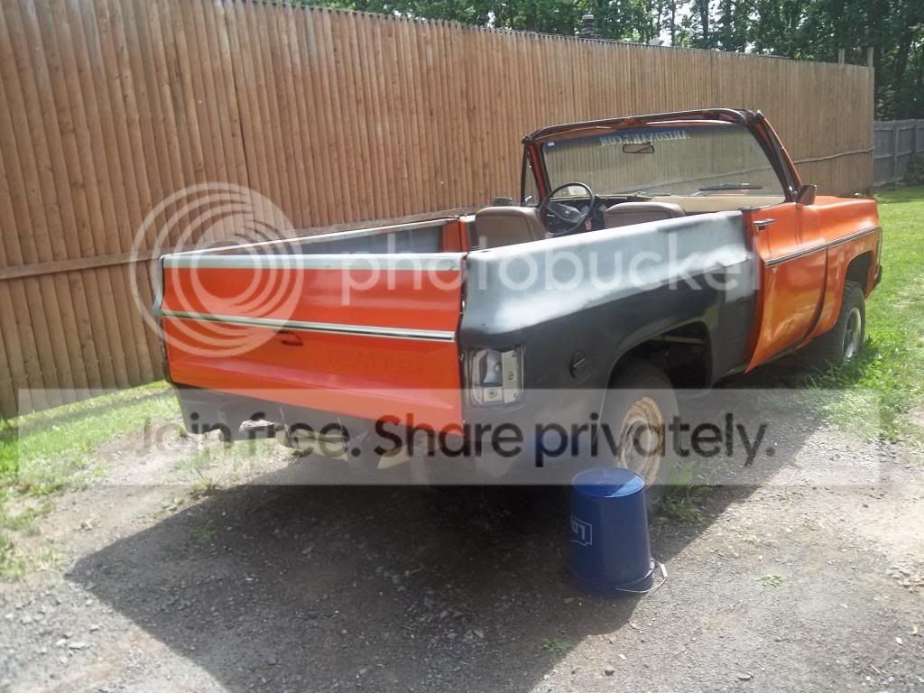

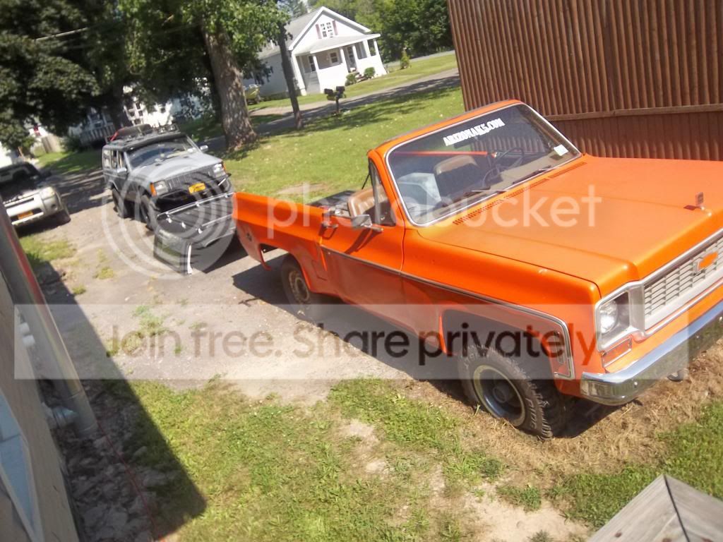

Top all painted up

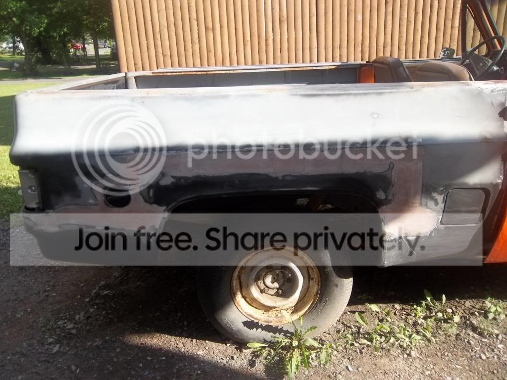

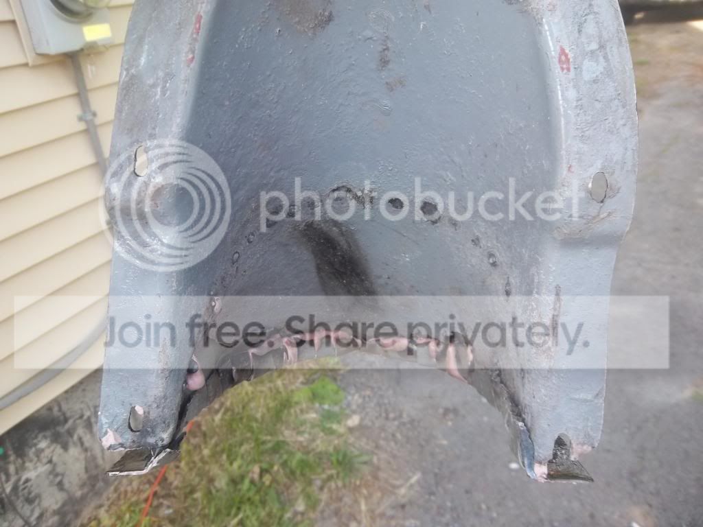

inside fender just used a thin strip to tie the front n back together
gonna do the same for the floor, just a thin strip of sheet metal welded in

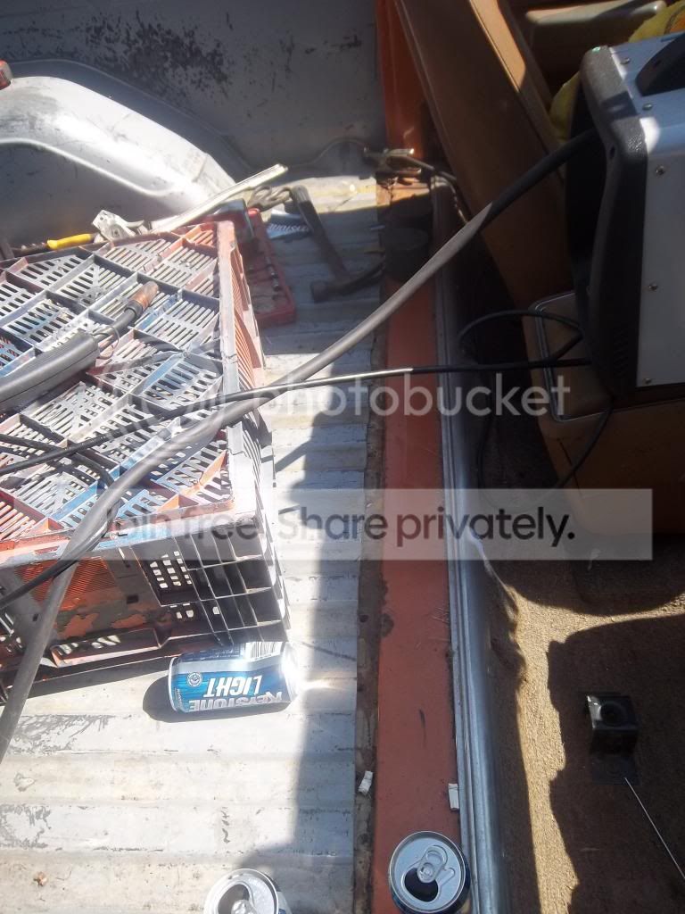

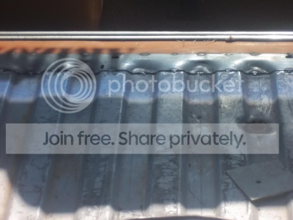

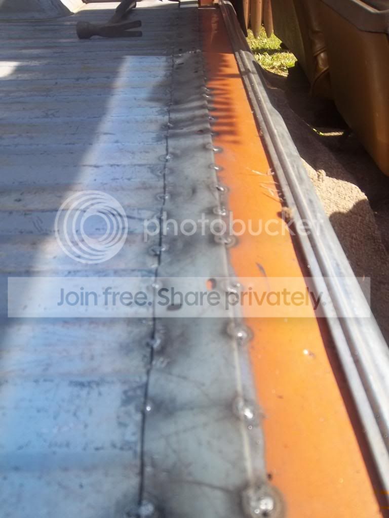

Getting there slowly

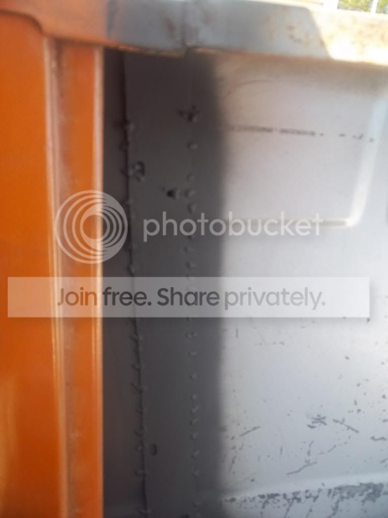

got the back weled up to the front. ran out of Wire mid way so ther are like 4 times the nmber of welds in the pic shown
Hammer the strap down to conform to the bed

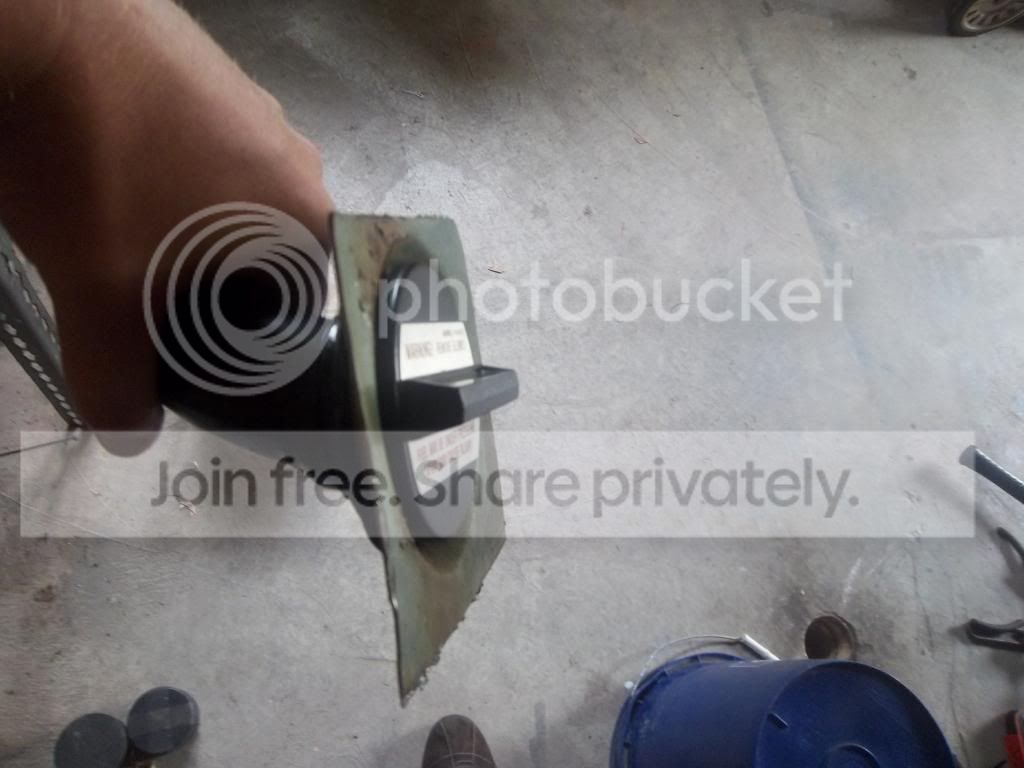

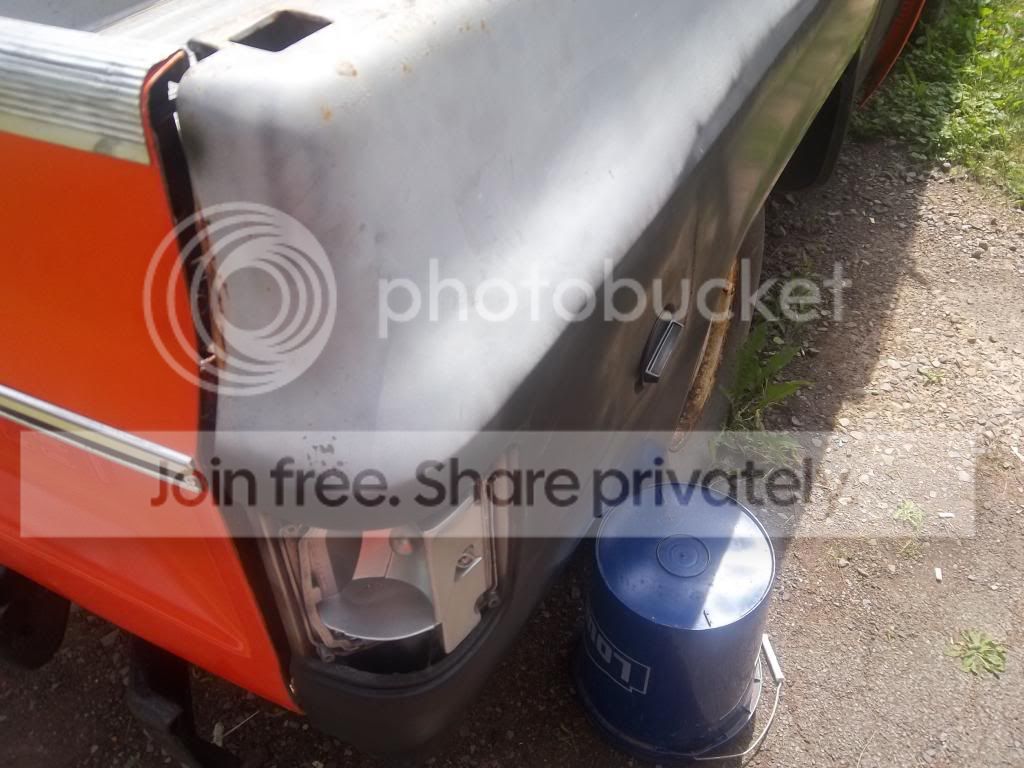

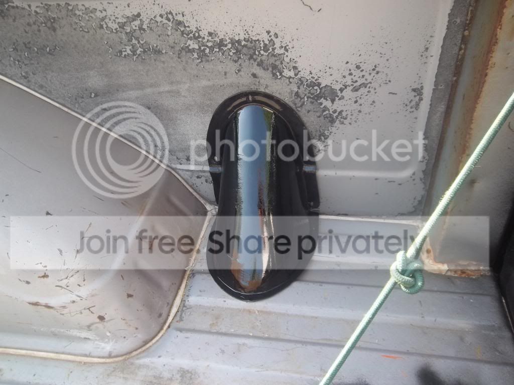

Got a filler neck cover from the J/Y need a little fabbing up since the bottoma half was gone with rust
shoty fab work

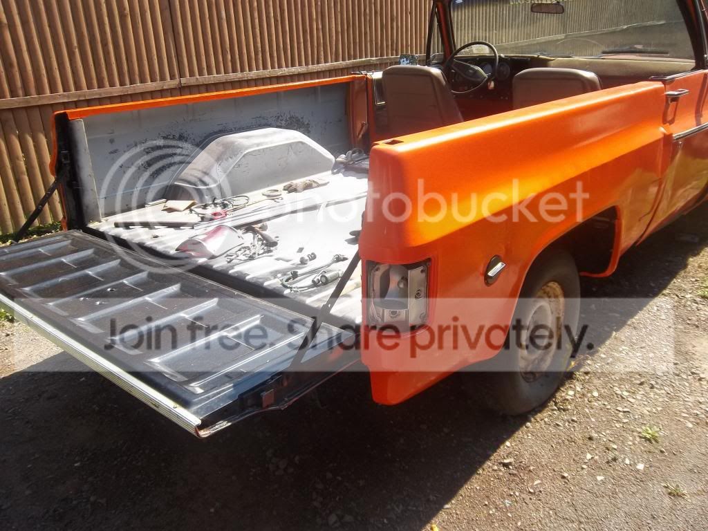

Also found my sheet metal i was looking for

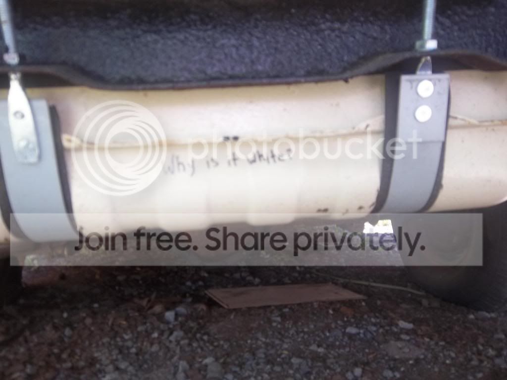

When I put the filler neck back in place the rubber filler neck tube is like 2" short so it's a trip to Napa for some filler neck and 1/2" vent line. I can't figure out where I lost 2 inches but my wife says cause it's cold out. :whistle:

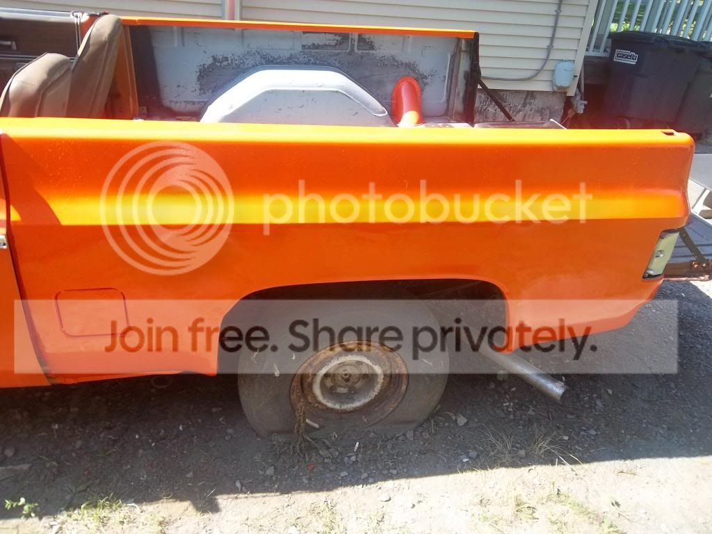

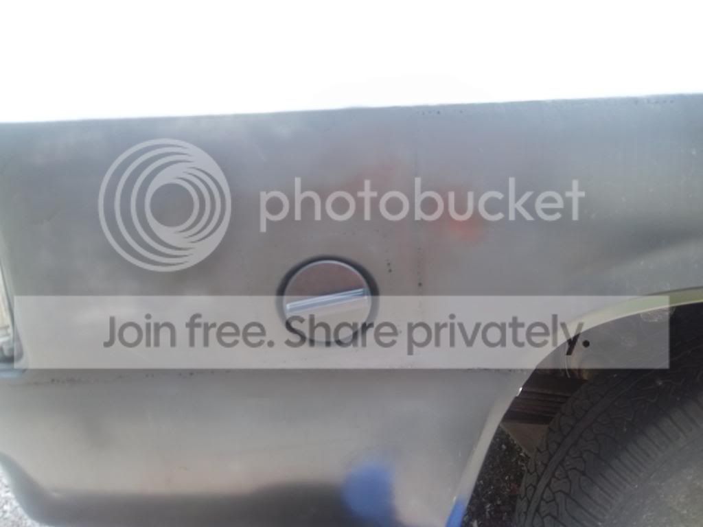

stupid me forgot to clock the sheet metal to level the gas cap, but not too concerned. filler work done on passenger side.
at least it sits flush
close up of the cap sittin crooked

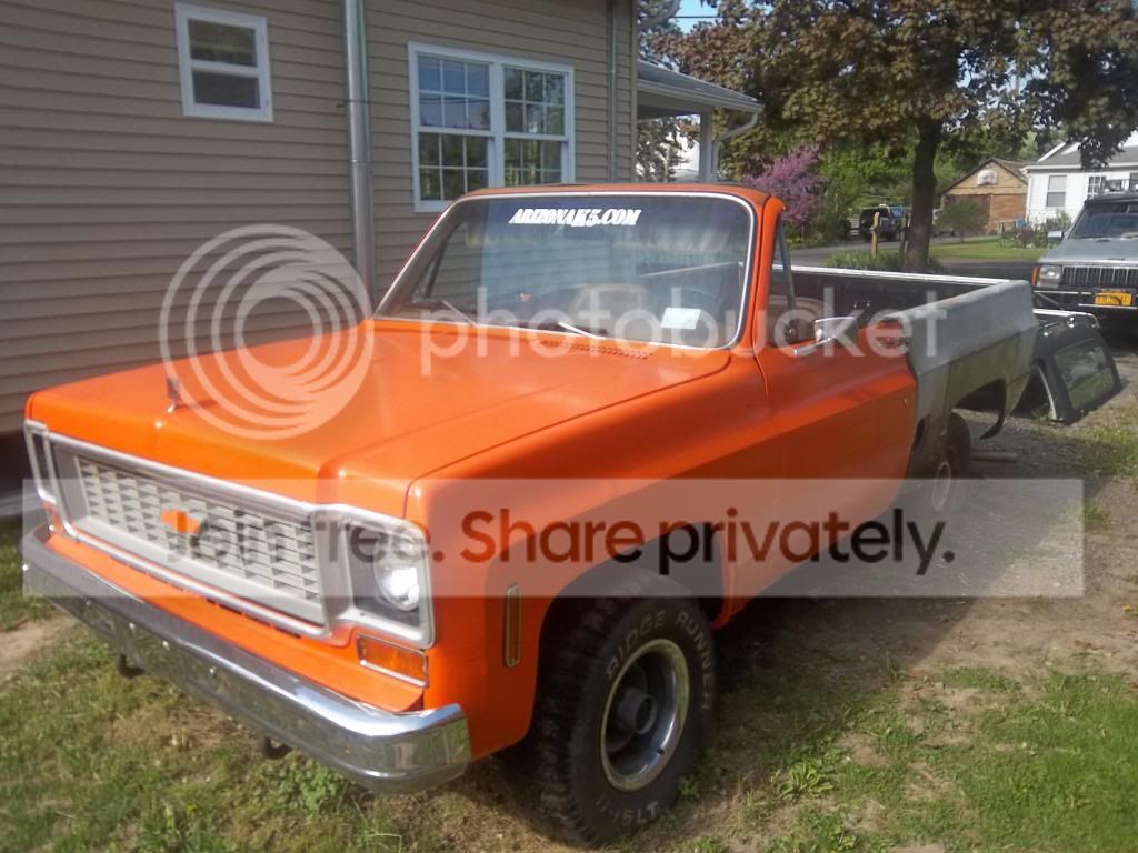

paint is finished. time for the interior.
