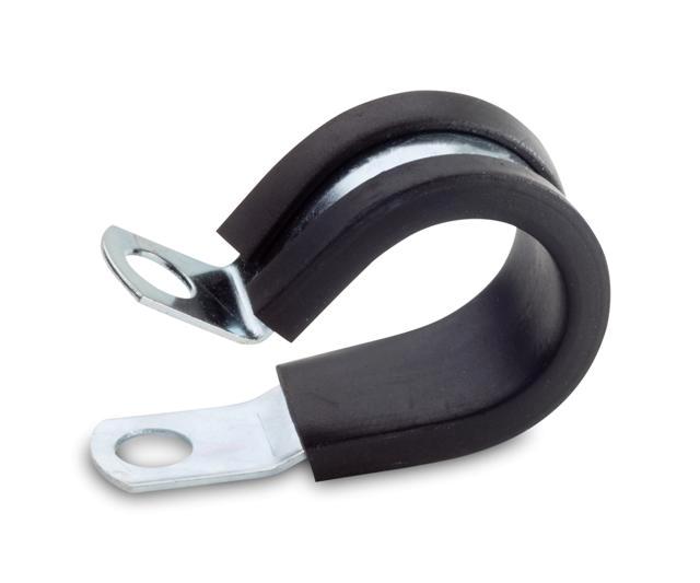

said rubberclampthingamajiggys
Don't go cheapie on those. I got some from Harbor Freight and the rubber was cracking and falling off within a yeat or so. I would guess that even from napa or summit they aren't expensive, and I should have gone that route. The engine heat just killed them real quick on my blazer
Bought a bunch of different sizes on summit already, very reasonably priced.
All star was the brand if you guys need to buy some.
Ah ok I have those. That's what I'll be using along the frame too...of course it's much bigger then one fitting. I think I'll jerry rig it up with the bigger clamp aND swap them when I get my summit order.
Yeah I've been getting them from summit...we'll see how they hold up!
Could you make something cool out of metal to attach it to your firewall? I thought you had a little bit of access to make smallish parts. Something like this but with holes on the sides where you could put a screw/bolt through to the firewall: Fuel line clamps
Yeah I probably could. I made some fuel clamps a few pages back...been swamped with work so I haven't been able to make anything cool lately.
