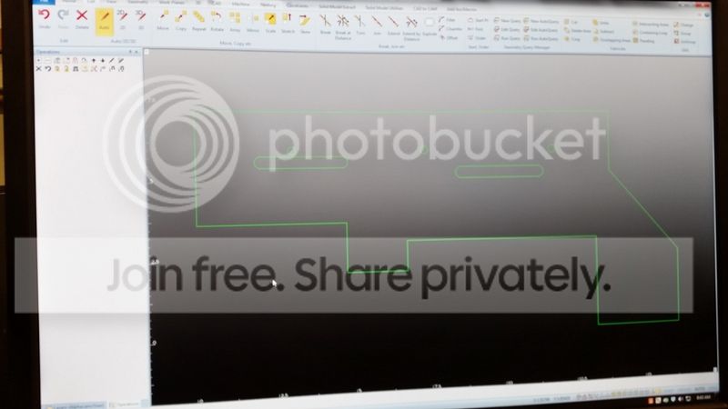

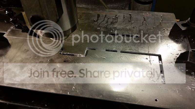

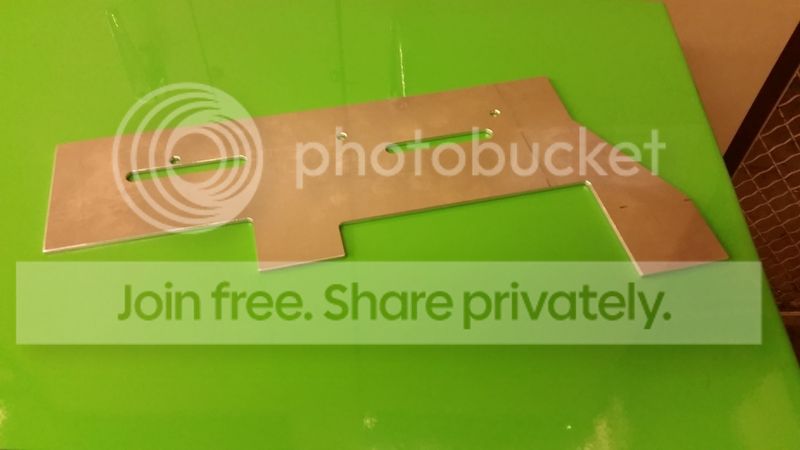

So heres the start to the windstar fan brackets...
Im going to wait to drill the holes for the fan side since bending could be enough to screw you up. Sort of a proof of concept to make sure these work as designed. Theyll need some standoffs to take some vibration off the ears to keep them from developing cracks, which ill add after i make the bends.
