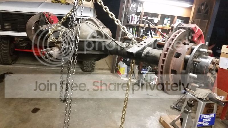

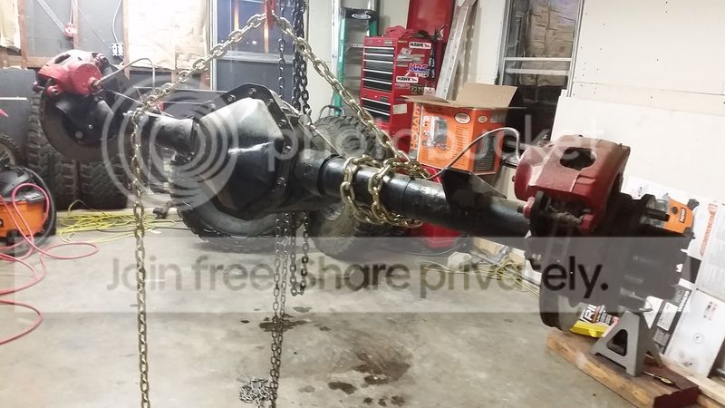

Got the 14 bolt out of the back of the truck last night. Now i have 3 lol. One under my truck (1990-2000 2nd gen), a semi float and now a full width 14 bolt from the 70's.
Trying to sell the semi right now.
Heres the new 14 bolt...
Turns out....its a 13 bolt! Its has a pretty well done shave. Nothing aftermarket added. Still has pleanty of meat...i think over .5". Wasnt leaking when i got it.

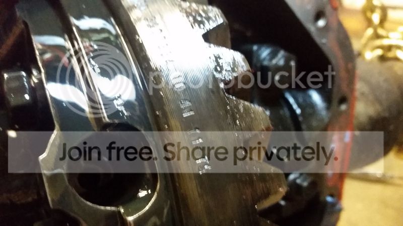

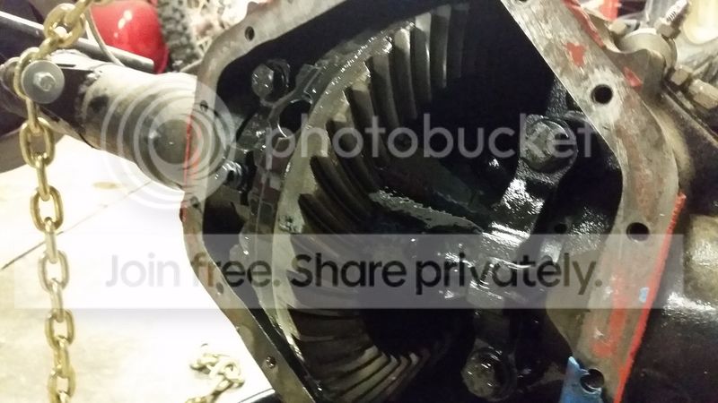

I emptied the fluid to see what it looked like inside. The guy was running 37s and said it rode nice on the freeway. His guess was it was 3.73 but i knew it couldnt be. It turns out there 4.10 gears. Everything looked great inside. I should be able to flip the ring and pinion for a little dough to put toward my 5.38s.
It appears its an open diff. I suppose it could be a gov lock but i dont think you can tell without opening it. Im debating on welding it. The spider gears are with nothing and if i dont like it ill take it out and do a locker. Lockers arent very cheap for the 14b for some reason. I got my d60 spartan for $200 less than the going rate for a 14 bolt locker.
Any opinions on welding the diff? I really only drive this on the street maybe 2 or 3 times a month.
how many cross pin holes are there in the carrier?
3 holes= Gov Lock
4 holes= open diff
you can still weld the Gov carriers
