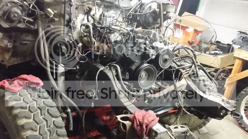

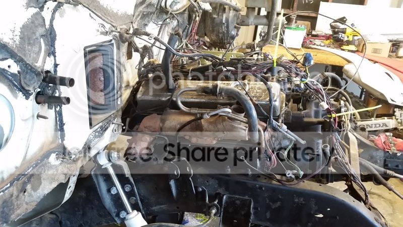

I worked like crazy today on the truck. Mainly just stripping it down to pull the motor.

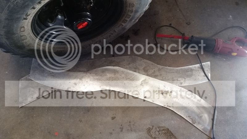

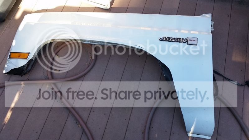

Id really like to try to make these fenders look better...maybe just make the cuts more of a flowing sweep?

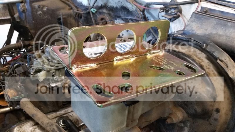

Got this handy lifting fixture from summit...14 bucks

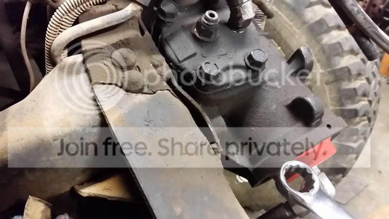

Still need to take the steering box off but heres another shot of the booboo. Ill get the box off, cut the cross member out, grind the frame then weld the crack. Then ill need to plate it.

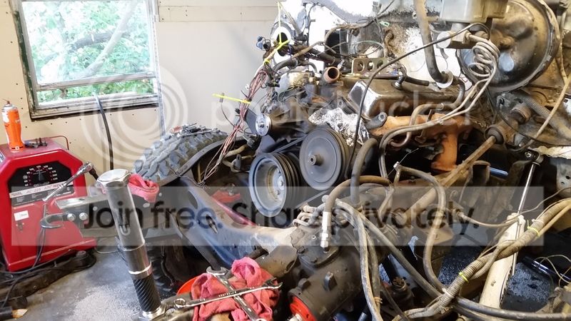

The motor is close to being ready to pull. Its great not having the smog and ac crap on there any more. I plan on leak checking the motor and checking the bearings next weekend. Anyone hear run a high clearance pan?

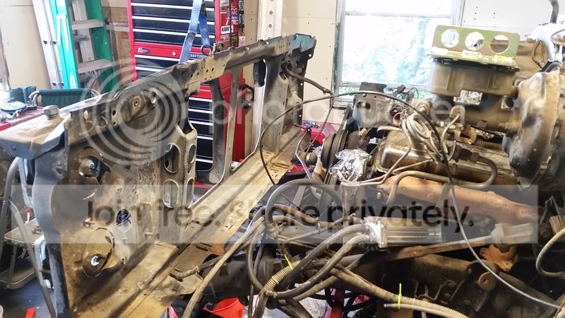

I got the ac unit out today, tranny cooler/ oil cooler stuff out as well. Ill have to replace the oil cooling stuff since it was destroyed getting it out but im alright with that since it was really old.
