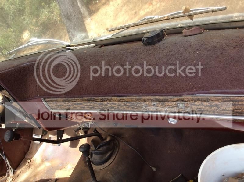

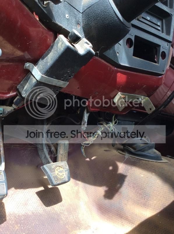

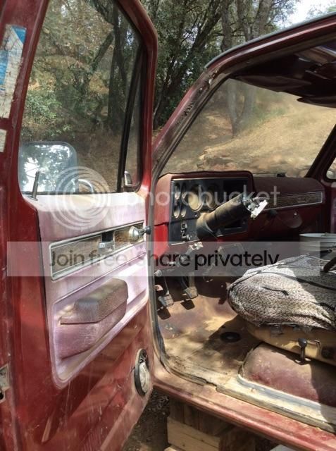

Cab pics are attached! No real rust spots. Got some interior pics to upload...
Hydraulic pedals did not come around till 1985.
Anyone who would go through the work of swapping out a set of mechanical pedals to hydraulic pedals, would know what they had, and would have advertised that.
I guarantee it has mechanical pedals.
Martin

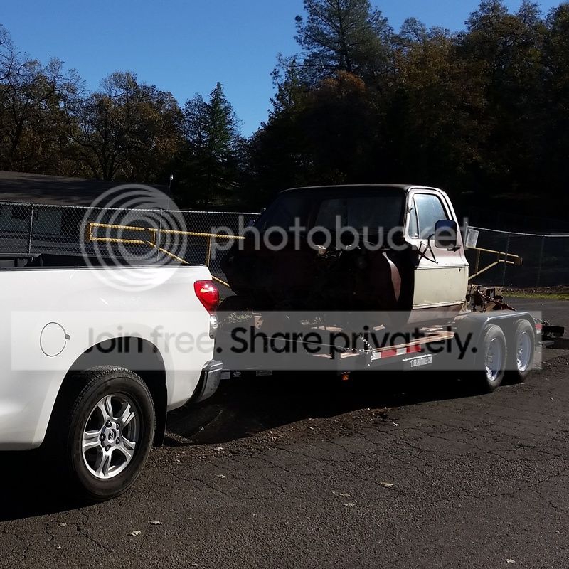

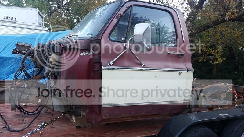

Well I picked up the cab this weekend. I ended up taking the k20 frame with it just because it had 56s on it, it made it easier to load onto the trailer and it was free. Ive been thinking a lot lately about the blazer vs single cab body and what my needs are. As much as I really love the openness of the blazer it has some drawbacks to it. I think to suit my needs better I may go with the trazer style truck....single cab on k5 frame with a tube bed.
The one thing I cant do easily with the k5 is leave it outside. The massive ferral cat population would commandeer it over night. I really hate putting the top on and my garage really doesnt suit a pulley system so I can easily put it on and take it off...which means I have to rally people together to move it around. Itd be nice to just lock a truck up and keep it outside when im not working on it so I can maintain my other vehicles. Changing brakes outside on a steep hill isnt exactly fun...
Still thinking it over some.

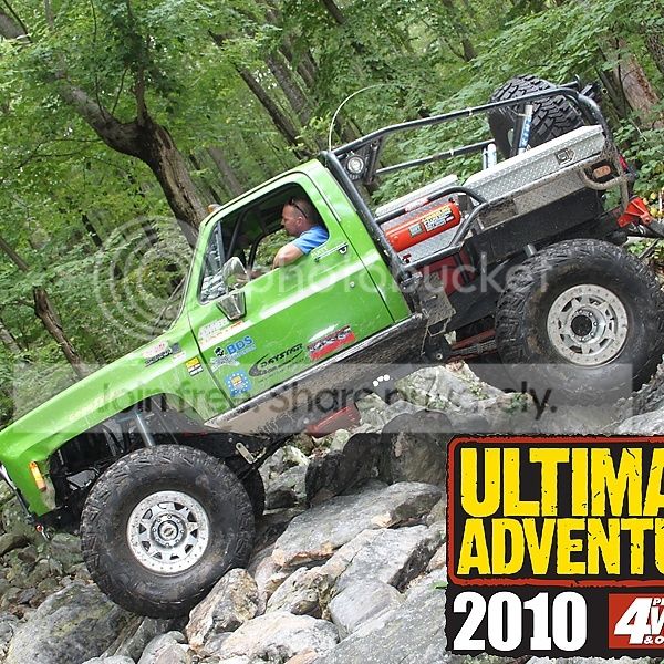

This picture has me thinking...
I don't regret one bit doing the Trazer swap so far... obviously I haven't driven it yet but its been very straightforward. If you need measurements or anything, let me know.
