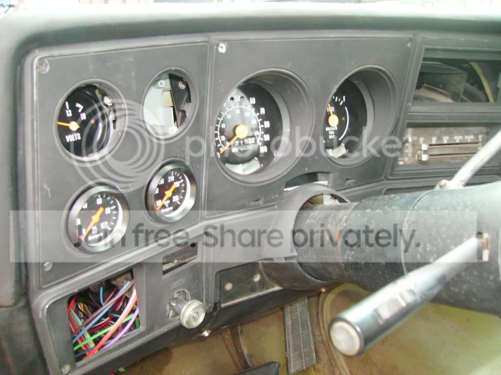

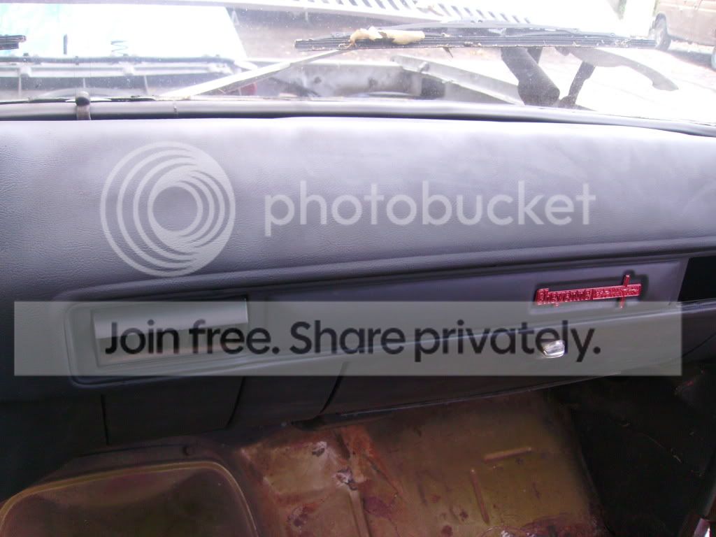

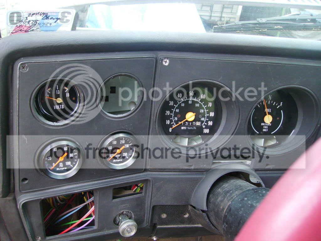

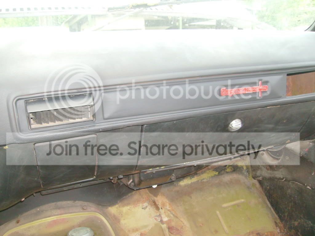

I worked on the dash and gauges today(keeping with the red/black scheme), took some pics but i'll have to post when i get home from work.
here's what i got done today:
The dash was originally tan, but i roughed it up just a little and then wiped it down with some Marine Clean, paint stuck great, i was surprised. I was gonna do more red, but me and my dad agreed that just the emblem looks pretty sweet.
I still have to hook up the fuel gauge, and i will probably be putting in a volt gauge to match the other sunpros. eventually i hope to put in all aftermarket gauges, but a mix of the two will definitely work for now.
not too bad for a litle elbow grease and some paint:D
